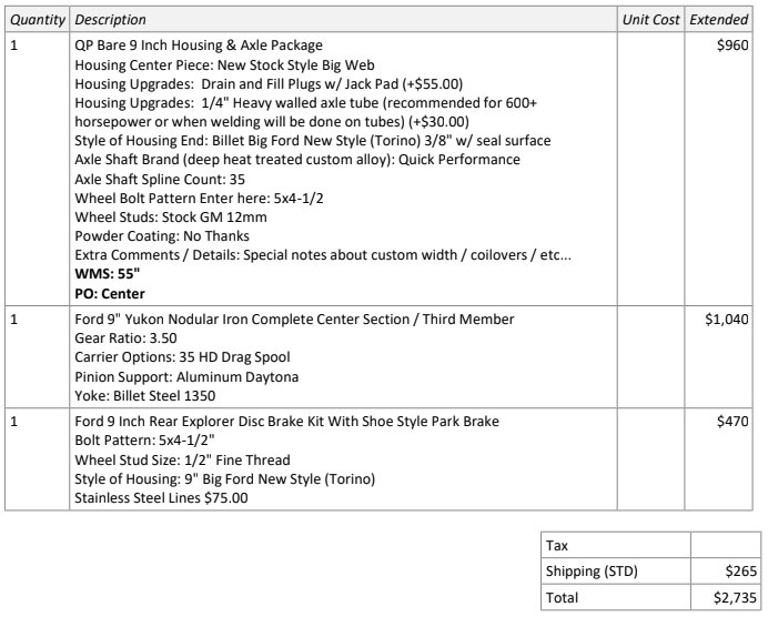

Quick Performance website is pretty dope, and lots of good reviews on them so I gave them a call and a guy talked me through all the options. He said they're at a 4 week lead time for the housings, so I said **** it let's do it and get it going!

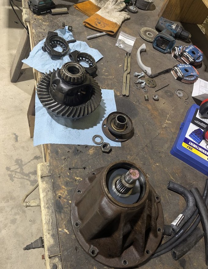

Talked to dude I got the 8" from, he said it used to spin fine so was probably just gritty or had rusty bearings. Ran out to the shop before dinner, pulled it back out and tore it down. Turns out the pinion nut was just so tight it squished the bearings and that's why it was so hard to spin. With the yoke off it turns like a champ! And this was a good move since there's no pinion seal on it, so if I filled the axle it would've just leaked everywhere. If I had swapped the adapter flange that I didn't have time to do yesterday, I probably could've solved all of this since I would've seen there was no seal, and probably would've found out the pinion bearings being overloaded was the issue. Oh well. I'll get a seal, slap it in, throw the adapter flange on it, tighten it on the bench to make sure it can still spin nice, and then slap it back in the truck and we're good to go. I'd call that a successful 15 minutes today!

Off-road stuff is so expensive compared to the street stuff I'm finding. Like a run of the mill ruff stuff 9" housing is $1200 and not even cut to length. Same price from Quick Performance and you get a housing with bearing cups welded on at the lengths you want and custom shafts cut down of any spline size and bearings too. My last build was a "budget" Ultra4 style buggy, and the cost difference is just insane in every aspect. Budget stuff for off-road is more expensive than nice street parts!

Got the diff together and back in the truck and she spins real nice now! I did not look at the crush sleeve or if there was a spacer or anything, I swapped the flange on I needed and just tightened the nut until it felt good and then staked it!

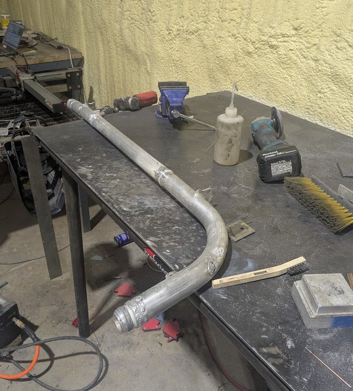

The coolant tube had welds cracked, so pulled that and welded those up. It also got beat on real good in a couple spots, they didn't appear to be cracked but I filled in the gouges with weld to be safe.

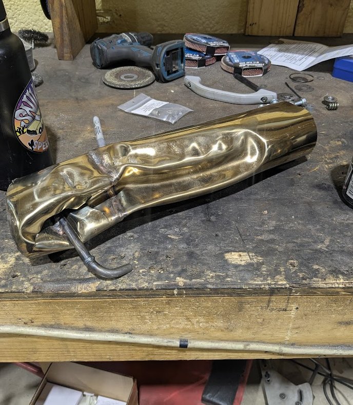

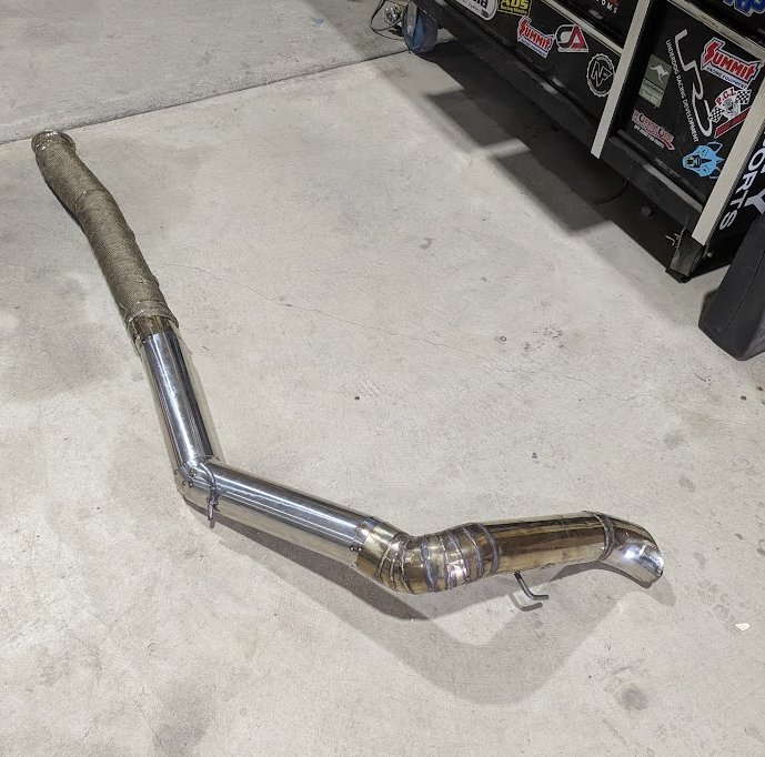

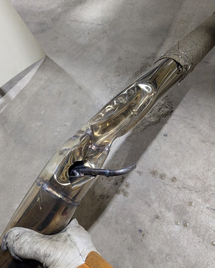

The exhaust got absolutely destroyed.

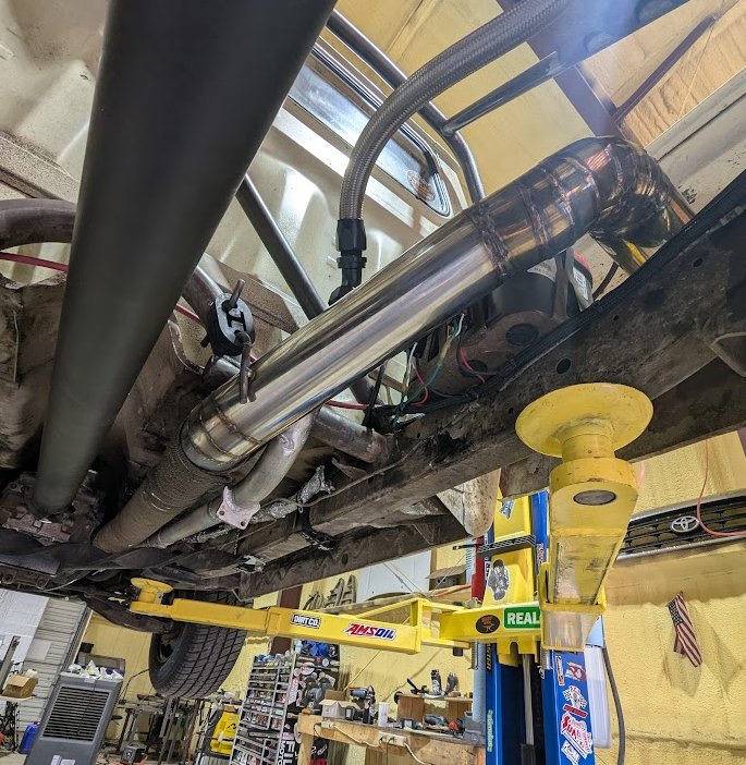

Ordered some new 3.5" tubing but it has not shown up yet. I dropped the driveshaft off and got it back yesterday, threw some paint on it and installed it. Filled the truck with coolant, and today went for a test drive and everything seems to be working! Oh wait the radiator fan isn't turning on, the relay isn't getting signal from the ECM.

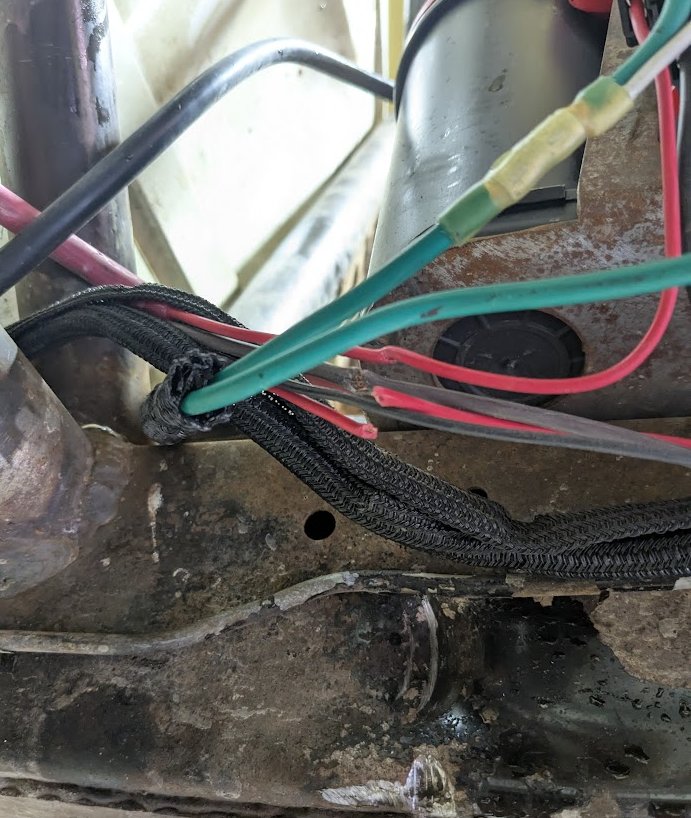

Turns out that gouge in the frame did some damage even though it looked like it missed the wire bundle. Only the fan signal wire was fully broken, and good thing it was otherwise I would've never looked! Fan and fuel pump signal wires were broken, as well as whatever the bigger brown wire is (I should probably know what that is but I have no memory of it). The fuel sender wire (black) was untouched though!

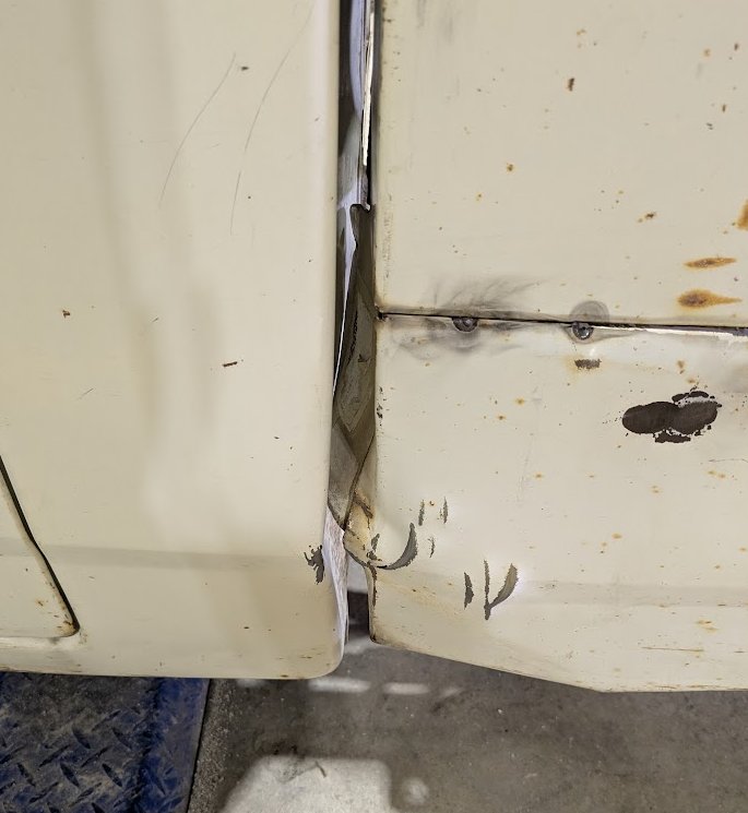

The driveshaft did a lot more damage than initially thought. The yoke off the pinion somehow slammed all the way forward and dented the bedside and even the body! Dented bedside/body, dented frame, wiring cut, coolant line broken, exhaust crushed and a hole in it, driveshaft broken in half, and lastly the pinion sheared off. A lot of damage! Could be worse, luckily I'm not super concerned about cosmetics, and the rest of the fixes are straight forward. I'm thankful that the radiator somehow lived, and the back glass.

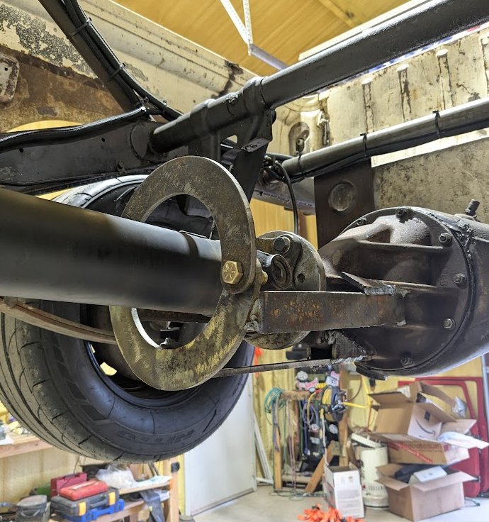

Did you also put a loop up front? The 'pole vault' caused by breaking that U-J at speed isn't pretty.
With the 9's bolt-in pinion carrier you'll have a nice place to bolt on a new version is so inclined. Most of the time what I see done for that instead is a 4X limit strap bent in a 'U' and hanging from something convenient on the chassis.
That's what I was gonna do up front but all the limit straps I have on hand are the wrong length. Was debating throwing one of the oversized ones on for today.

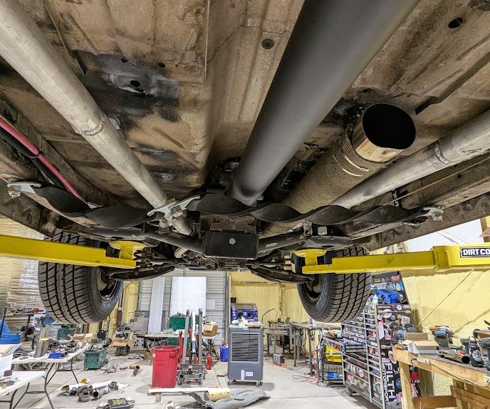

Saturday morning before more tuning I threw a limit strap under the driveshaft, which you can barely see in the below photo. I had been on the fence about doing it since I think the transmission side will be fine, but the wife really wanted it and it is a good idea. There's not a good place to put it, plus I didn't have any straps that were the right length, so I ended up psuedo-ghettoing it and just welding some studs to the frame and then taking two straps and twisting them (an offroading trick to shorten them) and that got them tight enough to not drag on the ground. I'd like a better setup to keep the shaft from destroying everything, but ultimately this is to prevent it pogo sticking the back of the truck and without adding another crossmember there's not really a sexier way to do this, so I'll keep it as is I think (and probably buy a correct length limit strap).
At 9am we did a bit more tuning, but the truck was so insanely loud with the exhaust dumping under the cab we couldn't do much since dude couldn't even hear me on the phone. Of course, the exhaust tubing showed up a couple hours later so I was able to make the truck not sound so loud (at least in the cab).

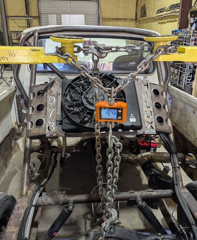

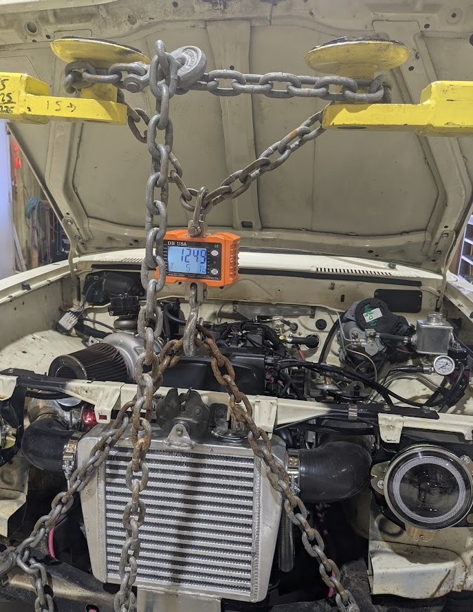

To wrap everything up, I've been wanting to weigh the truck and yesterday got around to it. Threw some chains and my crane scale on the lift and pulled it up.
Because the front is lifting off the frame and not the axle, need to do a bit of statics and the overall weight comes in at 2545 lbs! 1046 lbs over the rear axle, and about 1500 lbs over the front axle.
Trying to find a weight for a stock truck, on a mini truck forum one person says a stock truck is around 2500 lbs, another guy actually coincidentally says the truck weighs 2545 lbs too. I thought it'd weigh quite a bit less to be honest, but at least I can say it weighs the same as a stock truck. And 2500 lbs with 500hp or so is still no slouch!
Maybe this helps, maybe this is a bigger PITA, but options anyway. I use it to get corner weights. If I need it really accurate I have a helper pull on a piece of paper put under the tire and make my reading when the paper slips out from under. If close is good enough I just eyeball it. Leverage ratio is 10:1, so 100 ft-lbs on the wrench is 1000 lbs on the tire.
