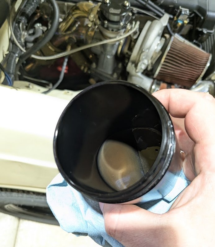

As far as overall truck updates, I was very concerned earlier in the week that the engine was having issues. I got lunch in it and the truck kept dying on me, but only when I would stop. It turned out it was the low oil pressure safety kicking in and turning the engine off. My oil pressure at idle was dropping below 15psi which really freaked me out, I was pretty convinced something was fried. Additionally my catch can had a ton of fluid in it, though I hadn't checked it in a few drives.

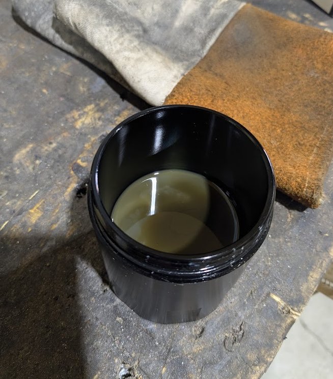

I had not changed the oil yet, maybe a bad move, so I drained it expecting the worst but it didn't look absolutely terrible? I didn't take a photo, but it was very dark and shimmery but there were no big chunks left on the sides or bottom of the bucket, and cutting the filter open and it looked fine. After talking to my neighbor, and the tuner, and researching, I've kind of concluded I just freaked myself out. First of all, the engine probably has 100 miles on it without changing the oil and this includes the break in oil and s*** still in there (probably should've changed it sooner, oh well). The filter being clean and no big chunks anywhere should mean the engine is fine, and the oil just being dark and shimmery would be expected from initial break in and flushing all the s*** out from machining and assembly.
The catch can being so full is most likely since I have very loose ring gaps (.028-.030) which is intentional if I ever want to up the boost, plus the rings probably aren't seated yet, and every single time I drive it it sees 20psi of boost. And at idle there's no crazy blow by, you open the oil cap and there's nothing choofing out, and the exhaust looks fine. With that said, I do need to be diligent about checking the catch can, this below is one drive after emptying it:
It doesn't smell anything special, your usual catch can brew. So I think that's fine, and comparing it to my buggy which is built very similar and seen a lot of abuse, it fills the catch can pretty fast (much faster than my Tundra for example) and it's likewise a built engine, loose rings, and sees boost and doesn't get a lot of miles.
Going back to the oil pressure, the 2JZ spec for idle oil pressure minimum is 7psi. SEVEN. That seems insane! But multiple people I've read from multiple places say that their idle pressure is 15-20psi, and as long as it's above 7psi don't sweat it. It seems weird to me that it seems to have dropped so much with miles on the engine, but by 2000rpm it's at like 50-60psi and over 100psi at high rpm. The low oil pressure safety was just kicking in when you'd punch the clutch, rpms fall and overshoot so it'd hit like 700-800rpm and then before the ECU brings the rpm back up it sees the pressure is below like 15psi and turns the ignition off. My normal 1000rpm idle the pressure is pretty consistent at 18-20psi which sounds pretty common actually, and the tuner was unphased by it and just said he recommended lowering the oil pressure safety limits at low rpm.
With all of that said, I did change the oil over to the Amsoil 10w-40 that the buggy runs and swapped filters. I'll change this oil in another hundred miles probably and see if there's a trend, but from a raw feeling perspective the engine feels totally fine and happy (knock on wood). Last time when I had the main bearing let go, I could FEEL it, the engine just felt off and felt like there was a drag on it, and I noticed that two blocks from the house after the bearing started to go. This doesn't feel like that, it doesn't feel like anything, it pulls like an absolute freight train, idles great, runs great, no indication anything is wrong. Based on all of that, I think it's fine and just keep monitoring stuff like usual.

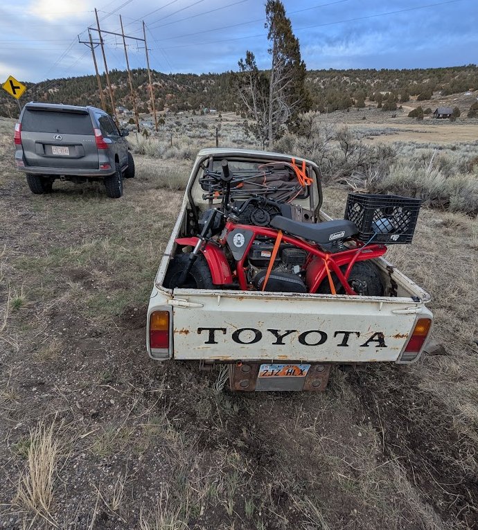

Some friends were heading out camping yesterday, and they said their first campsite was only 1.5 hours down the road so I decided I'd take the Hilux and stay with them the first night. The truck has been running great, has the engine protections working, so even if my laptop died so I lost my gauges I was confident the truck would be fine. I threw a sleeping bag, sleeping pad, tent and a couple clothes in the truck. My friends also packed my Coleman mini bike in the bed which happens to be the perfect size to sit on the frame rails sideways, and then a camp chair strapped to the cage and that was the extent of planning I had!
We went over the mountain on the way to Bryce Canyon. Truck's first time climbing the mountains with the new setup, and no issues going up. I was worried about water on the road, but besides a few trickles nothing bad. Just had my headphones in, laptop with the dash up in the footwell, just cruising between a GX and a F250 and some beautiful weather! Sadly though, my wife was correct not an hour earlier saying she didn't trust the truck to not break hahaha
I literally texted her saying the truck is doing fine, don't worry, and then not two minutes later said can you come get me.
The GX passed two cars, and another car was coming the other way so instead of being in the GX's ass since the truck is way faster, I just chilled, let the other car come by and then went to pass. I didn't think I was particularly pushing it hard, but it's so hard to tell, I rarely use more than 50% throttle in the truck because it makes so much boost, so fast, and the torque and push back in the seat is immense without needing more throttle. I think I was in 4th gear, and just letting it rev out, and then higher in the rpm got the (now classic) thump in the rear. For some reason my mind always defaults to the axle falling out? Regardless, hear/feel the thump as I shoot past the second car I'm passing and instantly the truck is going sideways in a clockwise spin. Around 180deg I see smoke everywhere, and the whole time I'm kind of spotting and waiting for the truck to roll. Again, not sure why my mind defaults to that, maybe it's from all the offroading I do and rolling vehicles so I expect anything will roll if it gets sideways. The truck spins past 180, and has now essentially pirouetted around the second car, going from passing on the left, to spinning clockwise and now facing forward again in the right hand lane, and then sliding off the shoulder. Once the truck started sideways I hit the brakes, I figured locking them up (no ABS) wouldn't make any difference since it's already out of control. The first time the rear end let go we still had brakes and control, this time it was instantly sideways almost at the same time I felt something happen in the back.

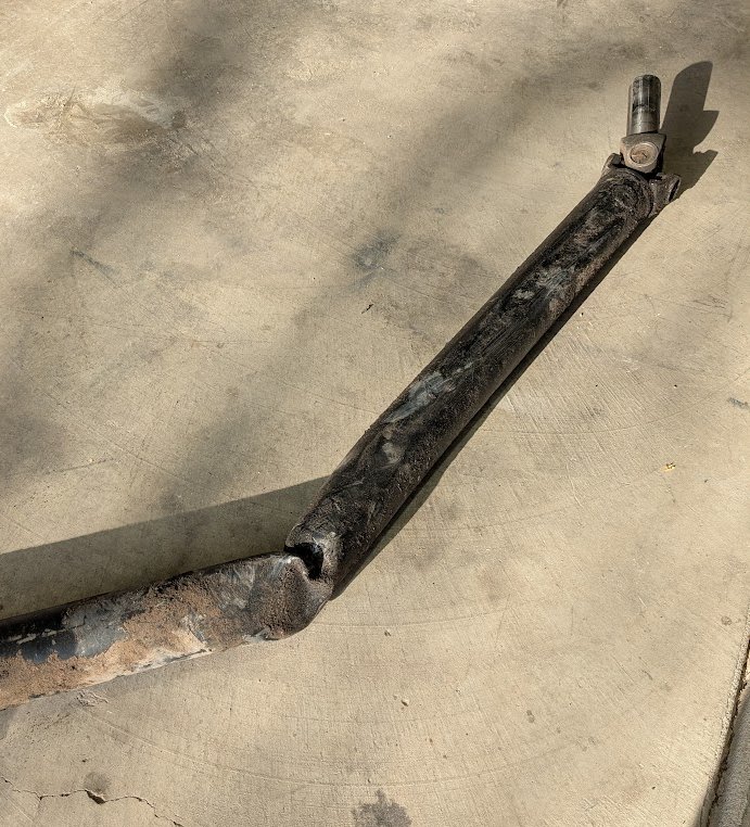

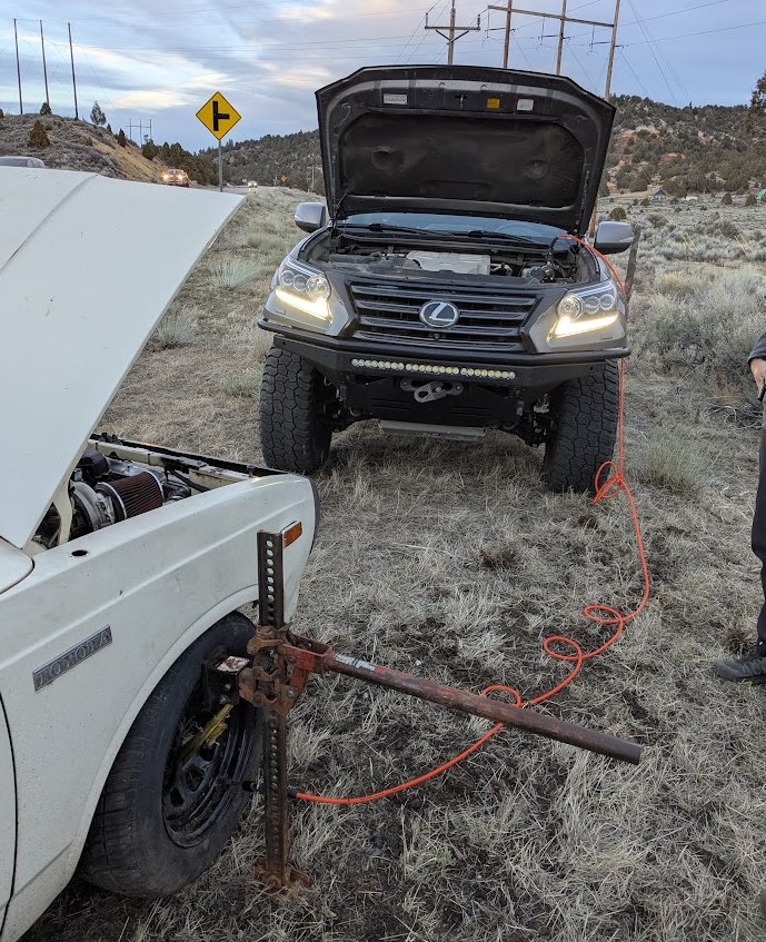

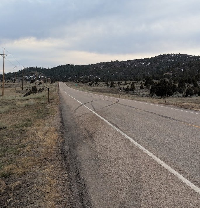

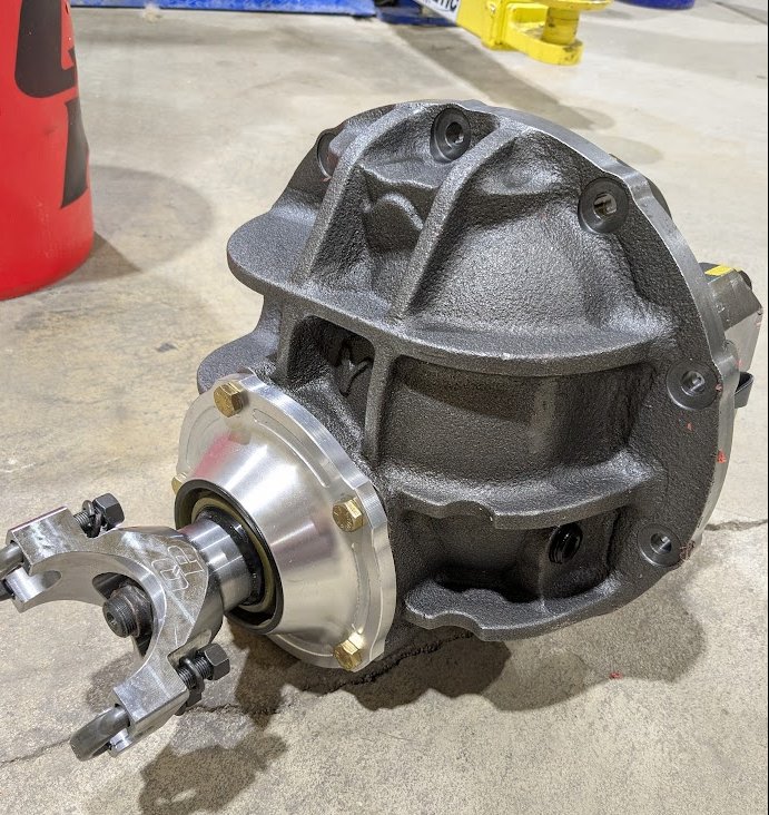

What I THINK happened, there was so much axle wrap that the U joint got maxed out, and that locked up the rear end. This is why it started spinning right away. The diff still spins, but one of the yoke ears got ripped in half and the driveshaft is buckled/twisted, and the rear tires have flat spots. and the leaf springs are noticeably warped now. The U joint maxed, locked the axle for a second, the engine kept spinning, twisted the driveshaft and broke the yoke.
I'm sure the cars I passed absolutely s*** themselves as a loud little truck passes them and then bursts into smoke and 360 spins in front of them. I was totally fine, the back of the truck was maybe 4ft off the side of the road, so no banging around or anything since it just spun down the road and then settled into some loose dirt. I called the wife, and she grabbed the Tundra and trailer to come get me. In the mean time the front right bead had been popped, so we got that reseated.

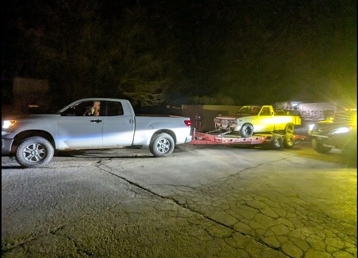

We then flat towed the truck to a gas station back where the two highways joined, and waited for the wife to show up.
And needless to say, that ended my camping trip! I thought the truck was going to do great, and I was even trying to be mindful of loading up the rear end since we know it was a weak spot. I figured it might break at some point, I didn't figure it'd be so fast! Especially after all of the tuning and WOT runs lately, I thought it had somewhat proven it would be fine staying at lower power---but as I said, "lower power" can still be a lot!

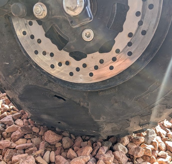

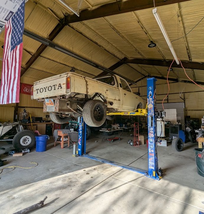

This morning I unloaded it to see what other carnage there was besides the obvious. Maybe the most sad actually is one of the Coleman's tires got popped.
The Coleman was fine throughout everything, and then FLAT TOWING the truck to the gas station, the front tire shifted and got rubbed through on the back tire of the truck! This was probably the saddest part, some stupid collateral damage that was totally avoidable!

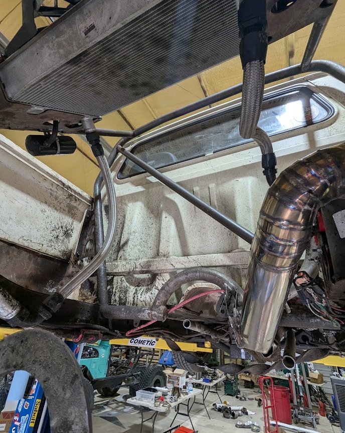

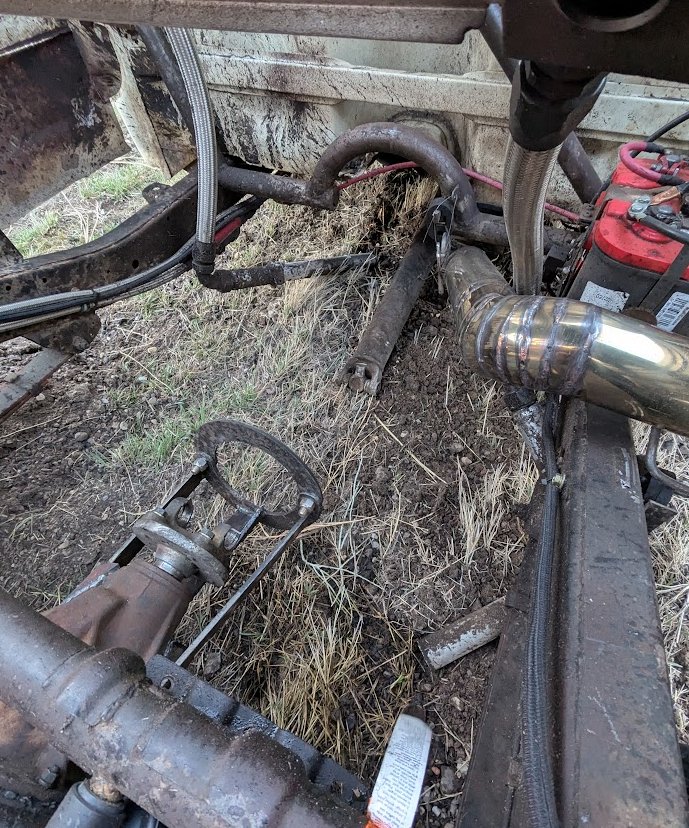

But back to the truck, both cooling lines this time broke.

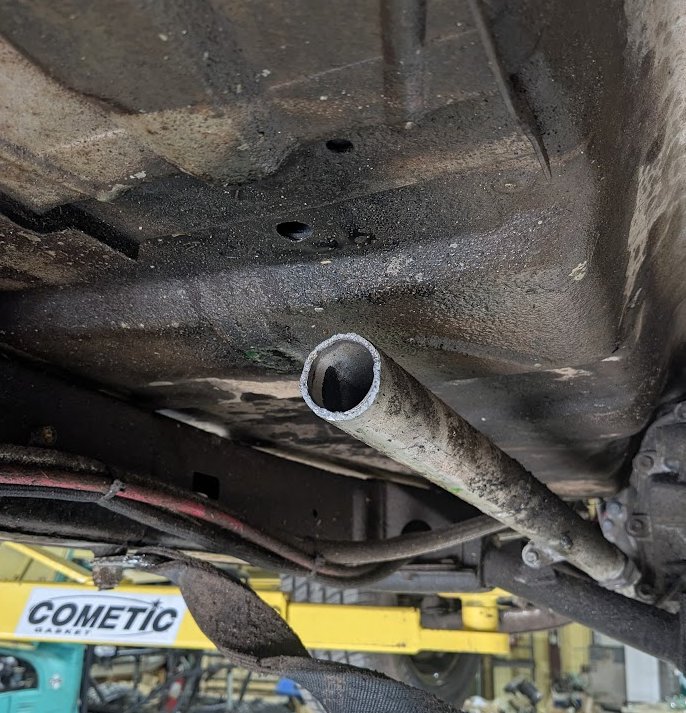

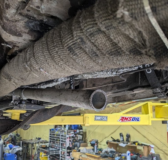

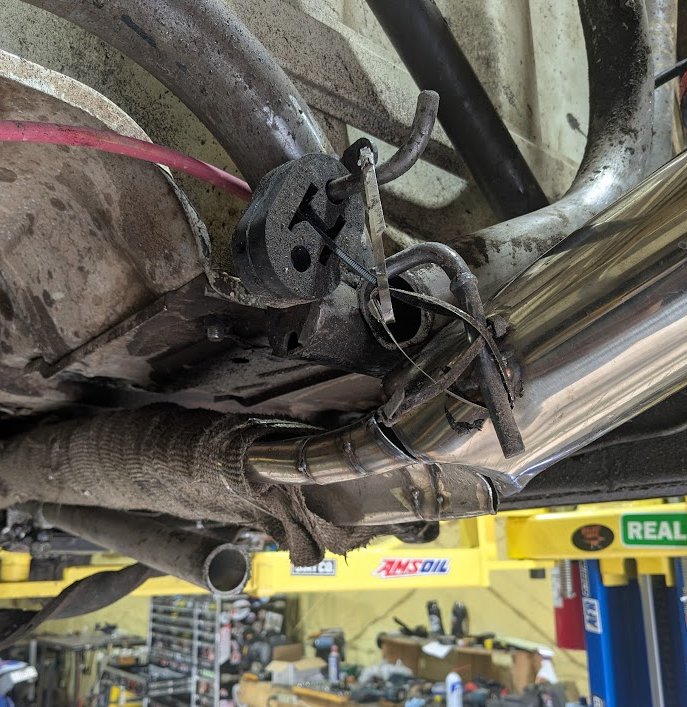

Of course the exhaust once again got mangled. On the plus side, I will definitely install a muffler to try to quiet it down this time I fix it!

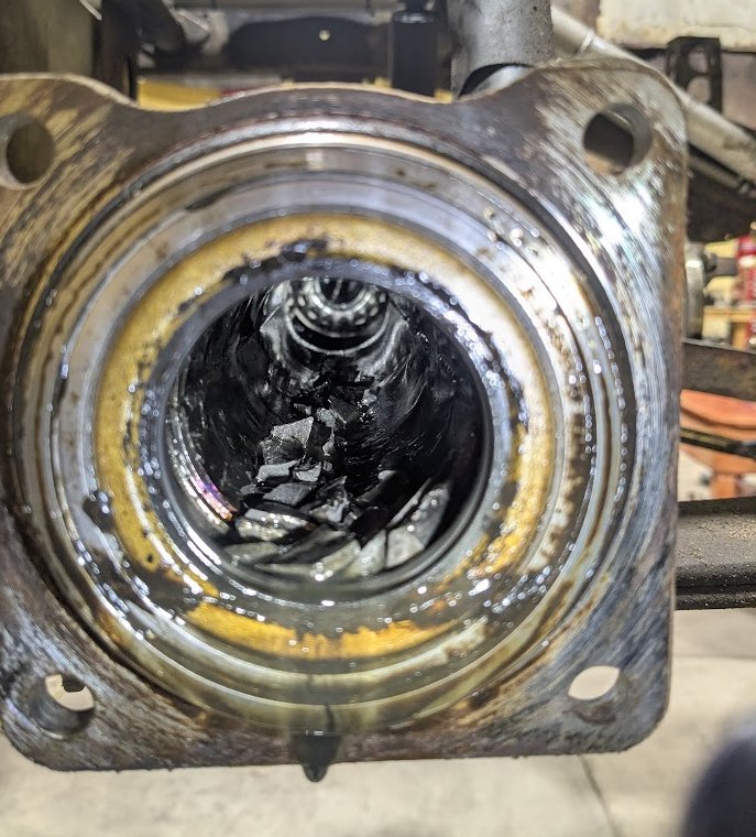

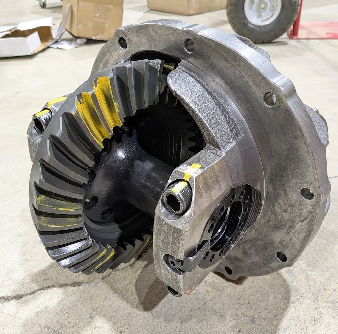

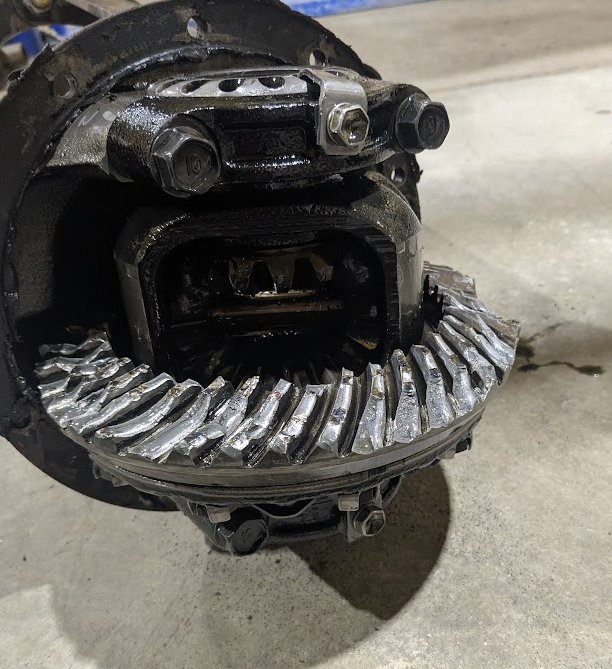

The rear diff still spins fine, but there is a lot more backlash and some radial play now. The yoke has an ear ripped in half, and is actually cracked in half down the center.
The driveshaft that I got a week ago is now dead, albeit not in two pieces! Arguably the little diff hoop helped.
Lots of dirt and mud under the truck, coolant, gear oil from the trans, but at least the axle didn't spit oil everywhere!

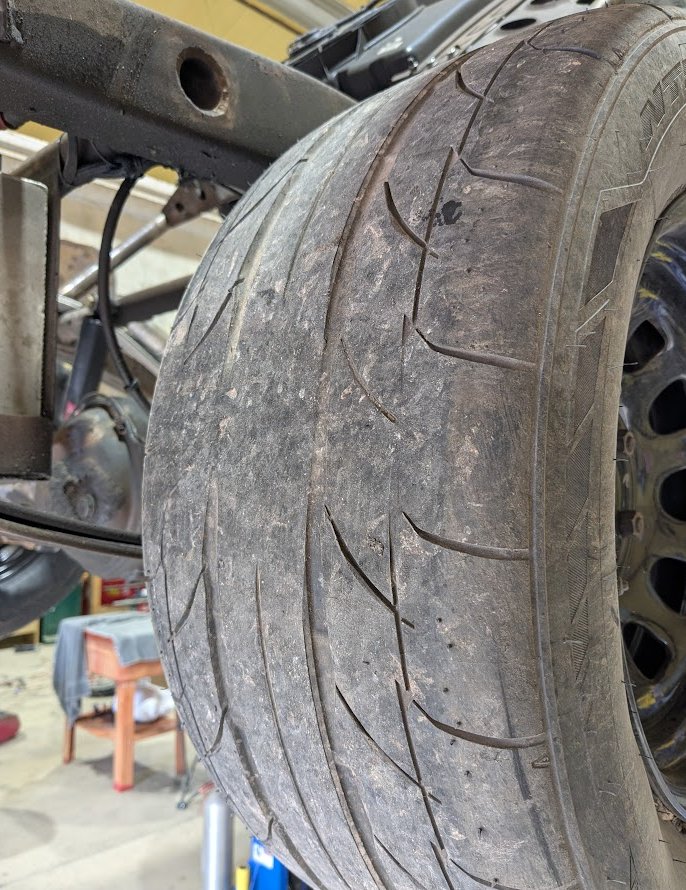

Probably need new rear tires already, we'll see how bouncy they are. At least they're cheap!

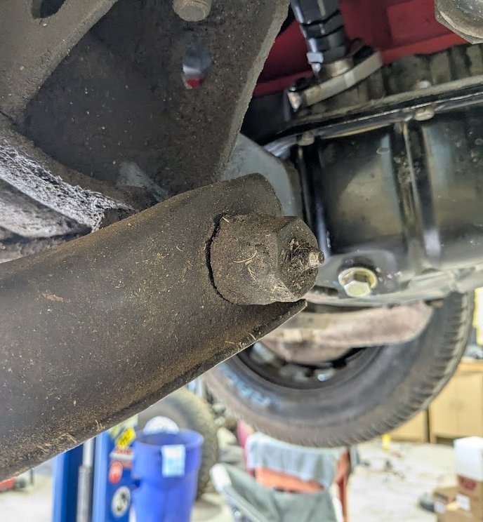

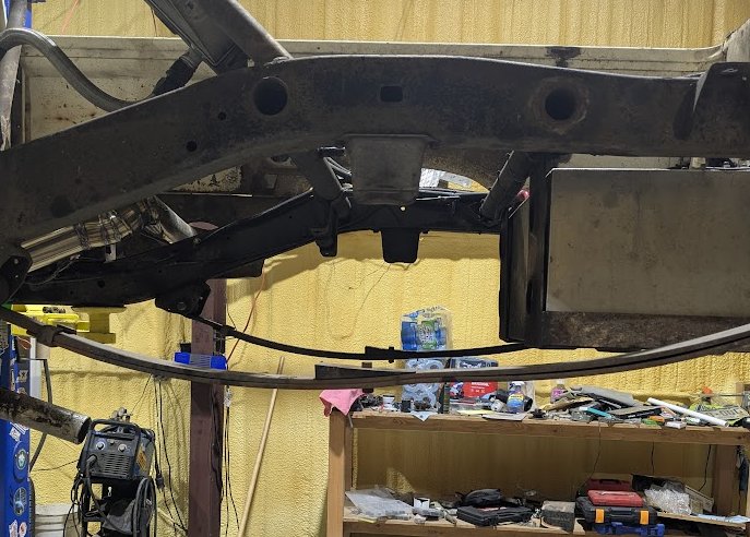

The current mystery is the front right alignment is WAY off, the tire is shifted backwards an inch or two. I can't find anything so far that's obviously bent or broken. I do have the 3D scan of that corner though, so have been comparing scan to real life measurements. So far the lower ball joint seems to be pushed back 1.5-2.0", and the upper arm seems to be in the same spot. But the lower arm doesn't seem to be bent, the mounting points vs the the ball joint are the same distance. There is some dirt that is shifted in one or two spots, maybe that amount of motion is enough to have moved the LCA backwards that far?
I'll need to investigate more, maybe there's just some bushings or the LCA bolt got bent or something, since the frame seems fine, UCA seems fine, LCA seems fine, but the LCA seems to be angled back quite a bit.

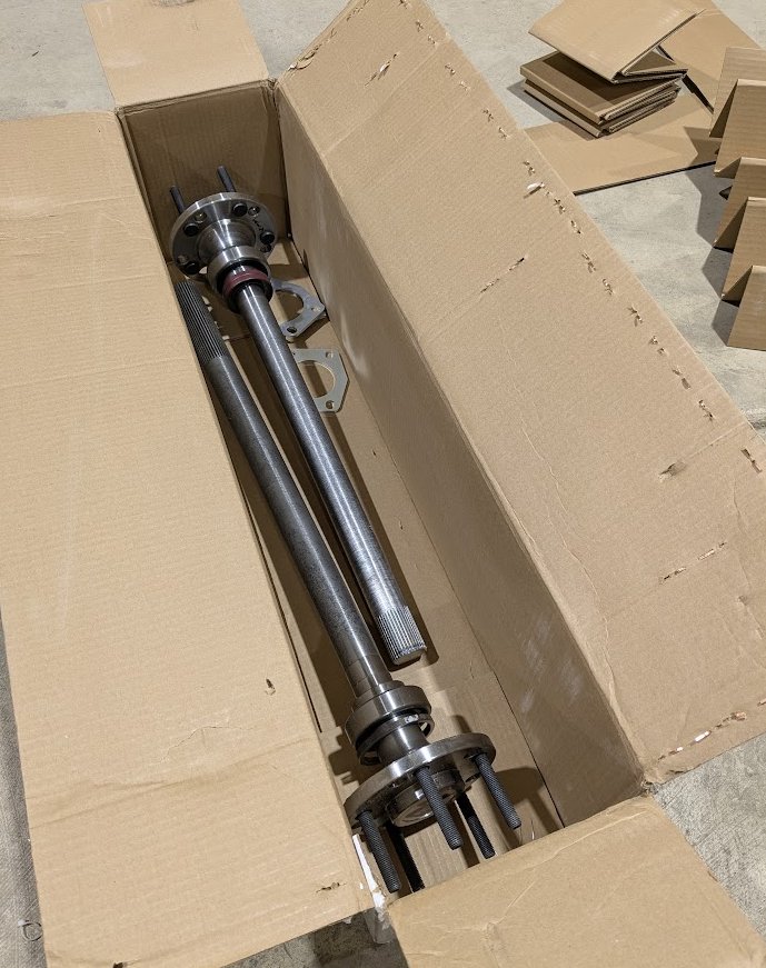

Quick Performance is wickedly quick! I got another tracking number, and I think it's for the axle housing already! Should be here later this week. With the rear stripped down I'll now scan the back and throw everything into CAD to design the brackets, figure out axle placement, look at suspension geometry, and size what shocks to buy. But first I decided to scan the front right again so I can compare them in CAD and see what's bent since visually everything is fine.
Overlaying the two scans is a pain to actually get very close. This position seems the most correct I've come up with, and roughly matches the ball joint position difference I got with the tape measure.

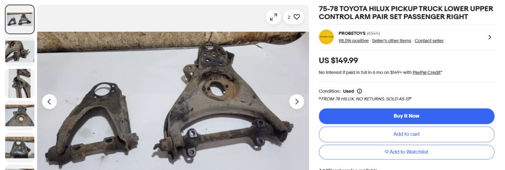

The gist of it is, I think both upper and lower control arms themselves are bent and that results in the hub being pushed to the rear over an inch. I was hoping to find a set of new arms, but so far haven't found anything. For $150 there's a couple options on ebay of used nasty looking arms.
If I can't find any new replacements, I think I will just cut the front of the control arms, bend them back forward, and then weld the arm back together in the correct position. A bit janky, but we're not looking for perfect handling, and the whole front suspension will get deleted in the future anyway.

What are you thinking to eventually replace the front suspension with? I had been thinking to just make some tube arms patterned off the good one until you mentioned that.
Hadn't put a lot of thought into it, but delete the whole subframe, add normal brackets welded to the frame, some type of adjustable arms so I can get easier caster and camber adjustment. I have a Prius steering rack and electric assist already, so install that, move the steering rack to the front, front diff on the back side, then probably some billet aluminum spindles, maybe billet control arms if I'm feeling froggy. Maybe increase the turning radius depending on how drifty I want to be. And convert to (normal) coilovers. Oh and some bigger brakes and vented rotors.
