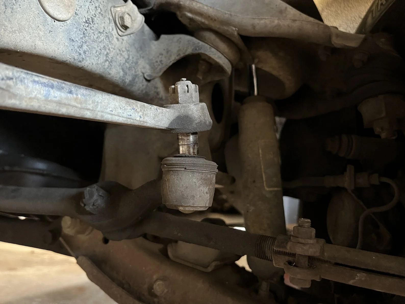

I've picked up all the parts below.. this follows a quote from a local mechanic ($US2900) for a rebuild of the steering/ball joints/and control arms bushes.. it was very much a "I really dont want this work" quote
IFS has been a mystery to me, but the more videos I watch and the more I look into it the clearer its all becoming.. I am feeling increasingly confident about the upcoming work that I'll start this weekend.
Total parts cost $US380 ($AUD605)..

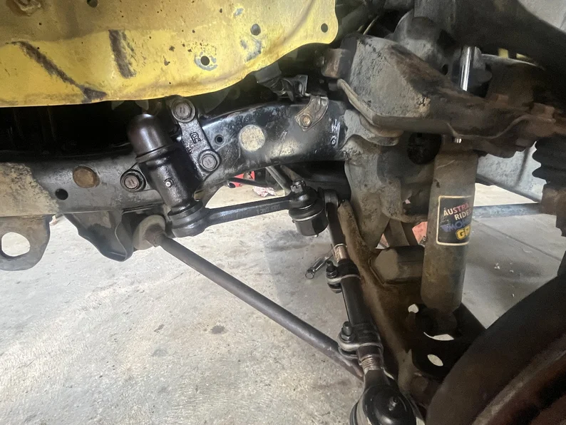

The Idler Arm's connection to the Relay Rod was almost certainly approaching failure..
How do your CV boots look? I've repacked and rebooted my OEM ones several times over 20+ years.
4x2, thankfully no CVs to deal with - that upgraded Idler arm looks nice.. overkill for my application though thankfully (ouch on the price!)

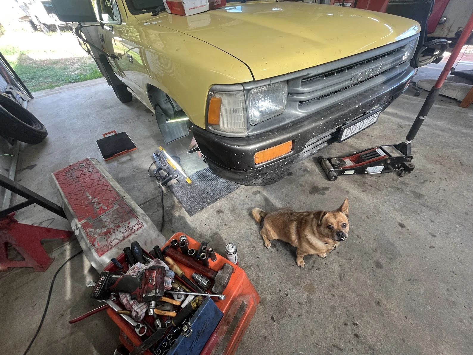

New tie rod ends, new relay rod, new steering idler today! Did a basic alignment and it drives well..
Ball joints in a few weekends time.

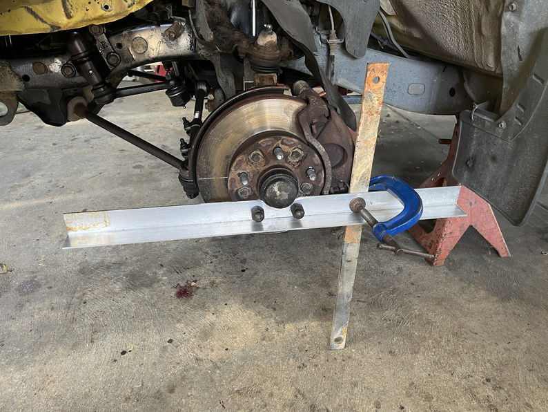

did you put the a-arms at ride height for alignment ?
I did not.. that seems like a suboptimal mistake.. I will do again. First time doing this. I could jack the lower control arm up.. but if I put the tyres on I wont be able to get a straight edge on the rotors. When the ball joints are done I'll get it in for a proper adjustment I think.
you can just put it on jacks or blocks without wheels to get the suspension loaded
Ah.. interesting, thank you!

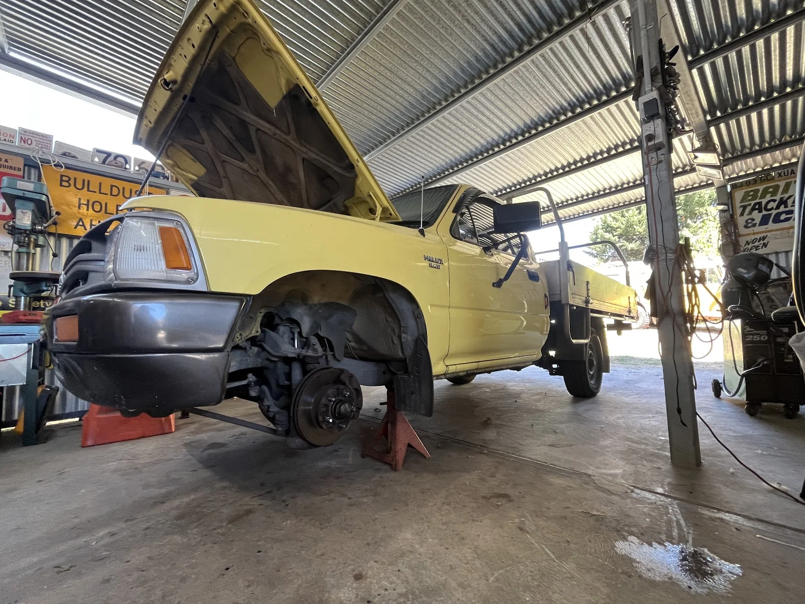

Upper and lower ball joints done today, and new rotors..
