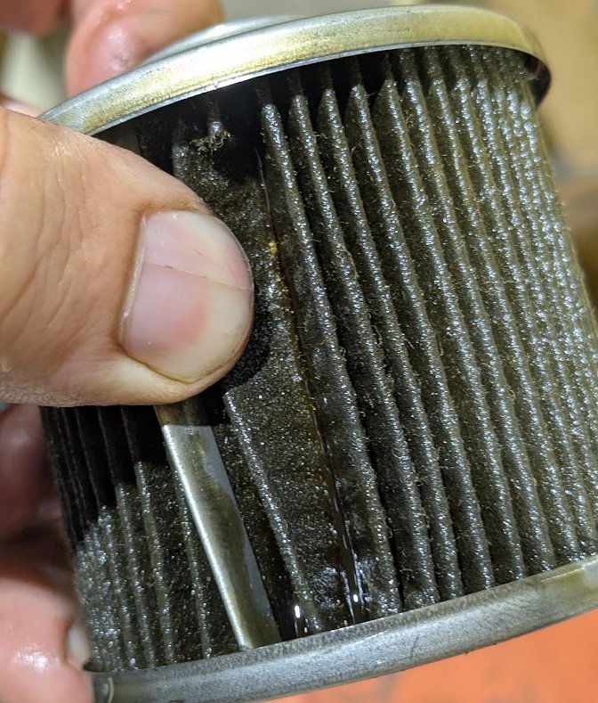

The oil looked fine, a bit of gold shimmer in the bottom of the container after draining it, and some shimmer and a couple small pieces in the filter. This is the 2nd or 3rd oil change on the engine, so I'm not particularly worried.
The VVTI filter had some s*** in it, but not enough to stop the VVTI working.

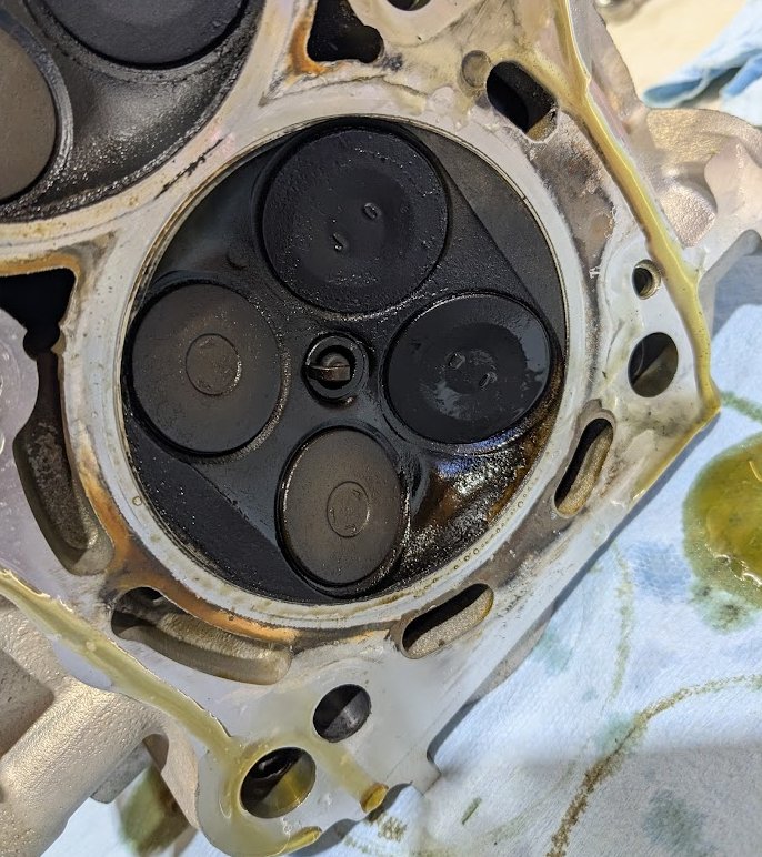

The top end looked fine. I pulled the spark plugs and they all look great.

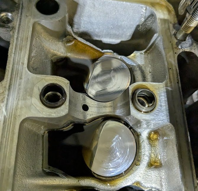

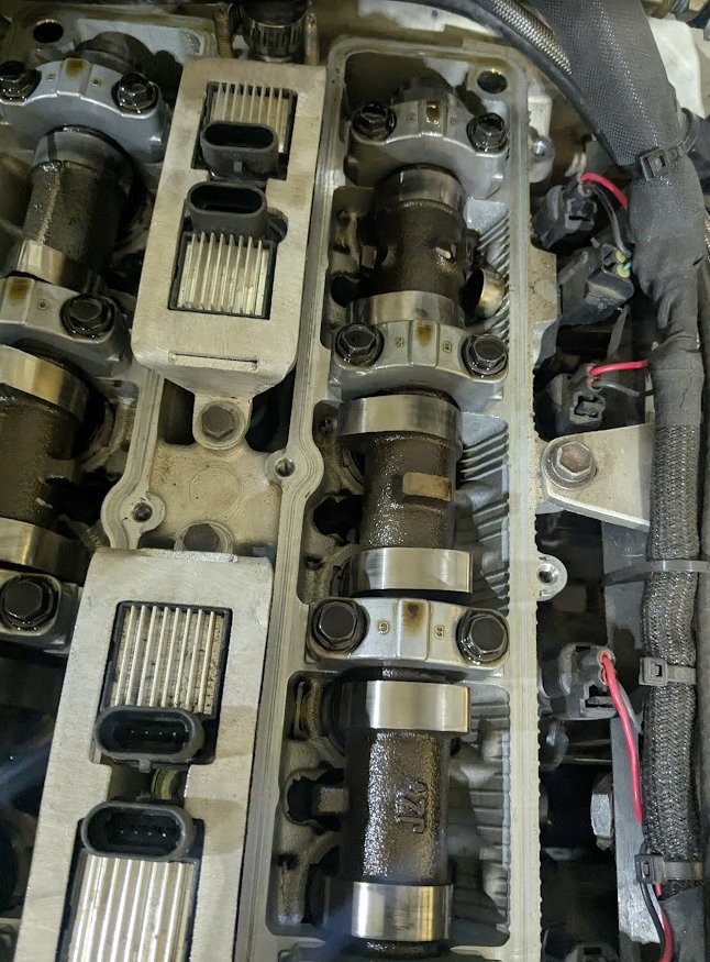

The noise kept bothering me and I couldn't figure out where it was, so on a whim I pulled the cams to fix the valve lash on the couple spots out of wack. That revealed the journals were pretty chewed up.
The cams seemed fine, but there seemed to have been an oil starvation issue which was odd, or some s*** had gone through the engine. With not a lot of options, I took some scotch brite and smoothed out the surfaces which didn't take much effort and made them look a lot better.
That was last week. Put it back together, no change. Talked to my neighbor, and we found that unplugging #6 made the noise go away, so whatever the noise was from was caused by #6 firing. Friday morning I decided to pull the head and see if there was anything that would help me not have to pull the whole engine.

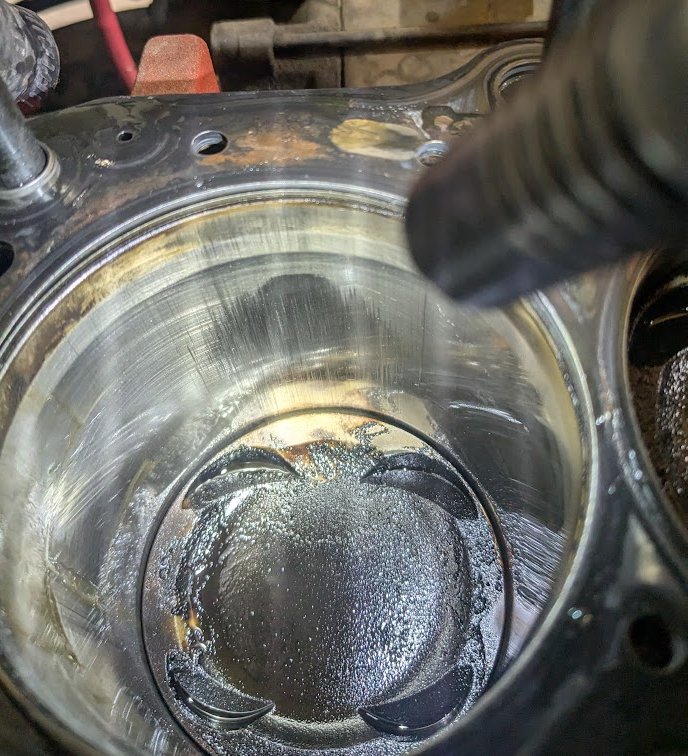

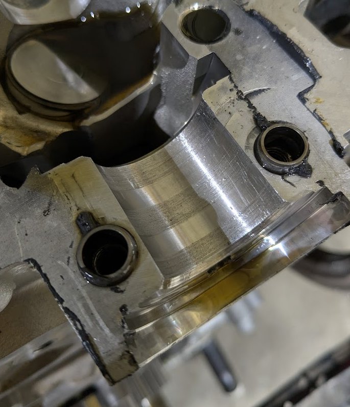

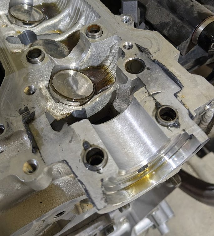

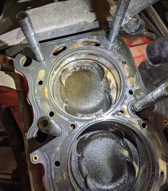

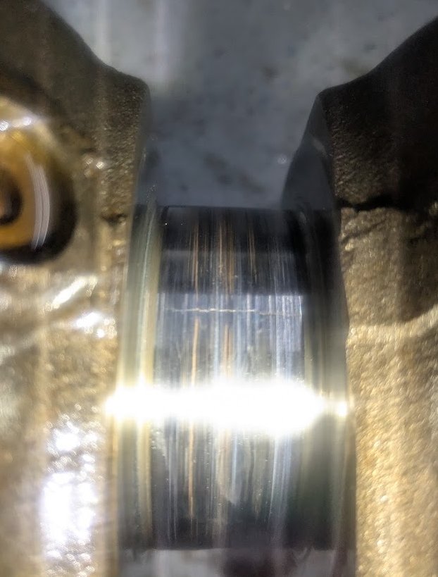

There was nothing seemingly wrong with the head. The cylinders (all of them) had these weird wear marks about halfway up and on both intake/exhaust sides. It's all smooth but the cross hatching is worn away, and this is with maybe 3000 miles on the engine. My other block with 200k on it doesn't look like this.

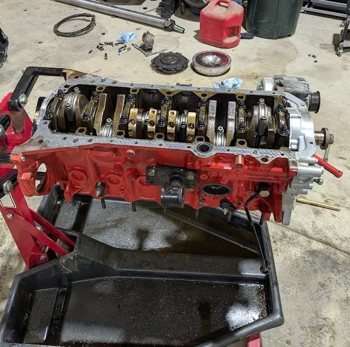

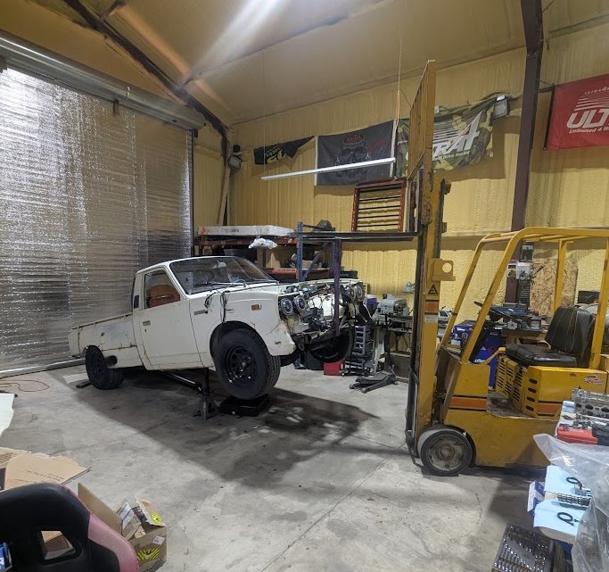

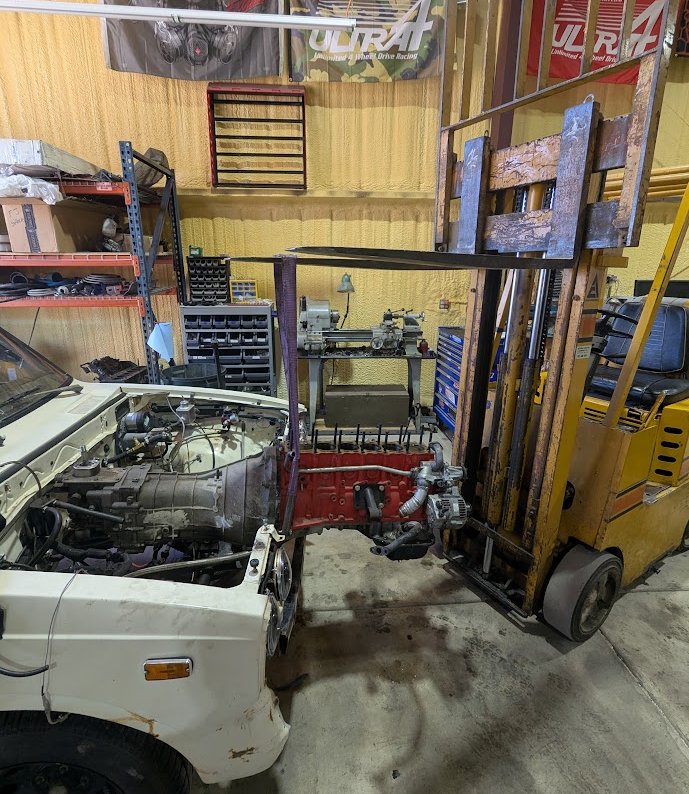

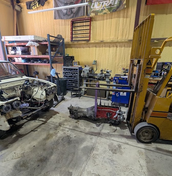

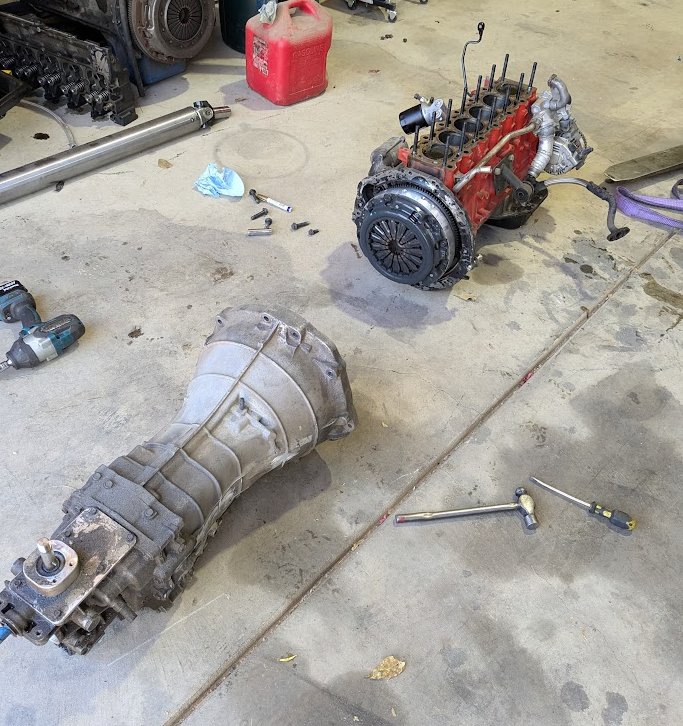

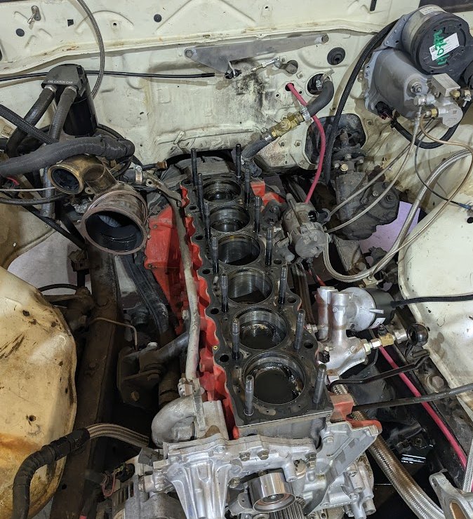

Today I pulled the engine.
Easier to just pull the trans out and then will make aligning with the clutch easier when I reinstall it.

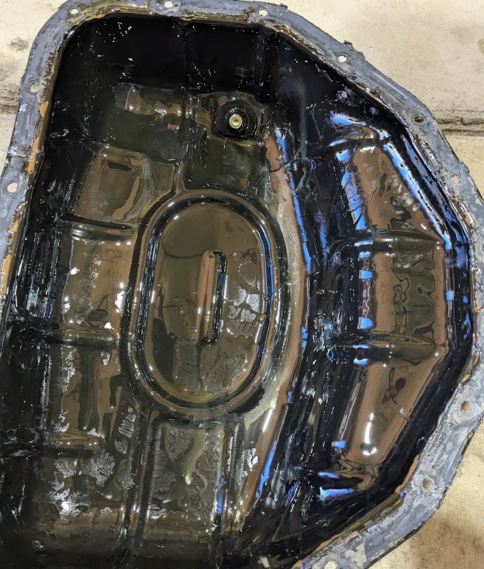

No big chunks in the oil pan which is good

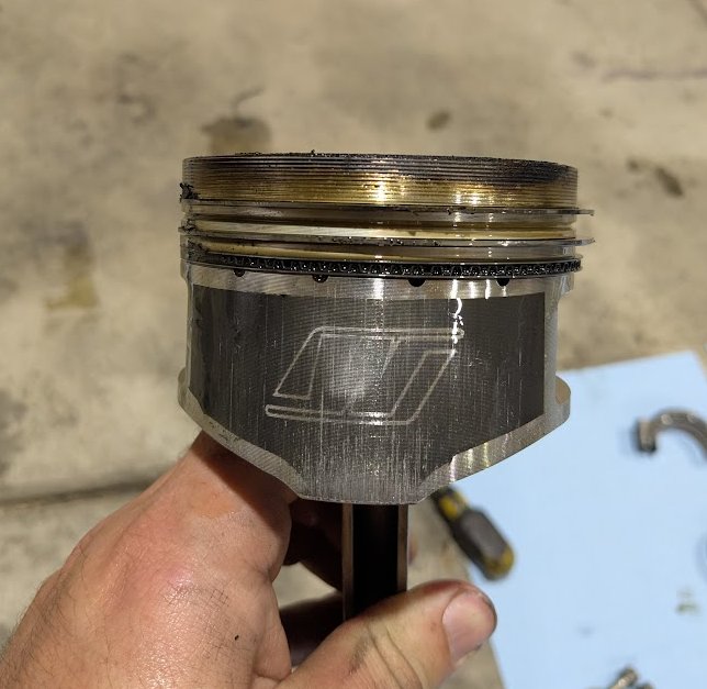

The skirt has matching wear marks as expected, but is pretty smooth actually.

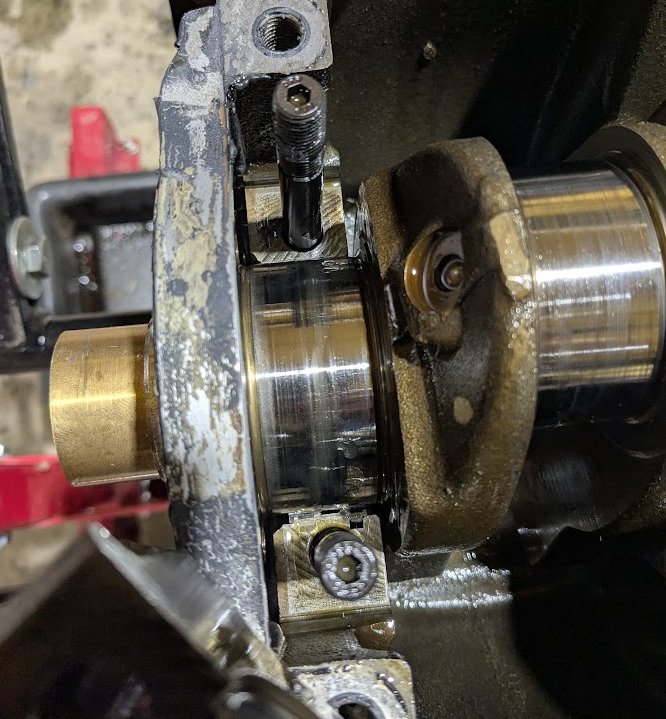

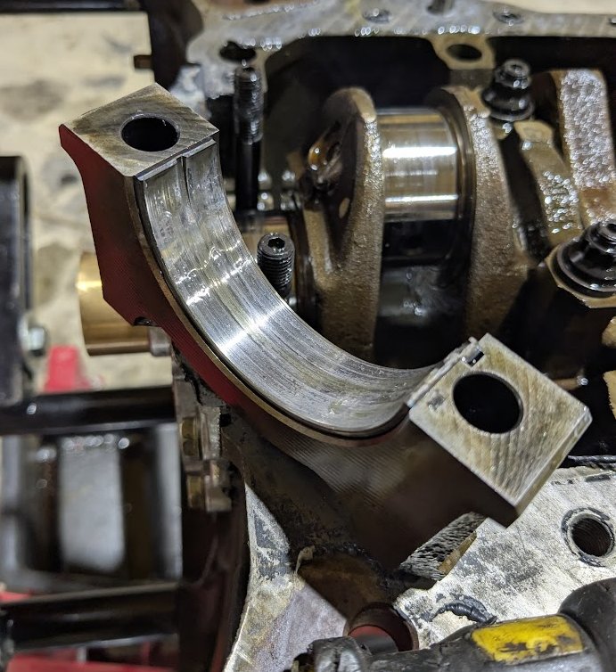

Let's check the mains.
Well that's not good!

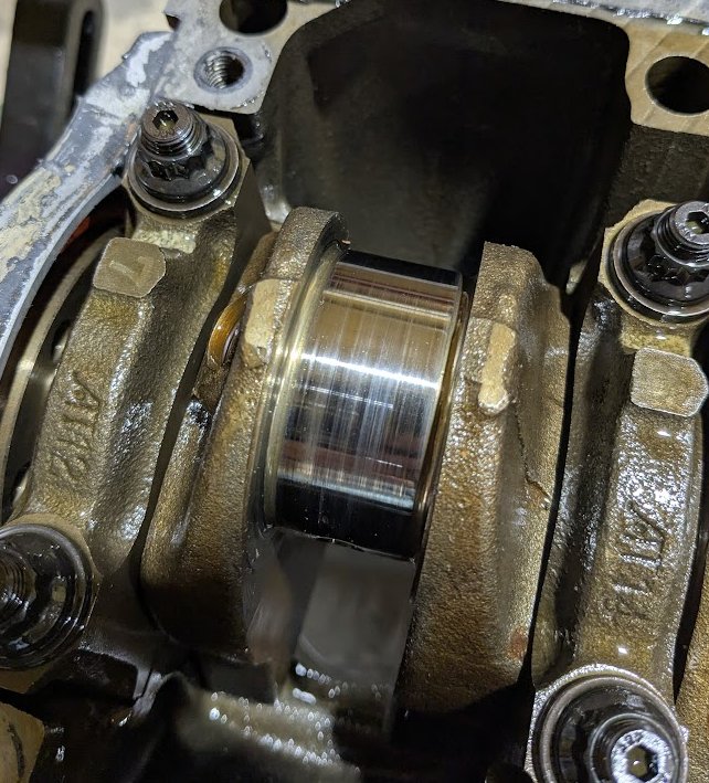

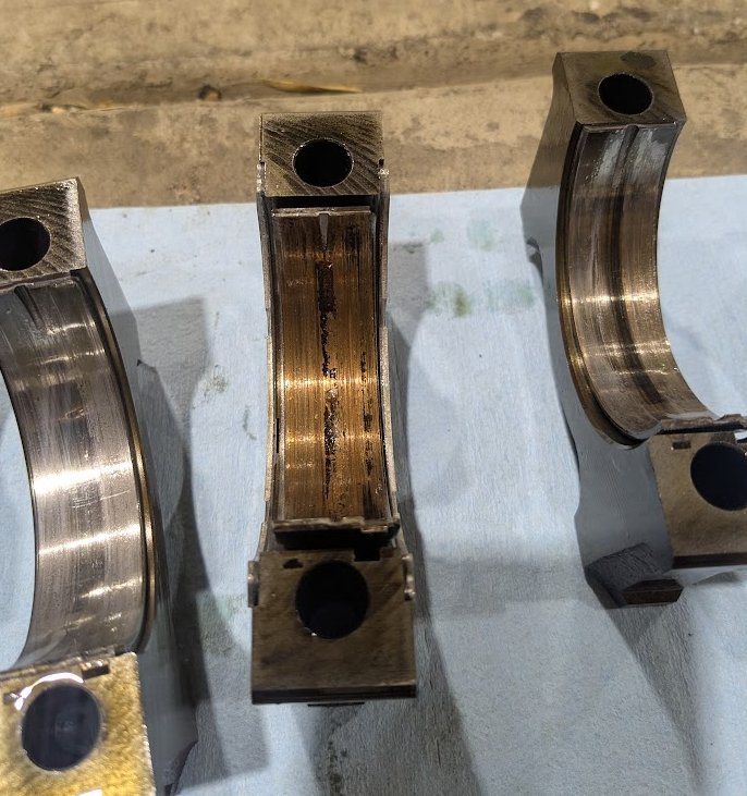

Those are all ridges you can feel and get a nail on the #7 main. It turns out all but the #4 (center) main is totally wiped. Here is #4

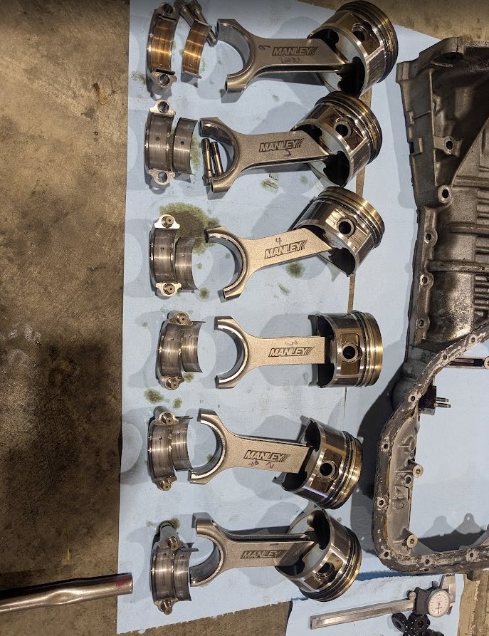

Pull the other pistons. The #6 was the ONLY one that was in good shape.

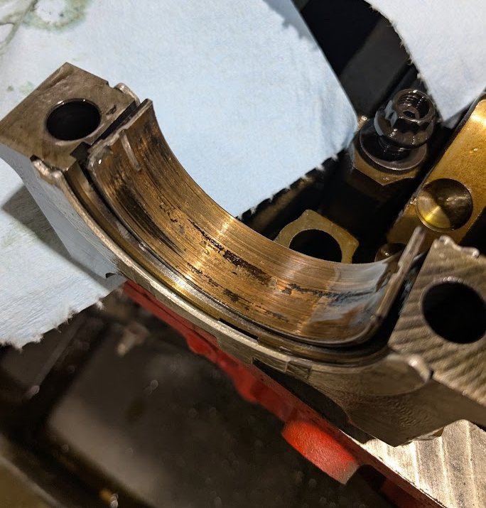

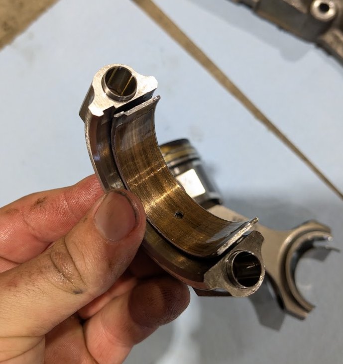

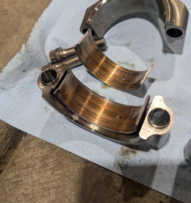

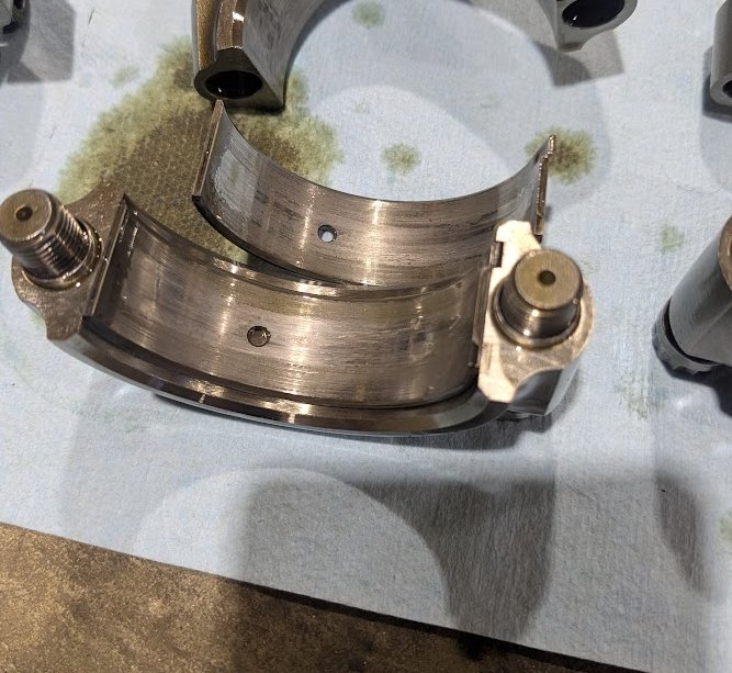

Here's how most of the rod bearings look, they aren't in "bad" shape as in they're nice and smooth, but all the top layer is gone.
And #6 for comparison, the cylinder that was causing the noise looks great by comparison?

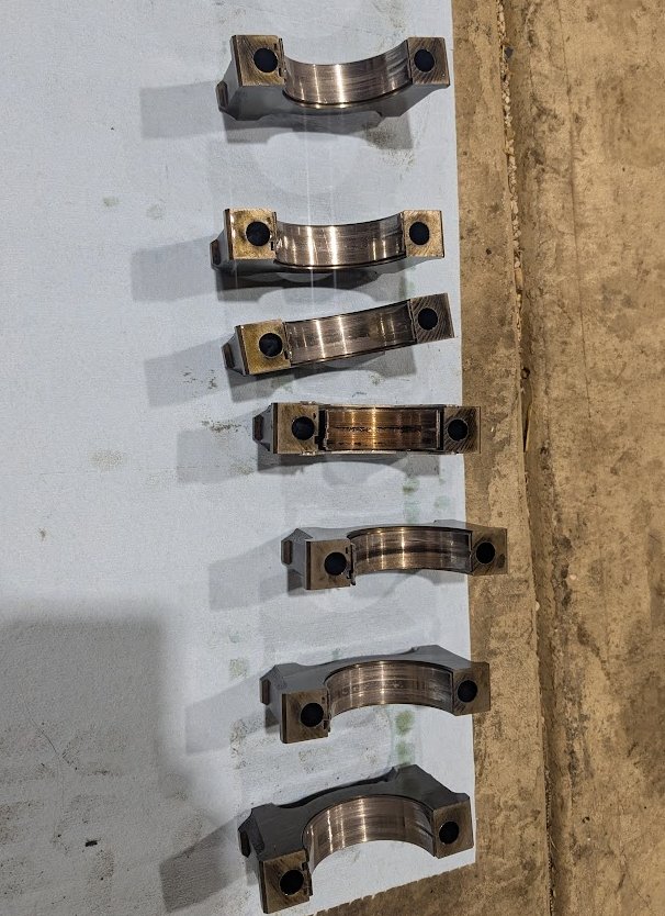

And then all the mains:
The mains are in bad shape, feel nasty and gritty and have crazy wear marks.

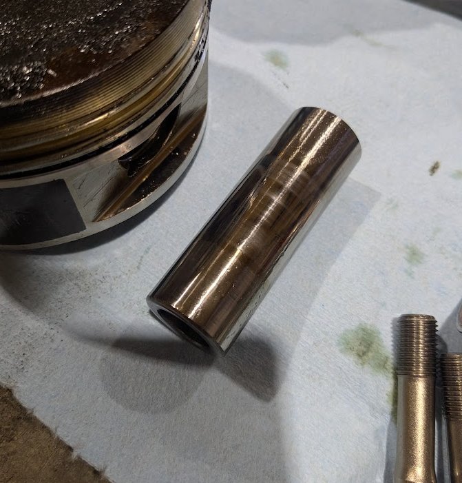

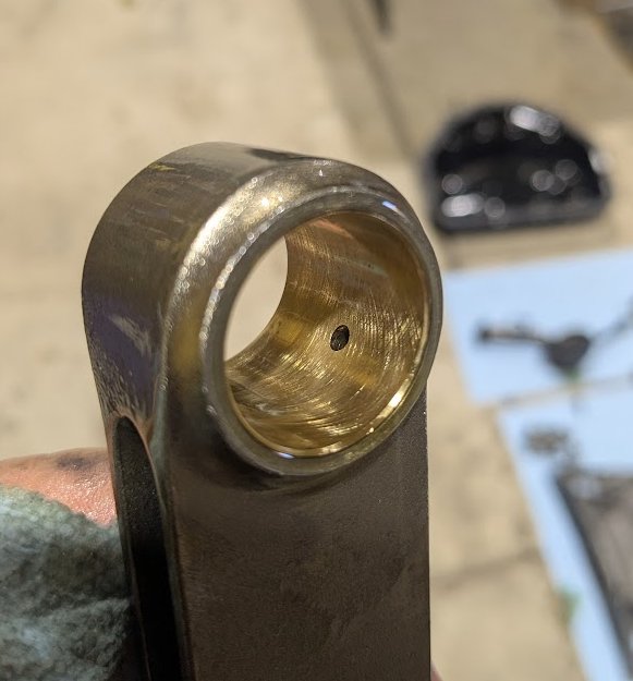

Back to #6 because it was causing noise. But the wrist pin, bushing, and piston journals are all tight feeling and look great.

I'm pretty stumped what's happening. There seems to be three or four issues at play:
1. Cam journals seemed to lack oil
2. Cylinders lacking lubrication on the walls?
3. Rod bearings wiped
4. Main bearings wiped
I'm going out on a limb but maybe the noise from #6 was really the crank flexing from the #7 main bearing being so beat up (it seems the worst of them all) since the #6 assembly seems the best out of everything.
As for the real issue, there seems to be an oil feed problem. What is weird about that is it not rearing its head until thousands of miles in, and I have low oil pressure safeties which will turn the engine off if the pressure drops below a value that's dependent on rpm. This engine has had low oil pressure since the start, but it was within stock spec, it was just much lower than the original stock engine. But once it gets above idle the oil pressure is like 40+ psi and up past 60psi at high rpm, and at idle it's around 18-20psi (but stock engine was 35-40psi for comparison).
What I'm going to do next is get some plastigauge and check the bearing clearances. After talking to my neighbor the theory is that the mains are too loose or tight, that blows them out, then the rods aren't getting enough oil and get blown out, and there isn't enough oil spraying out of the crank/rods to properly lubricate the cylinders. That doesn't explain the cams that seemed starved for oil... but the thought is that it's a brand new high flow oil pump, and the ecu thinks there's high oil pressure, but is there something happening down stream of the oil pressure sensor that is making the engine not get properly lubricated?
It's all very confusing and the more I tear into it the more questions and messed up stuff I find, and so far there's no smoking gun besides something happening with the oiling system.
While you've got apart rod out all of the oil passages? Physically verify that none of the passages are partially blocked or compromised, or that any plugs aren't leaking.
Does the oil pan have any baffles? Windage tray? Is there sufficient clearance between the pan and pickup? If you had no alarms for low oil pressure, I guess none of that's a problem. Just curious.
What oil do you run? Any chance it gets airated?

It's not baffled but it does have a windage tray. The pan has an upper section and then the actual sump hangs off that in the front and is where the dip stick goes. Lately I've been running Rotella-T6 15w-40, early on the engine seemed to make low oil pressure compared to the stock engine (but not outside the realm of "normal") so I bumped to the 15w-40 from 10w-30, and that isn't uncommon either for 2JZs from what I've read. I guess it could've gotten aerated, I don't know how one would conclusively know that though, it would seem like if it was aerated enough to cause issue the sensor would register that maybe?
The only thing outside the realm of normal that has occurred recently was setting up launch control and we did a bunch of pulls on the highway, but I have a hard time believing that did anything (and I don't remember when the noise specifically started so the two could be totally unrelated). But if doing 0-60 pulls dialing in launch control was causing issues, that's no different really than hard acceleration so I don't think the oil would've been sloshing around enough to make a difference.
With the sump at the front of the engine those hard launches may have been sloshing the oil and momentarily uncovering the pick-up. Once in a while may not be a problem, but a bunch in a row may have been.
This is a common issue in drag racing with front sump engines. If you can devise a baffle that acts like a diode, oil can flow into, but not out of the the rear of the sump (w/o resorting to hinged gate(s) because those always complicate things) I'd do it.
I built a KA24 pan to fit a 510 that used two over-lapping sets of 90° baffles arranged in a pair of diamonds to trap oil around the pick-up. The gaps at the tips let oil in under G loading, but they were short enough that normal flat-level oil level flowed over the tops of the baffles. It was crude, simple, and enough for the occasional hard corner that car would see.
If your sensors are working as designed, it sure would seem to eliminate an oil delivery problem yet it "looks" like a delivery problem. Could it be insufficient oil type for the current use/load? Or is more bearing clearance needed with more flow like the old school racers used? I think they did it for less rotating drag though??
