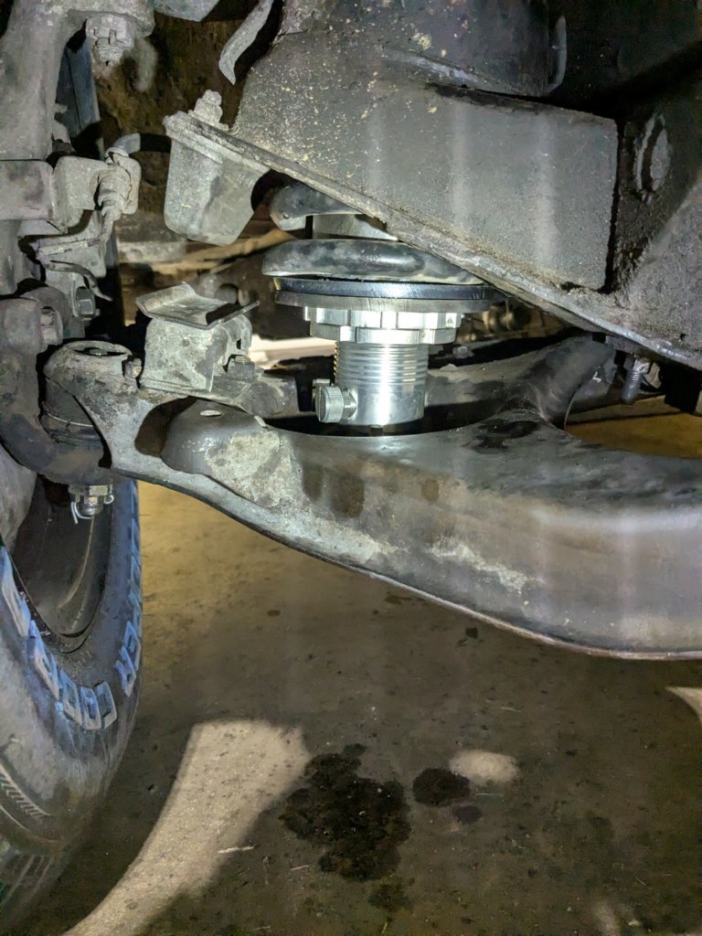

Passenger side shock I was worried about alignment in the coil bucket, from being tweaked it actually ended up lining up better!
I then did the same setup as the driver's side and adjusted the shocks and settled on this spot as rode height:

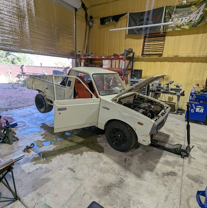

For maybe the first time ever I had to work on the truck without the lift. Ironically having a low vehicle makes jacking it up easier since it makes such a big height difference hahaha
The FJ is currently hogging the lift
Everything went in smoothly, then we bled the brakes, clutch, and cooling system. I did find one small leak on a coolant tube so pulled it off and sealed it with the welder then ran another pass over that stretch, otherwise no issues! Right now it has straight water while checking for leaks. Bleeding the cooling system is quite a bitch, this time it took the thermostat opening like two or three times of getting bubbles out and spilling s*** all over the floor.

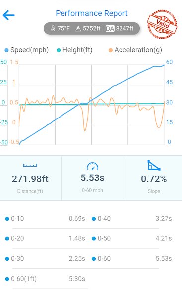

With that said, I do think the turbo is really holding it back. As you can see from the Dragy it's just not accelerating that hard, my Tundra's acceleration is around 0.5 Gs after it has gotten out of the holeshot and is tapering down, and the Hilux isn't getting over 0.5 G ever, which would kind of indicate a similar power to weight ratio I would think, and that would mean the Hilux is WAY low on power compared to what it could/should be. I think the turbo is just too small for big power---that's not necessarily a bad thing, because it's fun how fast it spools up---but in the future I think I will look at upgrading the turbo to something more suited for the 2JZ that maybe doesn't compromise the fast spool and can also not fall on its face as quickly.

And this seems visible in the dragy, we only did the two launches and they weren't great, but there's a few G spikes that are higher than we've gotten before. And this is without launch control or any boost at take off.
