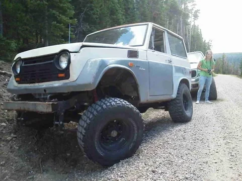

No, I'm not currently planning this on either of the current, but given another three months to ponder the '76 while reprocessing title paperwork, guess anything is possible....
Have seen a few pics floating around the web, but didn't save. Saw these yesterday, thought it actually looked very cool, and since I've little else to ponder but my navel, figured a logical discussion on "How to", simply for conversations sake, might ease the frustration felt on the current two Pigs.
Wonder if it'd even be possible to chop that much out of the frame, to maintain the OE body mount locations, or if it'd be a matter of relocating/rebuild frame mounts?
Know anything is possible, but what would be a logical (yeah, yeah, yeah....but a 70, I get that. We're just chatting) way to achieve?

looks like they just sectioned out the frame bit that was under the back seats....don't see why this couldn't work. BUT, where does you sleep when its rain?
Maybe the easy way to do it would be to chop out the center section of the body, frame and all, and then just rig them back together. The rear section may be a bit wider, but a strong cross member and some serious welding, and the rest of the pig would not know any different.

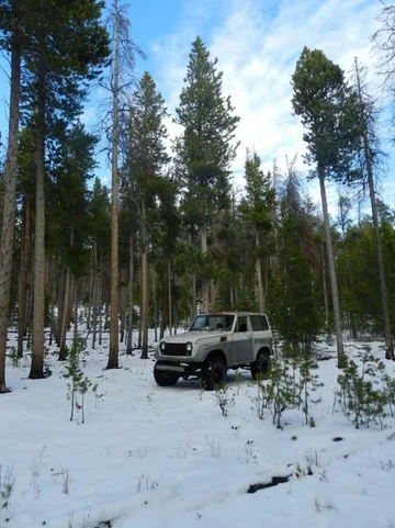

It's not necessary to chop the frame at all. Lots of folks ask me how much I took out of the wheelbase, but I didn't chop any frame except out back. The pig has a great wheelbase, just too much rear overhang.
The secret is thinking in sections not as whole chunks. You take 22" out of the bottom third between the wheel well and the tail lights. You take the same 22" out of the rear door just below the body line up to the roof line. And you take 22" out of the roof panel. Slide them all together and weld away. You don't want to cut it at the body line where it changes color because that's too hard to recreate, but you can visualize a horizontal cut there. Think of taking metal out of the rear below that line and out of the front above that line.
Mine is a little longer. I kept a bit more in the rear and that left space for the small windows from the rear door to fit behind the doors. I liked the way it looked and I look out of them a lot when wheeling.
Pics of the process in the Cerdito (little pig) link in my sig.
