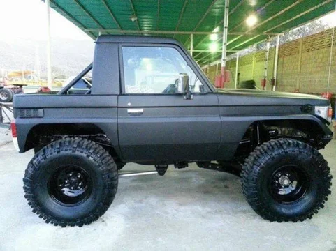

When I chopped the top off of the previous pig I left the section over the driver like a 4Runner. I like it way better than a true convertible.

this has always been my favorite chopped pig. but i like jamiesters ideas. i like the full rear door, angled top, longer wheelbase

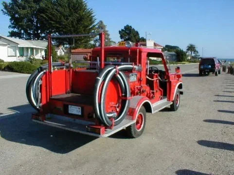

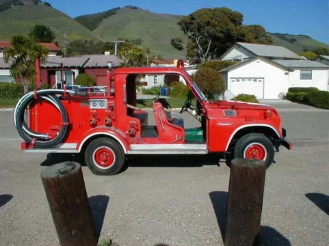

in post 34, love the look but so much easier just buying a FJ55 ex-fire truck from Japan and chop and mod the rear, most of the work is already done and they can be picked up dirt cheap ...
when they show up...

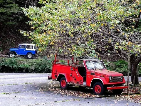

The whole RHD isn't appealing. Haha.
Interesting how they terminated the cab at the bed.
Might look cool for the crew cab truck to finish similarly.
Guessing the wheel bad of the 56 fire is the same, doesn't appear they had any issues with cantilevering the bed a ways past the axle.
I'd be interested to know if the pillars and roof supports are any stouter than a 55. Sure seems a long distance to span, unsupported, with what structural I've seen inside.
those have come up at action in Japan now and then VERY rare ... i almost bought one 5 or 6 years ago.
passed on it though.
def ex-military units, not for civilian use.

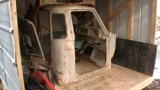

Couple questions...
First, would it be safe to assume that the bulkhead (??) is from another derivative of Cruiser on this?
Curious how one, whose self described as pignorant, could go about replicating the back of the cab, with a heavy emphasis on safety, but without caging.
Second, does this look like an earlier bed than the '80s?
This is claimed to be a 1980 and earliest bed I've found that appears similar.
Not that it matters, just curious.
