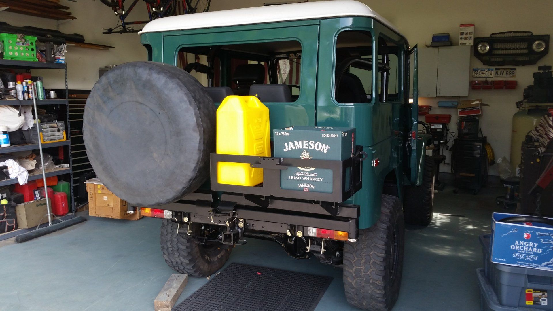

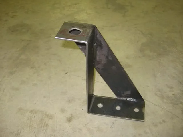

I cut off my cooler/gas can carrier and welded on a flange on the carrier. Now I can bolt the cooler carrier on or remove it. It's easier for people to get in the back without the cooler carrier, and I could make different attachments such as a folding step ladder or giant water tank for showers, or a mountain bike rack.
Hoping to get back on the trail soon and have been really interested in others peoples setup and what additions they’ve made or what they carry.
Anyone care to share what they’re carrying and post up pics?

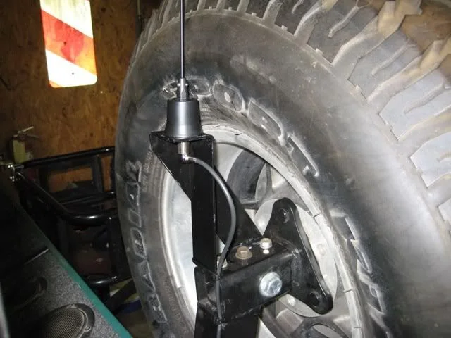

The only addition I've made to mine was to drill the pivot tubes and install a grease zerk in each one, before I installed it. Now I can grease the pivots without removing the swing arms.
Other than that, I just use it as-is:
Oh, and I almost forgot - I did build a 2M ham radio antenna mount to go on top of the tire carrier:

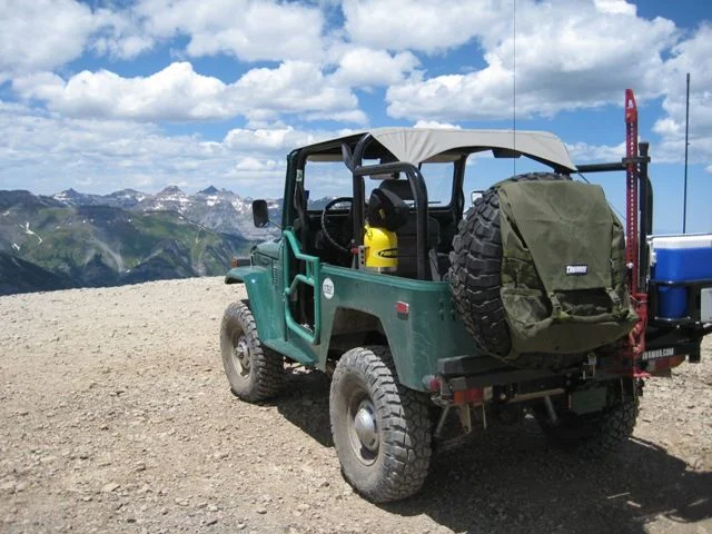

I’d love some info on this setup from Sackwear...

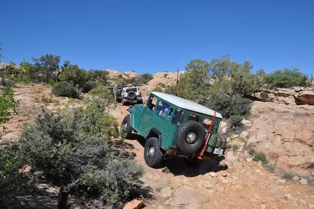

Personally, on my home built tire carrier, I run a Hi-Lift, two antenna's CB/HAM, license plate, spare tire... and because of my usage over the past 10 years, I'm contemplating a second swing out for keeping my ARB Fridge outside the rig, freeing up some interior space.
