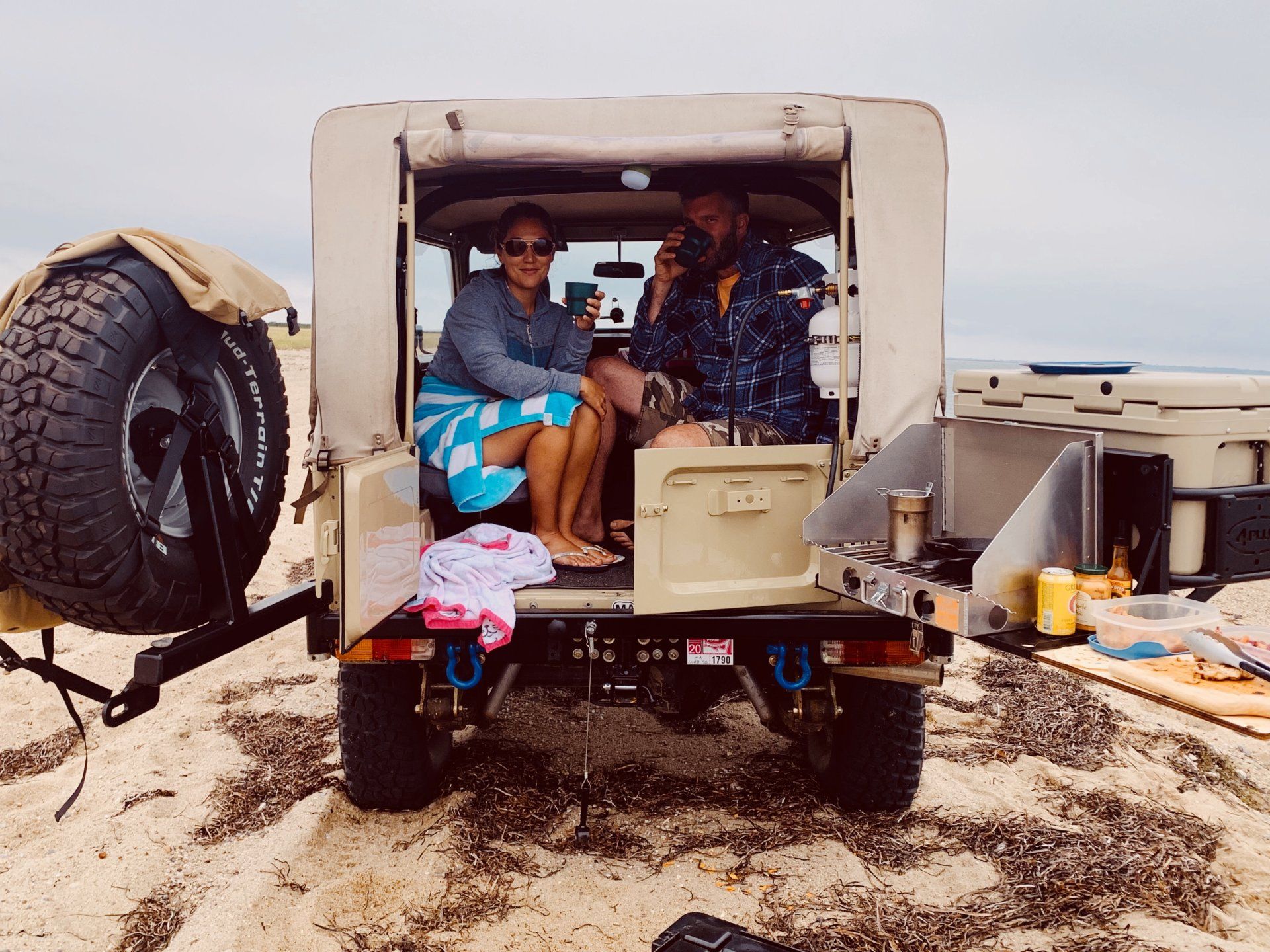

Current 4plus status...
Hello @77fj40JV. I need to know where I can get one of these security pins with the button on top. Can you tell what it’s called and where I can get one?
Nice truck :steer:
