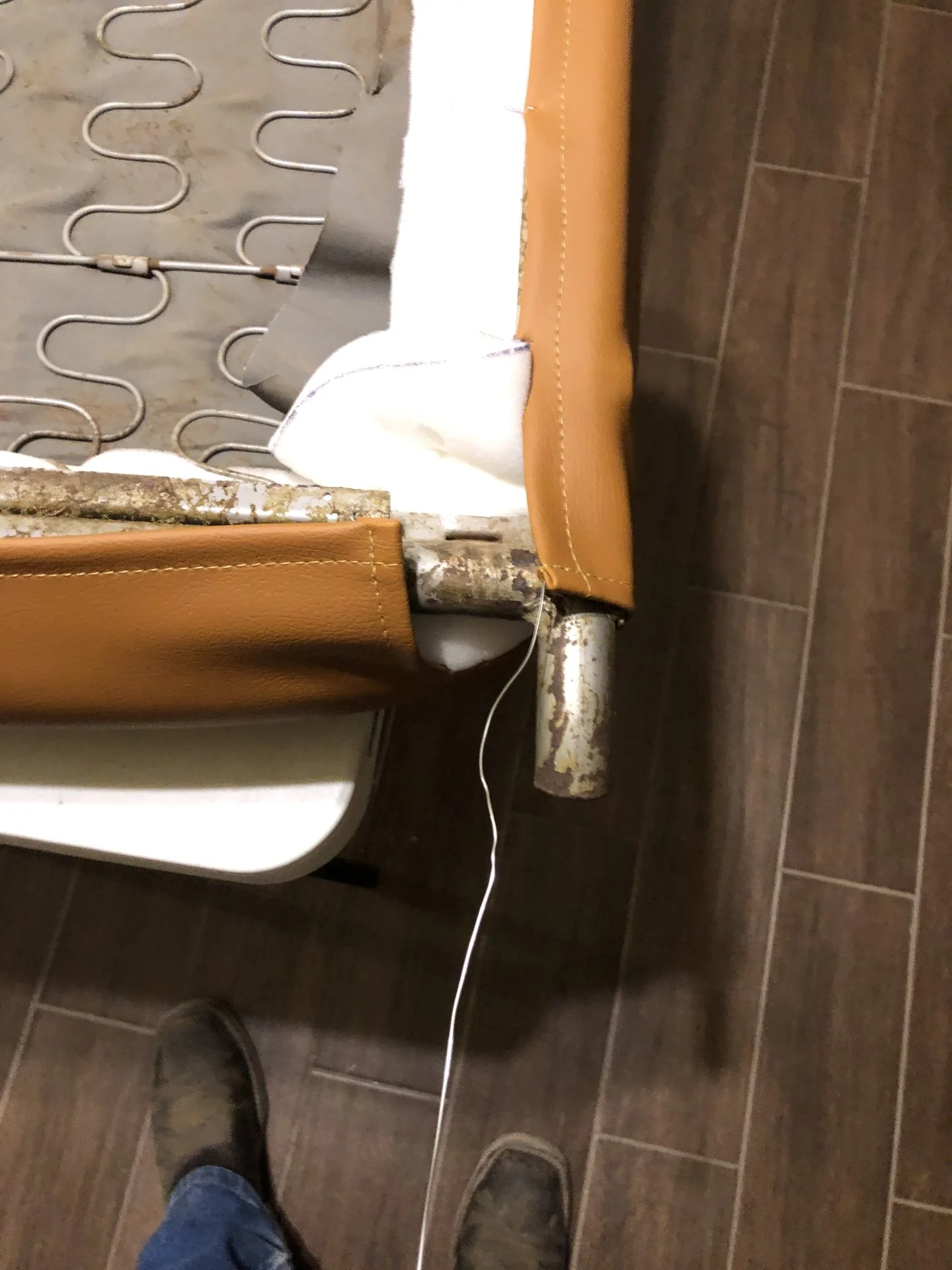

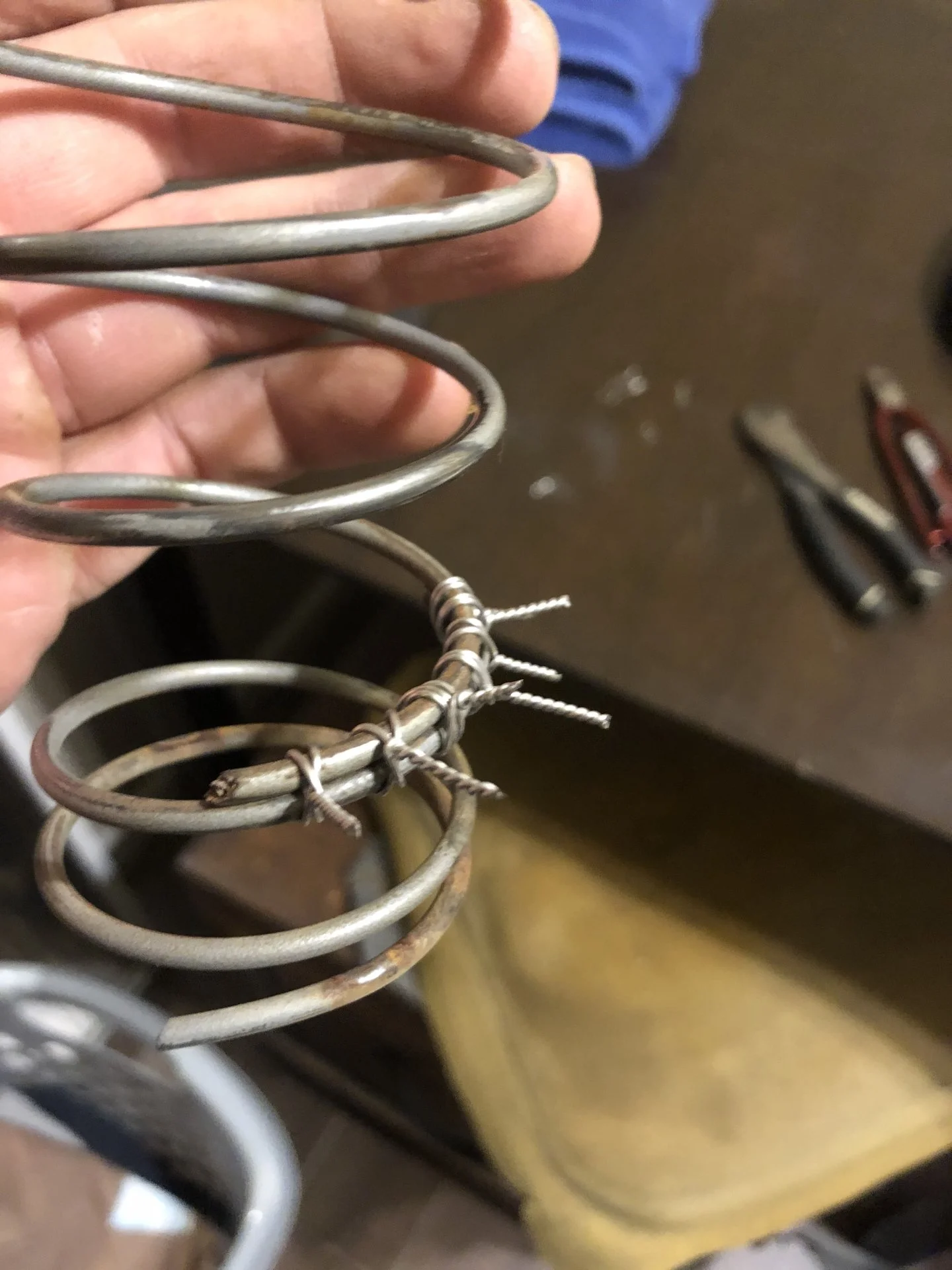

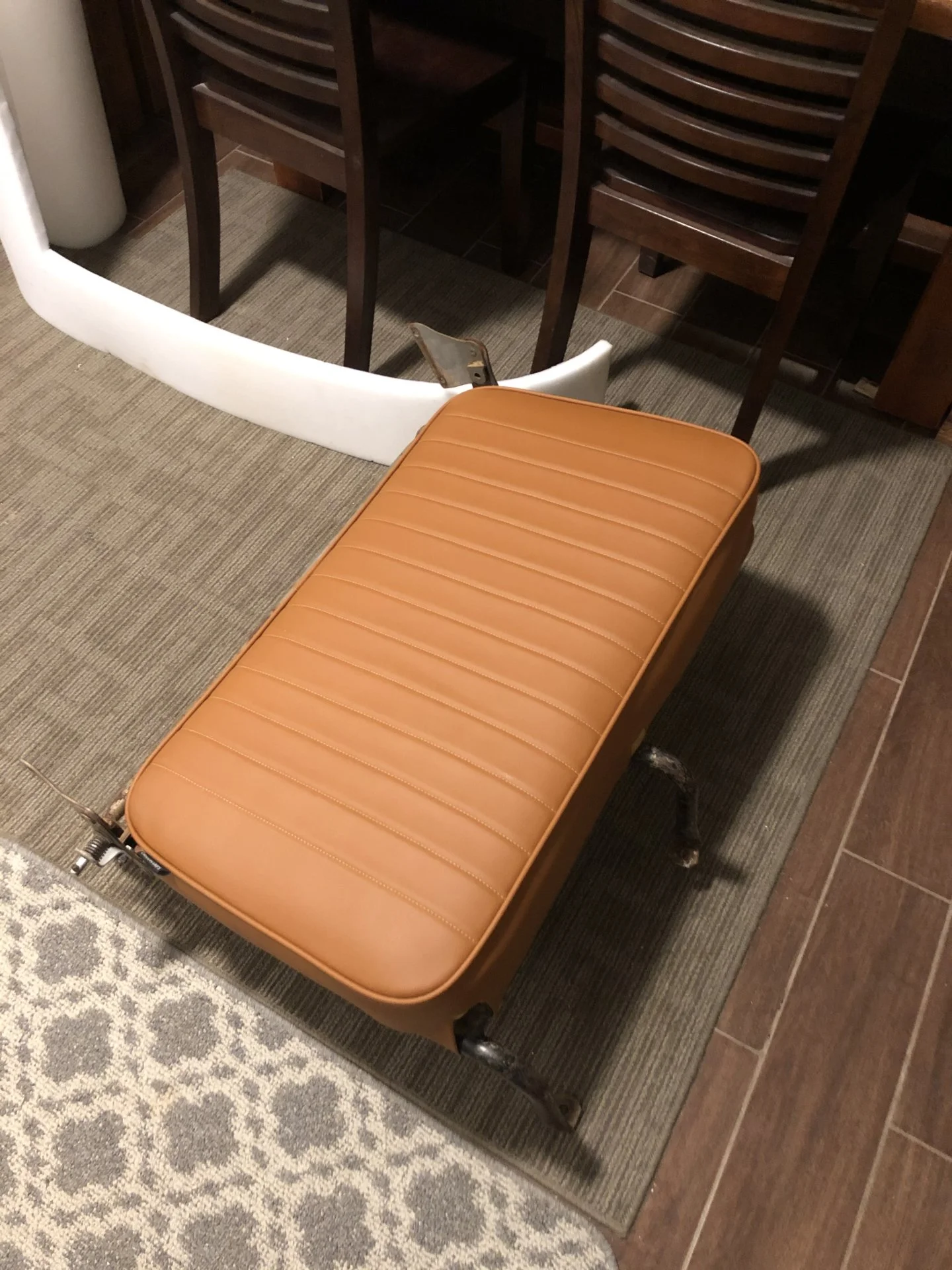

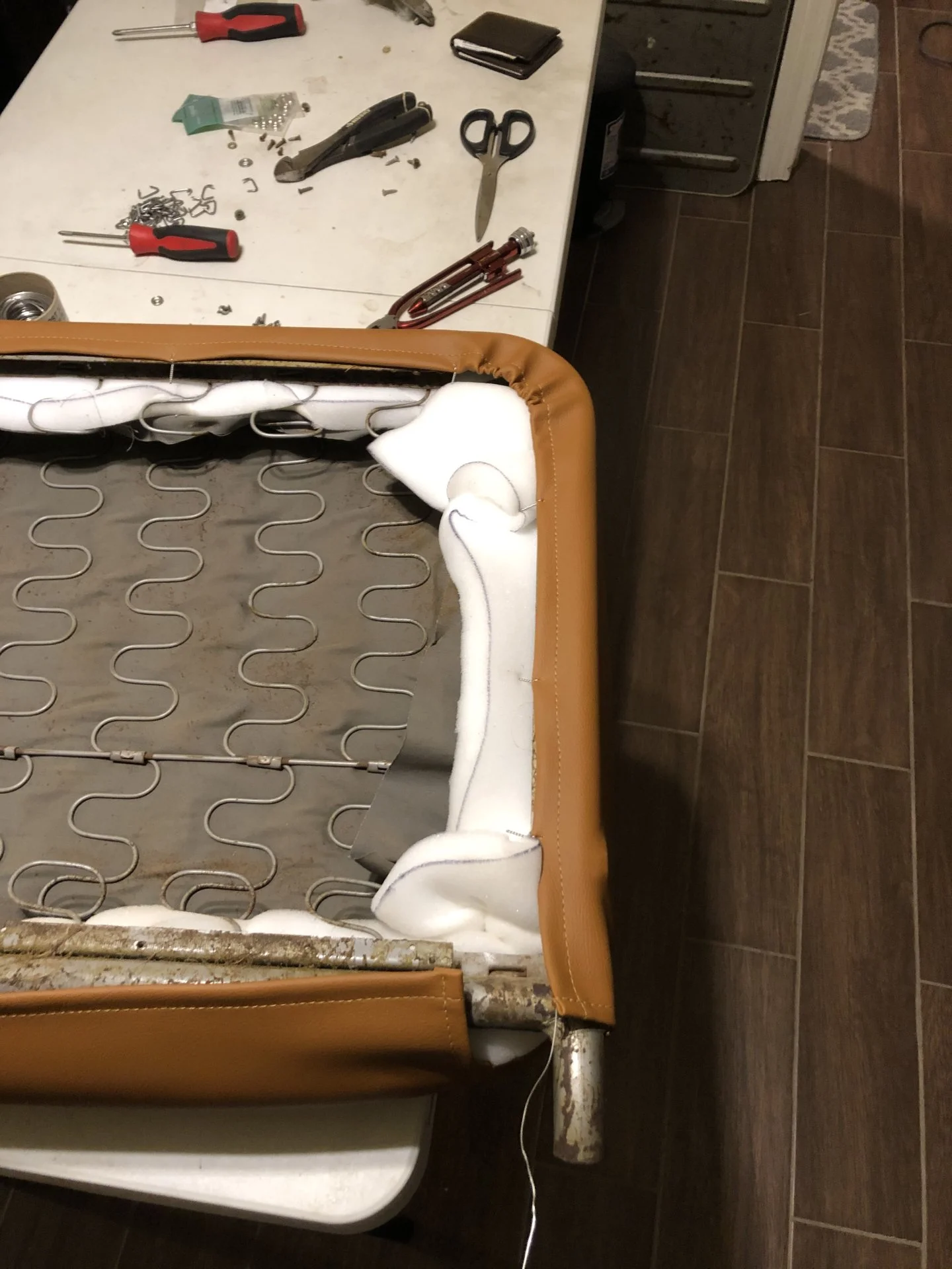

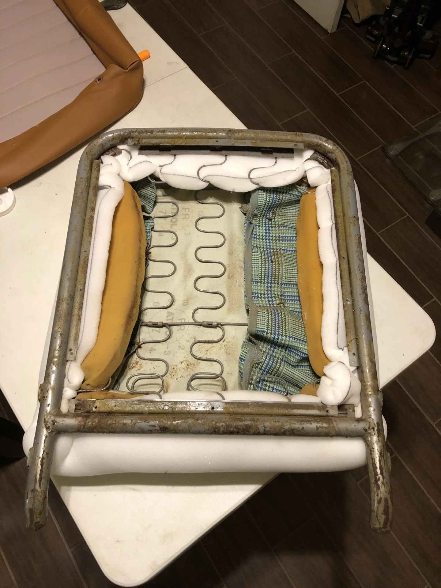

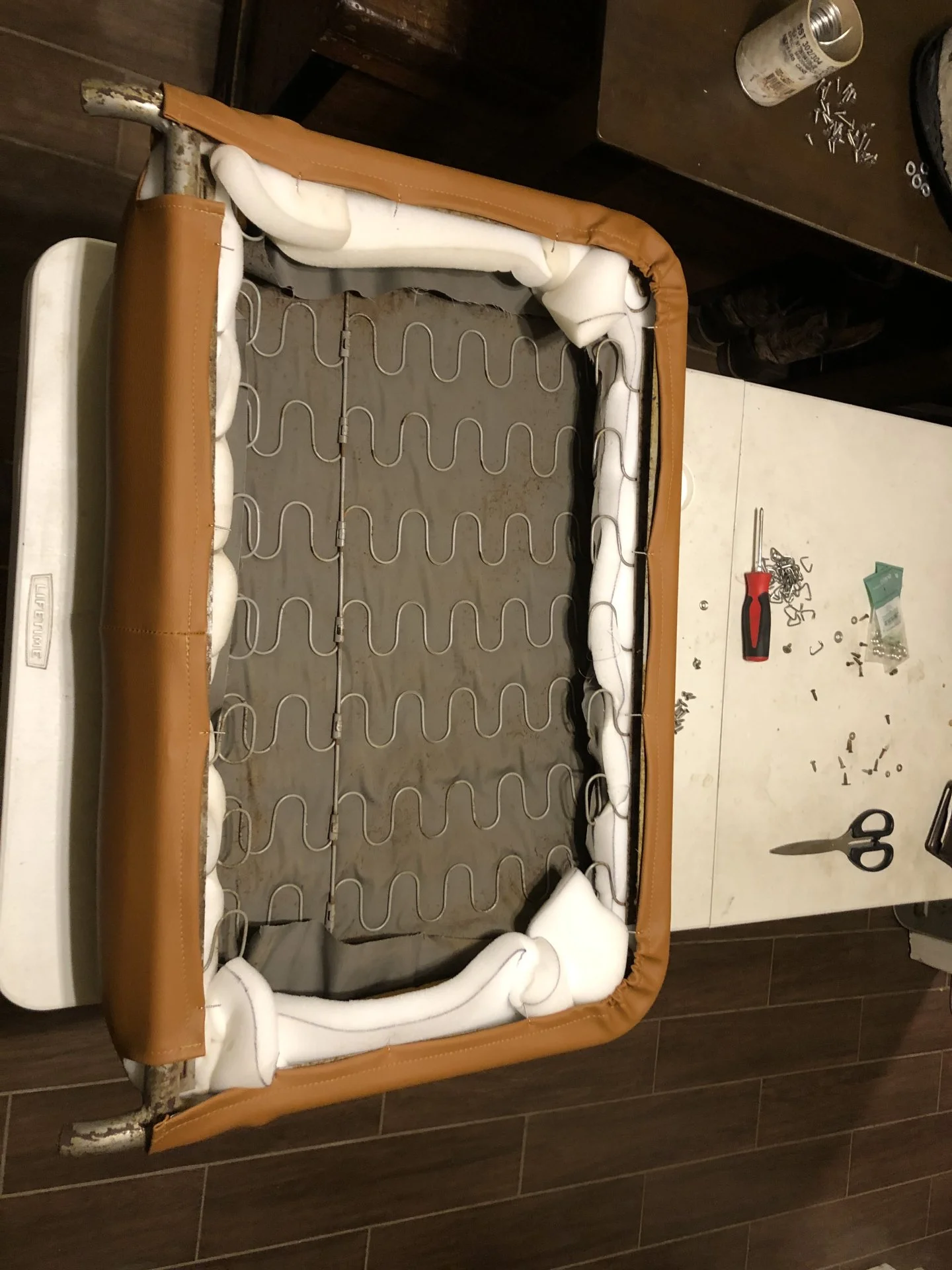

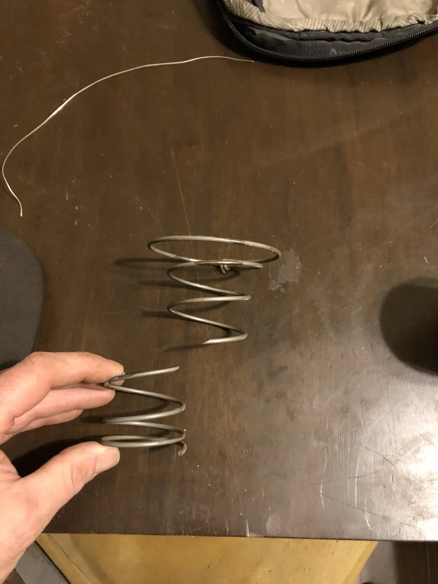

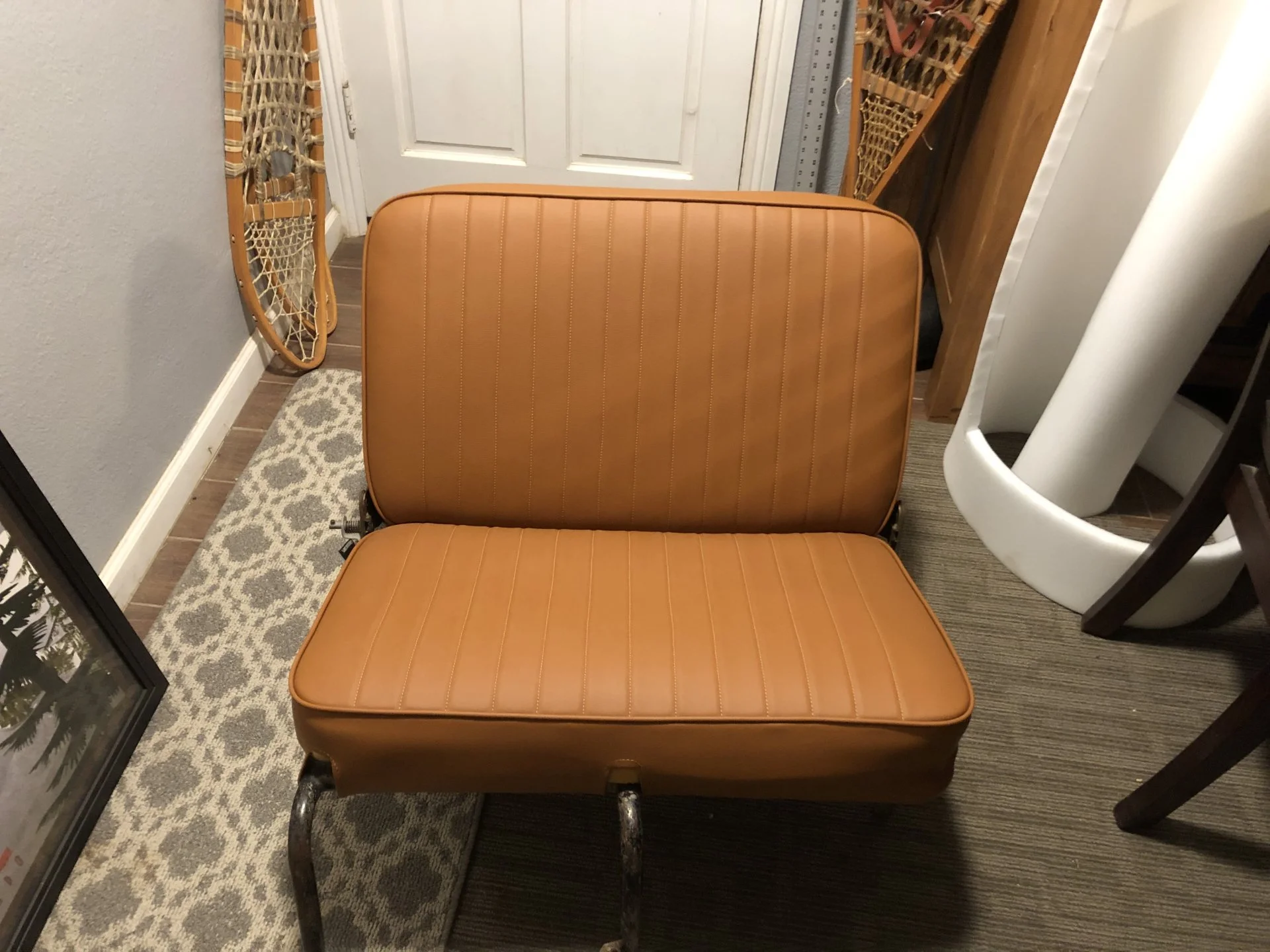

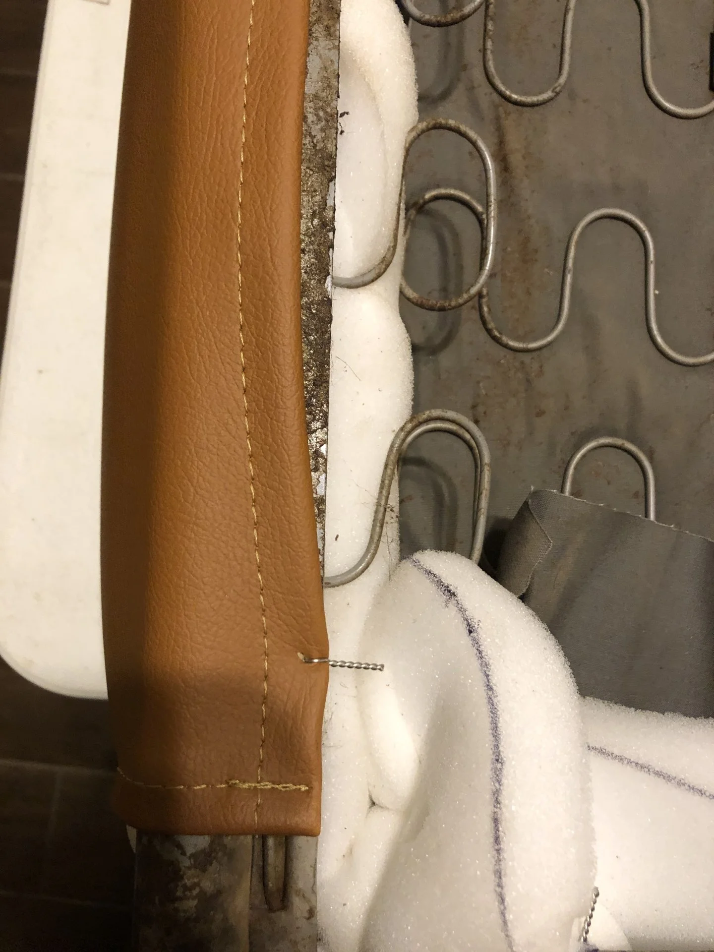

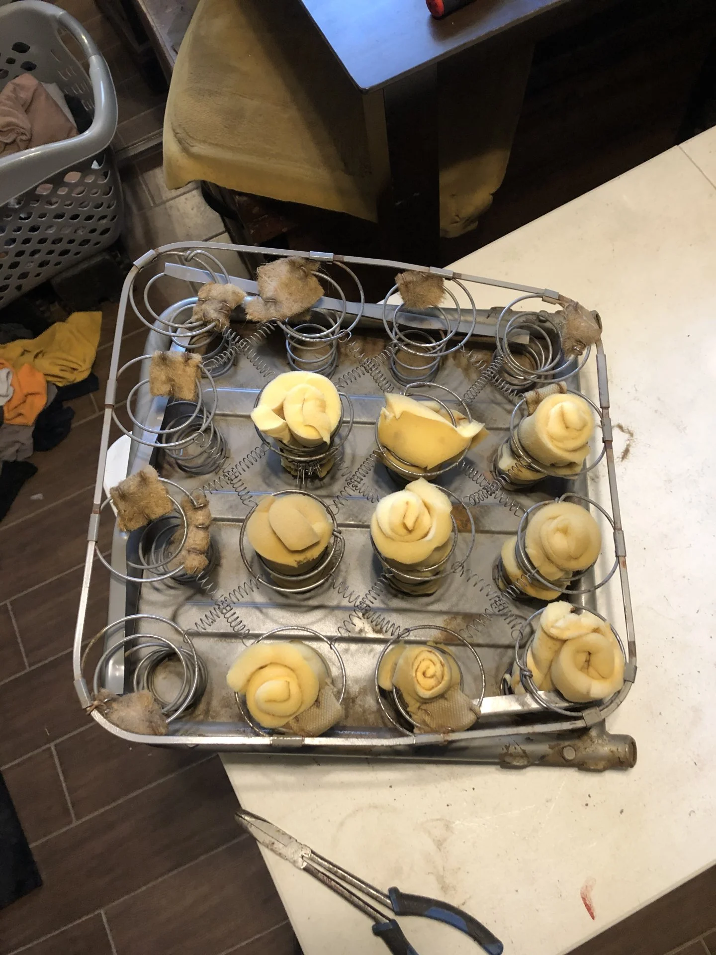

I just did Cruiser Corps covers on my 60/40 bench in my '69. I have the jump seat covers but havent made time to do those yet. I would call it a 2 bananna job, pretty straight forward and easy. Your seat should have springs, the padding is about 1.5-2" foam that you can buy at Jo-Ann Fabrics. I ended up re-using the existing foam (not factory, it was from a previous seat rebuild) and then put a new 3/4" piece of foam over the old stuff. I also put poly-fill fiber inside all of the spring cavity, and some old foam rolled up into the springs themselves. I found the springs to be far too bouncy & soft without the polyfill. I used 4 bags for the 60 seat base and 2 bags for the 40 seat base. If I did it again, I would go with 3 and 1.5, they are just a bit too firm now. One key is using some kind of wire through the cover surround that won't let the screws pull through the fabric when you stretch it. I'm bad at taking detailed step by step photos, here are a bunch:

WOW.... NICE!!! THAT'S WHAT I WANT!!! I'd like to clean up my seat frames though

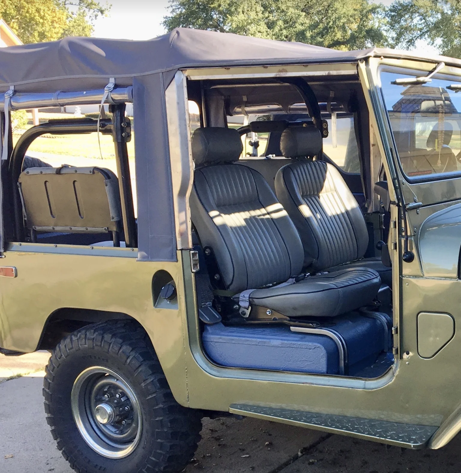

An upholstery shop will have an almost infinite number of color and texture options to choose from, including the welt material, whereas with a vendor you get what they got and that’s it. I had mine done to match my soft top in light gray with black welt.
