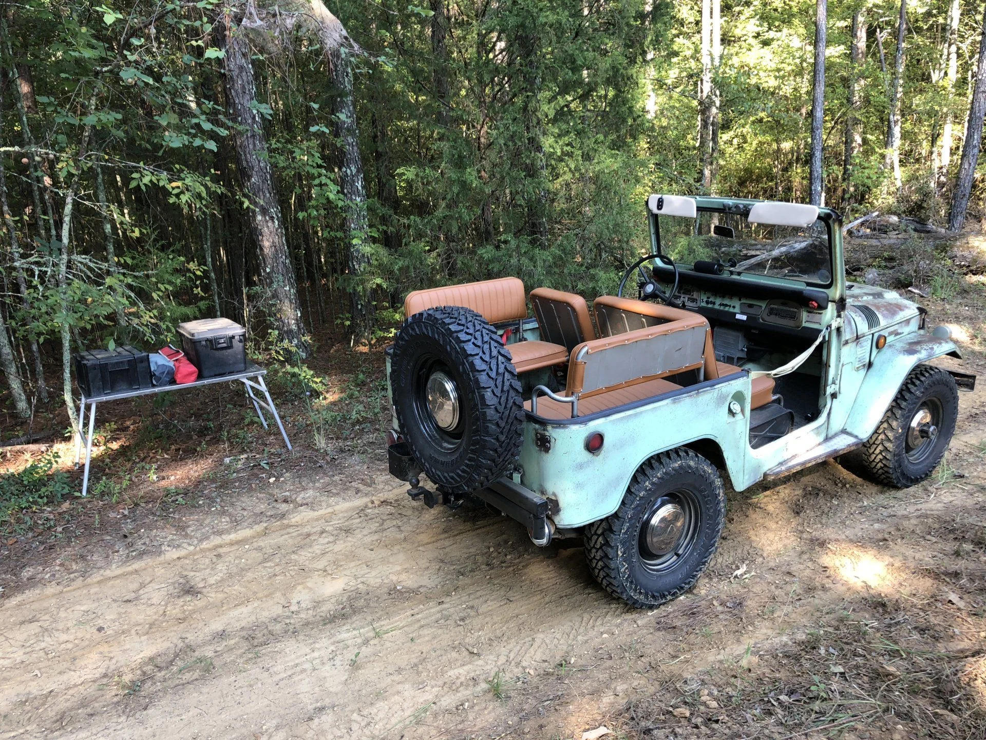

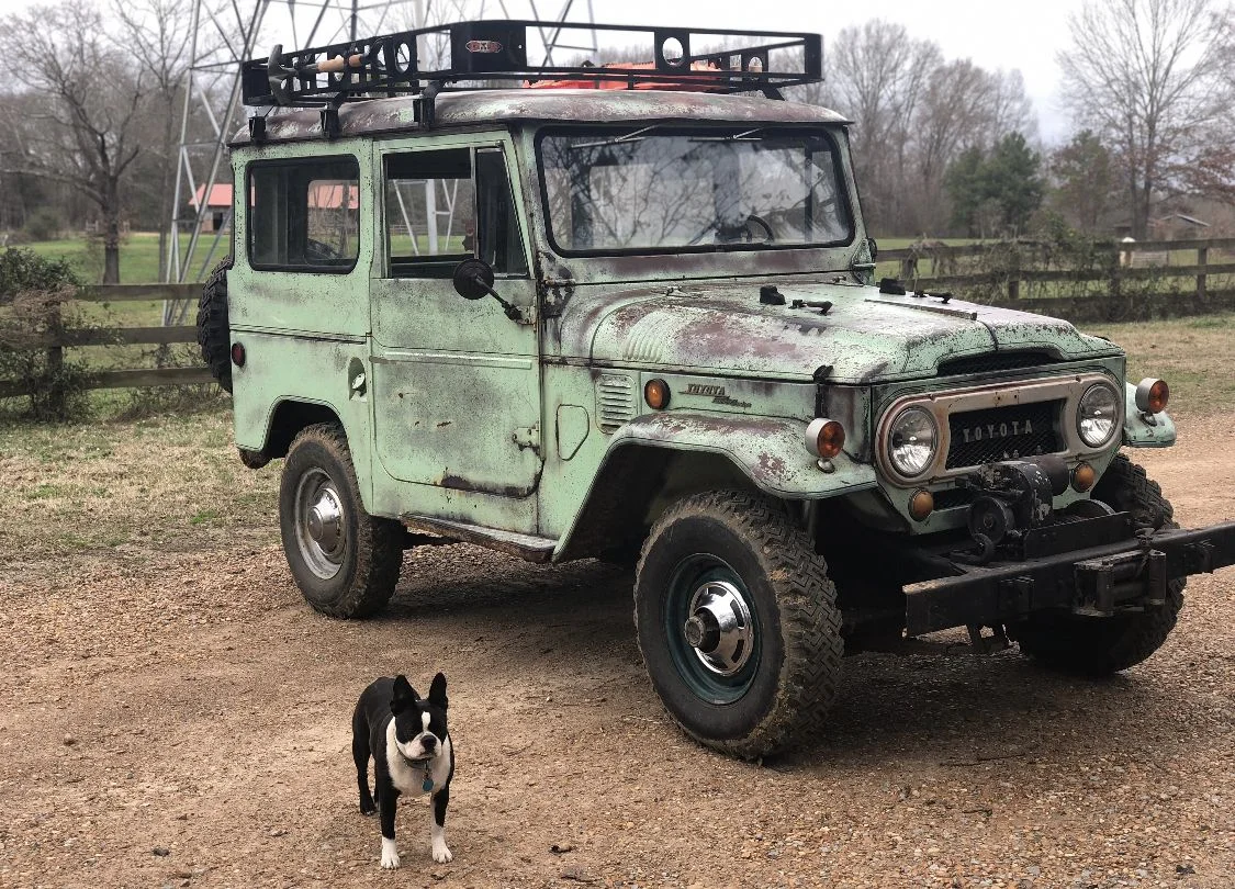

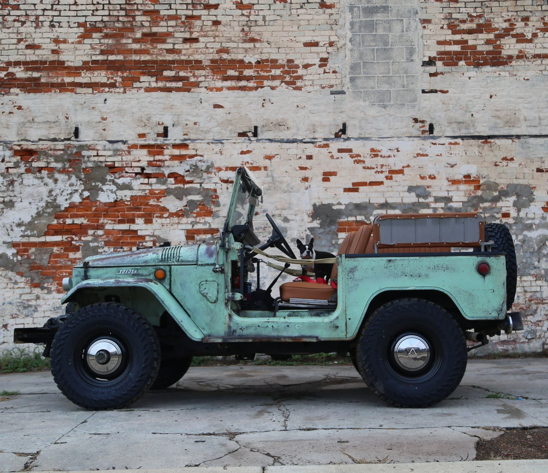

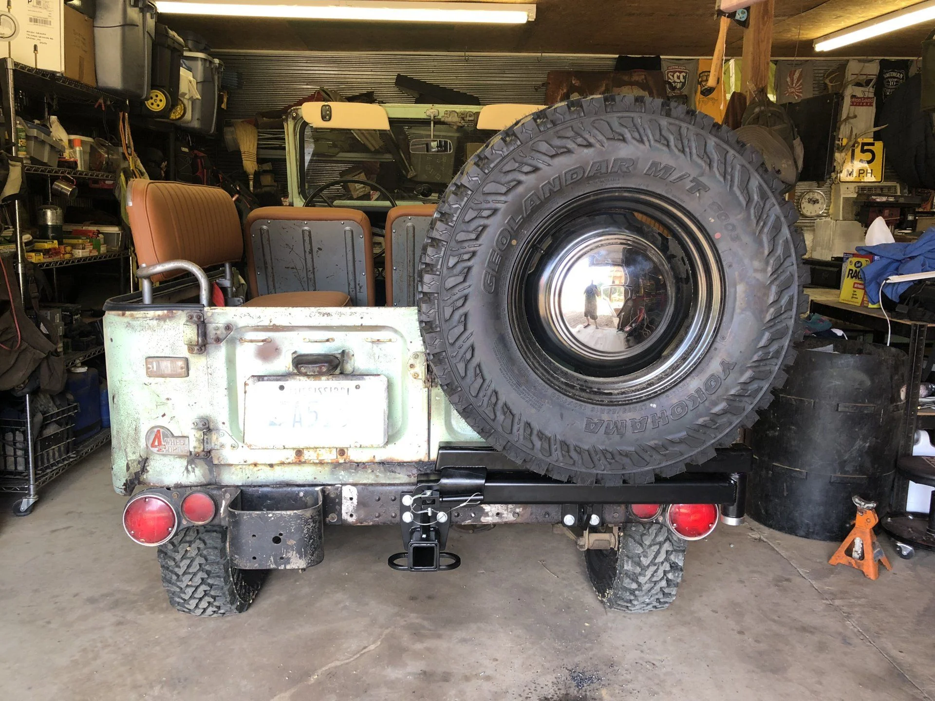

Pics for height. Tires are 235/85-16 that measure out about 32/9.50
