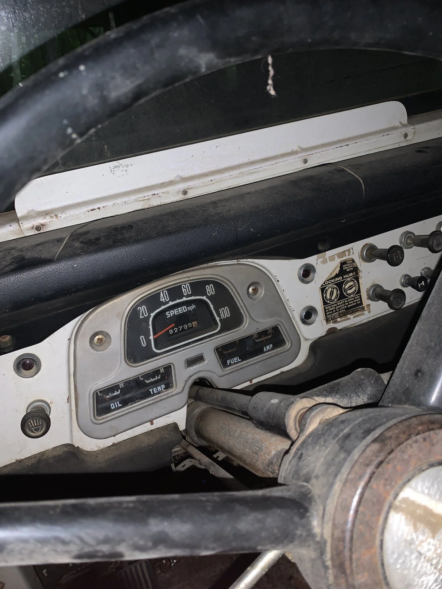

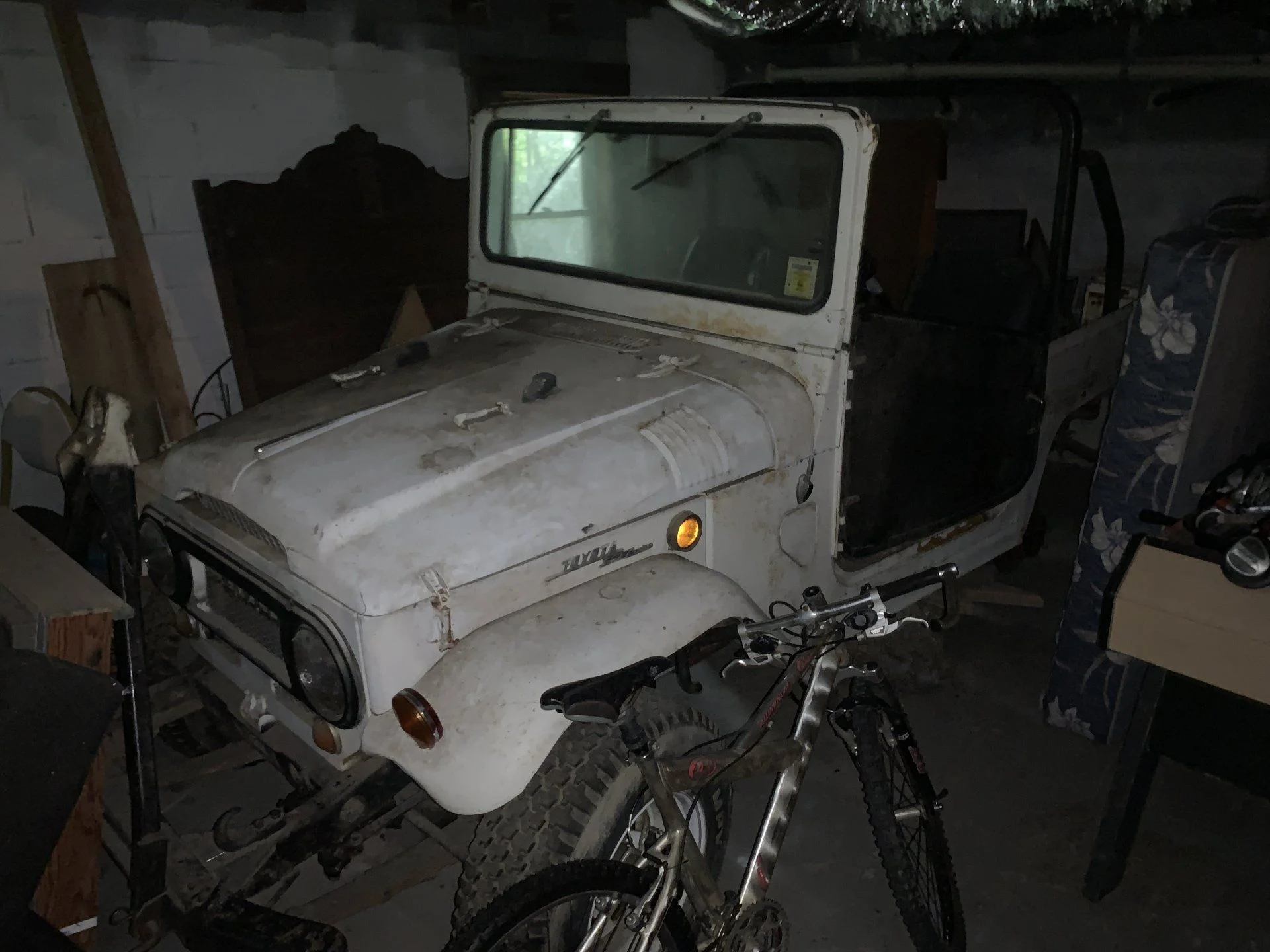

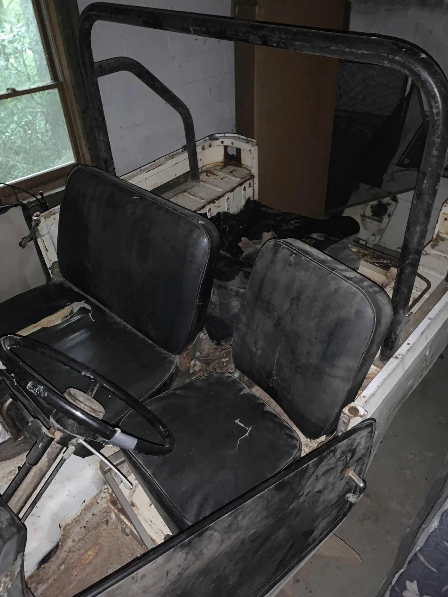

Hey everyone! Long story short I'm at app state, and was at a buddies house that he and his friends are renting in Boone, and they tell me they have an old land cruiser in the garage under the house. I go down there to find a 40 series that looks pretty rough and has apparently been sitting there for the past 18 years (the last year it was registered was in '02). They said I could probably buy it for like 500-1000 dollars, potentially cheaper if the owner knows I want to fix it up. Anyways, I'll attach some pictures of it and I'd love to know if it's worth my time. Ideally, I'd love to fix it up myself over the next few years.
Oh definitely if you can get it at that price. Get it running and safe and beat the hell out of it :)
Heck yeah. Looks like late 60s truck. Appears to be bone stock, so no real surprises. Looks like an awesome project.
Buy buy buy. Mothball it till you graduate if you have to, but buy it.

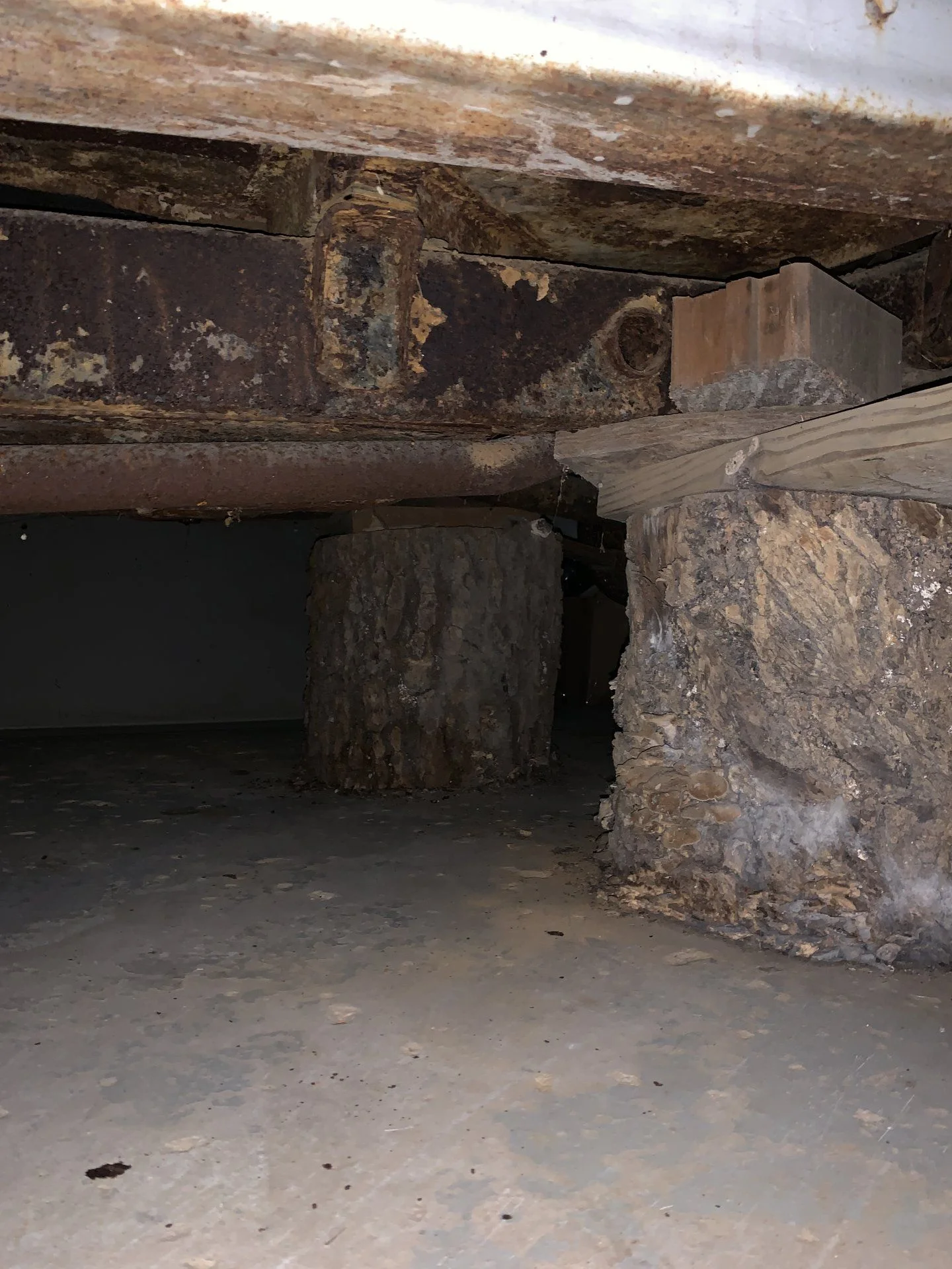

Will it be worth putting money into to get it run with all the rust it has? The actual body doesn't look terrible but the frame is pretty rusted as the pictures show. Does anyone have a ballpark estimate of how much it would cost to get something like this on the road?
Assuming the engine isn't locked up and all it needs is soft parts (hoses, belts, tires, brake lines, fluids, carb rebuild) $1,500 in addition to your purchase price would get you riding down the road in relative safety and reliability. Of course that is if YOU do the work and not a shop. Pressure wash it, remove the tank and have it cleaned (if it needs it). Coat the rust with Penetrol or Fluid Film, embrace the "patina" and call it good.

$1,500 on parts is on the conservative side, but it is possible. To stay under that, you'll have to be laser focused on ONLY doing what has to be done to get it driveable. It's the "might-as-wells" that kill the budget. For example, that truck has a single circuit brake master cylinder and hard to find 9mm brake fittings. It is not an ideal setup. If you end up trying to change the brakes to a dual circuit and if you wring off a rusty brake fitting, you'll spend more. Same with things like the gas tank. If it is crusty and leaking, you'll spend $300 on a repair or $500 on another tank. Head gasket? Who knows? There are folks who are specifically looking for these early trucks (not me, thank God). As folks have said, buy it cheap and either sit on it or put just the bare minimum into it and see how it goes. If it gets outside of your comfort zone, sell it.
