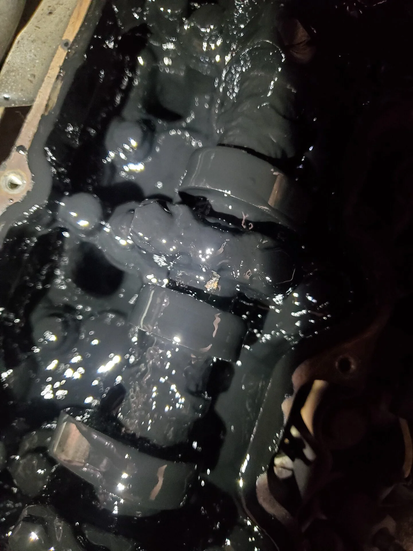

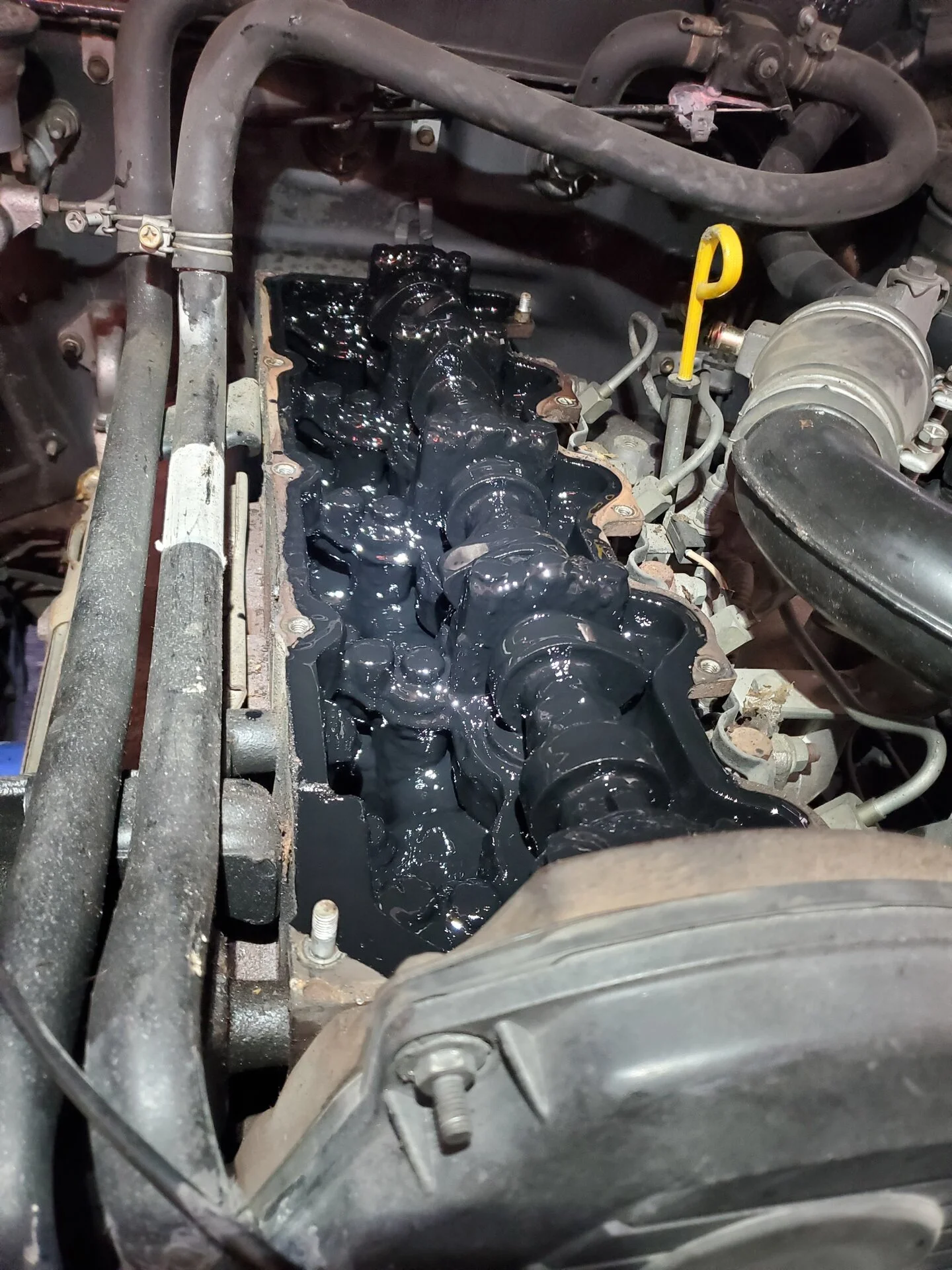

Motor sludged up horribly. Worst I've seen. I haven't had the valve covers off this truck since I bought it, but last oil change was approx 3500 miles ago. Only about 120,000 km on the odometer.
Anyway it began making noise this weekend promoting me to investigate. The noise initially sounded like normal cold start and progressed to knocking/vibrating. I pulled my sump pan and valve covers, and everything looked tight. Went through the pan with a magnet, no metal bits to be found.
Flushed the gunk a few times with oil flush til top end looked clean, refilled with amsoil diesel 15w-40.

and seriosly, what the hell happened to the oil OMG, is that water/oil/coolant contamination? never seen anything like that
No oil contamination that I can tell. Never been into the top end since purchase (this summer), so I can only assume I inherited that sludge.
What it reminds me of is when my buddy ran normal 5w30 in his Ford. Kinda had a similar look, wouldn't flow out of the pan etc. Who knows what happened to the hilux but it was probably on the other side of the pond.

Looks like someone put 7 litres of moly bearing grease into that motor instead of proper engine oil. Crazy, usually sludge doesn't look like that.
I can't imagine how hard it would be for the oil pump to pick that up and push it through the motor to the bearings. So I would agree with the above that thrust bearings and likely others are pretty hurting.
Maybe consider a rebuild before things get worse? It's possible block/head/crank/cam etc. are still ok, and it just needs new bearings throughout.
