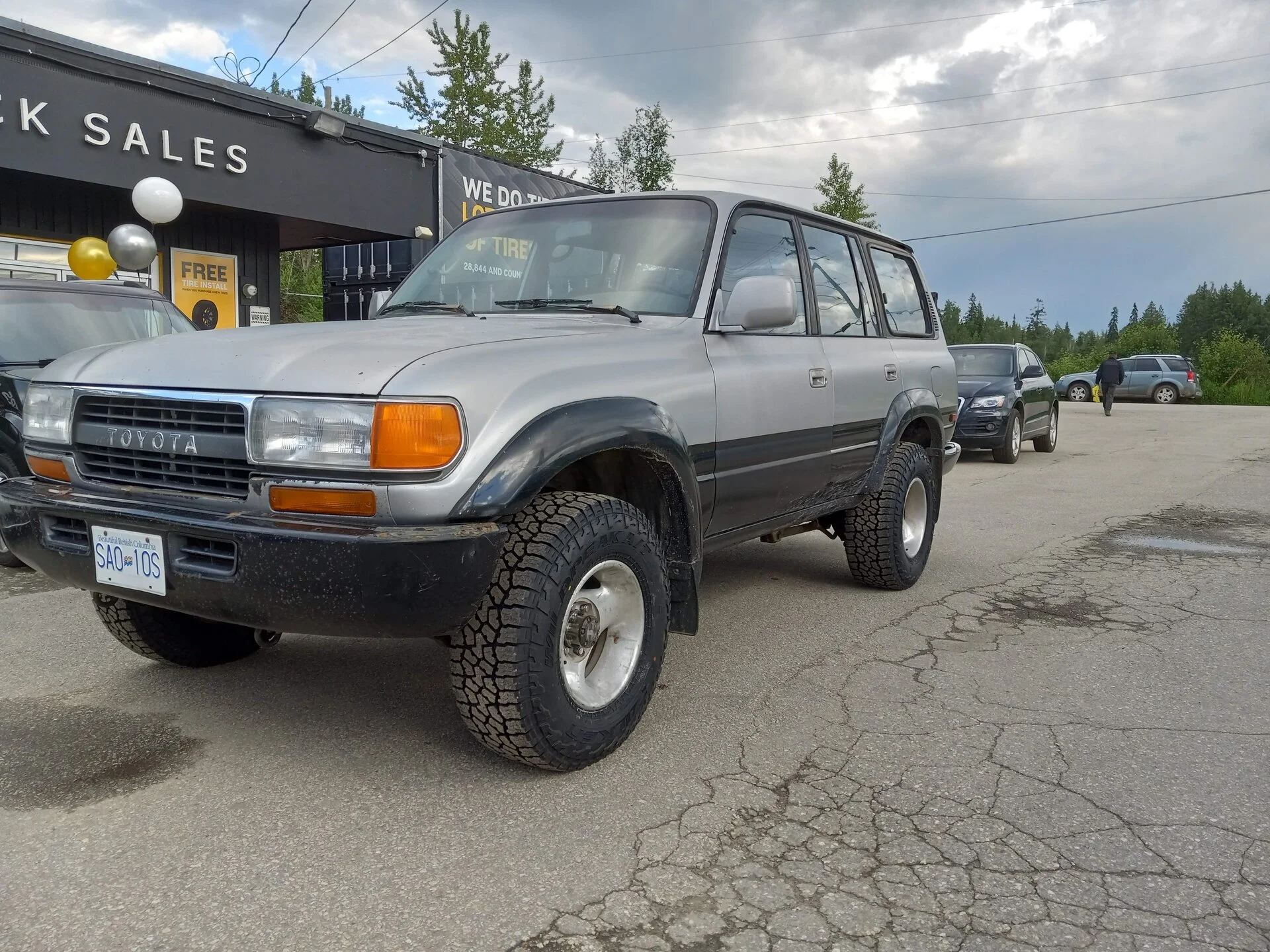

Hey all!
Hoping for some 3B guru input here. New to the forum and new to diesels so any advice is welcome!
My daily is a US-spec ‘91 FJ80 which the PO swapped the drivetrain from a 1983 60 series into, so H55 and NA 3B. It was a stalled conversion and sat for 10+ years unfinished before we got it back on the road last spring. The goal has always been a turbo conversion which I have most of the pieces for, but I’m trying to get it dialed naturally aspirated and understand the mechanics of it before I slap a turbo on it.
Just recently we changed our exhaust from the manifold back to 2 1/4 side exit and installed a pyro just below the manifold. Fuel has not been monkeyed with yet as far as I know(safety wire is still installed). Currently I’m seeing an average of 8-1000F on somewhat level ground at 100-110kph, and the more concerning part, 1350F pulling steep grades in 4th with the throttle buried. I almost never notice any smoke at all from the tailpipe. Temps never climb past halfway on the gauge even crawling around in summer heat.
For reference, again, it’s a stock 3B, factory fuel setting, linear pump, H55, locking hubs, and running 31s.
What I can’t understand is how I can have such high egts with no modifications and no smoke. I live in a very hilly area so it’s working hard for a good majority of the time, and I’m not comfortable driving every day pulling hills above 1300F. I would like to increase the full to have a whisper of smoke under load, but I don’t dare touch it with my current temps.
Any input is appreciated!
