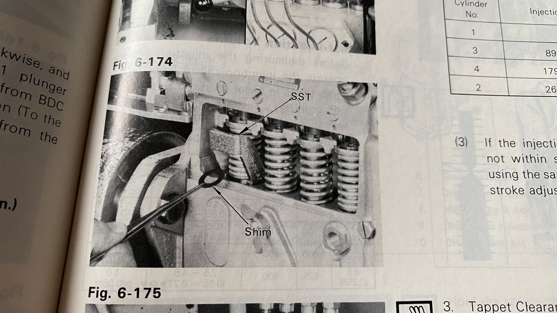

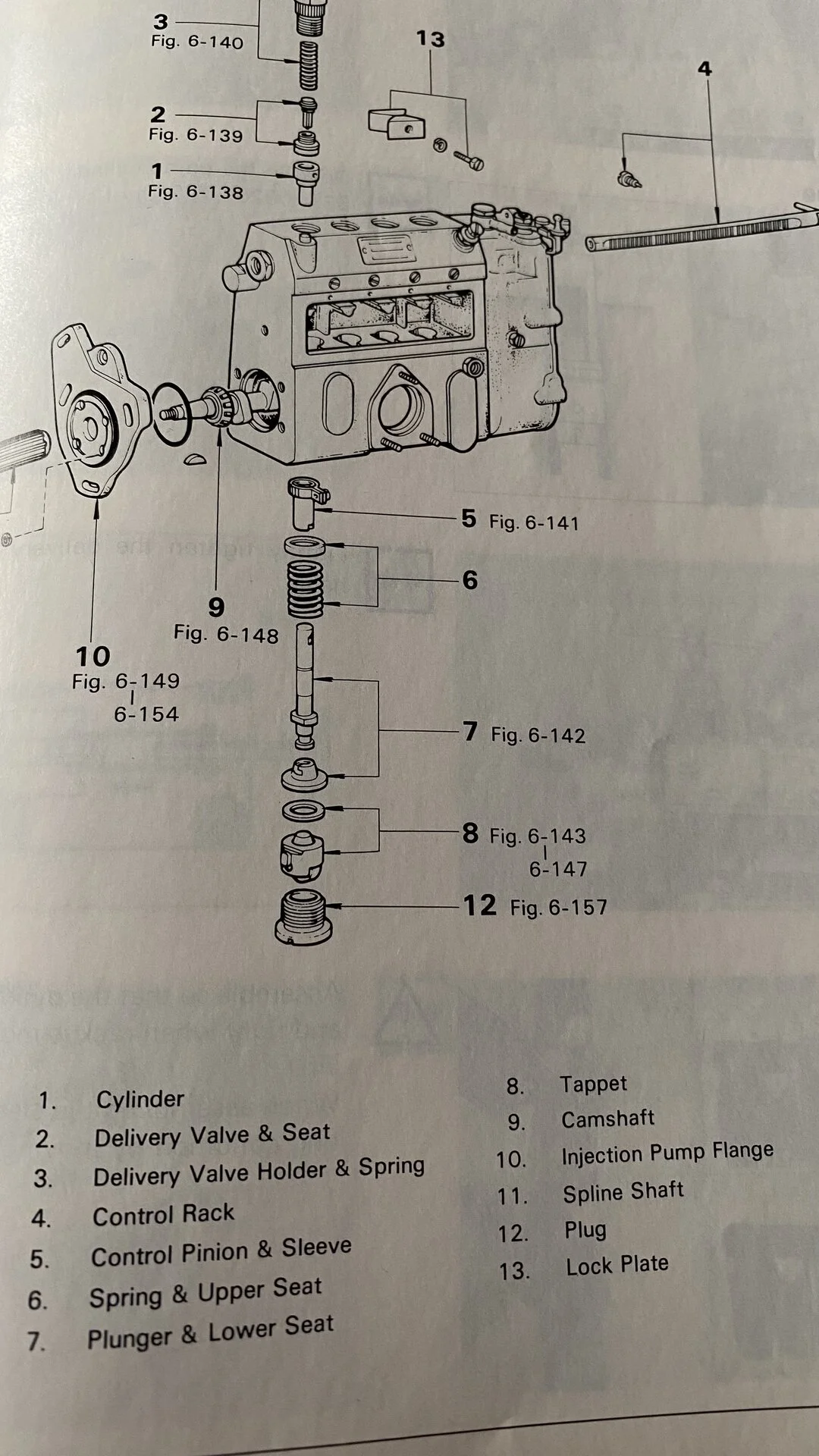

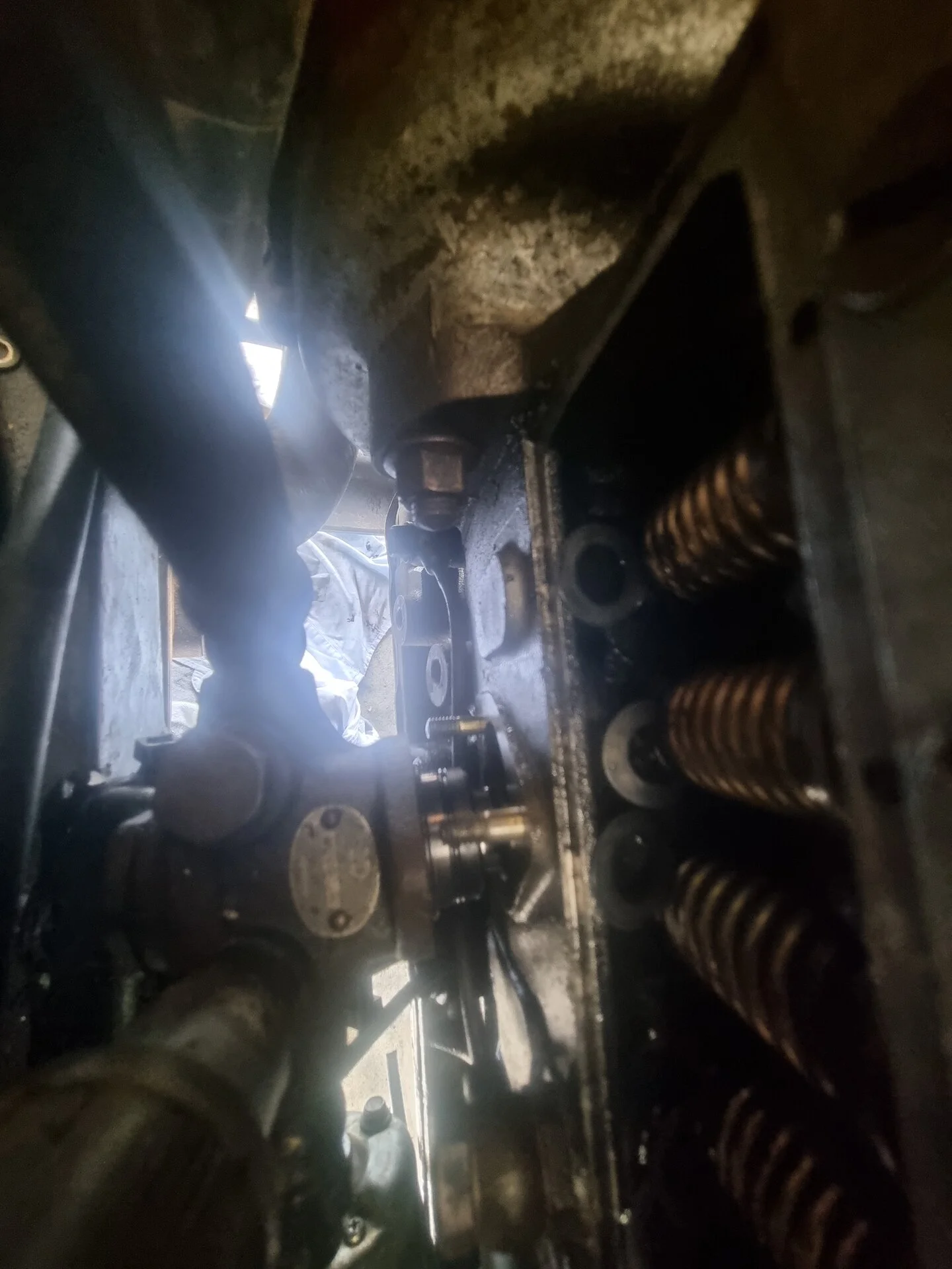

Needing to rebuild my inline fuel pump. Unfortunately I needed to take it apart as the shims as they weren't sitting where that should ( in photo is how I found em) unfortunately i dont know what arrangement they went in. Iv been giving a photo of a document but I wouldn't even know where to start. All i really need to know is how to know where to put each or multipul shims
