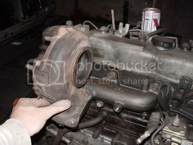

SO... here's where I'm at with this so far:
The turbo I'd purchased was the wrong one (from a Supra, not an MR2) but I think I may be able to use the housing with the correct turbo. I have one ordered and will post some pictures when it shows. Any reccomendations for shops/online retailers that sell oil lines?

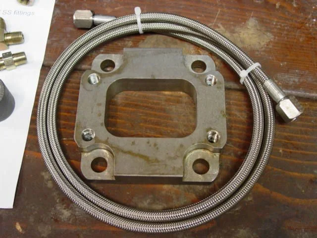

IMHO this is the best way to DIY a 3B turbo. 3bt manifold, and adapter to a T3. There are plenty of T3's with a .42/.48 which seems to be the generally accepted ratio's for the 3B.

I am adding ac and a turbo at the same time.
I had to relocate the oil pressure sender for ac bracket.
I used a t off the second hole in the oil galley for the sending unit and the turbo oil feed.
The turbo had to be disassembled to position it toward the intake.
The oil pan has a bug welded in for the turbo oil return line.
