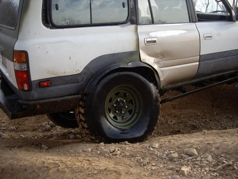

I think people who say the military tires don't flex don't have heavy enough trucks to make the flex. This is 19 psi. Didn't dare go any lower w/o locks cause of the no safety bead thing, but it rode nice and soft all day on the rocks at that pressure.
No, the outer lip is not locked. It is the same as running regular 16.5 wheels without an insert or run flat. I will be limited to 19/20 psi like you. Good to see they flex decent, I really can't wait to get them mounted and run down to the local stream bed. If I can get my wife off the desk top I will post up some wheel/ tire pics, even though they are not on my fzj yet.

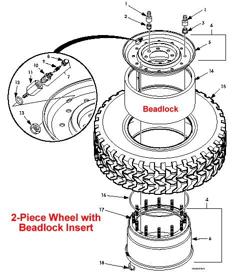

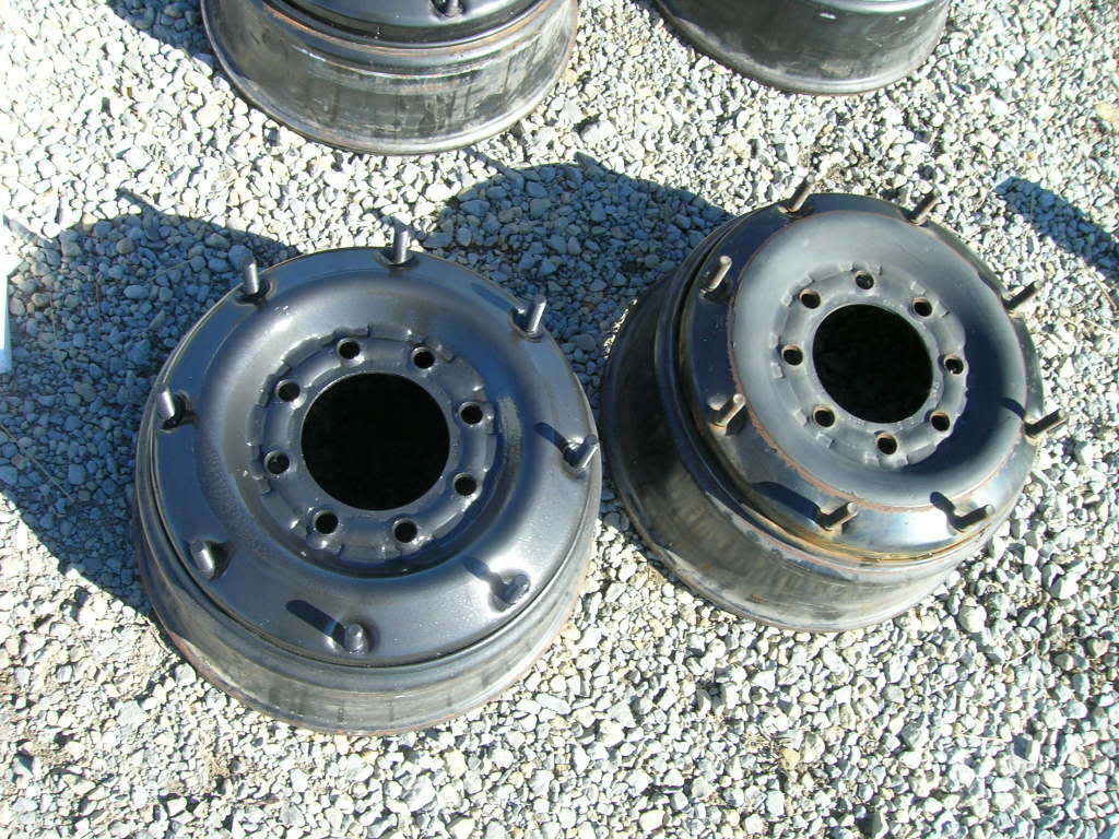

Negs, without either the military rubber, magnesium, or Trailworthy Fab PVC inserts the H1 rims are not beadlocks, just split rims. In the attached pics you can see that the body of the rims are just a cylinder without an opposing surface for the dish to lock the outer bead to like traditional beadlocks.
Nice sketch from Trailworthy:
Picture of inner rim cylinder:
Picture of outer dish:
