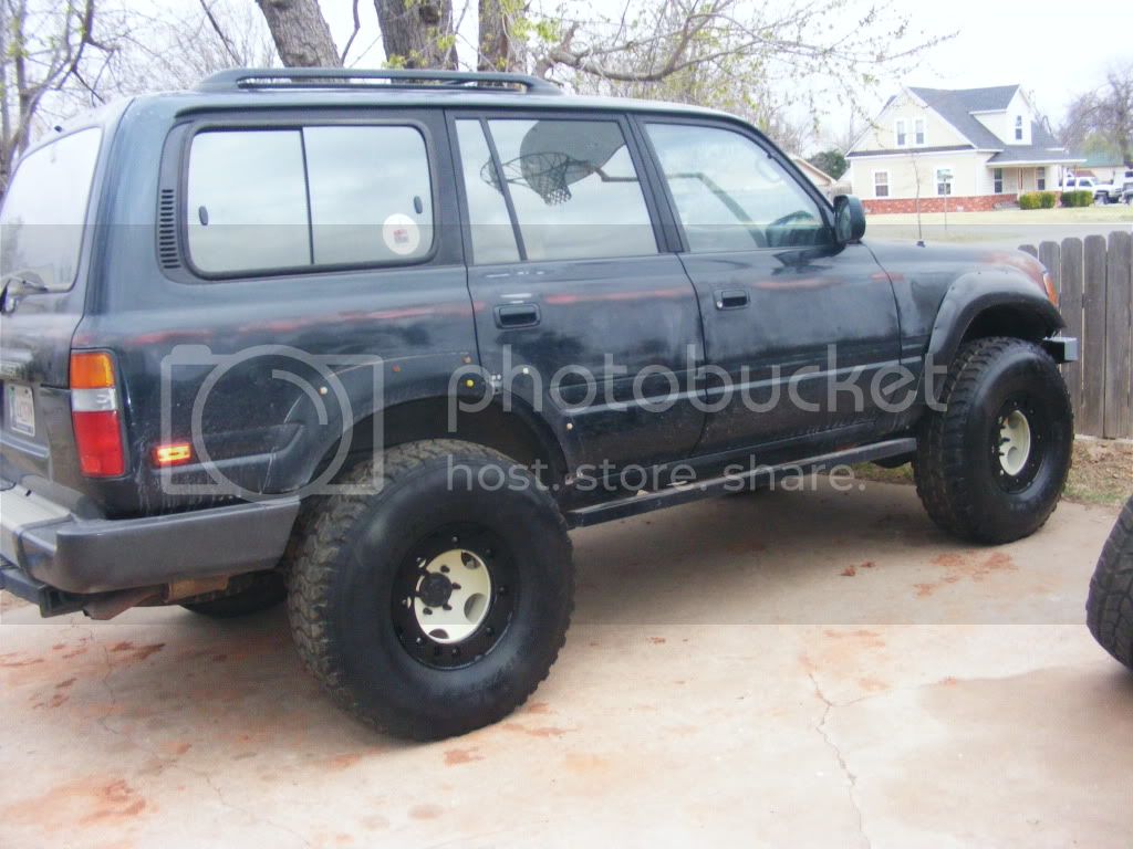

Ok, here goes. I know the fzj isn't pretty but I am getting ready for paint. Paint will be John Deere green to body line and antique white above that. This is the reason for the two tone paint on the wheels. I think I went the wrong way and will probably paint the center black and rock ring antique white. Easily fixed. Also, after burning the hair off of my arm I only have 3 tires mounted so only pics I have are of the passenger side. I still have the driver front to explode and seat. Here ya go:
Just for the guy that will axe, the flare is remounted as the fender well is cut out. I just used some fancy screws with a washer and will put on some rubber molding. The other side already has it and has the back of the flare mounted higher. It looks better IMHO.

Those look cool.... I need to save up to do this. Are you planning on getting rock rings??
These actually do have rock rings on them. They are just real simple. I want to go with a sort of throw back look with my 80. They make more decorated rings but I just went simple and easy. Like I said, I will probably go black centers and antique white rock rings. They may stand out more then.

Id do the rings the same white as you are doing the truck and do wheels JD green... I think that would look cool all matched up. BTW what rims are those?
They are the hummer rims with recentered middles welded in and rock rings welded on. The rings stiffen the wheels and protect the bead locks.

Tires didn't really balance out real well, but I am running air soft beads. Pretty much everything said on pirate about the beads and these wheels and tires is true, check there for info. I am probably going to change back to my stock wheels and find some newish 315's or ?.
I know, a lot of trouble for just changing back, but these are really heavy. I mean REALLY HEAVY, and you don't know just how heavy til you get them mounted up and try them on your cruiser. Probably about 2x as heavy as stock wheels and 315's. They may work good with regular steel wheels, but the recentered hummer wheels are probably just too much weight for a street driven 80. Just my .02 cents.
