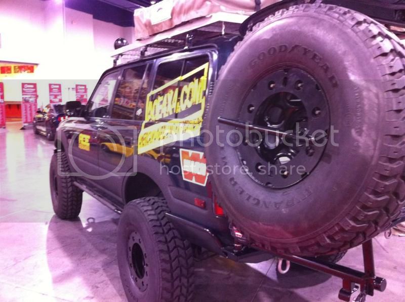

Ran across this pic of an 80 with the recentered beadlocks, have absolutely no info on the rig.
That guy was at the 4x4 expo last year. I think there is info about it on the website on the side of the truck.
We did talk on the phone for long time very nice guy and he knows what he is talking about just kinda steep on price but not so bad if you consider just what you get.:cool:
