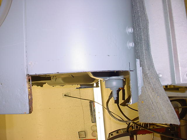

First I made brace's on each side from the B pillar to the A pillar. Bolted a 1/8" plate where the striker goes and the hinge stop goes. I then welded a piece of 3/4" sqare stock between them on both sides. I'm going to be getting a little aggresive around the rockers and A pillar, so just making sure nothing moves.

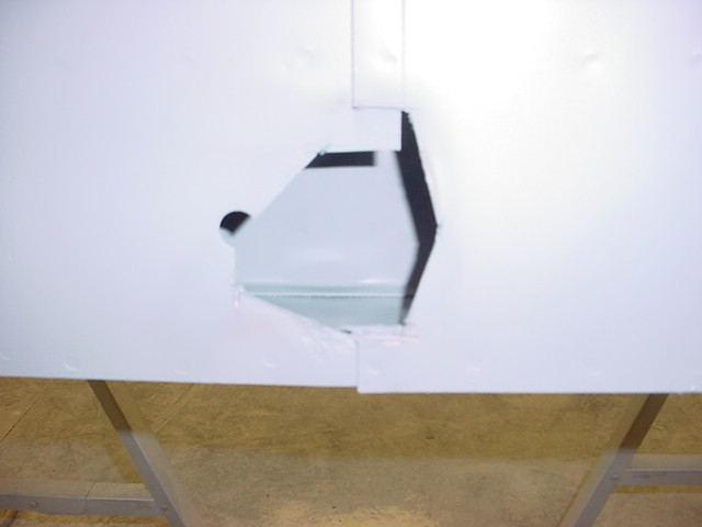

Since I haven't done much metal work in about a year I thought I would warm up on an easy spot. Little rust spot, dead center on the bottom of the rear of the cab. Cut it out, welded back in.....done.
Then I just moved to the closest thing, left rear quarter panel. Marked off what I wanted out with the sharpie, gone. I took the scrap piece and flattened it out to make the exact same length of piece. Cut it in the shear and broke 2 sides of it at 90. Then sliced the 1 side every 1/2" so I could make the bend. Pics should say it all.....I think it turned out absolutley awesome, it is amazingly straight on the outside. Should take a few coats of ureathane primer, but that should be all I need to sand out.
Pulled a floor support where it had rotted through, but it was getting late. So marked off what I'm going to cut out, which isn't much, and start again tomorrow night.

I don't know about, "the man", but I am extremely please how well the first night of sheet metal work went. :)
I can run my hand over that and you can't feel a wave in it, just the scratches from the flap disc. It should turn out very nice once the priming and sanding starts.
