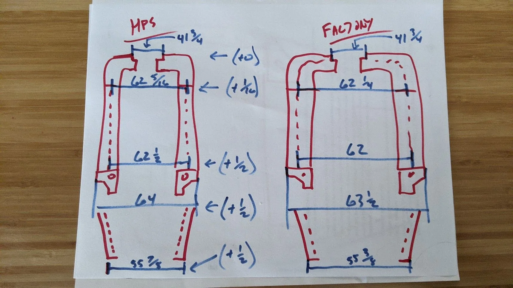

That said...it arrived a little bit ago, and with the firewall now cleaned up, it seems like the tub is consistently about 1/2" too wide on the front half, making for a bit of a poor mate with the firewall. Neither have any real "give" in them, so it doesn't appear to be a flex/wiggle room type issue. I'm somewhat curious if anyone might be able to snip a few example measurements from their tubs, just to help get this sorted. Easiest would just be the door jamb/rocker lip-to-lip up front where it's welded to the firewall. Lip to lip in the back by the striker on the vertical would be interesting as well, but not sure if there's clearance to measure easily with the seatbacks.

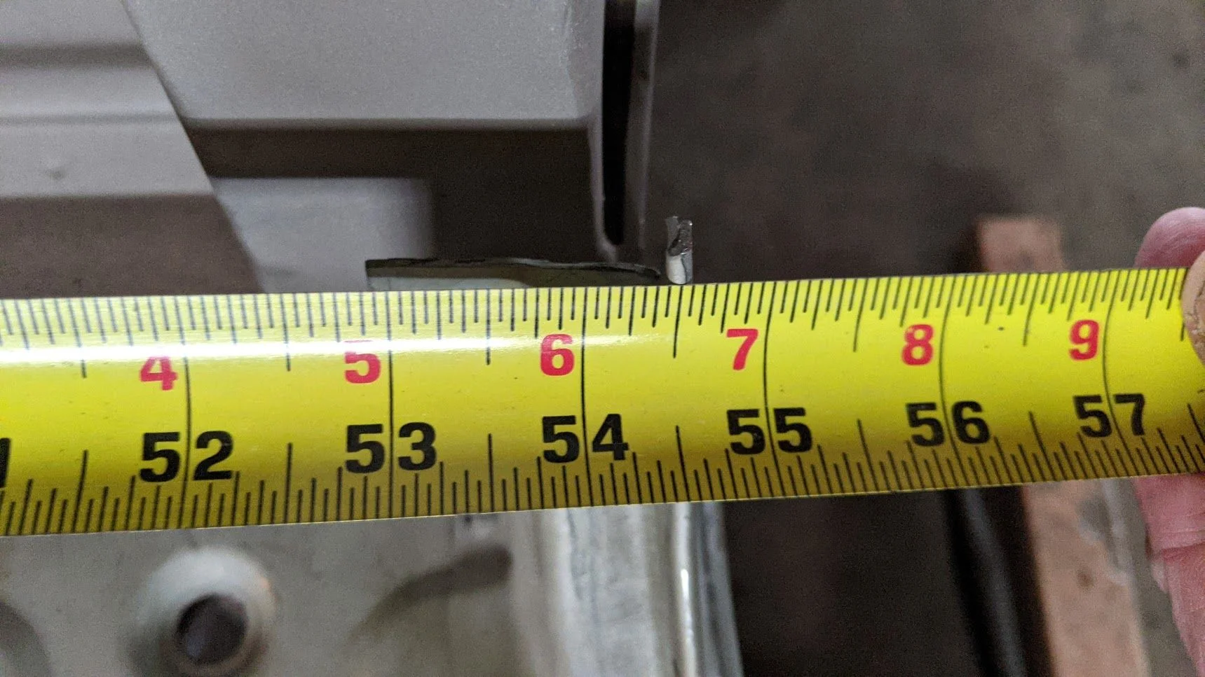

My old tub was 61 1/2" lip to lip at the striker area, but the HFS tub is about 62". The lip-to-lip where the HFS would meet the firewall is 54 1/2, but my hunch is that it should be around 54" to fit up...
Currently working with CCOT/HFS, but also trying to garner what info I can in the meantime...
Lip to lip, firewall joint/weld - new tub:

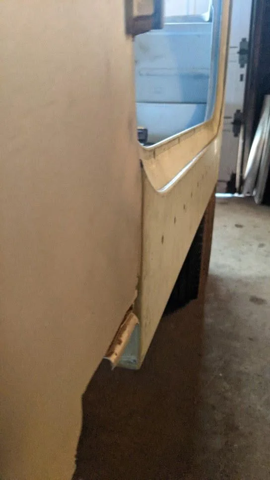

Lip to lip, near door striker (vertical jamb) - old on left, new on right:

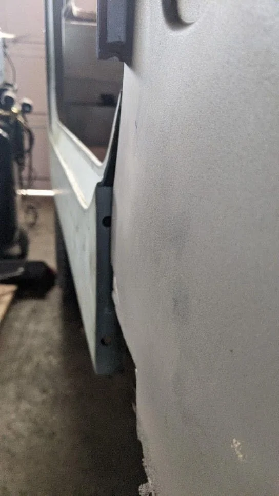

Set flush on one side:
Not so flush on the other:
I see no real solution than to cut and section the floor inside the rocker (on one side or both) and redirect the rocker panel inward to correctly meet the firewall section. You would re-weld the floor after that. Have you checked the fit of your hard top (if you have one) over the tub lips (top edge of the tub)?
After my fender fitment nightmare, you may need to think way outside the box to pull this off. I wrote a Toyota Trails article several years back on my fender mess and how I worked around all the fitment issues.
Yeah...that was my unfortunate thoughts as well - there's no give, so you'd have to section out the floor pan ahead of the rear step and pull out a 1/4" wedge on each side. I haven't done the measurements to see if both sides are off, or if one side is angled differently (to know if you have to section both sides, or if it's just one).

Could the lower side of the cowl on the non-flush side be bent in at all, from a wreck or anything? I only think that cause mine was. I had to pull it outward quite a bit to get it flush. (I didn’t do a 3/4 tub though, I did a half tub and new floor and new rockers...yeah the hard way...so I worked the fitment until it all worked)
We're the original owners, no accident history. Firewall is straight other than the typical rust on the very lower wedges.
The offset is only shifted to one side of the firewall to show the width difference a bit better...it may be split across both sides. I haven't set up a jig to see if one side or the other of the tub is off, still waiting to hear back from CCOT.

That's about what I expected to see - seems like OEM is generally around that 63 1/2" - 63 5/8", but the HFS tub is measuring wider at 64", and that 1/2" carried forward to the firewall. The 62 1/4" measurement was lip-to-lip back at the seam in the rail where it transitions to the radius'd part, there's a joint there for a consistent measurement spot. From what I can tell, the "spar" at the B-pillar on the HFS tub was made 1/2 too wide, and it carried forward to the firewall, as the back door opening is correct, with the error slowly increasing from the rear to the B pillar and firewall.
As far as the firewall mating/fitment goes, I am able to jig the front with fairly strong pulling in the trans tunnel to get it down to the correct dimension, but it'll mean pie-cutting the floor pan in two spots to get it to lay flat - pulling in the necessary 1/2" obviously results in fairly substantial buckling/oil-canning of the floorpans as they're all tied in around all edges.
What I don't know at this point is just how much that 1/2" discrepancy at the B-pillar will impact door fitment, as the hardtop will bring the hardtop sides back to "stock" by the top by 1/4" from the rail to the top on each side...so in theory, the upper rail of the door is going to be proud of where it should be at the top. The challenge is that I won't know what the snowball effect is there until the firewall is mated up, and at that point the ship has sailed...

Thanks for those that gave some measurements - so far, they all tend to align:
* my stock => ~63 1/2
* Brian's stock => ~63 5/8
* aqualu => ~63 5/8
