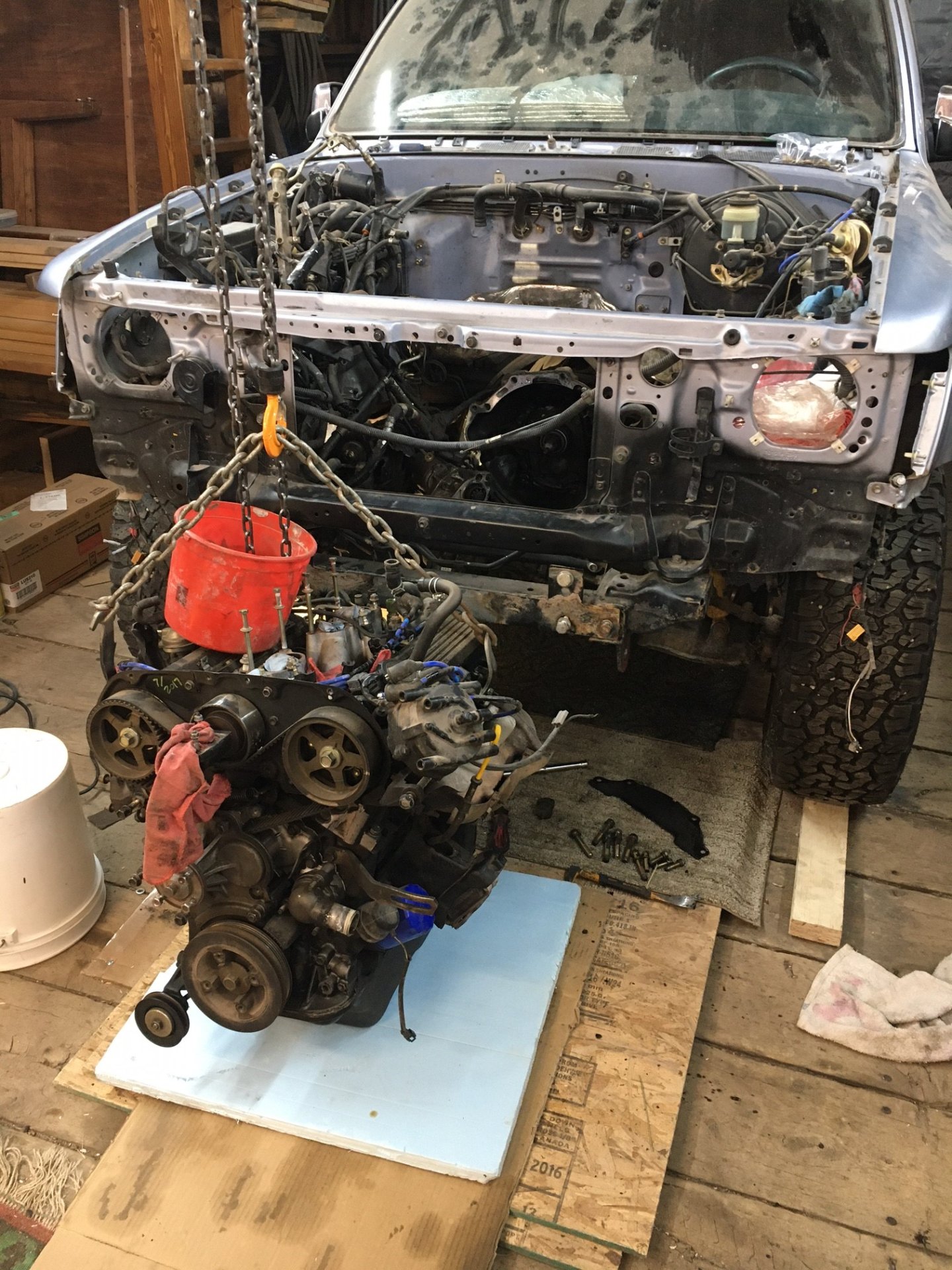

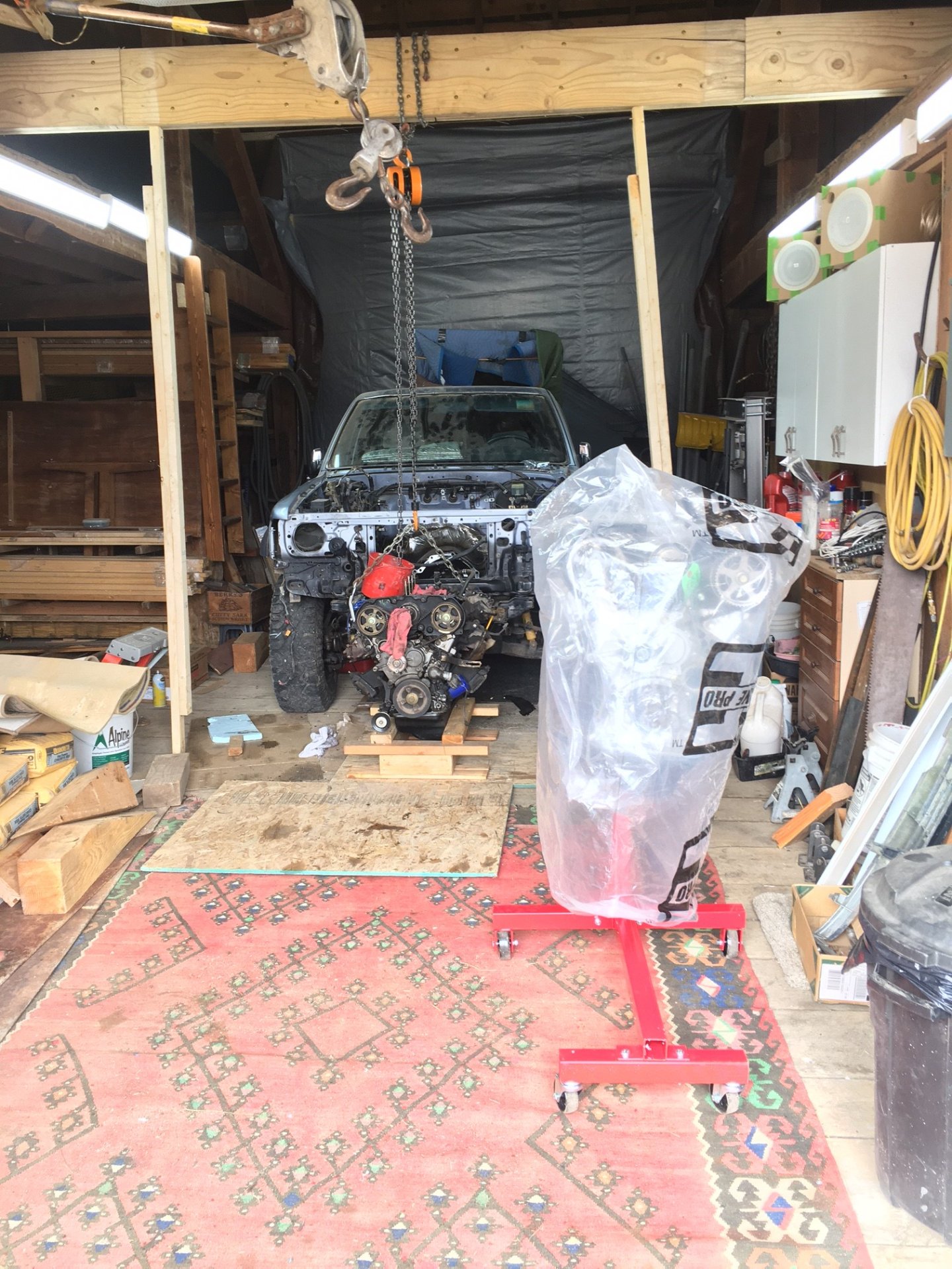

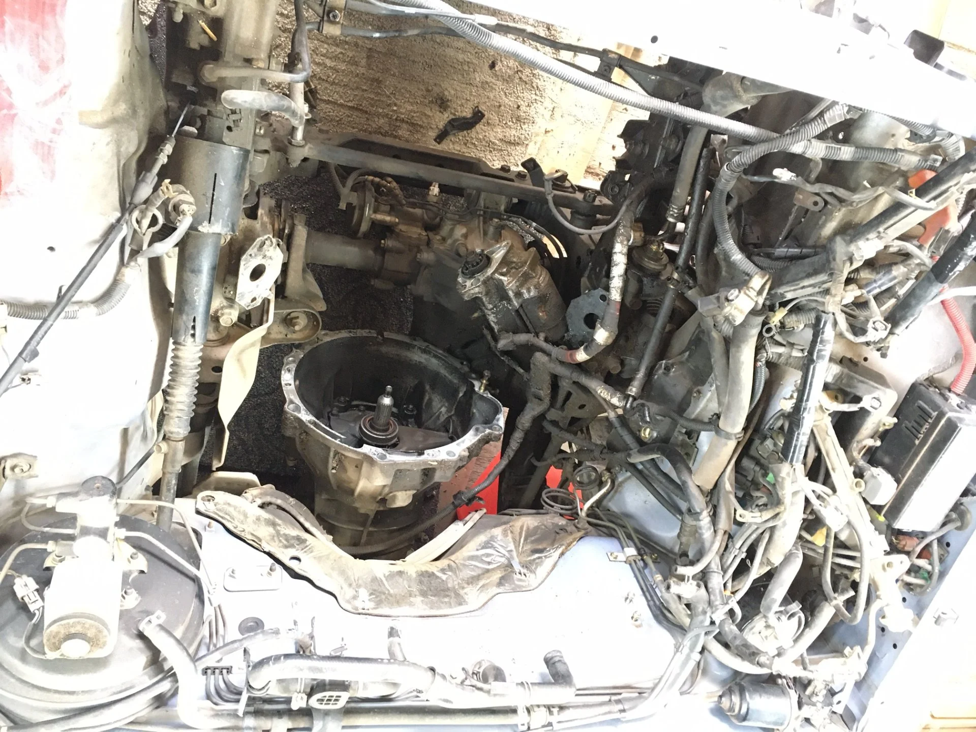

Got some stuff done this weekend...
The pull really wasn't the PITA I was expecting. Went pretty smooth.

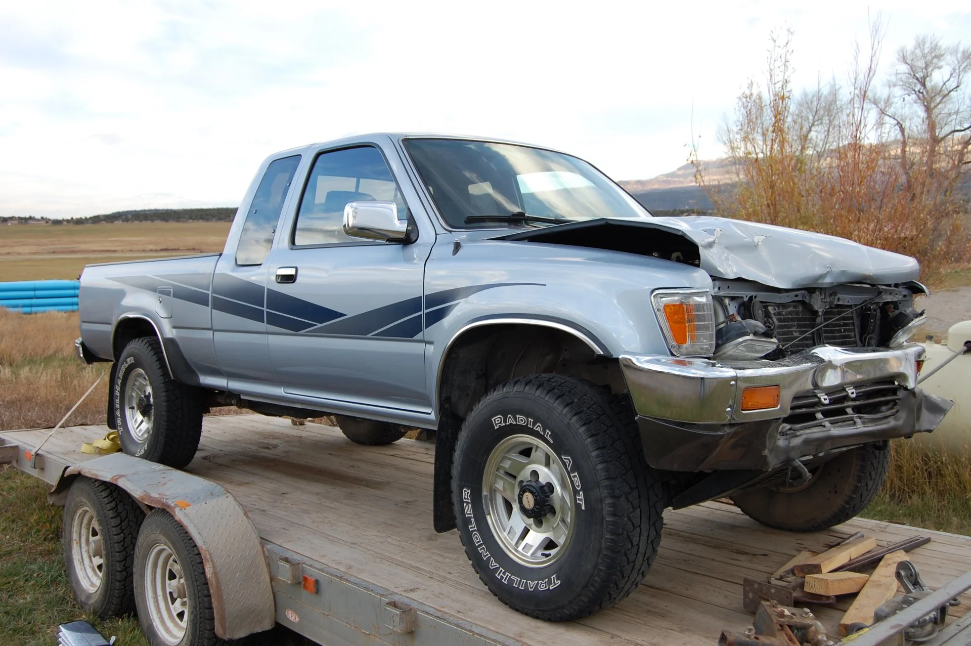

Hit a deer at O-Dark-Thirty one morning at the top of a pass on my way to work.
Went rounds with the insurance company for 7 months before reaching an agreement.

The carnage...

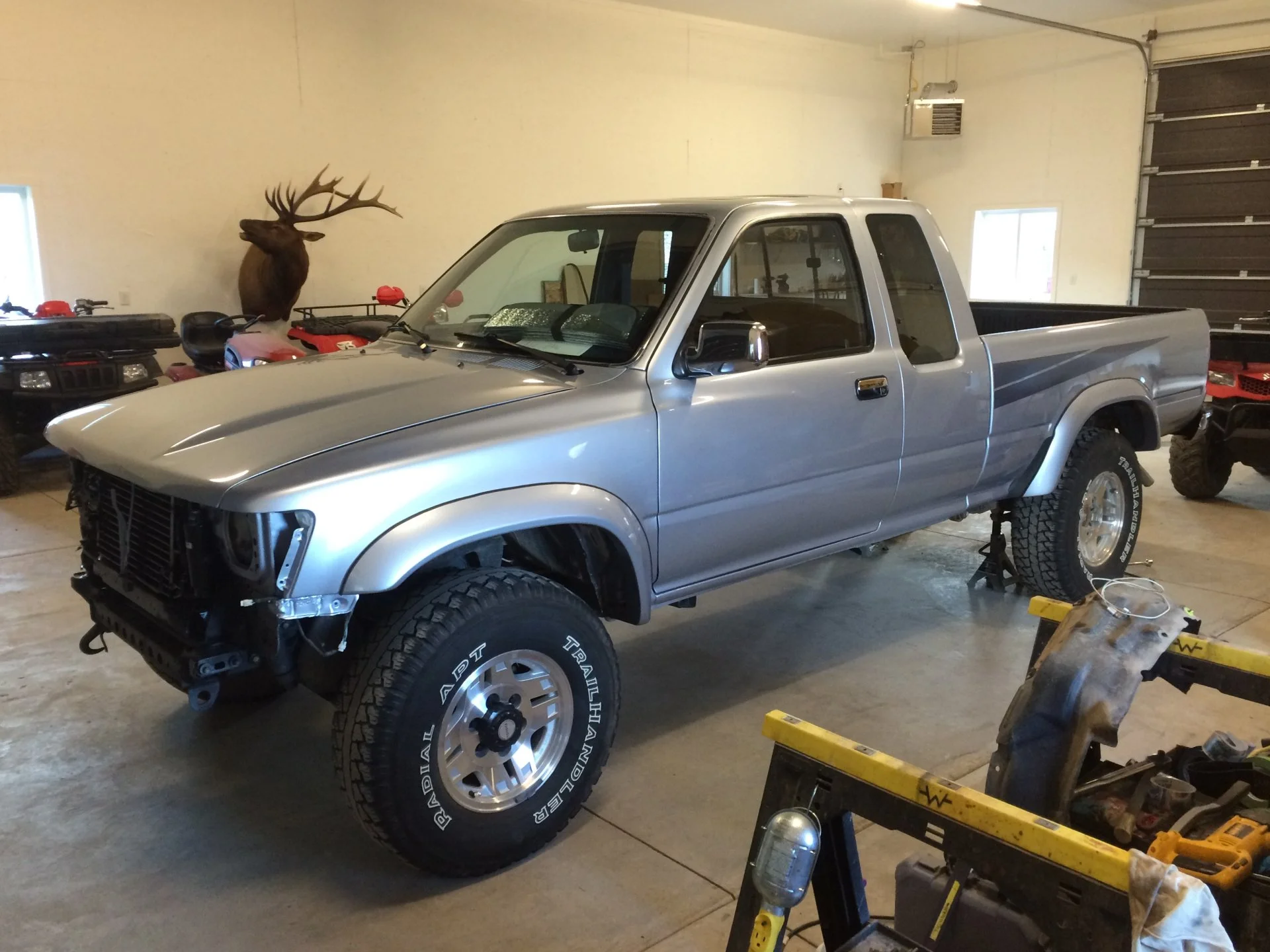

As she sits now:

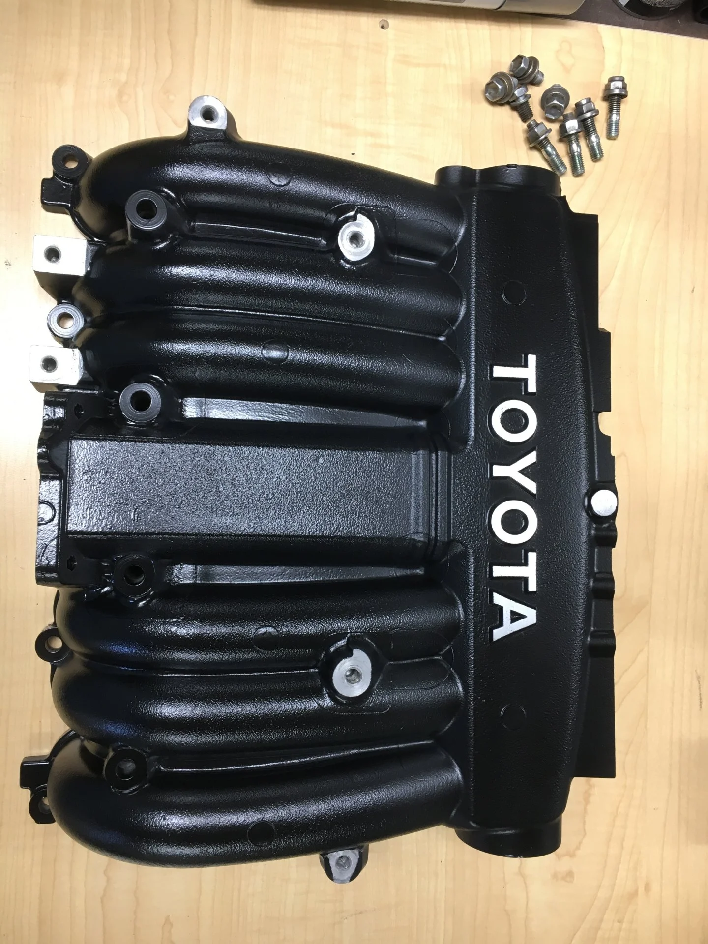

I'm going a little overboard, but having fun. Painted the air intake black.

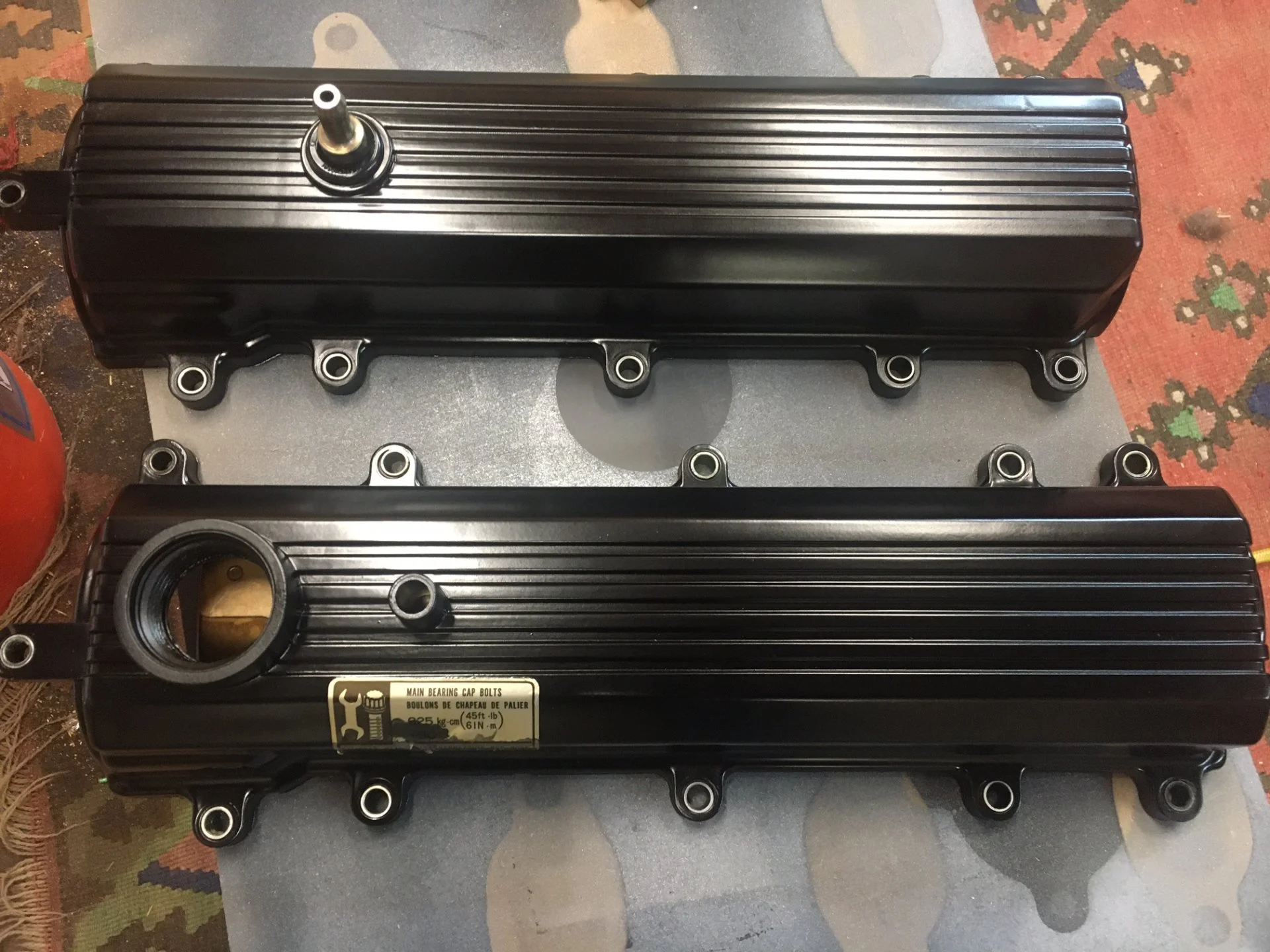

So... New motor delivered from Yota1 Performance this past October. I now have the old valve covers cleaned up & ready to install, given the rebuilt motor does not have the correct covers with breathers. Here is my question: Could the valve cover gaskets installed at the shop, and now sitting installed for 8 months be OK to re-use? Or, being installed and crushed without any use is still a no-go? Not necessarily wanting to cheap out, but with all of the other sensors and parts being pushed into this motor change-out, I'm trying to stem the $$ flow out the door. If I'm taking a chance on gasket leaks, then re-use is an obvious NO.
A little feedback from the experts, please?
