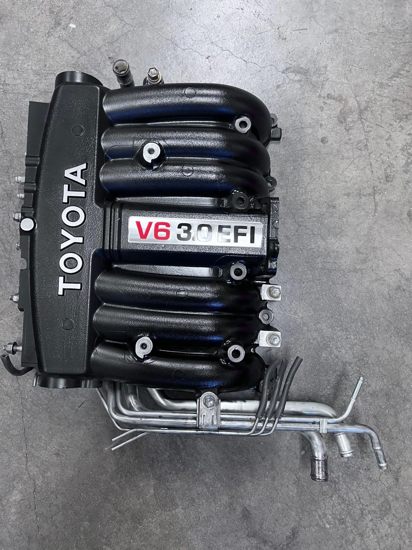

Now seeing that I need to purchase the grommets to seat the fuel injectors into the intake manifold. A bit disappointing to find these not included in the rebuild kit (generic description of INSTALL GASKET SET on the website). My fault for not knowing exactly what is required for all the little bits and pieces. :meh: On a positive note- got my injectors back from Witchhunter Performance. All specs came out great for the set.

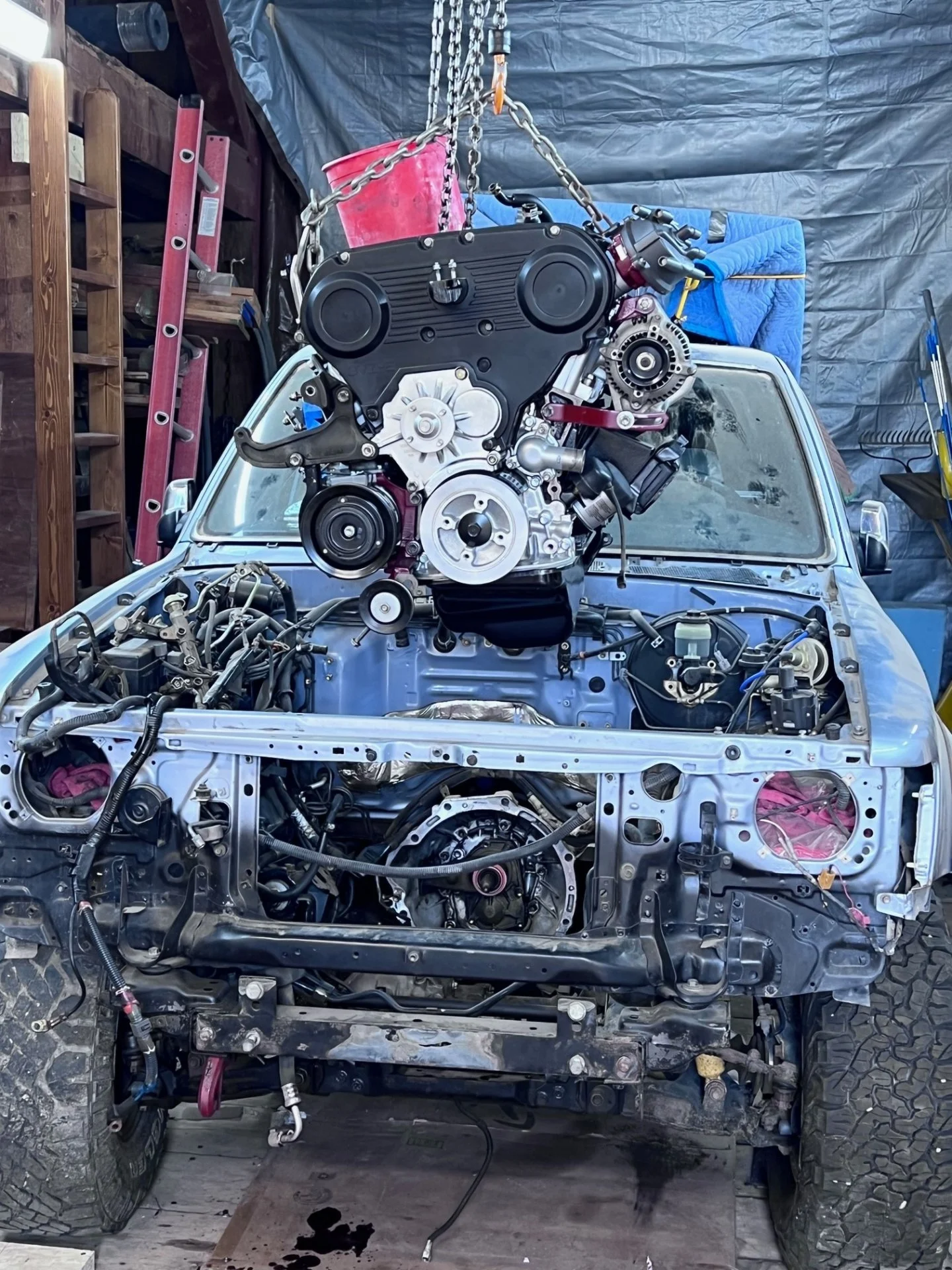

Slow progress, but progress is being made. Finally got the motor loosely bolted up to the motor mounts and transmission this morning. Slow and semi-steady will get me there, preferably before winter temps hit! I sure do miss driving this truck. New Denso starter, A/C compressor (& tidbits), and rebuilt the P/S pump. Looking for a Denso alternator soon (just because), but the original is still going strong (knock on wood). Looks like another $250, but trying to stem the bleeding of $$... Hard to do; would really like to re-gear "while I'm in there..."

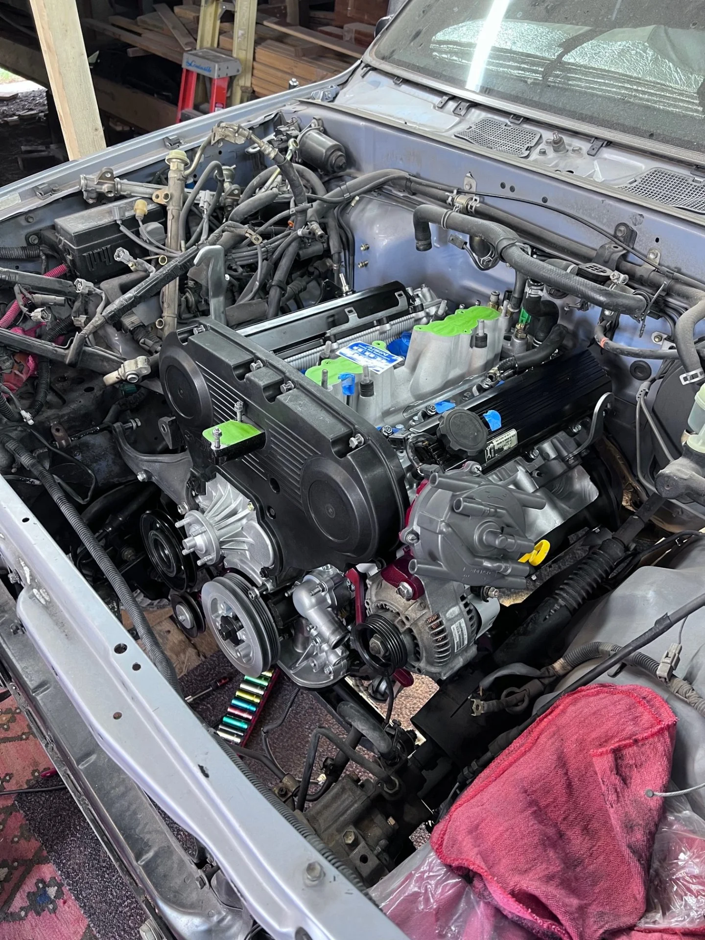

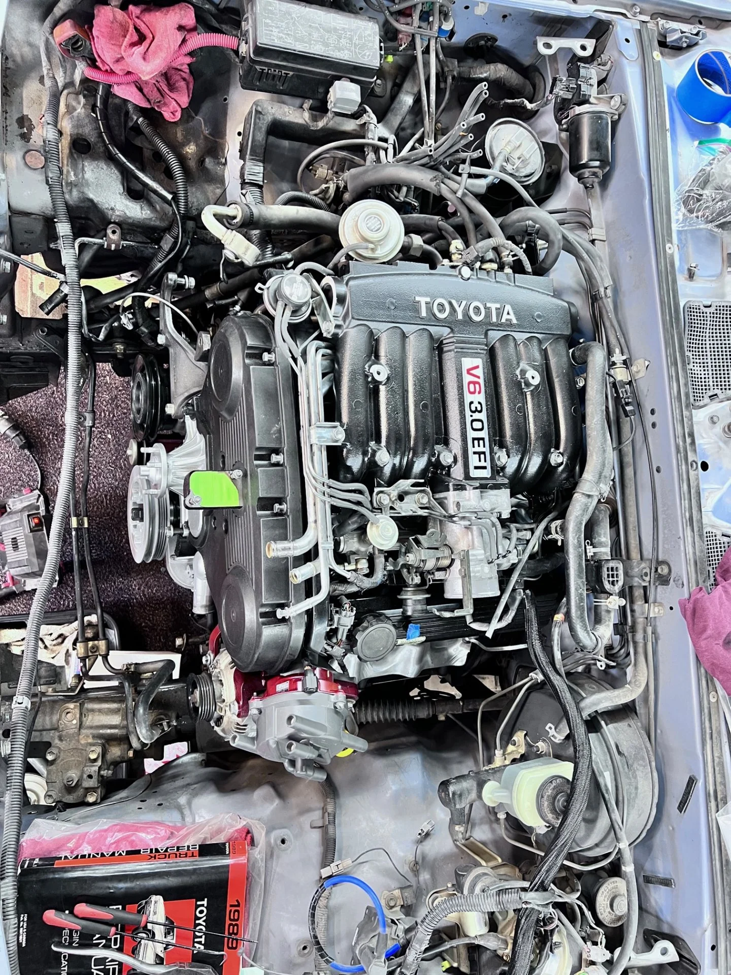

Finally starting to look like a functioning engine bay again. I need to hook up the vacuum lines, clutch slave cylinder, pwr. steering pump, A/C compressor, alternator, plug wires, throttle body... You would think the list would get shorter, but it seems to keep going. ;)
A good weekend of progress- I'll take it!
