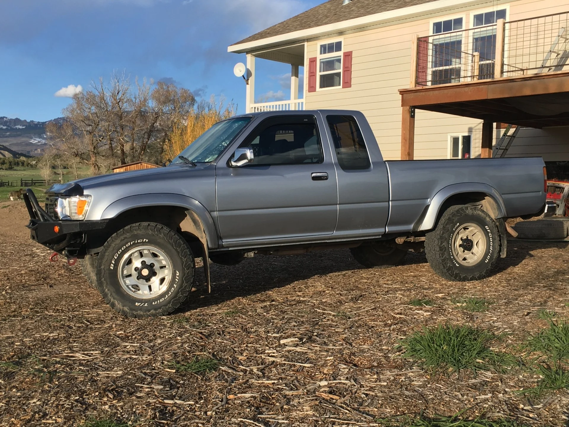

Got it all (well, never DONE, right?) but 80 Series back on the road, as well as the truck.
Just for the archives:
1989 Pickup - 3.slow engine replacement
190,500 miles- back on the road!
191,250 miles- oil change; drain break in oil and filter, Mobil 1 20w40 Full Synthetic
New:
clutch & components
full drivetrain oil change(s)
test, clean and refurbished fuel injectors
starter
A/C compressor
replaced vac hoses as required
Distributor o-rings, cap, rotor, wires, plugs
Rebuilt P/S pump
powdercoat for front bumper
