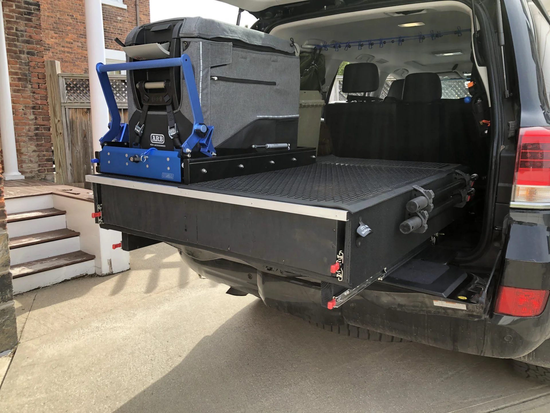

Hey all- I’m just jumping in here and plan to do the 2nd row removal this week. I made a double slide rear drawer that slides nearly completely out- wife likes to sleep INSIDE the vehicle- so this gives us a lot more room once I remove the second row.
Here’s the question-
Is there a specific trick to the removal of the plastic bolt / seat mount covers? I know I can just get in there and pry, but I’d rather not destroy them in case I ever want to go back.
TIA
