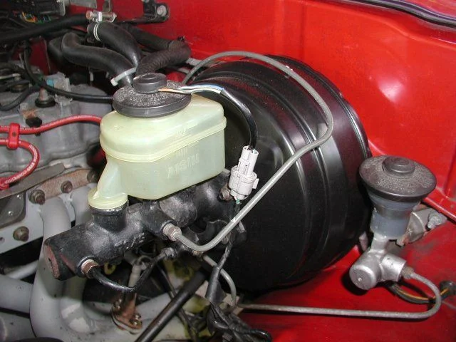

My old truck has a V6 booster, and a 1" master. Popped right in no problem. I don't remember needing a spacer, but that was way back in 2007. Tight to the clutch master, but it fit.
