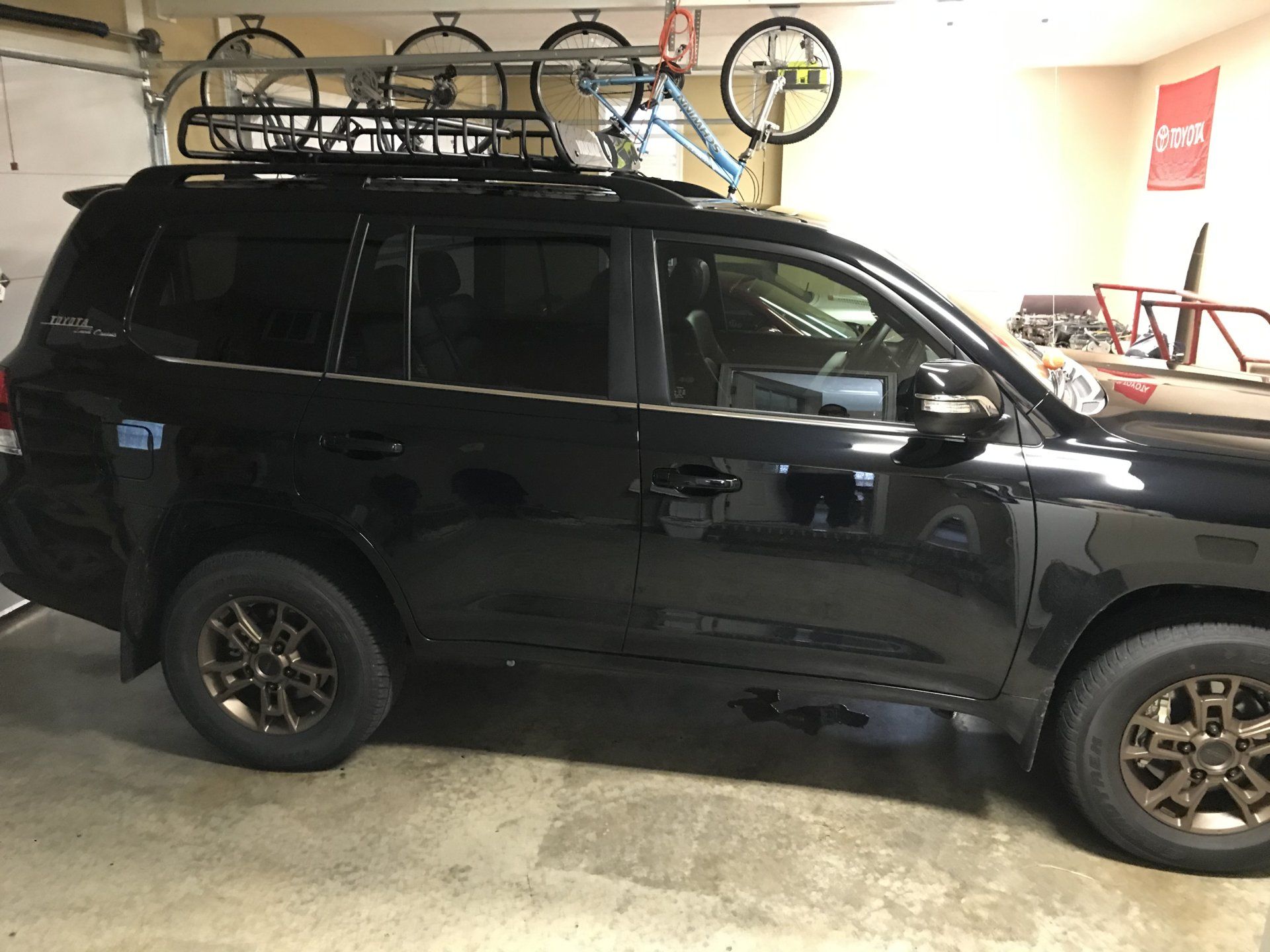

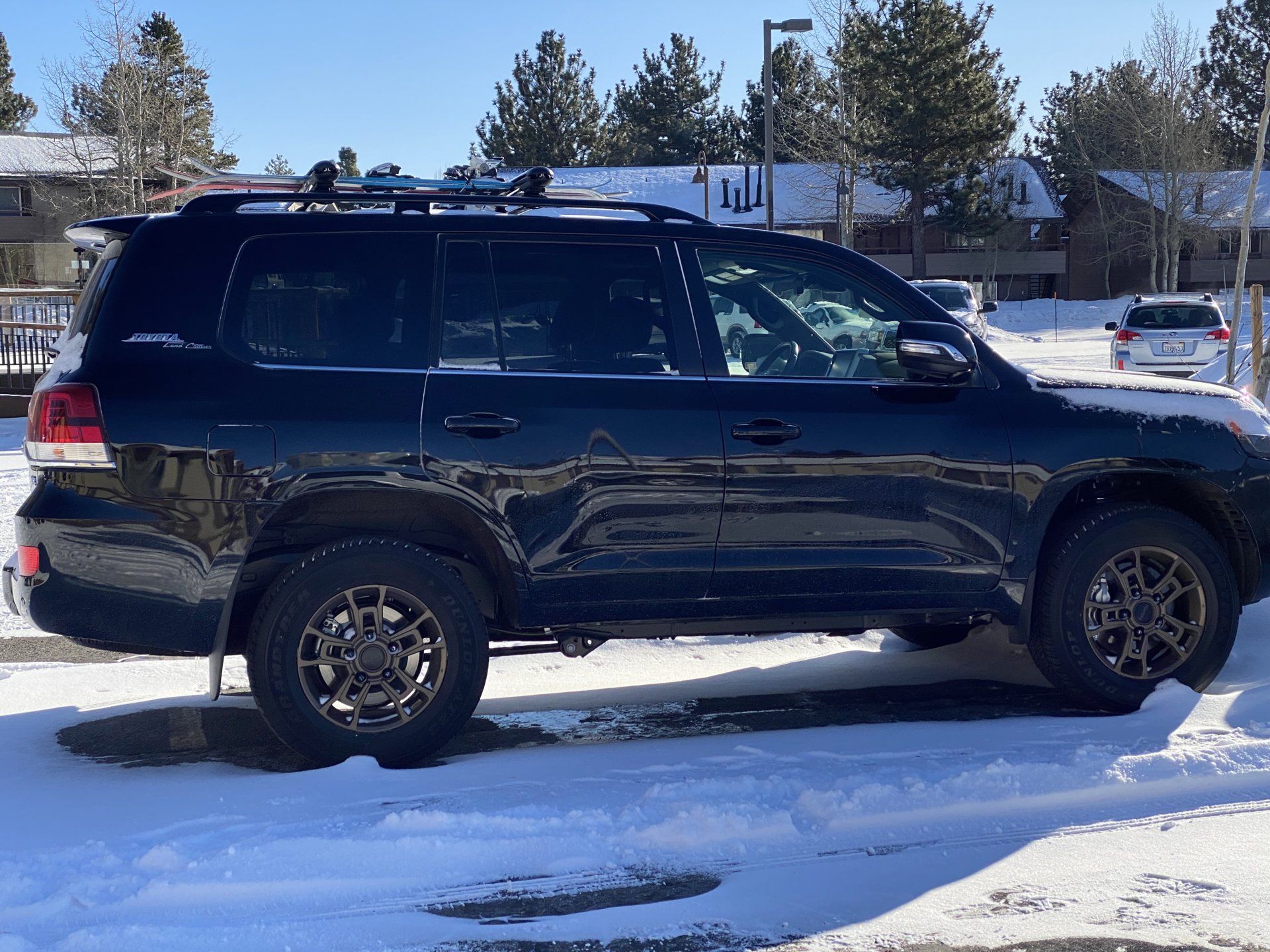

Just spotted one in the wild...
The amount of rake on them is at an 11. I would have to do something about it.
That rake isn’t a bad thing.
Load it with people or gear and it’s just right.
Plus...IFS suffers if you crank the front too high.
The standard axle in back is fine, but crank the front and you soon give away available down-travel from neutral ride height in front with CVs & lower control arms.

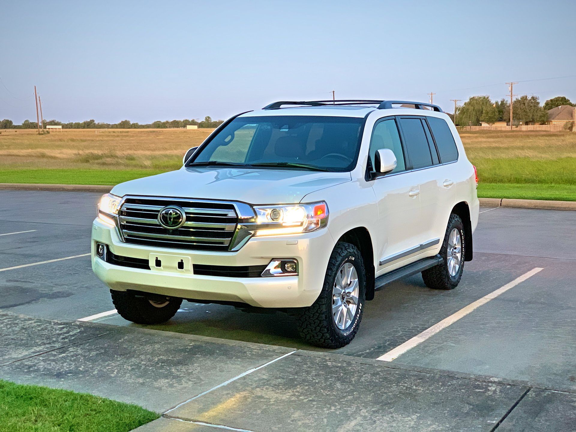

EZ Fix with Toyota's 1" kit, that's what I did to my '16
I was under the impression that the 13+ models already had the spacer from factory. So none of the LC200s have them from factory?
If one wants a quick 1" lift, the spacer is the way to go then.
My 13 didn't, and I'm pretty sure people with later builds had to add it to theirs too.
The odd thing is when I search which vehicles came with that part number, it lists all years of US 200-series Landcruiser. Though the parts lookup system I'm using isn't official toyota, so that could be an error.
But yes that's an easy ~.75-1" front lift that is designed to work with the stock spring/strut/bump stop/travel. You will need an alignment after install. Somewhere on this board are detailed side-by-side pictures of otherwise identical cruisers with and without that part.
My 13 has third row removed, though I do have sliders. It looked much like a HE in terms of rake.. the OE spacer helped a lot, but now when loaded for a trip it is perfectly level.

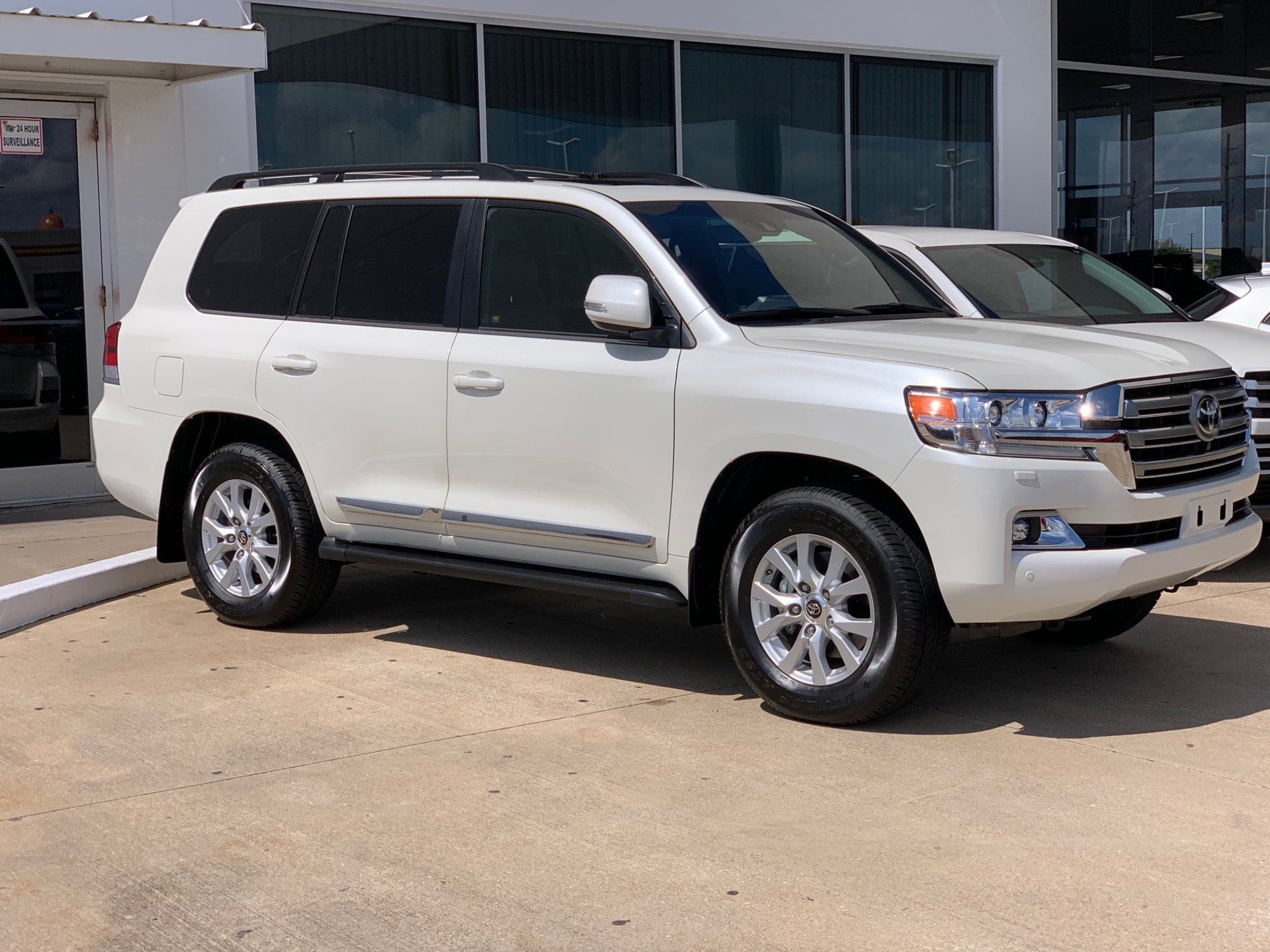

That’s a good question. I will check mine when i get home.
BUT, this may explain THIS: Newbie Q: why are the angles different b/w LC200s?
At some point in 2017 i think, the angles on the LC changed. 2016 LC (year of facelift) had the same angles as prior years, per Toyota doc. But in 2017+, angles changed.
The only problem with this is that the departure angle changed too...which does not make sense if you’re only lifting the front.
My STOCK LC seems pretty level empty:
