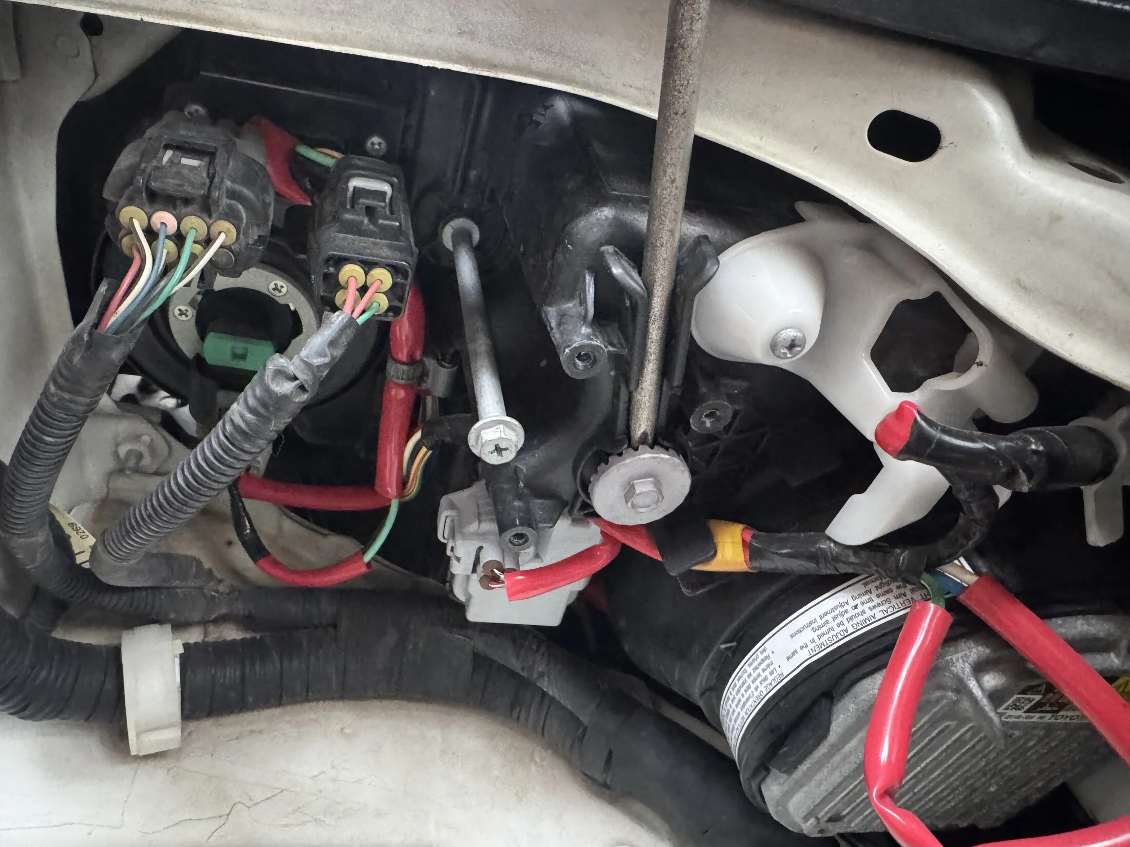

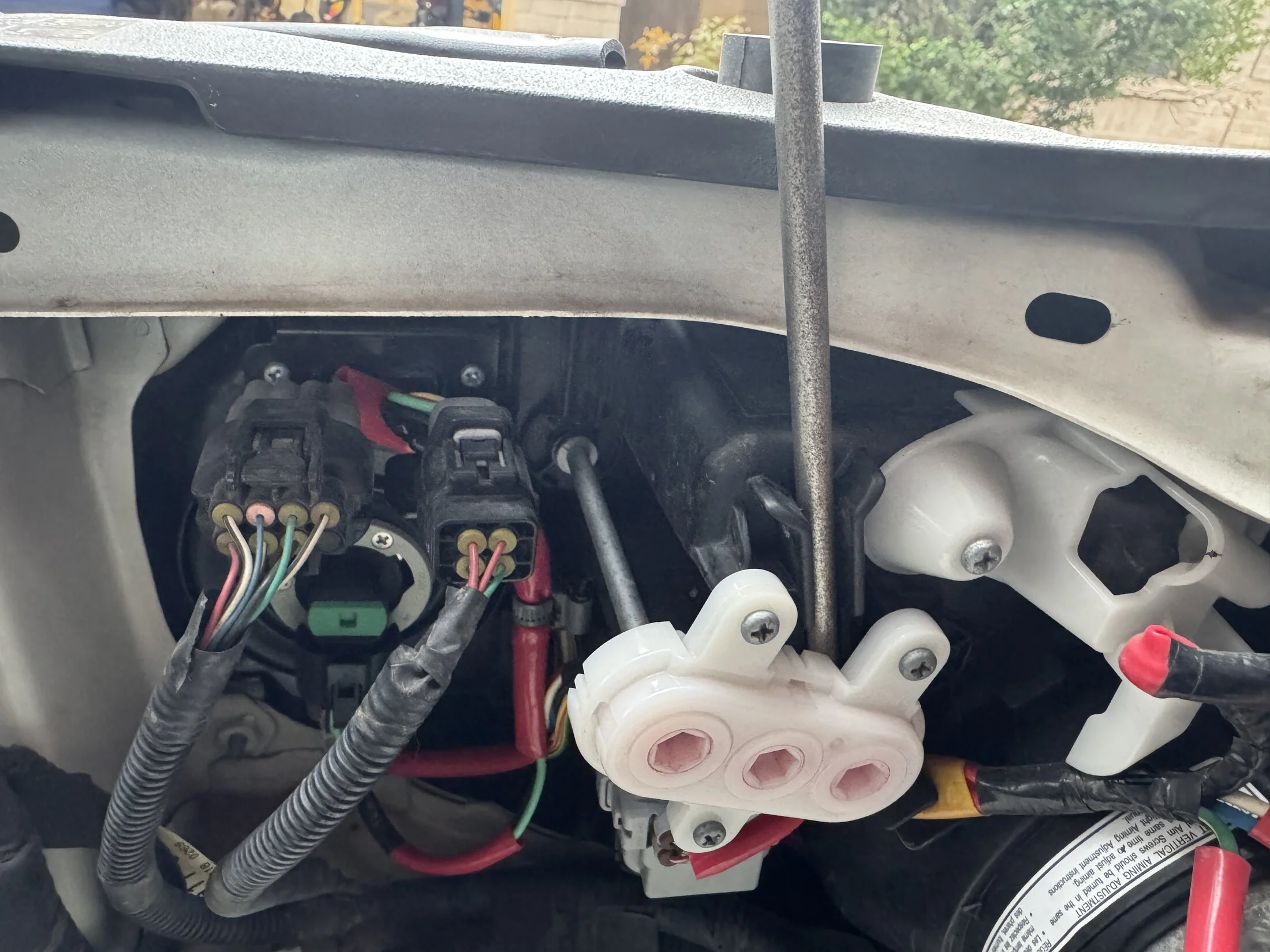

This is the right headlamp on my 2013 cruiser. I've put a long philips screwdriver into the adjustment spot for the low beams. The white/pinkish mechanism has three gears in it. When you adjust the low beam it relays the same rotation to the long screw for the high beam, the gray rod pointing forward.
On both of my new factory headlamps, and my friend's LX, the relationship between the low and high beams via this gearbox was incorrect. I had to set the low beams where I wanted them at the appropriate dash dial adjustment, remove the gearbox, set the high beam appropriately, then reinstall the gearbox. Now any movement to the low beam screw also adjusts the high beam the same amount.
Edit to say, this is for up/down adjustment only. Left/right doesn't have a gearbox so those adjustments are independent. In my case L/R only needed minor tweaking.

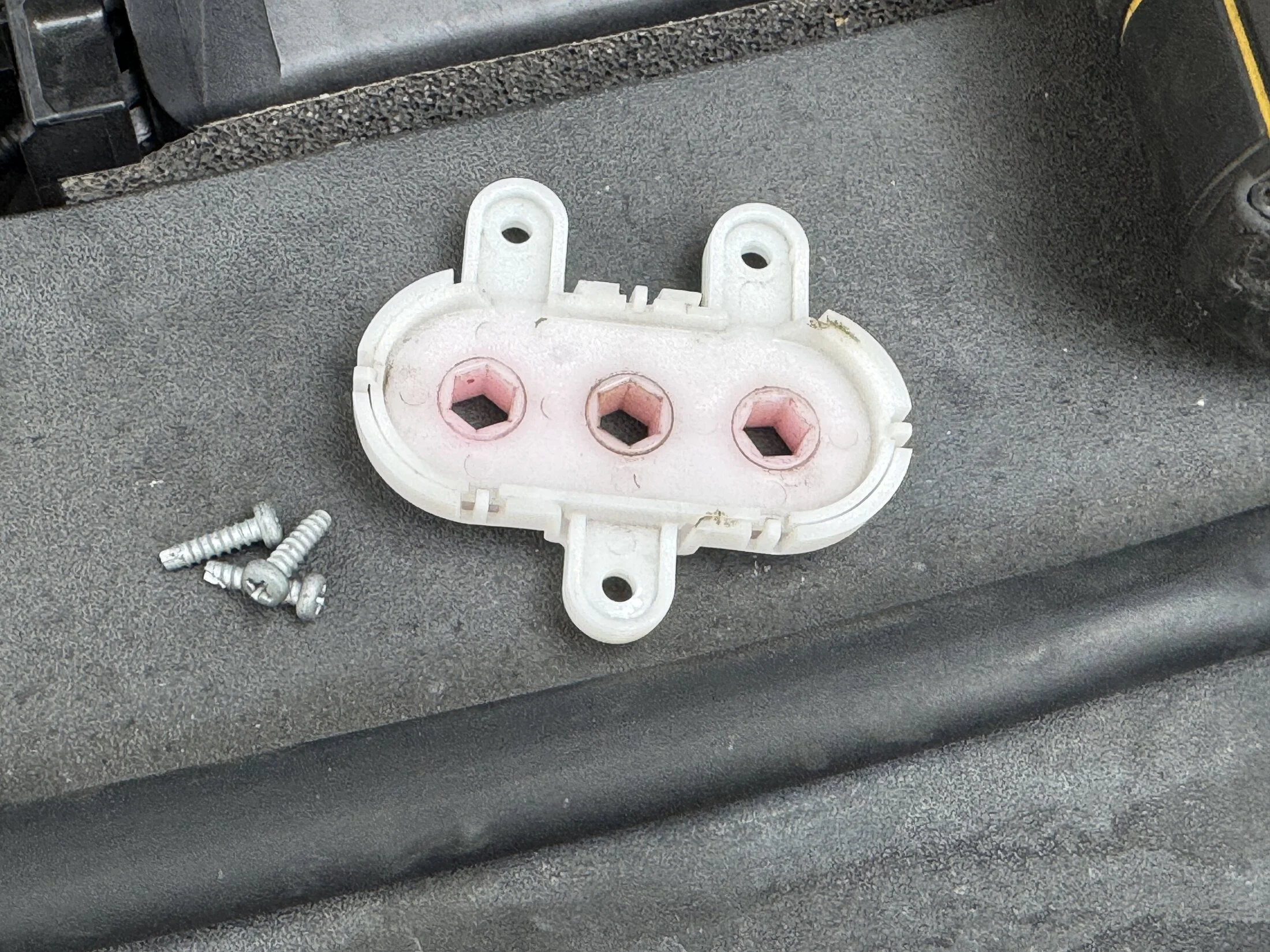

Same with gear box removed
Gear box

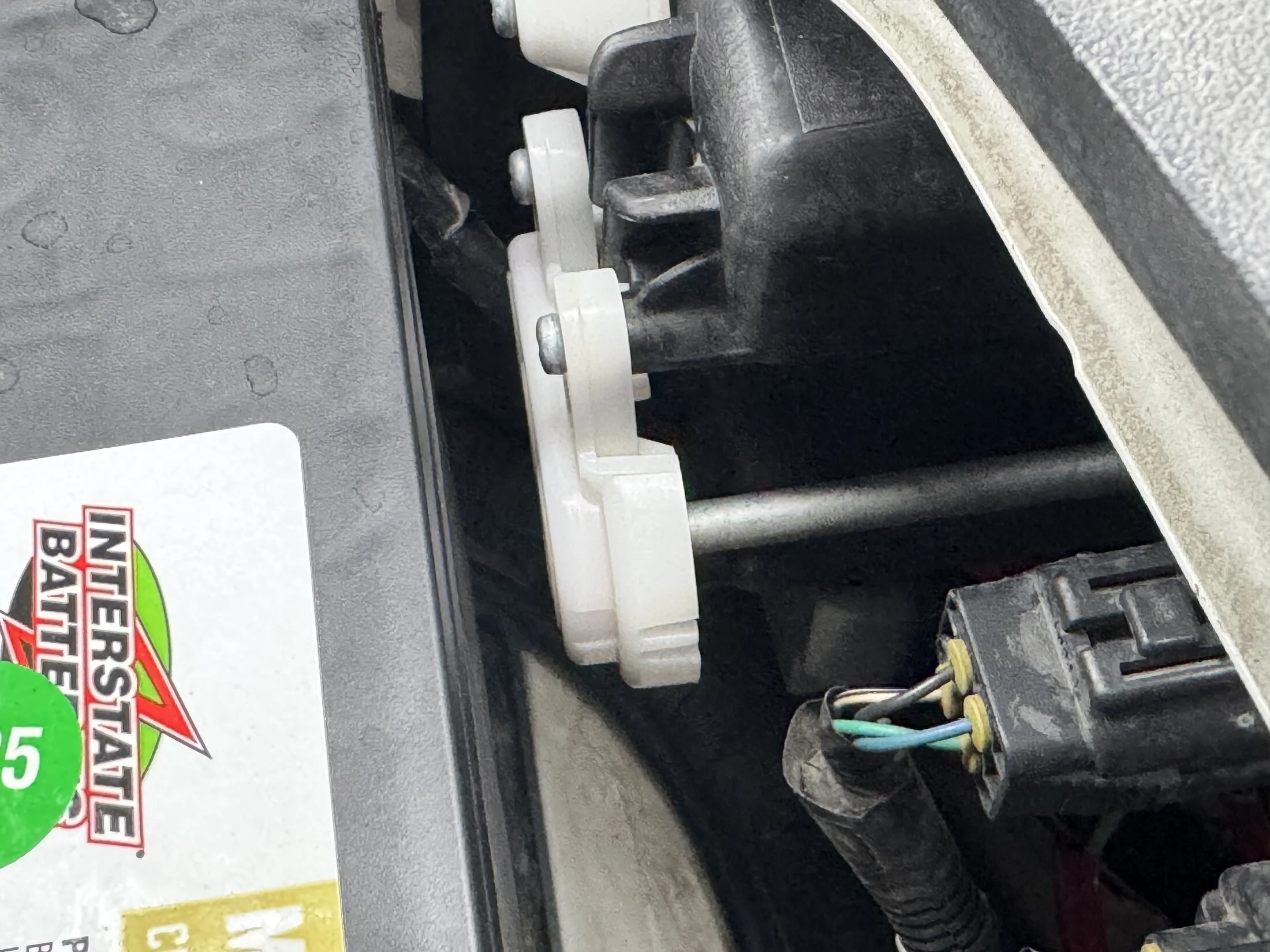

This is all pretty easy on the passenger side, but on the drivers side the battery is in the way of the gearbox screws.. I was able to loosen the battery tie-down and use a tool I have to make it all work. I'll show that tool in the next post. (limit on attached pics)
Driver's side, battery in the way

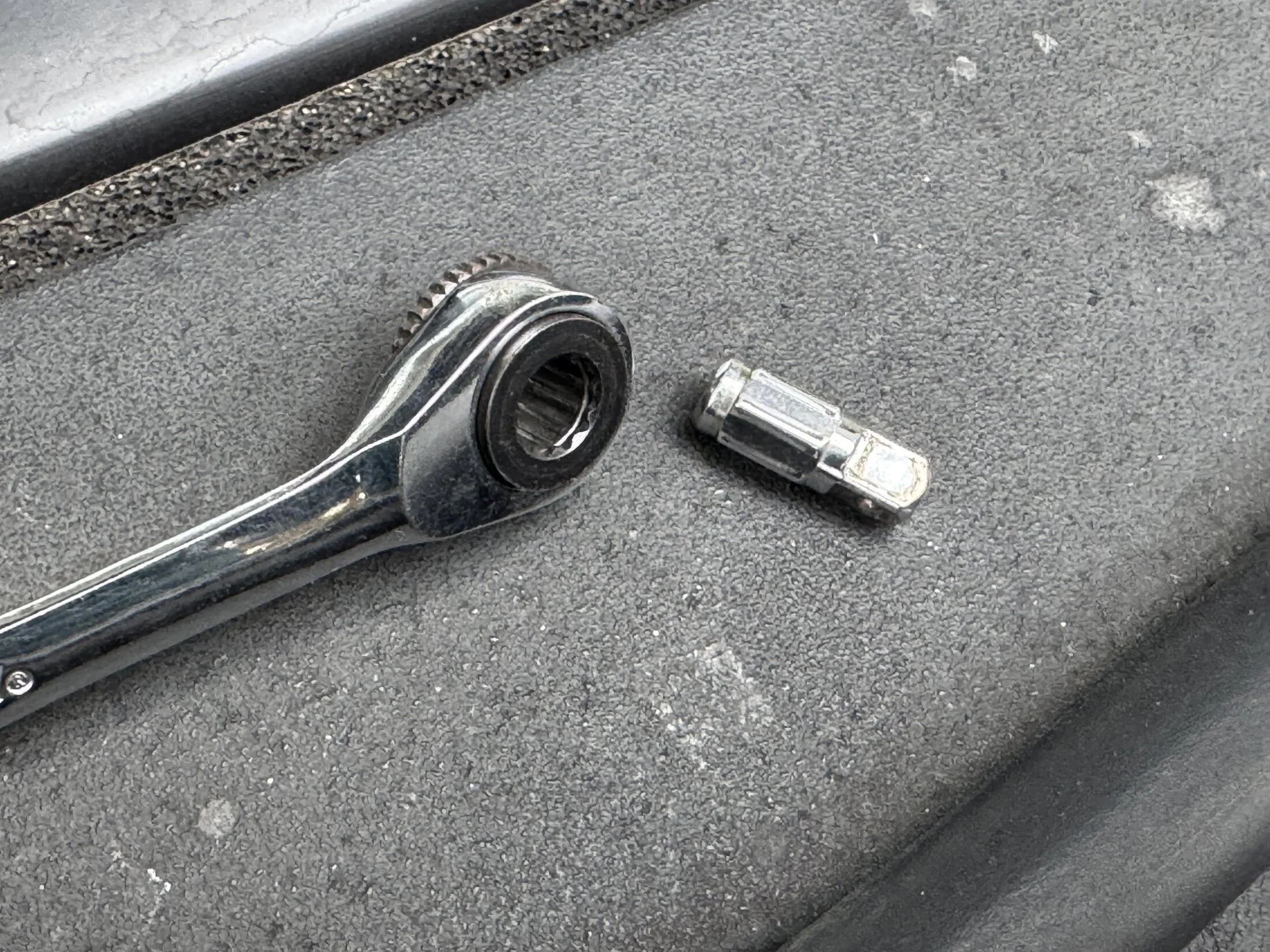

The tool I mentioned has come in very handy over the years. I got it at home depot via the Husky brand. It has a 1/4" and 5/16" female hex ratcheting ends.. the smaller is perfect for putting a driver bit into and having a short distance from the screw head to the height of the tool. Also the other 5/16" end has come in useful when toyota put an 8mm bolt in close proximity to something.. like the high beam adjuster on the driver's side headlamp.
You can even insert 1/4" bits through the other way to have the bent handle point back in the direction of the screw.. a few times this was a huge time-saver.
Gear box
