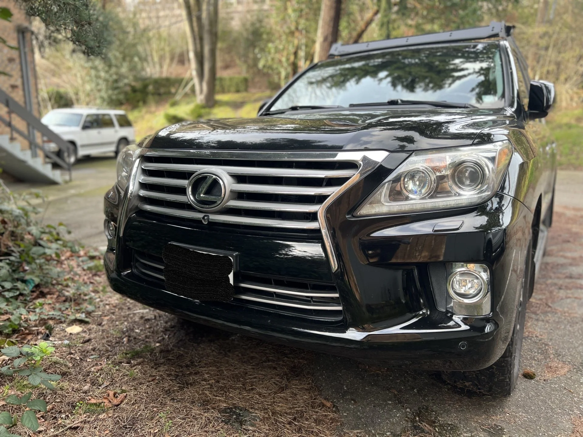

Hey folks, thanks for contributing to this thread. I have LX570 '14 and my question is - has anyone tried to put LEDs instead of OEM low and/or high beams? I am not happy especially with low beams, even though they are HIDs. Do they loose brightness with time? Would replacing them with new HIDs help? I'd ideally want to swap both low and high beams for LEDs (unless replacing low beams with new HIDs can give similar light output), but I am not sure if this would be an easy swap, or if I need to buy some other bulb covers/lids.
I am basically looking to get the brightest light out of both low and high beams in my car. I'll be adding roof single row LED bar + probably ditch lights, but I still want to have the best road lights possible.
Any advice much appreciated. Thanks guys.

Old bulbs can get dull, but how many miles are on this truck? I’m not sure new factory bulbs would get what you are looking for. Are your lenses clear or faded from sun?
I’m very happy with both the expensive Philips xtremevision in my cruiser and the cheaper osram nightbreakers in my DD. I can’t imagine any LED conversion putting the light in a useful place.. many of the LED bulbs make copious amounts of light, but it doesn’t end up being as usable as stock because they can’t put the emitting element exactly where it was in the factory incandescent bulb. And for example when you consider that it’s often 2 inches from the bulb to the reflector then that beam must be sent out 100 yards, very small changes in emitter position have a huge effect on light pattern on the road.
Hi @bloc, thanks for quick answer. Car has 145k miles and I don't know when was the last time that bulbs were replaced. I cleaned headlights with special kit and removed 99% of oxidation from lenses. They still seem to have some kind of layer of whatever it is (looks like dust) on the inner side, but I don't want to get into removing the whole assembly and so on. I don't think it plays a very significant role in light output, it's more of a cosmetic issue visible at night.
I get your explanation with importance of bulb placement, 100% agreed. I'll try to replace them with new HIDs then and see if it gets better or not. Thanks for your input.
