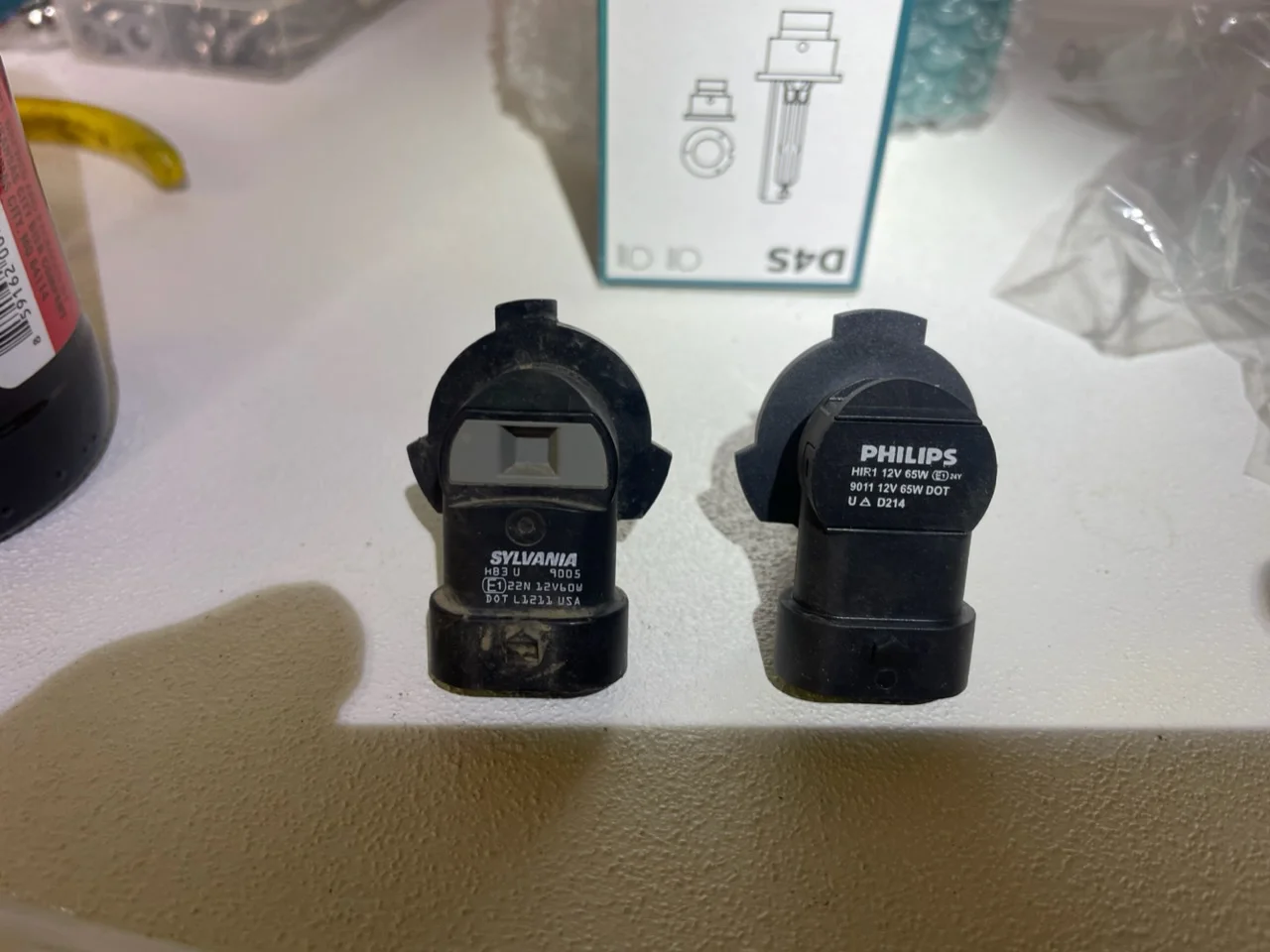

Installed I HIDs and new high beams today. Struggled a bit with the HIDs as it was very hard to rotate the heat sink/covers to get them off and same for putting them back on. I had to use a bit of dielectric grease on the new gaskets to get them on. RTH - HID replacement - https://forum.ih8mud.com/threads/rth-hid-replacement.1306262/

are not right for the 200. The tabs are 90 degrees off so you cant get the plugs back on. I used a dremil to trim one fat tab to make them fit.
That is just the process for fitting 9011 HIR bulbs into 9005/6 housings and documented well online.
A toenail clipper does a great job with trimming the relevant part.

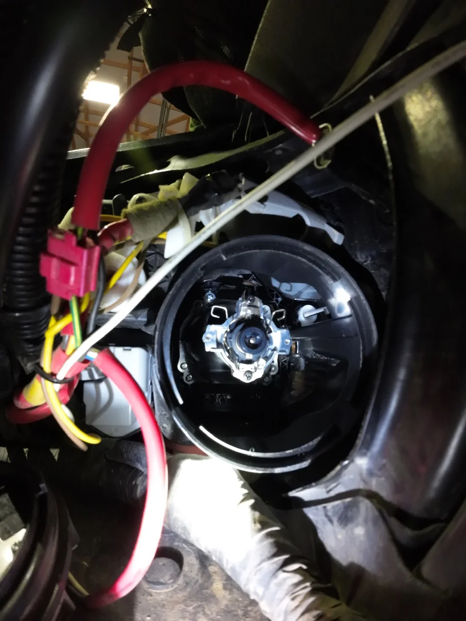

When I replaced my HIDs this last weekend I had trouble figuring out how to release the spring because I couldn’t really see what it looked like in there. All I could do is feel around so I used my new DJI Action 2 to cast video to my phone. I couldn’t get my head in there but the camera is small. Here’s a pic of what it looks like. After seeing that, it was easy for me to understand how to release the spring.
