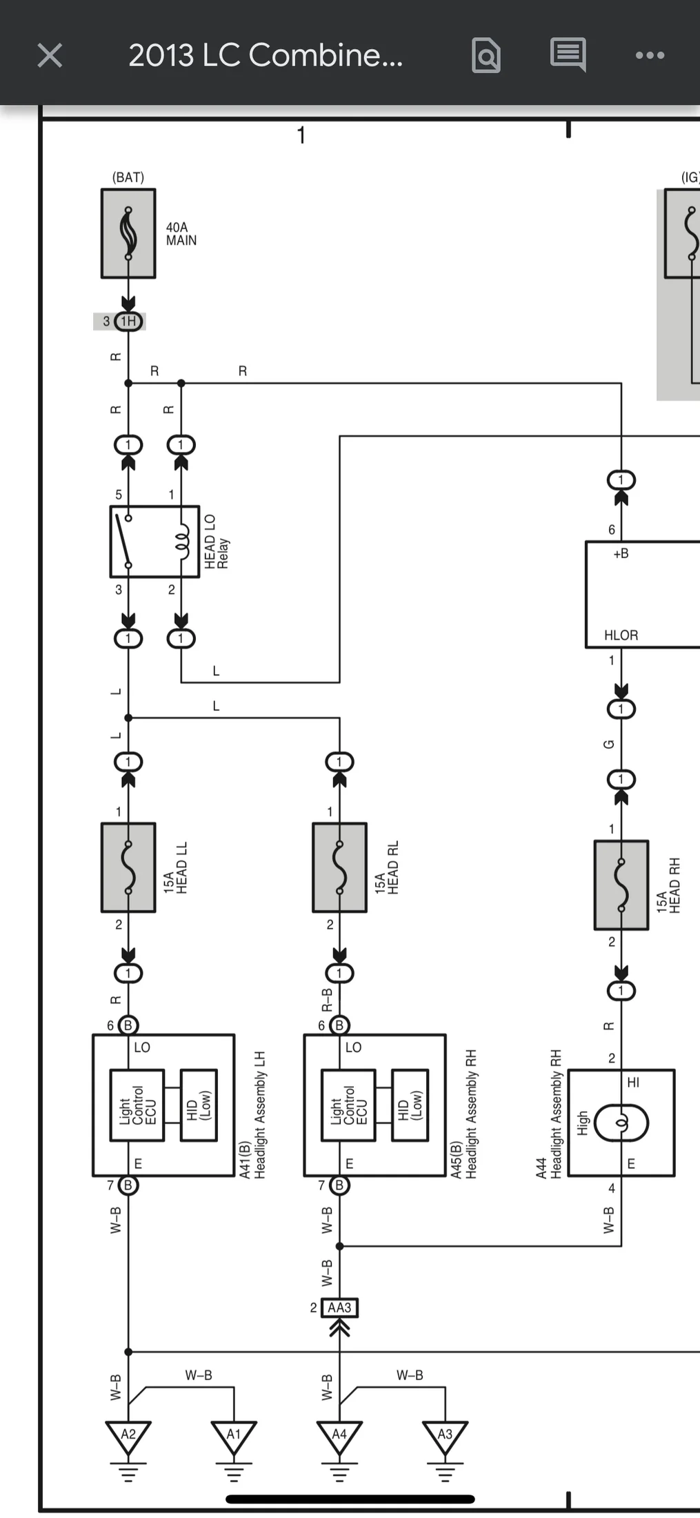

Posted this as a reply to someone having a similar issue but thought id make a new thread for visibility. 2013 LX570 that I picked up a year ago. Drivers side headlight was flickering occasionally and got worse until it gave out recently. Replaced the bulb, did not work. In my case, the fuse was blown. Thought it might have been because of the bad bulb. Replaced the bulb and the fuse and it started but flickered and died. Fuse blew again. Checked the pins on the switch under the steering wheel and it all looked fine. No noticeable damage to wiring. Also right headlight working fine. Took it to a regular shop and they told me it’s probably the balancer/ballast/igniter and to take it to the dealer without actually looking at it as they said it could be another issue.
Lexus tech said that it was not throwing any codes, he swapped the balancer to the right and it was working fine. Said it’s an issue with the headlight itself. Wants to charge $3000 to replace headlight and balancer on drivers side only. Does not make sense to me. Thinking about replacing myself if I have to as dealer wants to charge $3k, but before that I don’t understand why it could be headlight. All other fused connections for headlight (high beam, DRL, motor) are separate fused connections. Low beam path seems to be battery to switch to fuse to ballast to bulb. It has to be something in that chain and not the headlight. I don’t have the schematic but if someone does, can you advise if the headlight replacement makes sense or if I should just need to replace the ballast? PFA
Here’s a link to wiring diagrams and a fuse location spreadsheet. Fo 2013 LC. Not sure of LX differences.

Dealer said there was a control unit integrated into the headlight that was the issue. Circuit diagrams linked above seem to bear that out. Given that it was not just the flickering and that the fuse blew twice seems to be a grounding issue that either points to that control unit, or the ballast or the wiring. Can’t find any damage to the wiring or evidence of mice. Also, live in suburbia and not the country. So process of elimination says ballast or control unit in headlight. Just my thoughts, not a pro by any means. Happy for another opinion.
Update. Based on the information in this thread and another, decided to call BS on the service technician and service advisor and declined the replacement of the headlight and just took the car home. Paid $30 for a new ballast from Amazon and replaced the fuse. Issue fixed. Saved myself $2970. Had them refund me the diagnostic fee but I’m not going to get back the 6 hours I spent at the dealership. Also, just to confirm, contrary to what I said above, the light control ecu in the circuit diagram above is actually the ballast, also called computer assembly on some parts websites. There is no circuitry or controller in the headlight assembly part itself for 2013 LX570.
