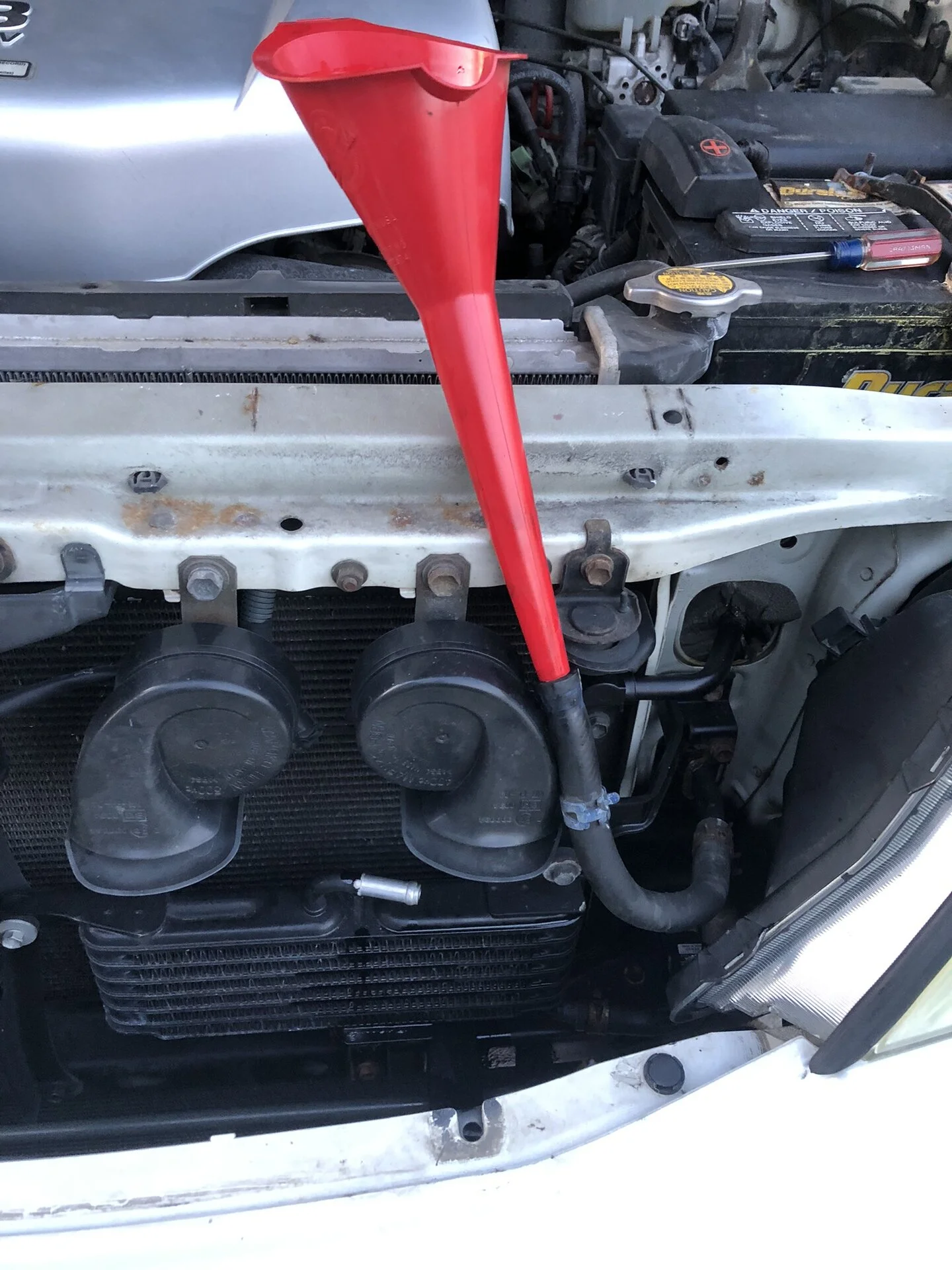

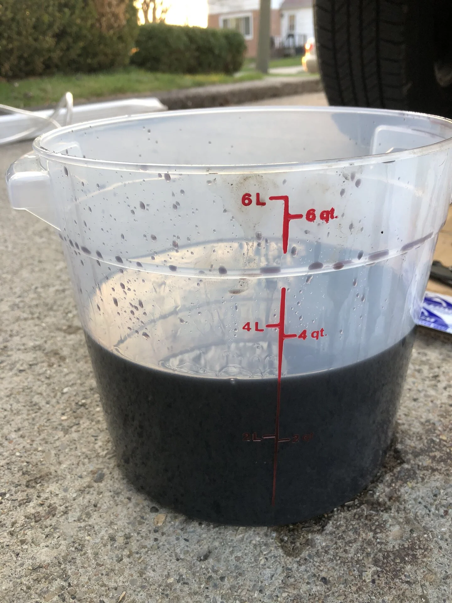

How are you Emptying the Torque Converter to Avoid Contamination? Dilution>Flush all Day
200K Miles - likely Original Oil - 3 Qts pumped out by Tranny
Replaced Same Amount.
