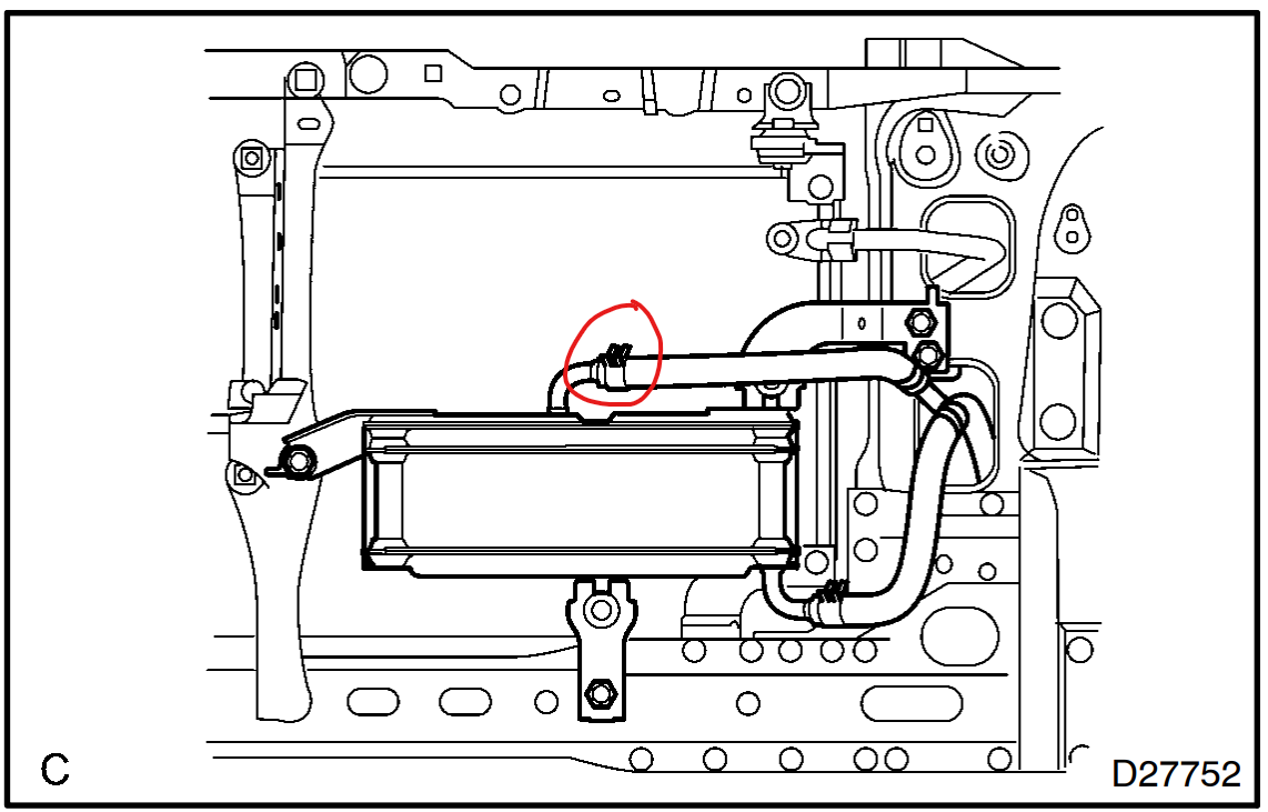

1. Remove the upper line on the transmission cooler (circled in picture attached) and zip tie line up and out of the way. (very little fluid should come out ~ a drop or so)
2. Add your 3 ft drain line to the upper cooler fitting and route it into the empty dirty fluid beaker in front of the car.
