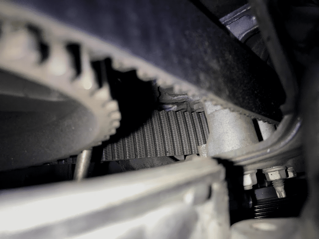

The timing belt picture has a little shine to the outside edge of the belt like there might be some oil on it, did/do you see this too?
That belt doesn't look new, but it can be hard to say. I changed my neighbors timing belt and the works with him and at 180k his belt looked perfect. He's the original owner and never knew it was something to change until he came over when I was doing mine.
That's just a glare from the light. After a little more research here, I got better views from the right side access cover. I know you all know these details and the info is repeated here many times, but my memory is a sieve and my patience for searching here is limited, so I'm documenting in my own thread :)
  • On the airbox, open up the air filter cover, detach MAF, unscrew 2 10mm bolts, remove 4 hoses, remove clip at the throttle body, remove airbox.
  • On the timing belt access cover, remove 4 10mm bolts. The odd one in the middle is not detachable from the cover (I think... and so far I haven't figured out the sequence to completely move the cover out of the way).
OK, so here are a few shots. No visible cracks. Teeth look unworn and fit nicely into the grooves. I did not turn the crank (can I?) so was not able to find any manufacturer markings.
Would it be reasonable to conclude based on this visual inspection that it has been replaced? If so, I'm thinking it has AT MOST 35k miles on it, given Lexus maintenance history up to 100k miles does not mention a timing belt and the current mileage is 135k.

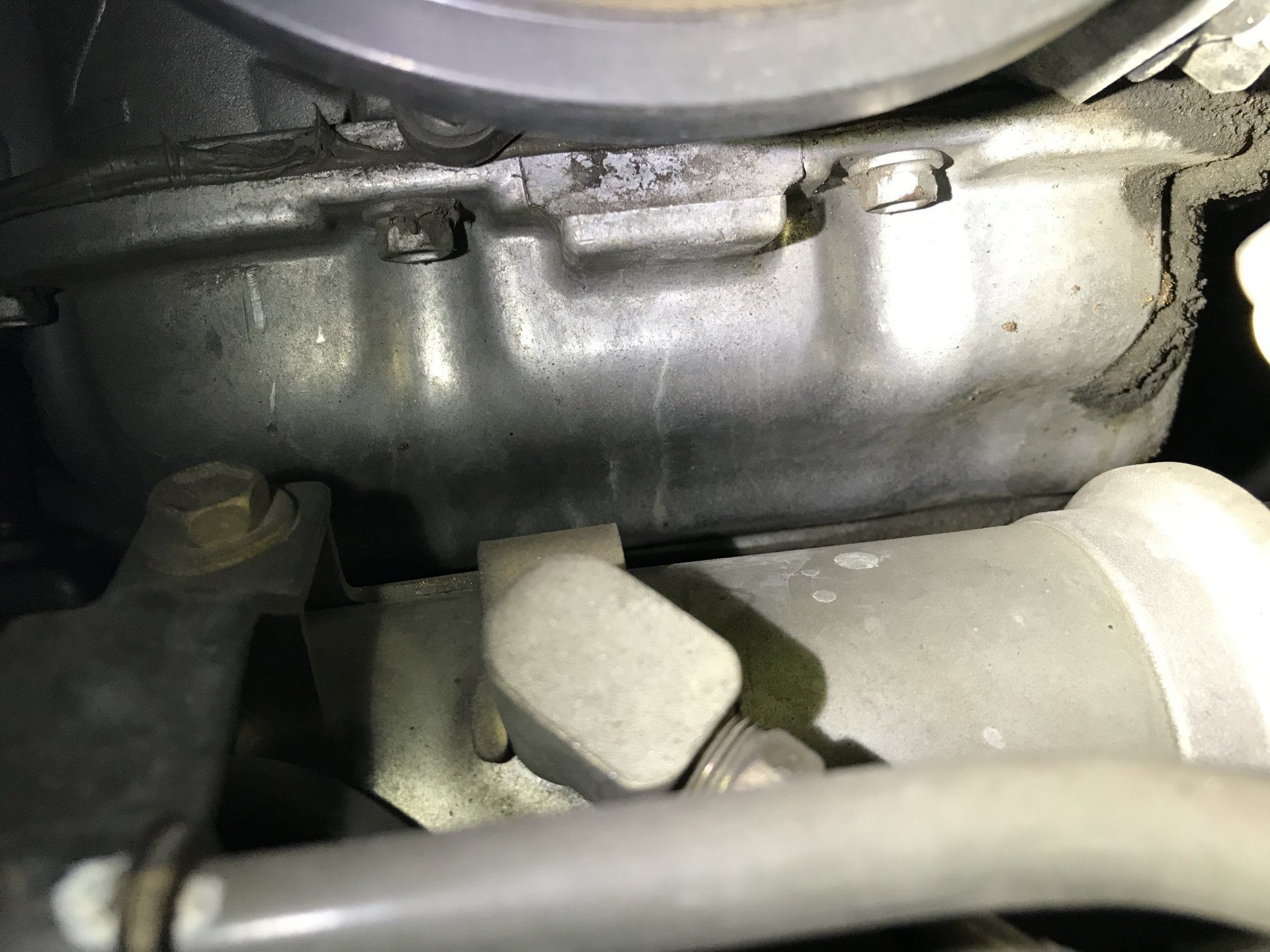

I’ll assume a non response about my timing belt inspection means there is no immediate alarm. So moving on to another topic.
How do you inspect the water pump for leaks? Dealer said it is “weeping”.
I took the skid plate off and peeked from under. I know pink is bad and I didn’t notice any so I’m wondering if the dealer’s assessment was based in this. Apologies for my ignorance, I’m still getting oriented.

Belt looks fine (most will). The 'concern' (if any) is usually with the water pump, the tensioner or one of the pulleys. If any of those fail (seize) then that takes out the belt.
All water pumps have a 'weep hole' that is designed to let coolant 'weep' out when/if the seal in the water pump is failing. It is meant to help WARN of an impending, more serious failure. But in reality....water pumps rarely hard fail....but do so over a long period of time. The trouble with a leaking WP on these vehicles (because of where it is located) is that the coolant gets thrown all around inside of the covers by the belt. This will eventually find its way into bearing seals (pulleys).
At the bottom of your engine near the Crank there is small slot that allows coolant and oil to escape from the timing belt area. You should be able to inspect that area and note whether it is wet. It can be a mixture of oil and coolant (not just coolant) in some cases.

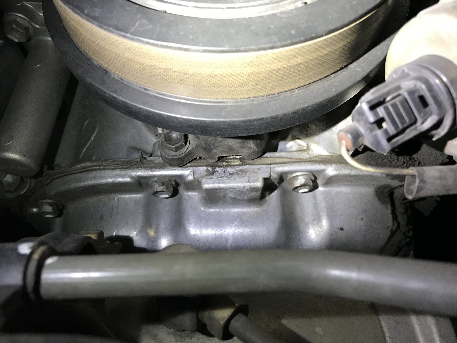

I'd ask again as it may have been missed - did any of the bolts/nuts on the covers, water pump, etc, have tool marks on them?
In the prior photo, I believe there is a decent shot of the bolts for the thermostat housing, which may show marks from prior repairs. Does that help?
The thermostat is often replaced at a different interval than the timing belt. My thermostat failed (open) after about 50k, so I replaced it - takes about 20-30 minutes including bleeding the cooling system again. Their springs weaken over time too, so if its been in there for 15 years it might have been swapped too, without doing the timing belt. You can do the thermostat without removing anything related to the timing belt.
I'd do what I could to chase down if the dealer can confirm if they did it or not by calling them. On the timing belt/cam covers I don't see any tool marks. I'd assume it hasn't been done.

From all the belts I have seen that does not look like its only 35k old. Not to alarm you, but I would start the process of either planning for self work or budget for shop replacement. They have been know to go many mile's pass your's on one belt, but to what end? Is it worth risking your new purchase? I just changed mime due to 9 years passed not mileage. What I have now is the warm feeling is that everything under the "covers" on my new to me 250K 20 year old ride is now good for another 100k. Two schools of thought, I come from the preventive medicine world. I change the timing belt on every car when i get them, that includes my 2000 RAV4 with 210k and the 1988 MR2 with 310k. some just run it till it breaks. To each there own i guess.
What exactly are you looking at to make that conclusion? Just trying to learn. Thanks
A little hard to explain but the side of the belt that you see starts to develop a "shadowing" for lack of a better term. You can see a color change that is a direct pattern to the cam teeth. While all belts get this over time, my observation is that if your belt was changed at the factory intervals of 90K It only has about 45k, seems more worn that I have seen in the past. If I was a betting man, that's the original belt. This is not to alarm you there are documented cases on this forum with 200k on a belt, but coupled with no service records from what I thought I read in your post, and no sticker under the hood. I have a 1988 MR2 that has a sticker on the hood from 1994 hard to read, but still there, plus one more and the one I put on last year. I have not met a mechanic that would not put a sticker after a T/B change just not a quality touch. So, while all that and $5 gets you a Starbucks or so I have heard, its your ride and your $$.

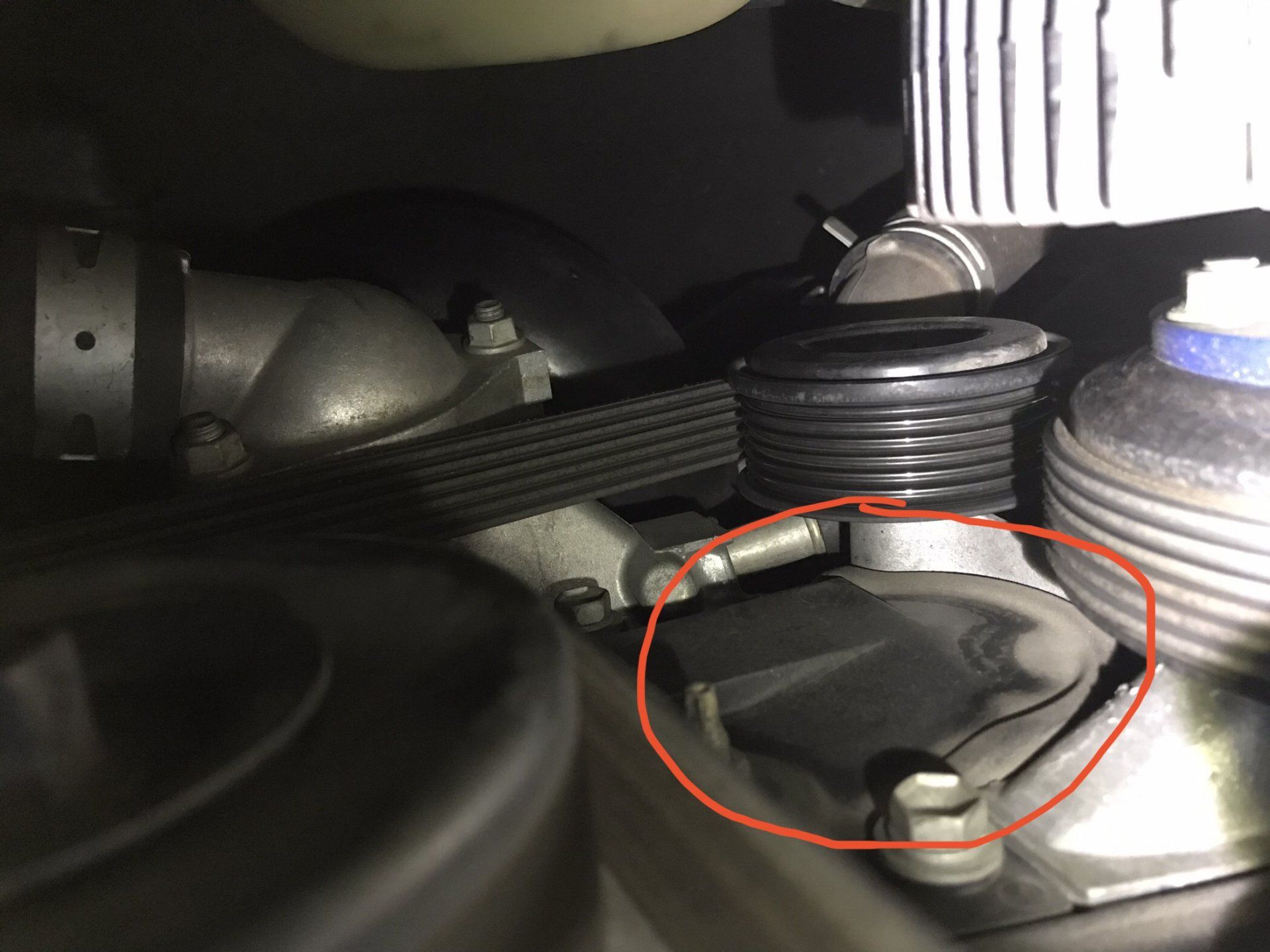

Is this the weep hole under the crank?
If so, here’s another shot of the area under that hole, looking for coolant remnants.
I am totally willing to replace the water pump, timing belt and surrounding parts for peace of mind, but I just want to get a sense of how urgent it may be. My situation seems to suggest it should be a high priority but not my absolute first.
I am totally willing to replace the water pump, timing belt and surrounding parts for peace of mind, but I just want to get a sense of how urgent it may be. Evidence seems to suggest it should be a high priority but not my absolute first.
I was not impressed with the dealers inspection report. I could have provided the same info without pulling out a tool. So I’m wondering if their recommendation for a water pump replacement was lazy and based on prior experience of this model, not an actual assessment of my car.
Yes, that is the spot and it looks bone dry to me. I would not expect to find any significant leaks from your water pump, cam seals or crank seal. Though you would not know the condition of the tensioner pulley or idlers.
