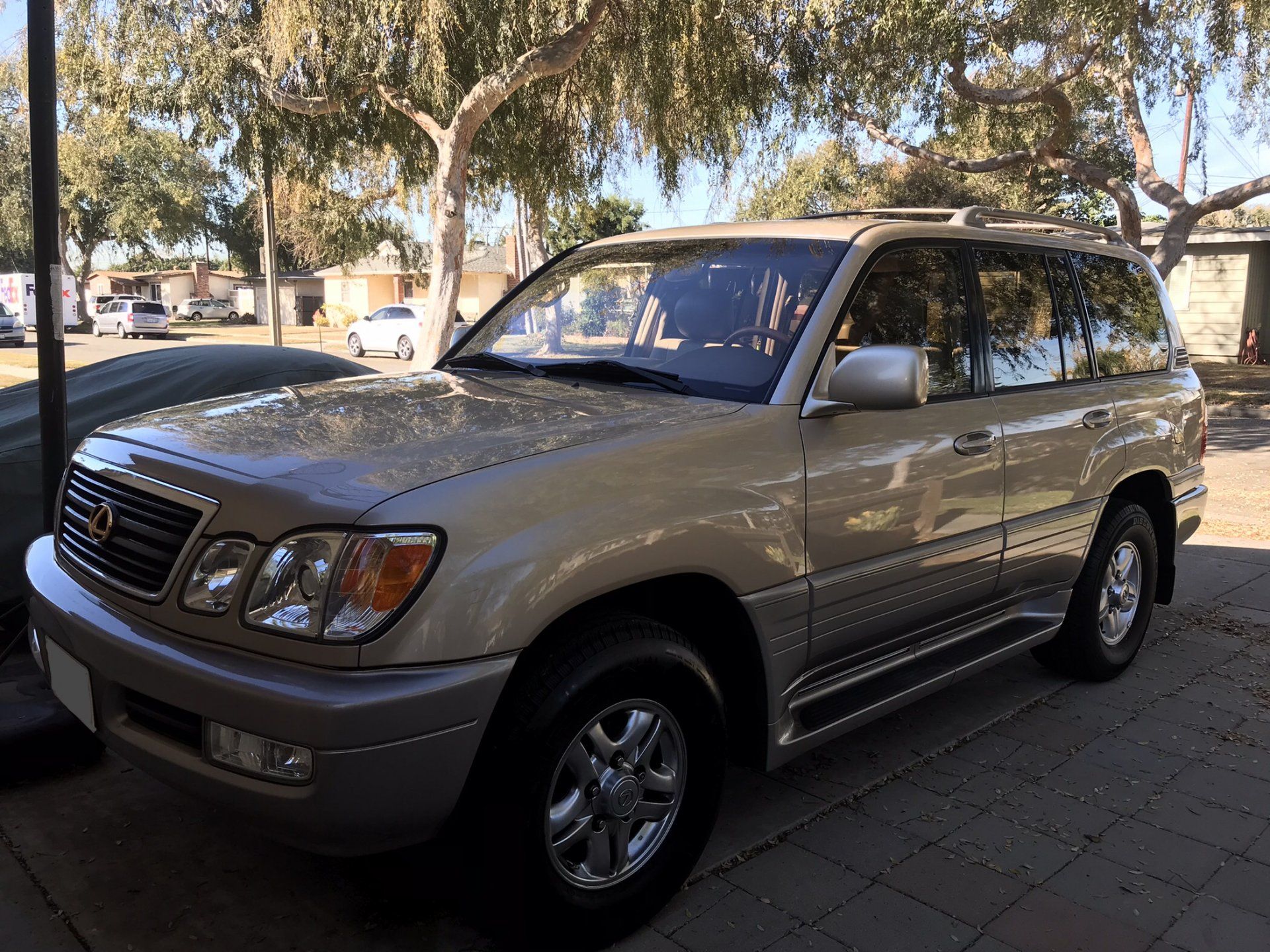

You know the story. I’ve been lurking here, wanting to buy my first 100 series, to haul the wife and kids into moderate wilderness.
With my budget constraints, I was leaning towards a Mitsubishi Montero or a newish Dodge Durango. Did the math and since I enjoy learning and hacking on my cars, I figured it was worth keeping an eye out for an LX (not a cruiser).
I think I got pretty lucky on this one. 2002 LX470 with 135k miles, negotiated for $13k.
Really clean outside. Averaged 7500 miles per year and it seems to have been all paved...
Under hood is like a new car. Do people detail their engine, maybe for selling?

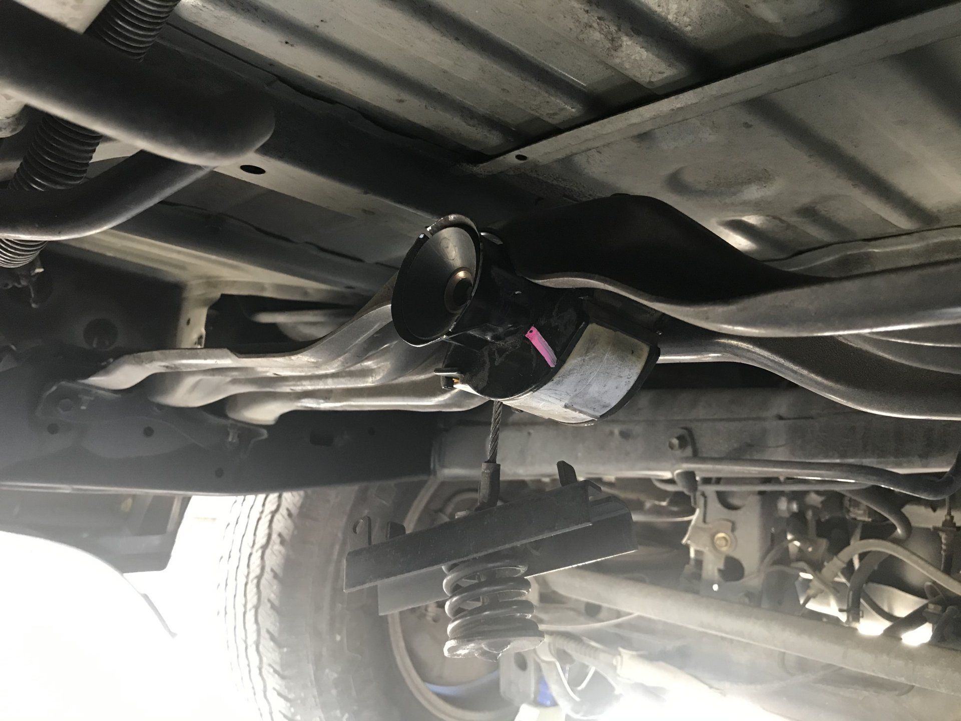

Undercarriage is clean too. Other than the exhaust, there are only a few specks of rust.

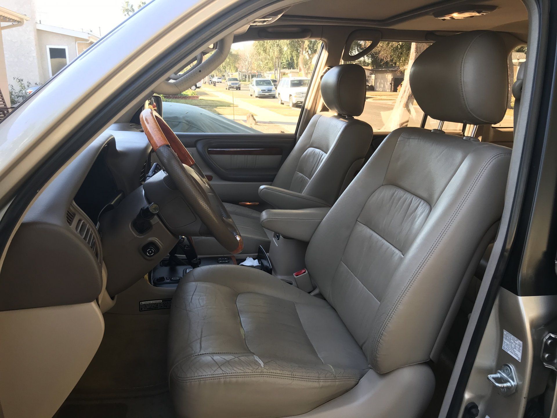

Most obvious sign of age are the ripped front seats but I can totally live with that!
Brought it to a Lexus dealer for an inspection and they said the water pump and a shock is seeping but otherwise solid. I don’t have the PO’s maintenance history so I’ll be doing some sleuthing and asking question of you smart and experienced folks.
FYI I’m fully expecting the unexpected because I’m usually not this lucky. But until then, my biggest issue is having people judge me as a Lexus owner since I’m more of a beater car guy! I bought this not because it’s a luxury vehicle, but because it’s a 4x4, so I guess I need to find some trails and dirty this up!

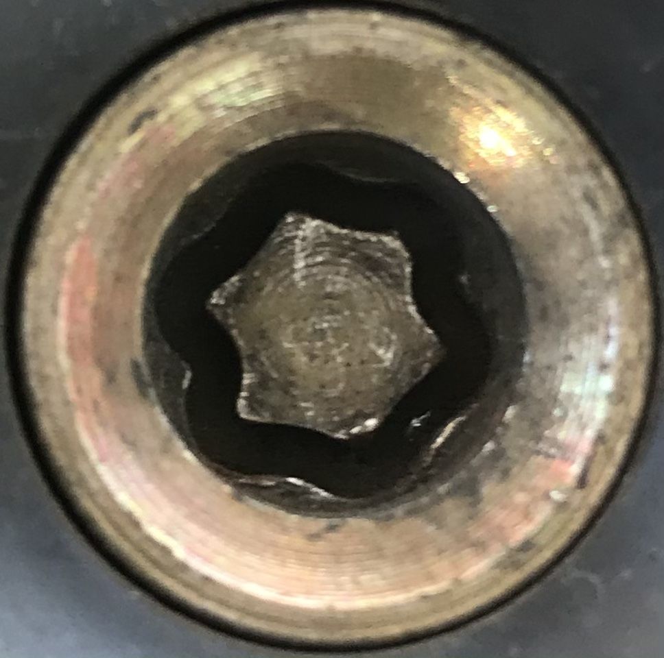

Oh wait. How do I lower the spare tire? I haven’t gotten to that part of the owners manual yet! But I know there’s a hoist since I’ve had cars like this before so I’m thinking roadside service can handle it.
Oh wait. What’s this about a special key for lowering the spare? I don’t have the jack, the crank, nor the key.
Four hours later, the tow truck drops her off at home and my neighbors are probably thinking I bought a lemon!
Thanks to this forum, I figured out I can unbolt the hoist from the crossmember to access the spare. So that becomes my first “repair” on this car. I suppose it’s a nice easy first task.
Here is the hoist installed back on with the spare removed.
I am back on the road now and my next task on this car will probably be to pry that lock off the hoist! Note my avatar... which is a little reminder of my introduction into this LX world :)

Dang man , I just found out about that stupid little locking thing for the spare when I was building my rear bumper. I searched all over the truck for that thing and thought I was boned. Then I found it tucked into a pocket in the tool kit.
I don't need mine anymore if you want it.....

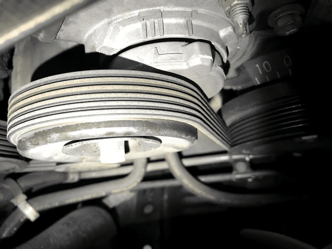

I did not see those stickers that show when it was replaced, but upon inspection it looks pretty good. Is this likely relatively new? I would think if it had 135k original miles on it, it would be a bit more cracked.
Take a look at the heads on the nuts and bolts on the tensioner, water pump, cam covers, fan clutch, etc. For tool marks to indicate someone has been in there before.
That’s the serpentine belt. You need to have a look at the timing belt behind that, hidden under the inspection covers.
