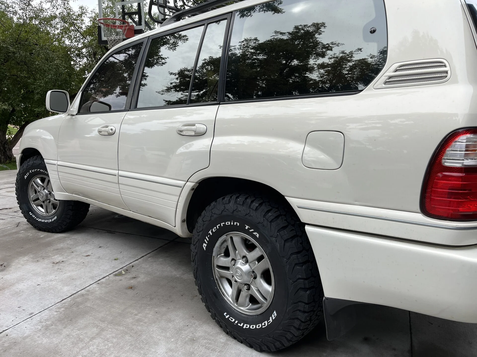

  • Tires (wants 33’s and different wheels)

  • Wheels (Maybe find some Tundra wheels for cheap? Maybe paint them?)

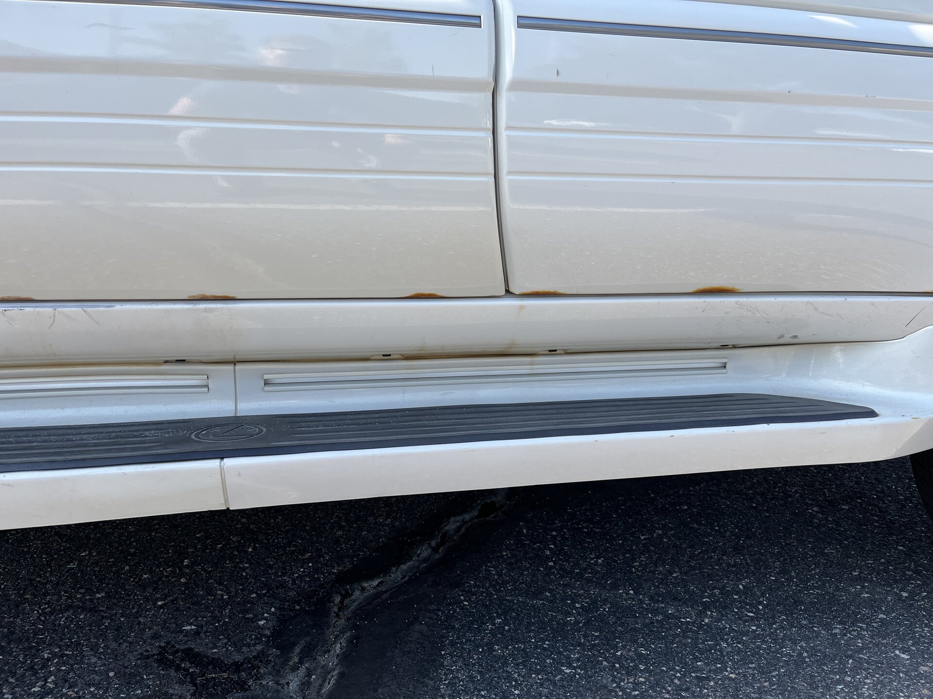

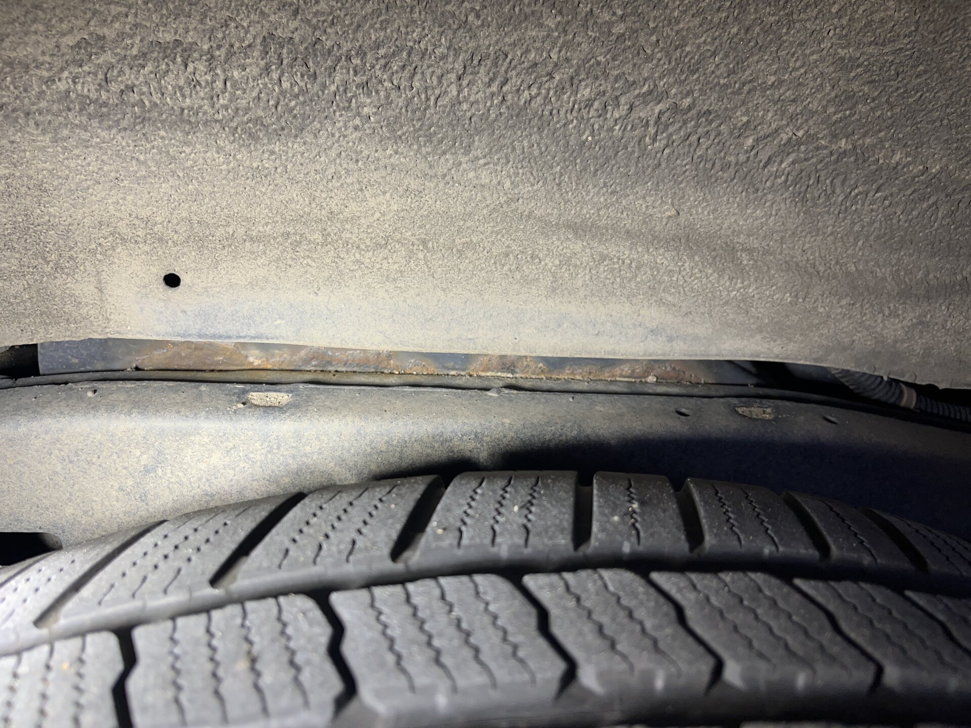

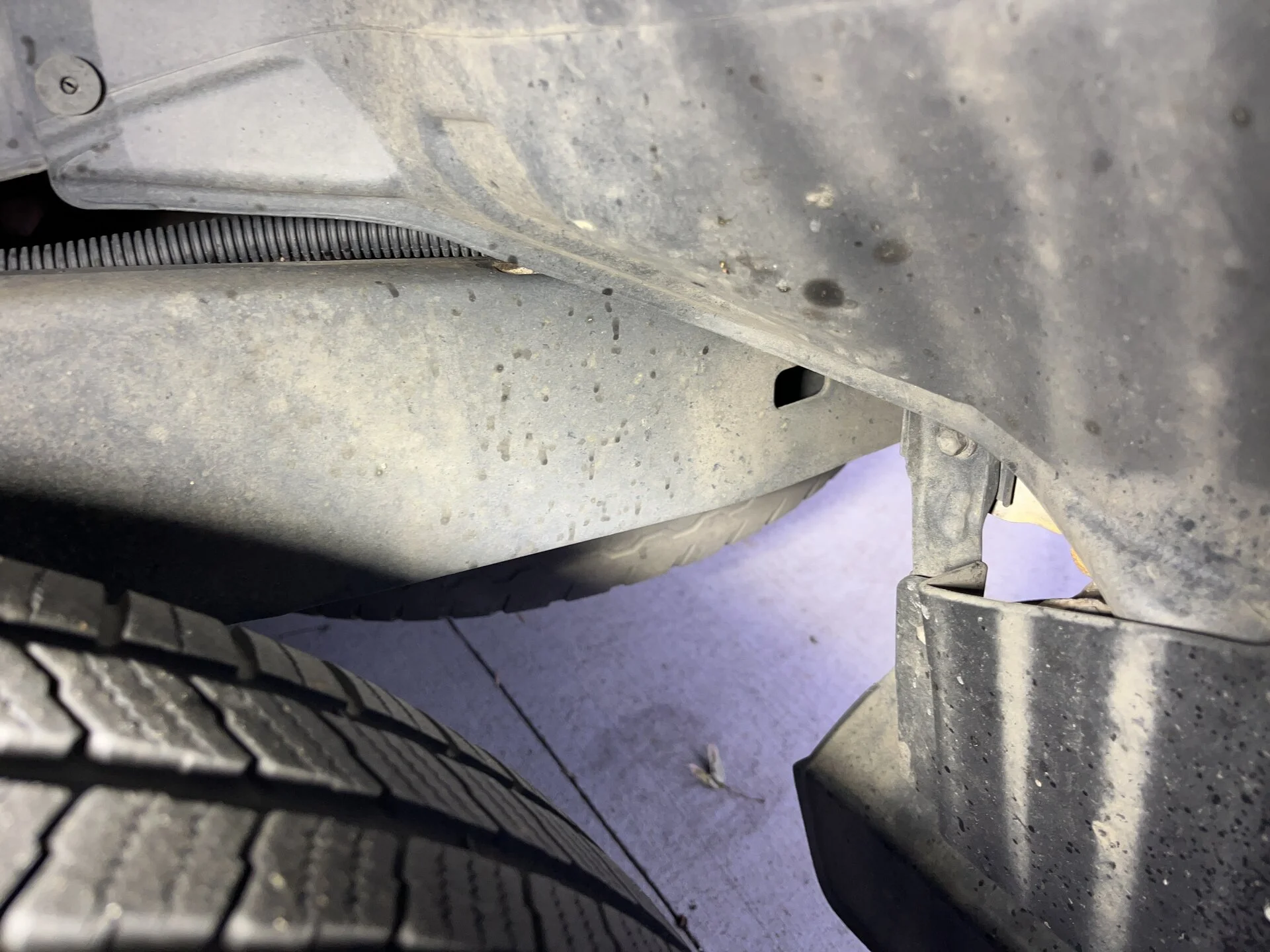

  • Grind out rust at bottom of driver’s side doors (replace window seals? where is the water coming from?)

I know a lot of folks happy with both Method wheels and ICONs

Don't go after your doors with a grinder....
The rust stains on the door bottoms are from the steel door cladding clips dissolving and rusting away. I would lie on your back under the half-open door, and gently pull the cladding away and inspect what's left of the clips and sweep out all the rusty bits. You can use something like naval jelly (phosphoric acid) to convert the stains on the door paint. They should disappear, but be sure to clean the paint well after doing this.
Then, you can choose to use something like urethane adhesive (PL series from Home Depot), and glue the cladding back to the door with a few large blobs of adhesive. The cladding clips are not sold separately and and removing and reinstalling the cladding is non-trivial. I have removed and reinstalled various cladding and ordered the clips (those that are plastic and are still available) and it's a great way to shoot a day screwing around.
Wow, certainly hope that’s the case. It feels swollen there, so I assumed it was rusting under the paint and puffing it out. But we will check it out exactly as you describe. Thanks Steve!

Huge congrats And welcome! As for wheels, yes on Tundra and Land Cruiser. I would suggest looking at pics from 98-07 and see if there are any you like. If you do, then try some place like car hyphen part dot com (salvage yard website) you should be able to find them for less than $100 each. Or check classifieds. Good luck with the project and hope you update us along the way.
