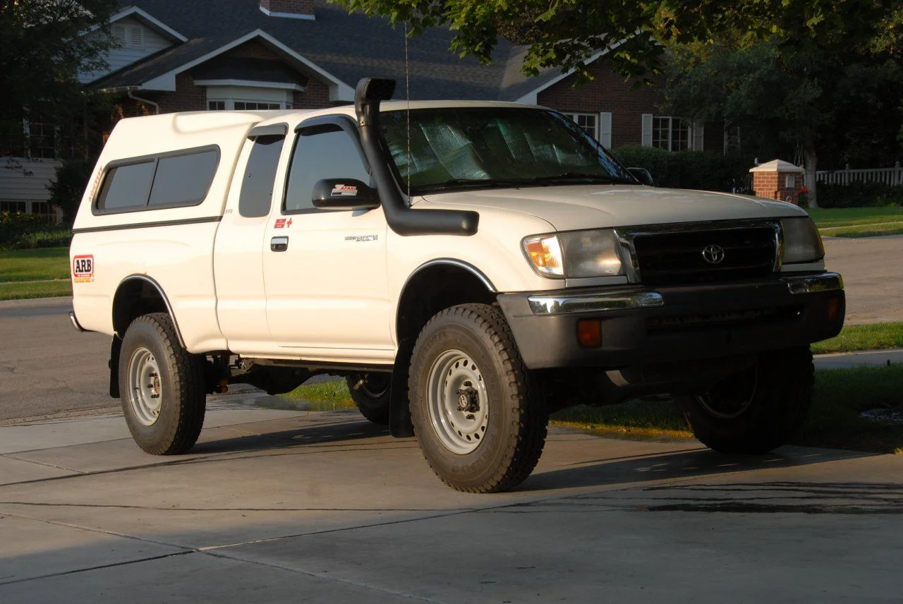

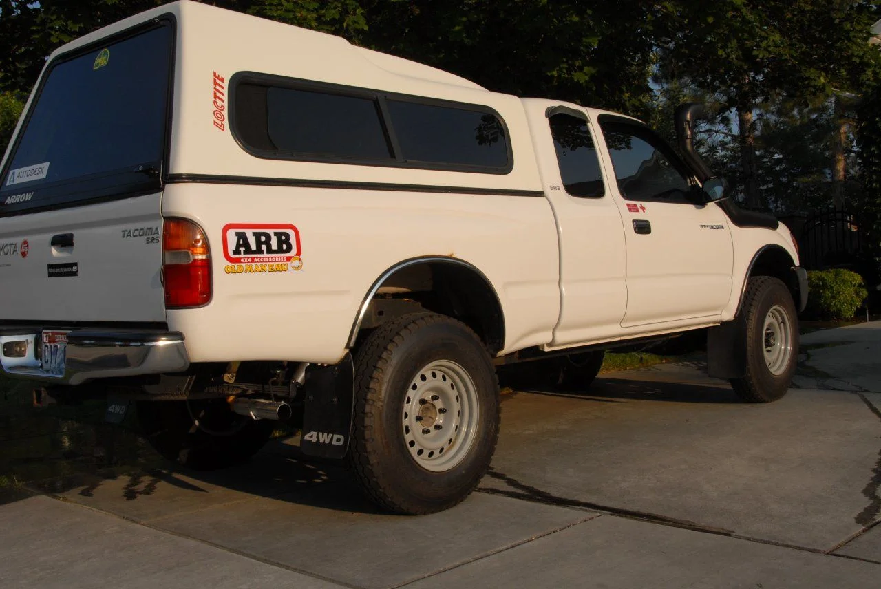

Been a while since I posted any updates on my Tacoma. With the truck turning 150k miles old and the recently upgraded suspension I figured now was as good a time as any.
Huge thanks to Kurt @cruiseroutfit who helped me get set up with the OME lift. Cruiser Outfitters customer service is top notch and answered all my questions regarding the lift. It rides so much nicer than my tired stock suspension and it gives the truck a great stance.
I found a set of 16x7 steel rims and had them powder coated at Les Schwab and fitted some 7.50R16 tyres to them. I love the tall skinny profile and for the off-roading I do, they will work perfectly.
...Huge thanks to Kurt @cruiseroutfit who helped me get set up with the OME lift. Cruiser Outfitters customer service is top notch and answered all my questions regarding the lift. It rides so much nicer than my tired stock suspension and it gives the truck a great stance.
