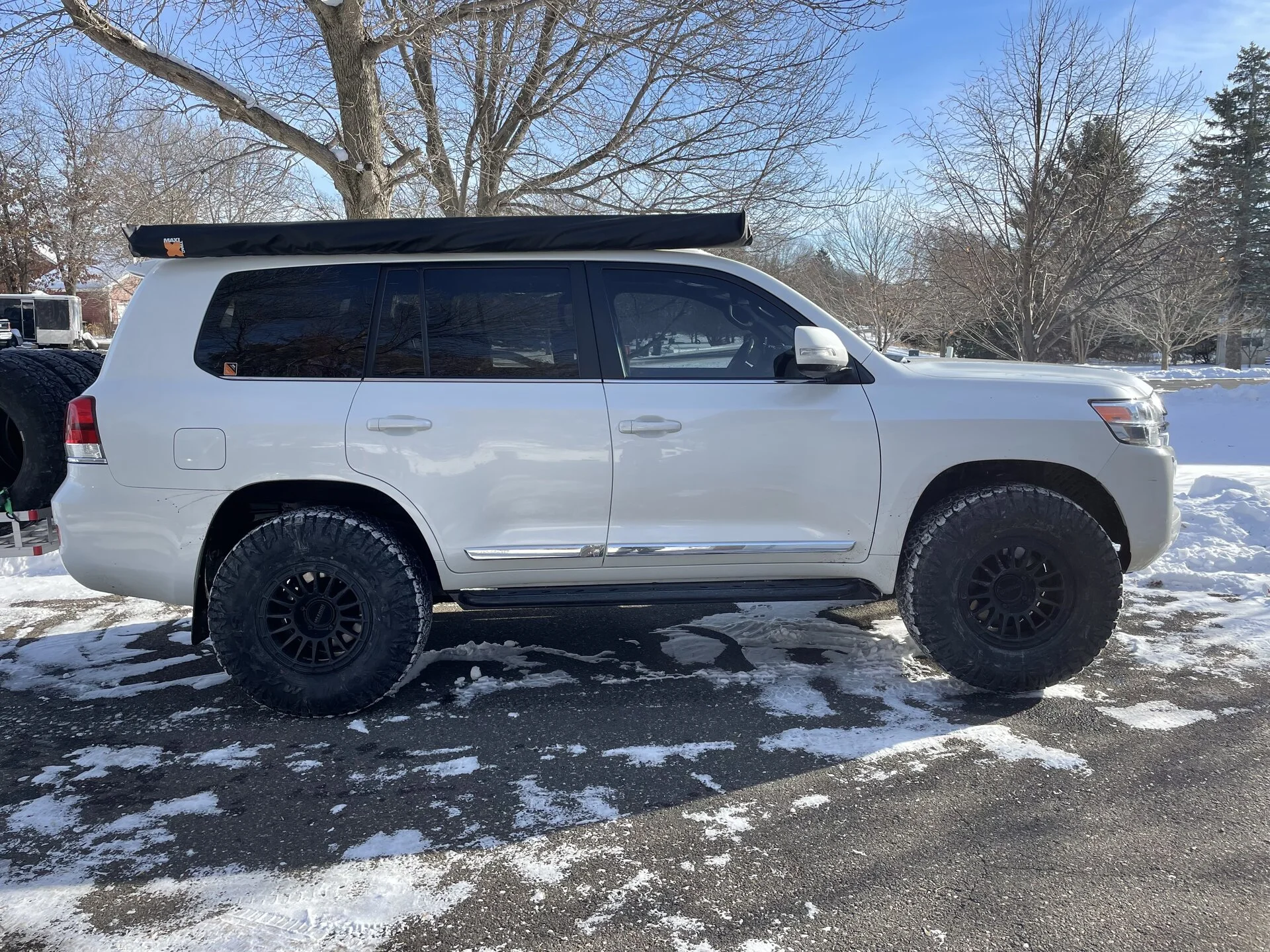

@gaijin what’s recommended tire pressure for the above setup? Thx in advance!!!
The RCTIP for those MAXXIS AT-811 RAZR AT 35X11.50R17LT 121R Load Range E on your LC200 is 35psi F/R.
HTH

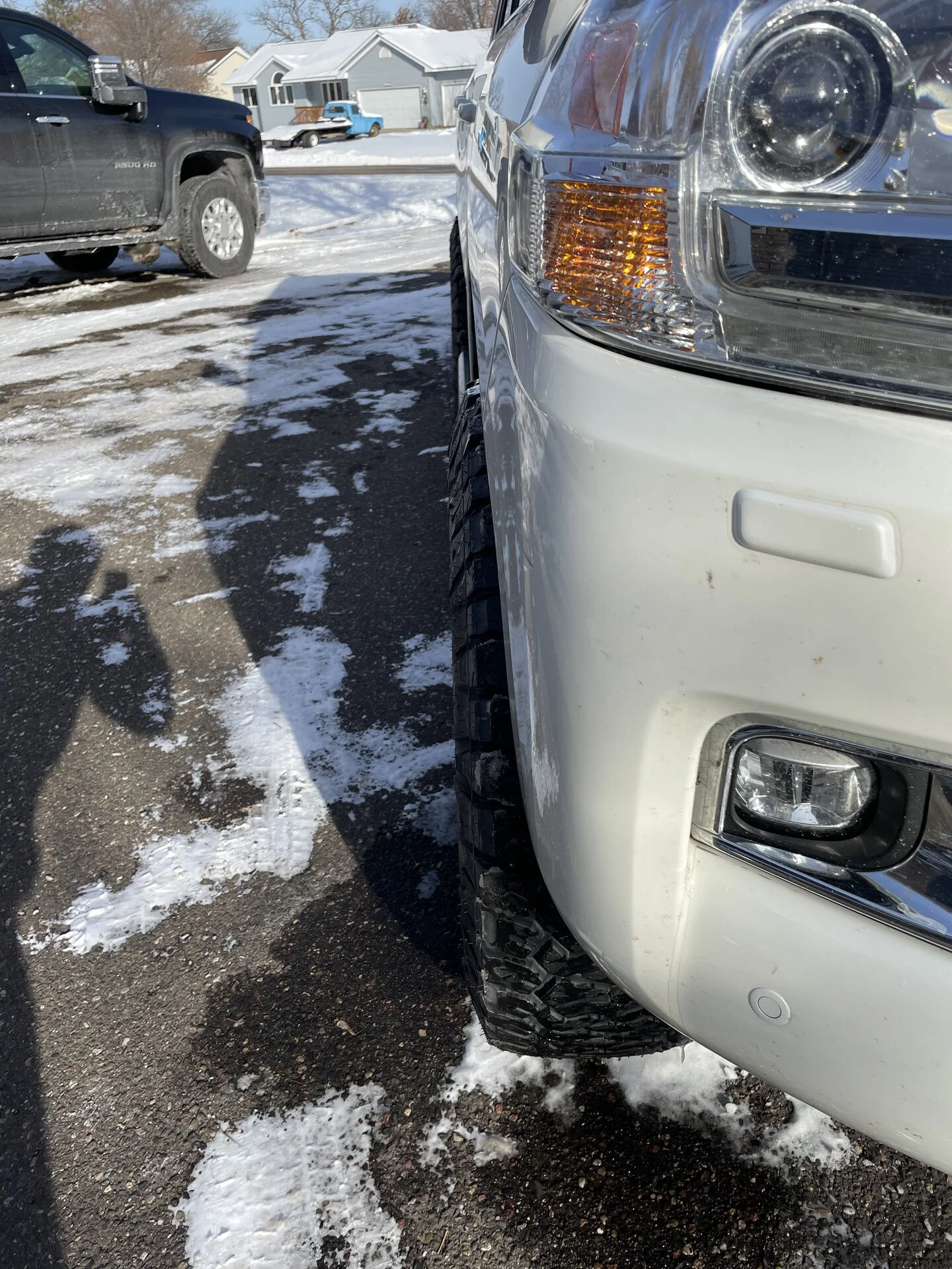

Thx! It’s only rubbing at full lock so I may just leave it as is. I’m hoping with alignment it will fix it.

Actual measurements:
33.7/8 hight
34.6 left to right measurement
Wheel is 17s 0 offset. Rubs kdss bolt driver side at full lock. Will see if alignment will help get rid of it.
Reason for for this tire is planning to run all season. Has 3 peak snowflake certified and the size for less rubbing. This required BMC and fender liners cutting and massaging.
Still need to do flex test.
Great tire option! Flotation load rating of 121 will drive nice and supple, a bit narrower to aid fitment issues.

If you take care of the wheel fenders rub it should be fine. The kdss kiss at full lock may be the only thing to worry but even then we just gotta know not to plus most of the time we’re not going full lock anyways. At least that’s how I feel and I’m only speaking of my setup.
