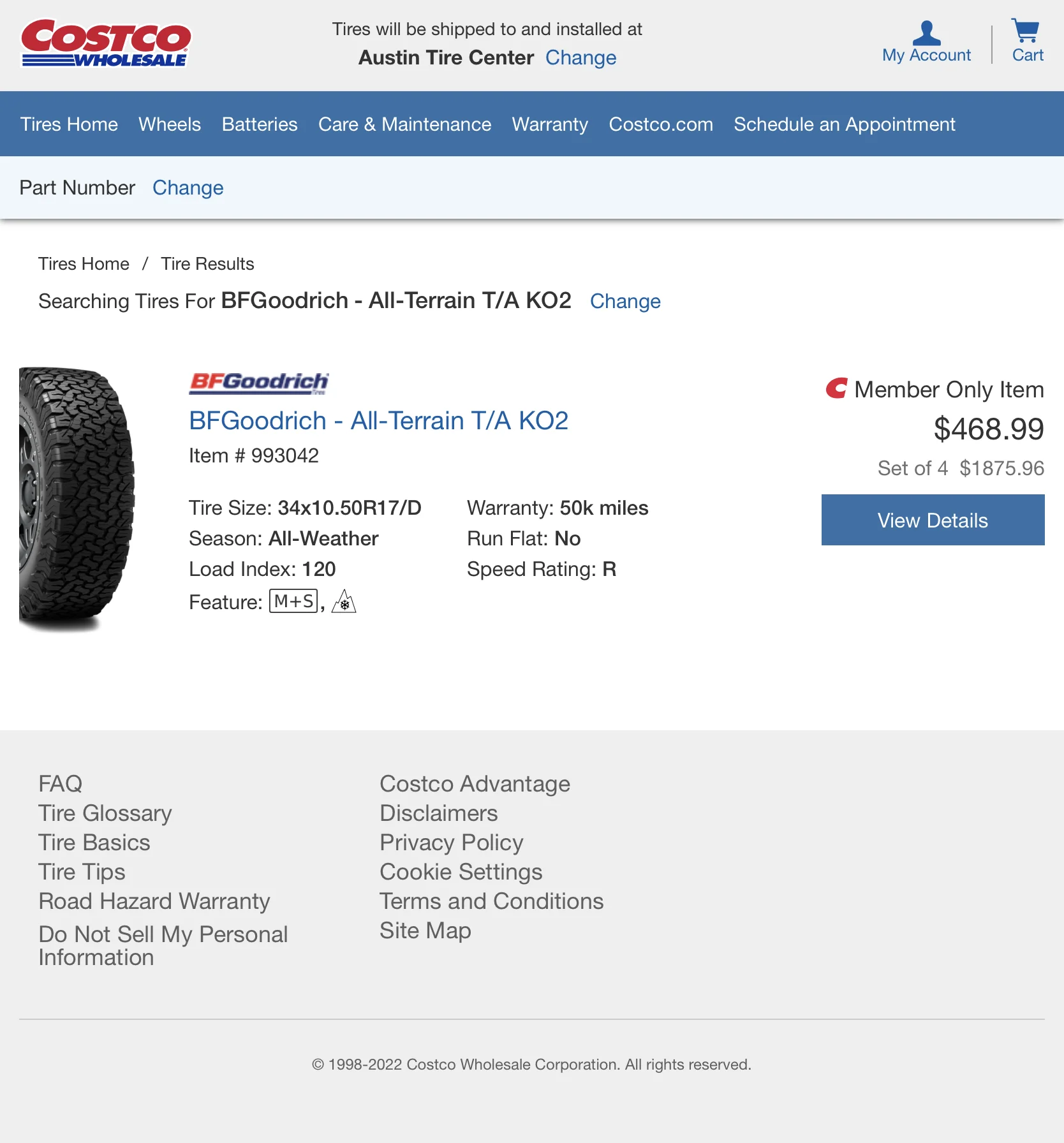

Hmmm, do the Costco returns policy apply to tires?
Price is still wild. Need 5.
a lot for 33s, but good width, D and load 120. lots to like.
<bfg measures them at 33.5, should be a good fit>
I'm betting that BFG 34x10.5 actually measures damn close to 33.
Thats the real shame here, thats like half the whole point of flotation! And the prices are ghastly.
Doubt anyone stocks it anywhere either to measure.

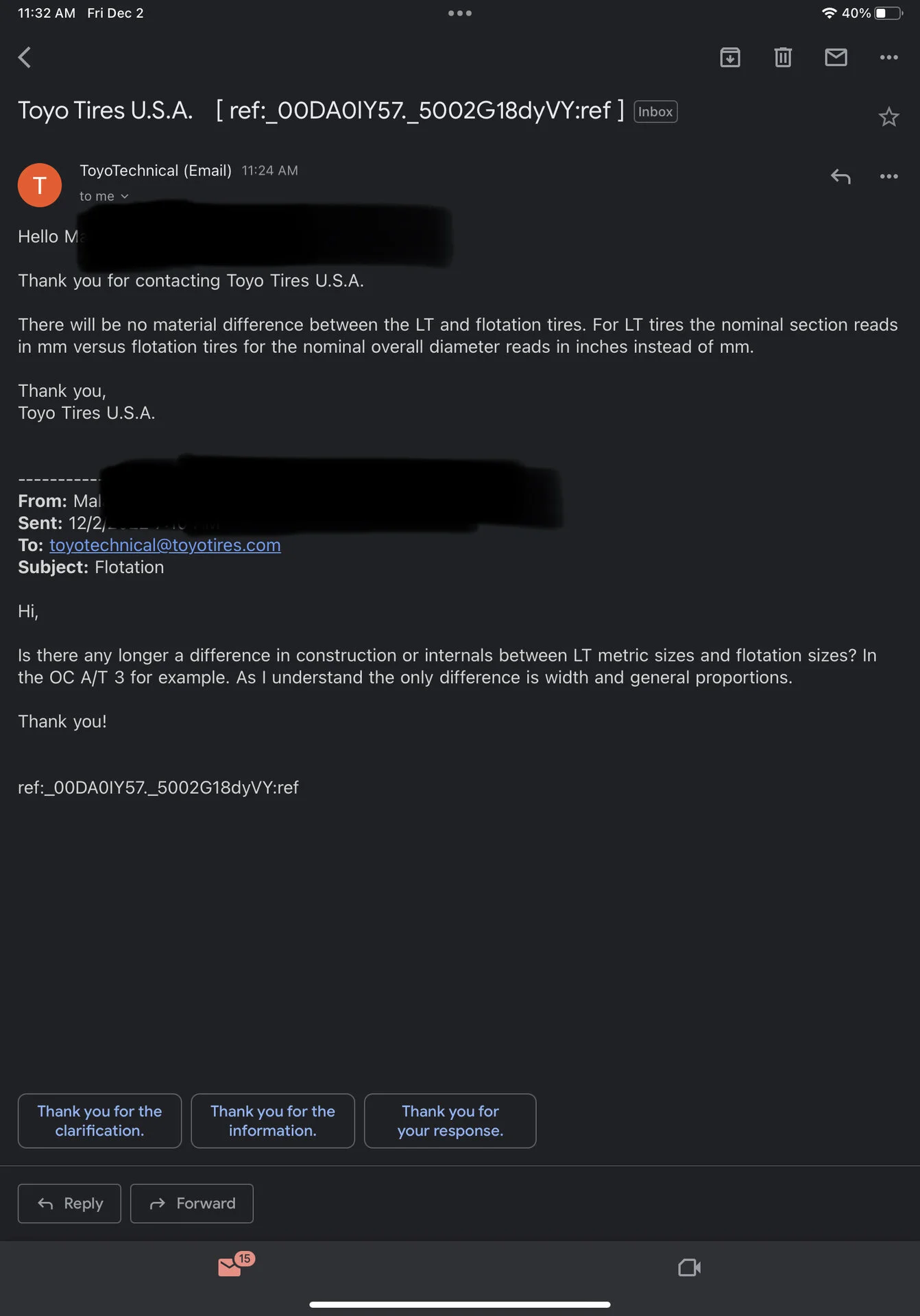

You're just making s**t up now - reading WAY more into the statements by Toyo than was actually stated.

Eh, respectfully as i can @gaijin, we will never agree so its not worth either of our time. Im not blocking you, useful info can come from anywhere, and im sure you will have interest in some stuff I do.
As far as tires go, ive made my peace with mud on this topic. I dont also care much for the court of public opinion as we will have people on all sides of the “argument”.
I just want people above 32 psi in 33” Ps so they dont die.
And one of the top Toyo guys, on this very forum, told me that himself.
Not making that up either.
I can admit when im wrong… Maybe you can too, i wont think lesser of you for it, in fact quite the opposite.
