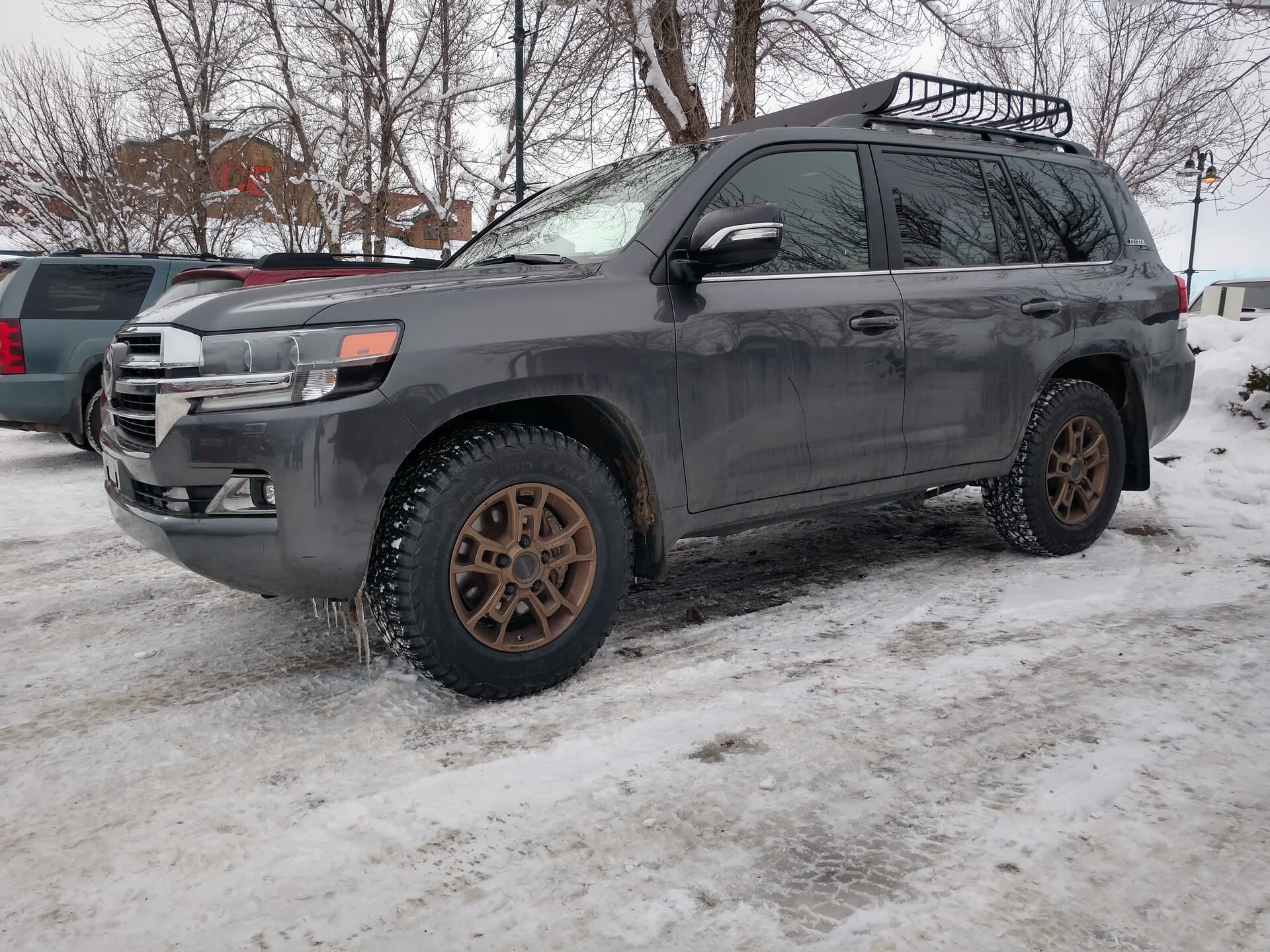

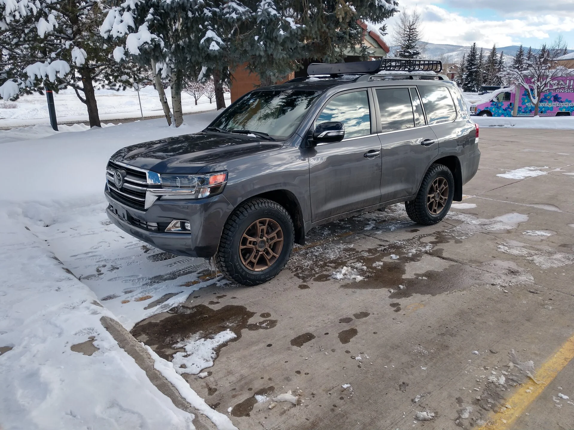

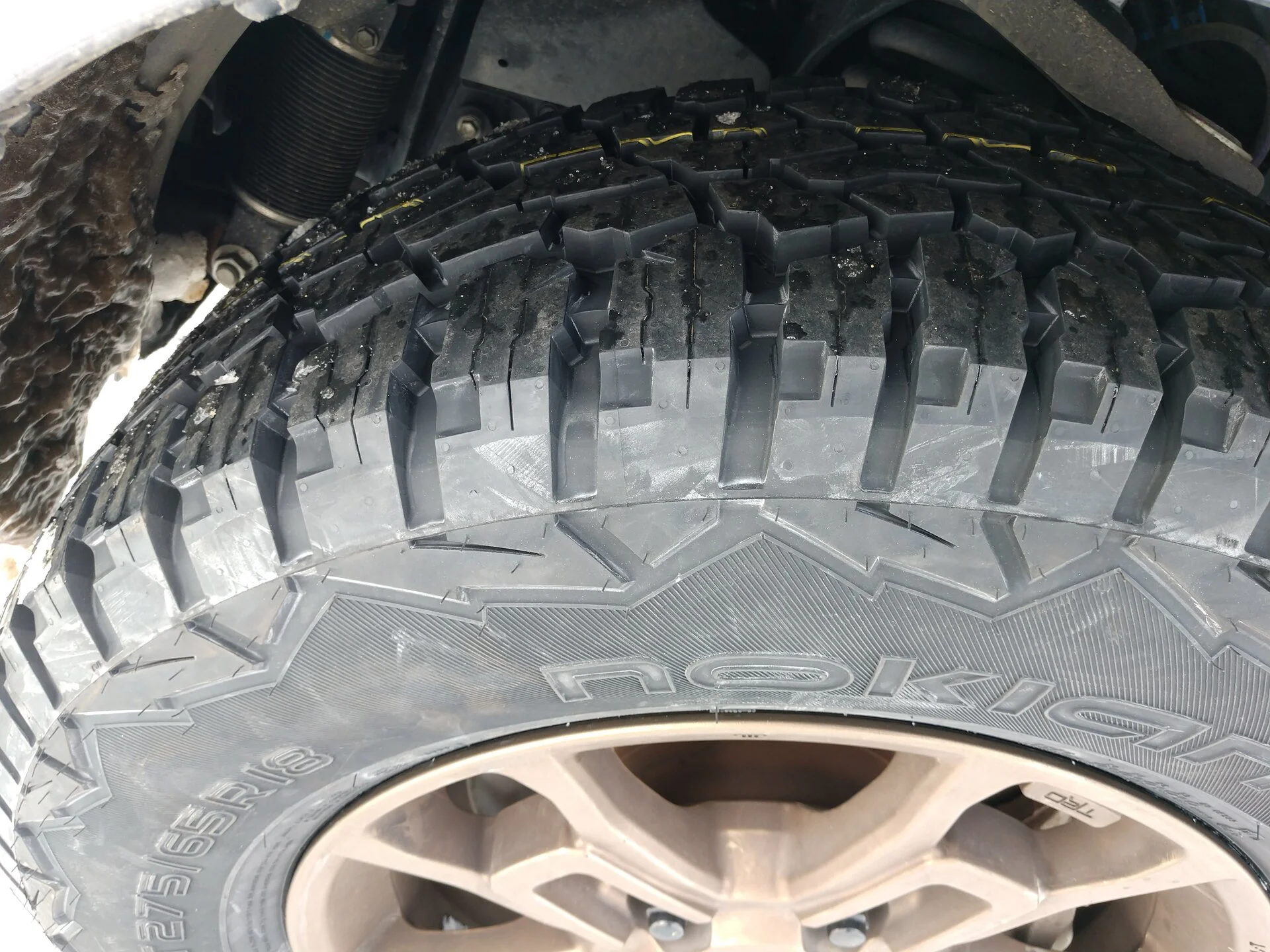

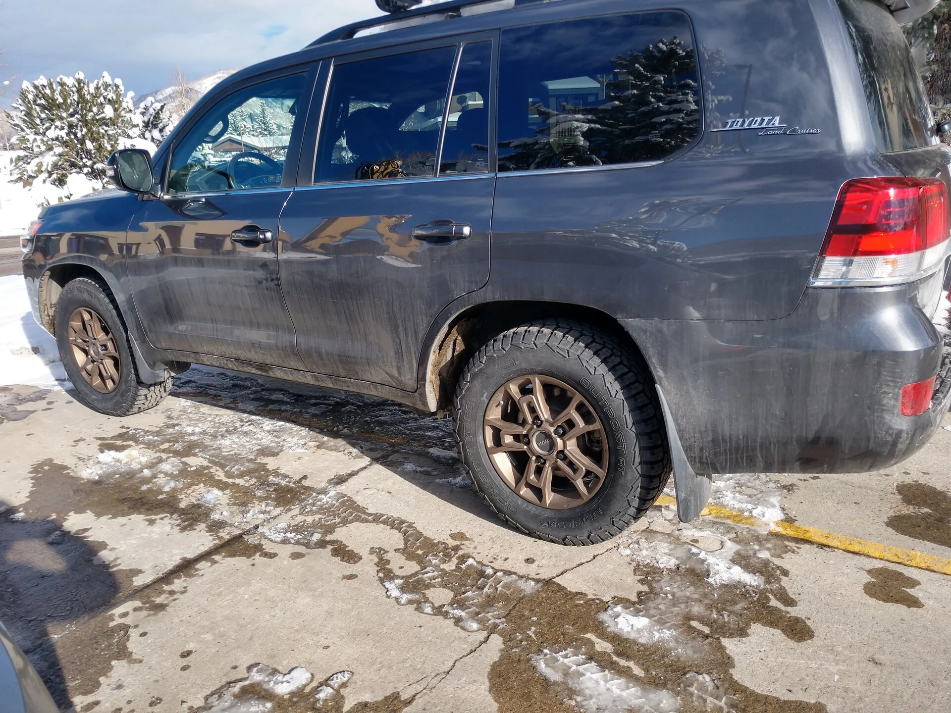

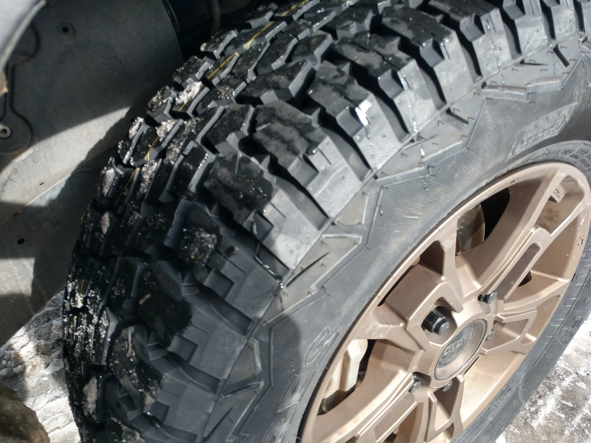

Ok, had the new Nokian Outpost AT in LT275/65-18 mounted today. @Slow Paddler asked that I let everyone know what I think once I get them.
Vehicle is bone stock, no mods yet. After a day of city driving, and about 25-miles on the highway home, here are my thoughts.
@gaijin suggested I run 45-psi on these. Local independent tire shop who did the mount and balance suggested I run 38-psi.
On solid ice and hard pack snow, they aren't very good, even though they are rated with the 3-peak mountain snowflake symbol.
On the way home, I found a flat open area with around 14-16" of snow, and went through that. I could feel the tires working, and they appeared to do well, and if I recall traction control didn't engage.
Ride is definitely firmer, and feels like handling in the corners is improved. However I can feel the difference from the factory Dunlop's which were at 29-psi this morning with the temperature at 10-deg while heading to town this morning.
With these new tires, I can occasionally feel the tires bounce, and can feel just about every crack and imperfection in the pavement, but I wouldn't call it harsh.
I got up to around 65-70 mph on the way home briefly, and on the bare pavement sections between patches of ice and snow, they were quiet, and mostly quiet on the ice and snow, but most of the time the ice/snow wasn't smooth as it had impressions from the road grader and front end loader tires that do the snow removal on our county roads.
I'm going to experiment with dropping the cold tire pressure to 42-psi, and then maybe 38-psi as the tire shop recommended, to see if traction on the ice improves, along with ride quality.
Here's the bad;
I bought five tires, and an extra Heritage wheel. I had the original spare in the back cargo area, as I plan on fabricating an interior mount that attaches to the third row seat mounting points. Because of that, I left the little rubber cup that goes on top of the spare at home. The tire shop put the new spare/wheel back underneath, and without the rubber cup in place, it gouged the wheel in a couple places, through the bronze finish and into the aluminum. 😟
The other thing, and I knew I was taking a chance on when I placed the order, these tires are made in Russia, just like the last set of Nokian's I bought for my Ford Explorer last year. All the reviews I read online on the Outpost AT kept on referencing or mentioning the new Nokian tire plant in Kentucky or Tennessee? Not sure if they have actually started production on the Outpost in the USA yet, and/or I received older stock? At least they're not made in China.
I like the look of how they fill the wheel wells, and so far no rubbing, which according the this thread, shouldn't be an issue with this size anyway.
