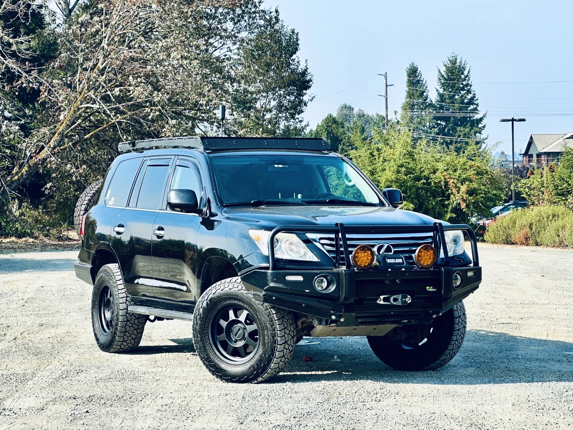

Loved the stepped lip concave, aka shower drain LOL, CCWs on my IS. Completely built to spec for that perfect offset. Was going to get a set for my 911 Turbo but CCW won't build the Classics for that application. Too much load on the rear wheels evidently. LX pic to stay somewhat relevant.
what size ko2? Right now icon has 25% off and I would also check out alpha equipment. depending on tire size you could actually want those low offsets.
Checked with Icon. Love the Icon Six Speed and Vector 5's, but neither is available in 18's. Will check out Alpha Equipment. The tires are typical 285/65/18's. Don't want to do any cutting of the fenders and obviously avoid kdss rubbing.

That’s a plus one size up your going to run, and again a good choice.
if you don’t mind stance, buy the Trd forged bbs. You shouldn’t rub anything that close to oem fitment. Can’t get any better than that that bbs wheel.
The stance will be ugly though. Some dealers are running sales too.

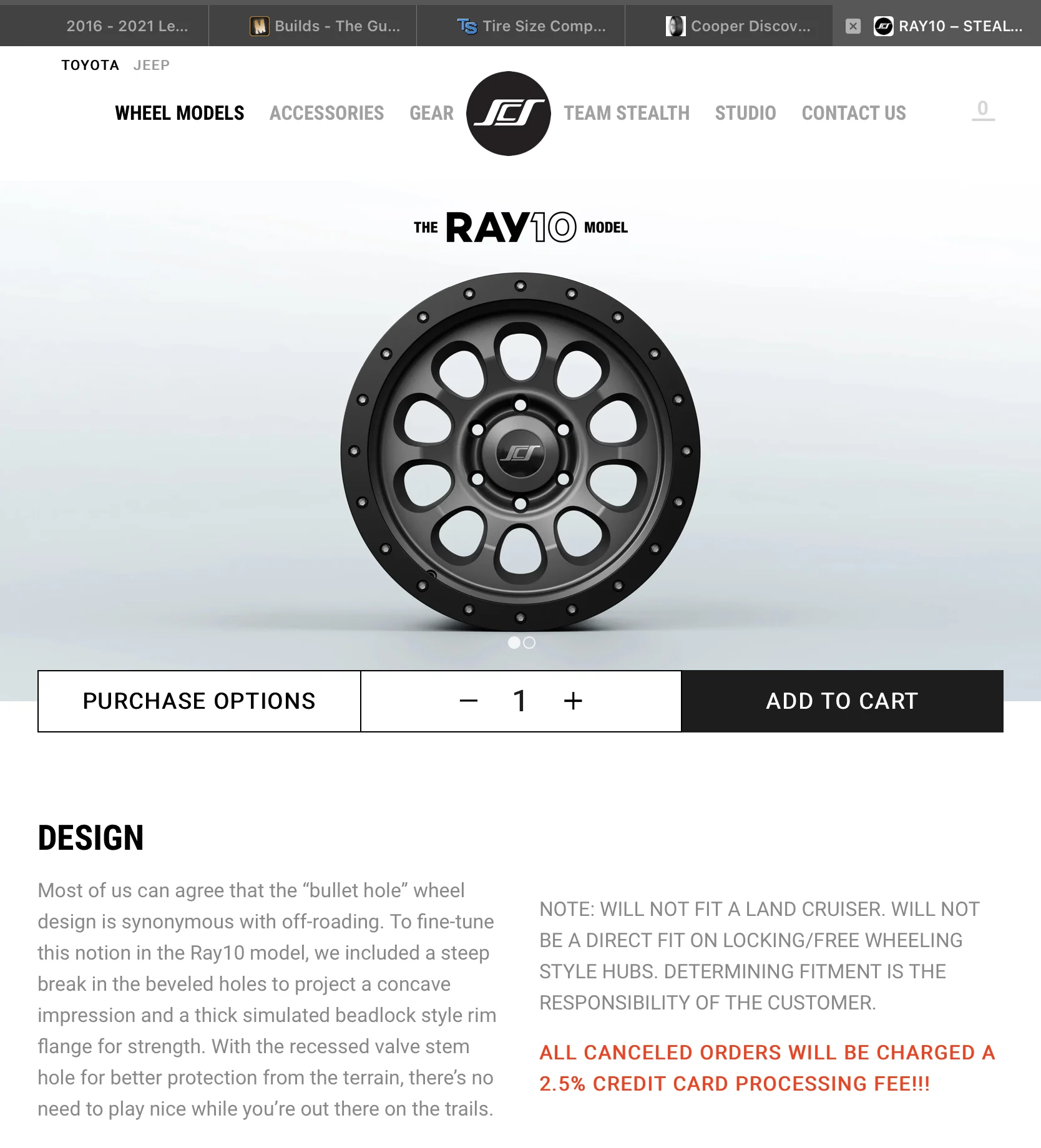

Its not showing me the hub bore for some reason though…
Edit:
should be fine on the 200:
Thread '5x SCS Ray10 Wheels 18x9 5x150 +25mm New in box - Dark Bronze - NoCO'
SOLD - 5x SCS Ray10 Wheels 18x9 5x150 +25mm New in box - Dark Bronze - NoCO - https://forum.ih8mud.com/threads/5x-scs-ray10-wheels-18x9-5x150-25mm-new-in-box-dark-bronze-noco.1252166/
@Supra Turbo here ya go dawg. this is your wheel.
+25 is the only caveat but then again lift and larger tires will be easier later lol

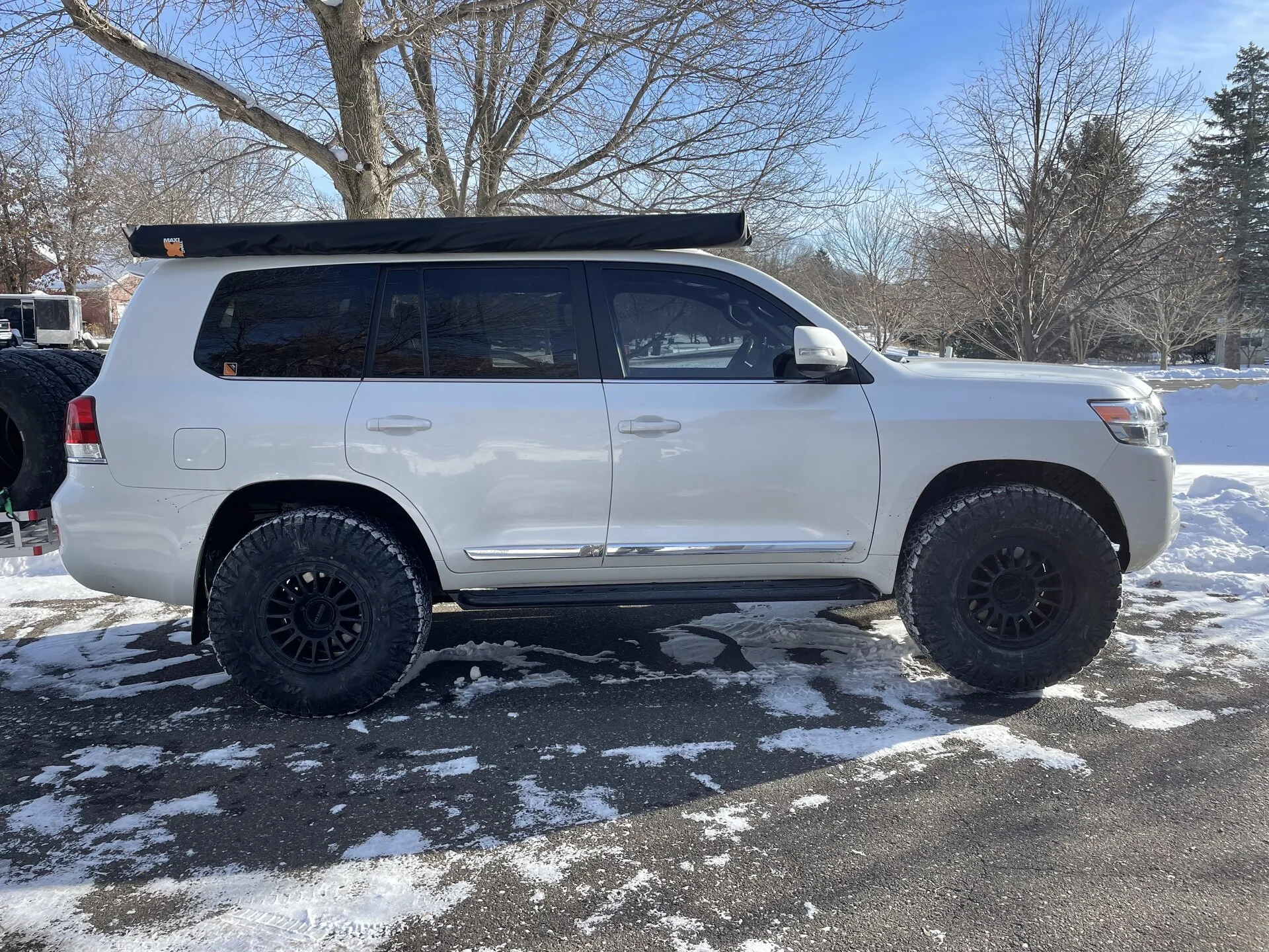

I’m running 701s
I’m running 701s
Yup yup, saw your setup a few weeks ago. This is my backup option if I can't use the Method 305s with 116.5 hub bore wheels with centric rings.
Though it seems like it shouldn't really be a problem with 305s since so many 200 series are running them.
The only thing I don't particularly like on 701s is it seems the spokes are not exactly at a 90 degree angle to barrels... I know, I'm weird 😄

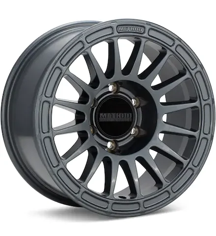

I am interested in the 18x9 Method MR314 in Titanium, anybody have experience with this model or running these on a stock LC200?
The offset on these is +18mm.
What tire size are you looking to run?
Depending on that answer, you may find that +18mm offset will create additional challenges to fitting good size meats. Possibly more importantly for the 200-series that's a full time 4WD, that aggressive offset is going to create scrub radius issues where it will actually break traction in turns resulting in overall less grip.

I’m running a 295 on a 25mm method 701 and can make it rub the body Mount. I don’t see how this truck is running a 305/65 on 18mm and not rubbing like crazy.

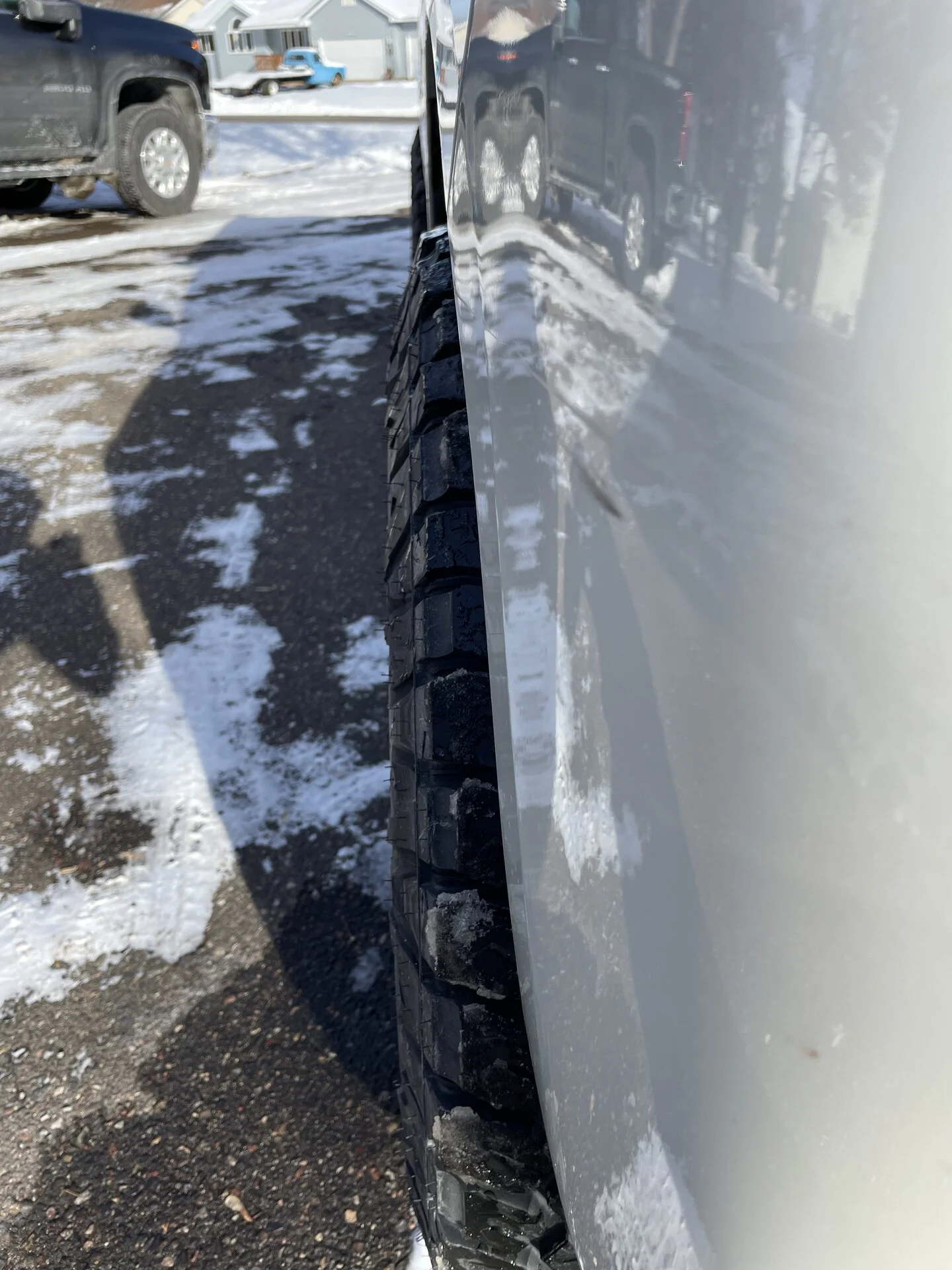

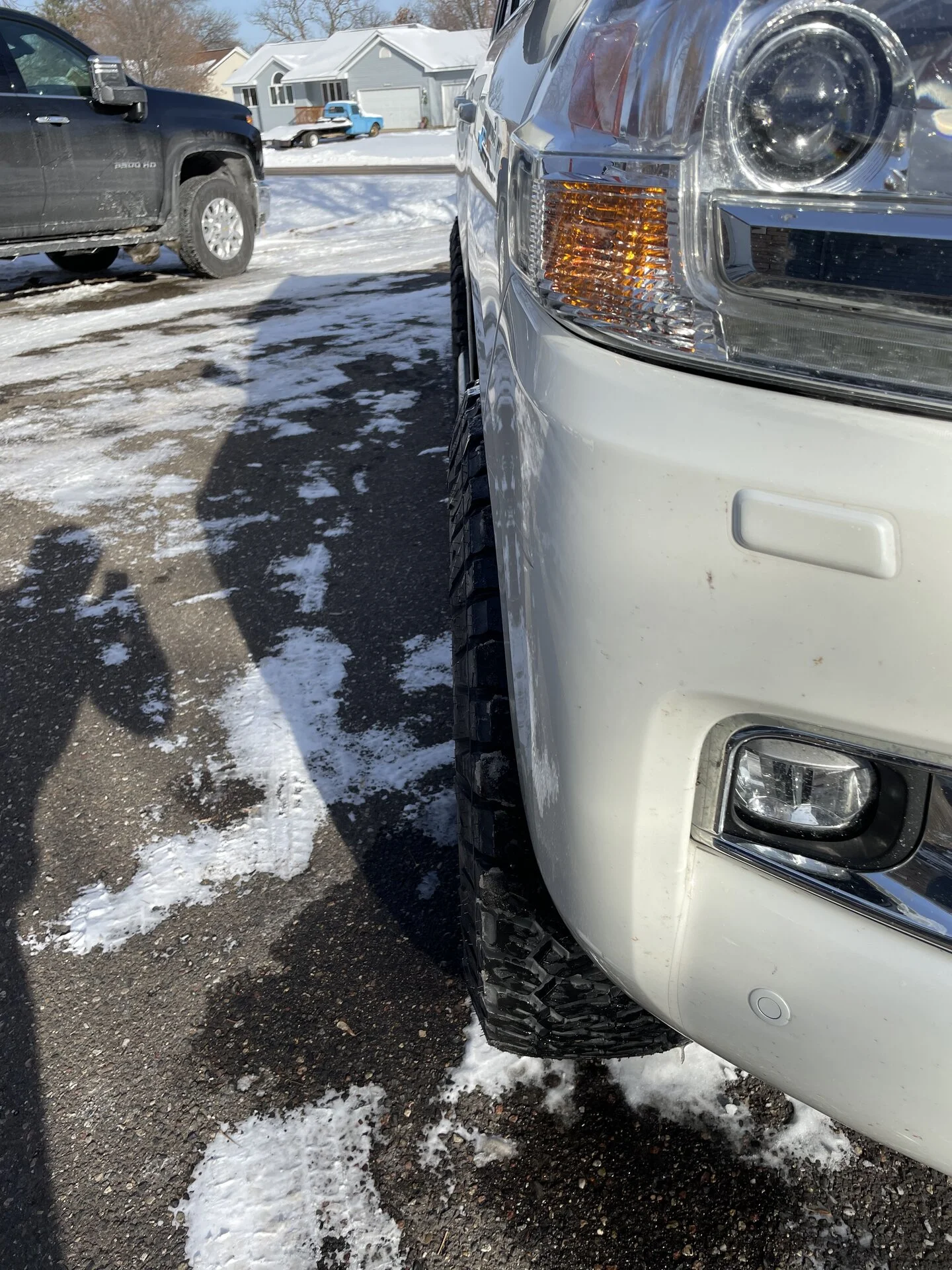

Maxxis Razr at811 tire specs
35x11.5x17
34.7 at 12.10 width
63.228
Actual measurements:
33.7/8 hight
34.6 left to right measurement
Wheel is 17s 0 offset. Rubs kdss bolt driver side at full lock. Will see if alignment will help get rid of it.
Reason for for this tire is planning to run all season. Has 3 peak snowflake certified and the size for less rubbing. This required BMC and fender liners cutting and massaging.
Still need to do flex test.

Looks great. Fenders are nice and full.
I need to get my 35s on.. curious about your kdss rubbing solution
Thx! It’s only rubbing at full lock so I may just leave it as is. I’m hoping with alignment it will fix it.
