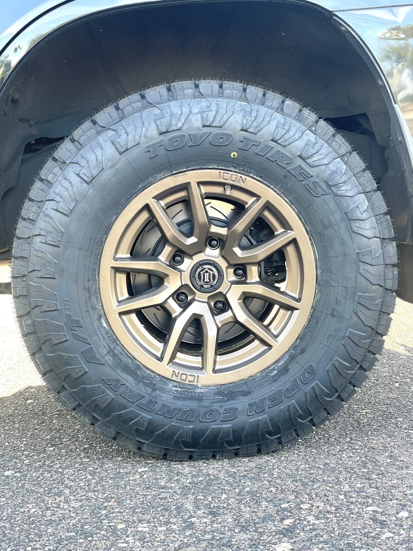

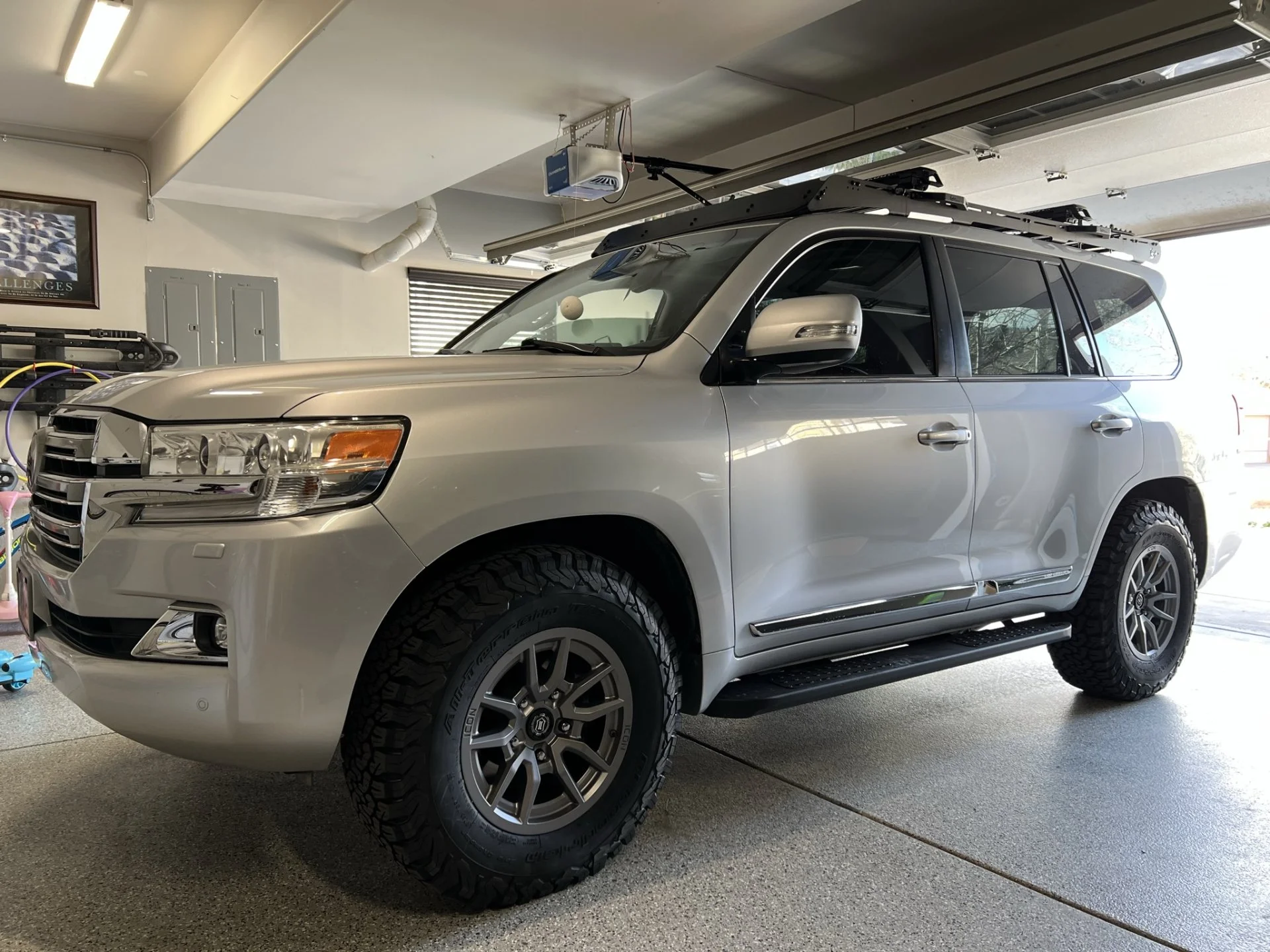

I'm sure I'll be happy with them! I loved the AT2 XTs I had on my Tundra and their better suited for daily driving with the occasional trail than the Ridge Grapplers I have on my 80. Toyo & Nitto haven't let me down yet!
Load range c? How’s the “comfort”/“softness” of the suspension compared to oem?

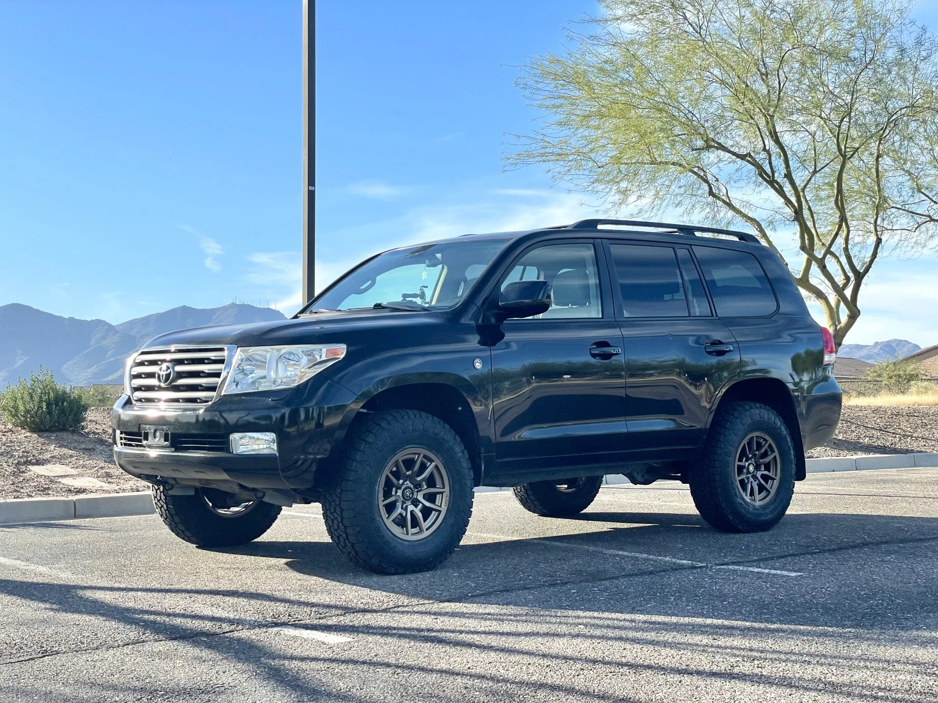

Yeah, I went with C because I want to keep weight down a bit and didn't want to lose the comfort of the ride. It's my first non-E load so we'll see how it holds up. I have less than 50 miles on it so far but I can't tell there being any difference in feel than the oem setup. Which I think is a massive win after a lift and adding significantly bigger & more aggressive tires than the Kumho's that were on it. It is still a very plush ride. What I do absolutely notice though, is the braking. I was expecting this which is why I added DBA rotors & hawk LTS pads a few weeks ago but it definitely takes more effort to stop.
@Just Diddly
Same 34-36 PSI unloaded. Im gliding.
Too many LT scare tactics due to overinflation.
No spacers right?

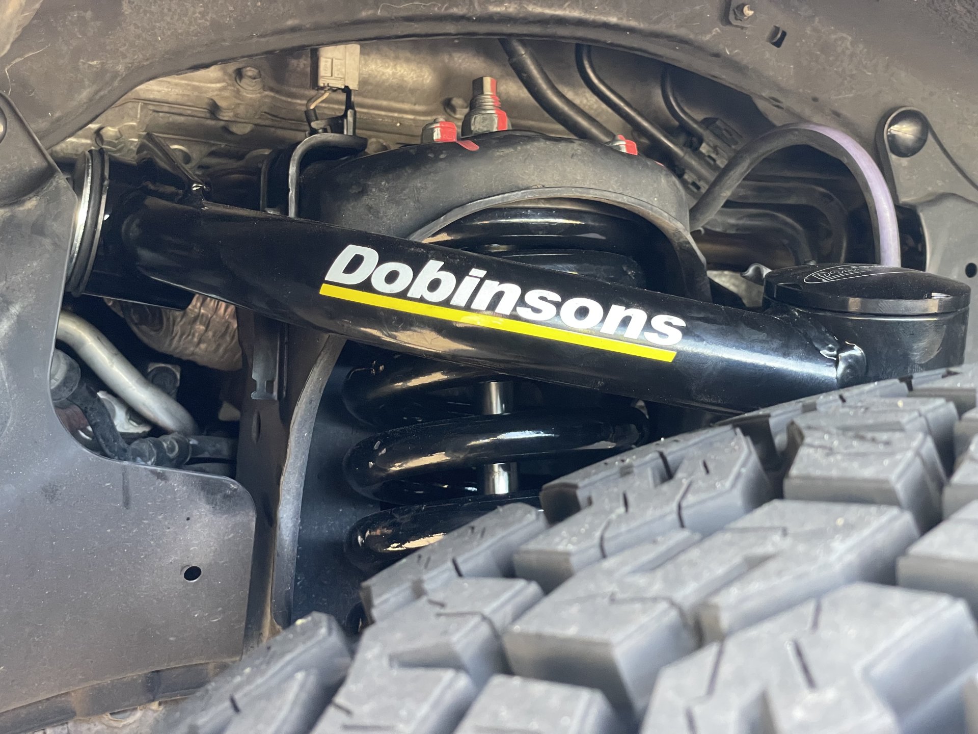

I added a 1/4" Trim spacer on the front driver strut assembly to compensate for lean, but no wheel spacers or anything else. The Icon wheels are +25mm offset which gives just enough clearance with aftermarket UCAs & proper alignment to fit these 34s.

Ha, you did respond to a post that was 7months old.. but other than that you did it correctly. He was running wheels with a +25 offset.. it’s very unlikely he was using a spacer.

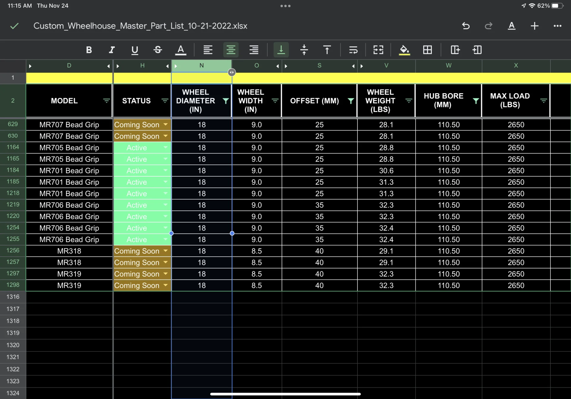

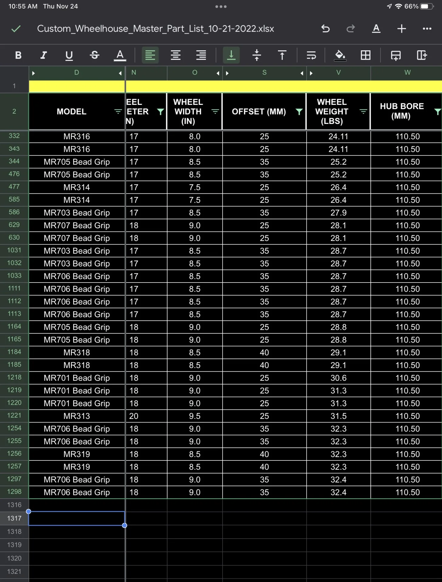

depending on size, what you think of the 703 or 316. 316 being showerier.
These are your real options.
Sorry, I should have specified only interested in 18" wheels.
I looked at 703's, but not available in 18's. And the offset of 316's (offset 18) seems low?
oh ok, great choice.
I would wait and see what these new ones look like. I’ve been waiting myself.
18 offset I would avoid as well.
