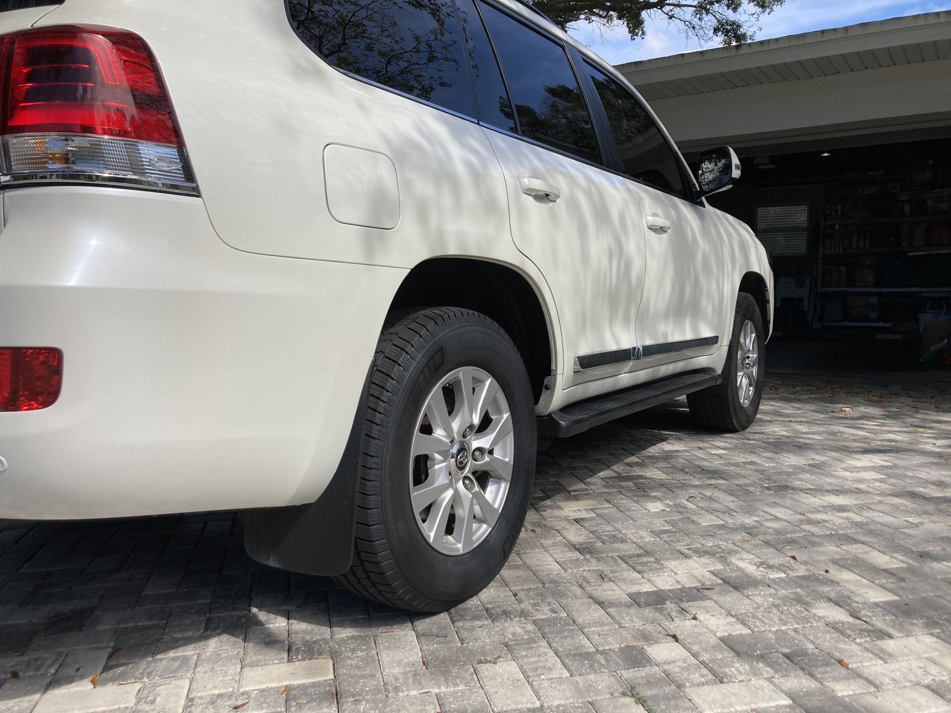

I just installed Michelin Defender in 275/65r18. Regarding that size: the measured tread width on the 275 Defender is the same as the 285 Dunlops per Tire Rack and per others who have measured. ...the tread width on the Defender seems slightly wider versus the total width compared with some other tires. Lots of 265 spec 10-10.4” wide tires on Tundra, Suburban etc, the 10.8” width of 275/65/18 will not be an issue with braking or other performance. I was concerned I would notice the narrower width but I don’t at all, 275/65r18 looks good on the truck, and the slightly taller (by 0.6”) sidewall looks better than stock to my eyes, although I might be the only one who would notice.
Have you got any pics of the 275/65/18 Defenders on your 200? Also, I assume you're on stock suspension?
Based on many reports here, 285/65r18 will fit on stock wheels without significant rubbing, as will 275/70r18. But these sizes are almost all LT-E rated which will affect ride comfort, acceleration and braking...so if you don’t need the sidewall toughness of an LT-E tire, the increased size may not be worth it.

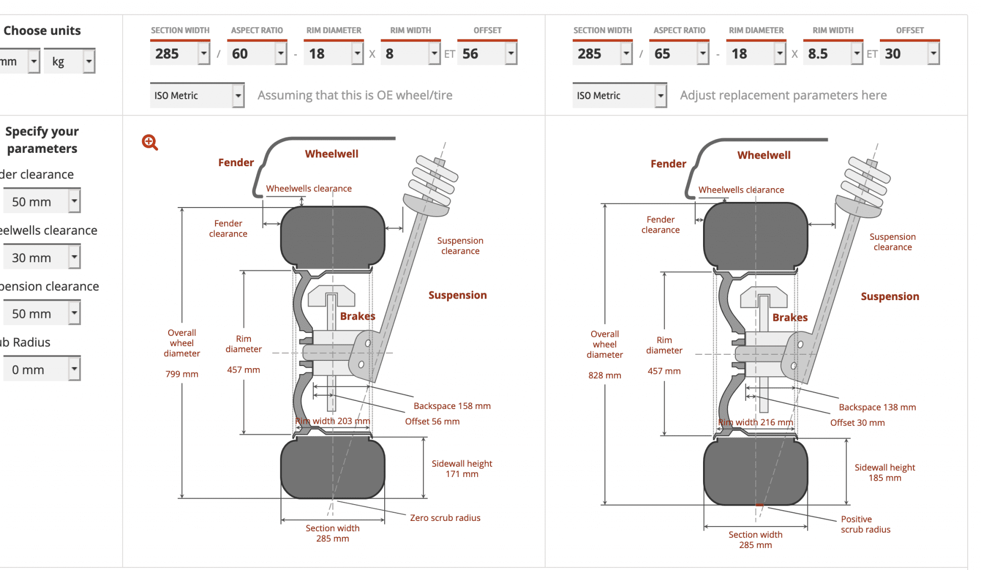

Hi y'all. New 2020 LC200 HE owner here. I looked at the database and trying to figure out an answer, but haven't quite figured it precisely. We do a fair amount of winter driving up north from RI to Canada and I'm looking to put together a set of proper winters like Blizzaks or Xice, which I've been happy with on DD cars/SUV's before.
Question is will the following rub?
There are some new 18 inch x 8.5 OZ Rally Raid with 30mm offsets that look nice if a little heavy. Was hoping to use a 285/65/18 to get just a bit more sidewall. Stock supension for now of course. Unlikely to do any more than fireroads for now. But parking this pig here and there will always require some full steering. Unsure how that offset will affect rub. It'll also increase the scrub to be a bit more positive, but not too much- I think that'll be okay.
The closest entry in the database was some Nitto's of the same size, but with 35mm offset which mentioned very slight rub. The blizzaks or x-ice don't see to have such pronounced lugs, but the less offset gets me wondering. I'm working on finding the exact circumference differences.
I'll probably run the stocks for summer until I get a lift someday.
