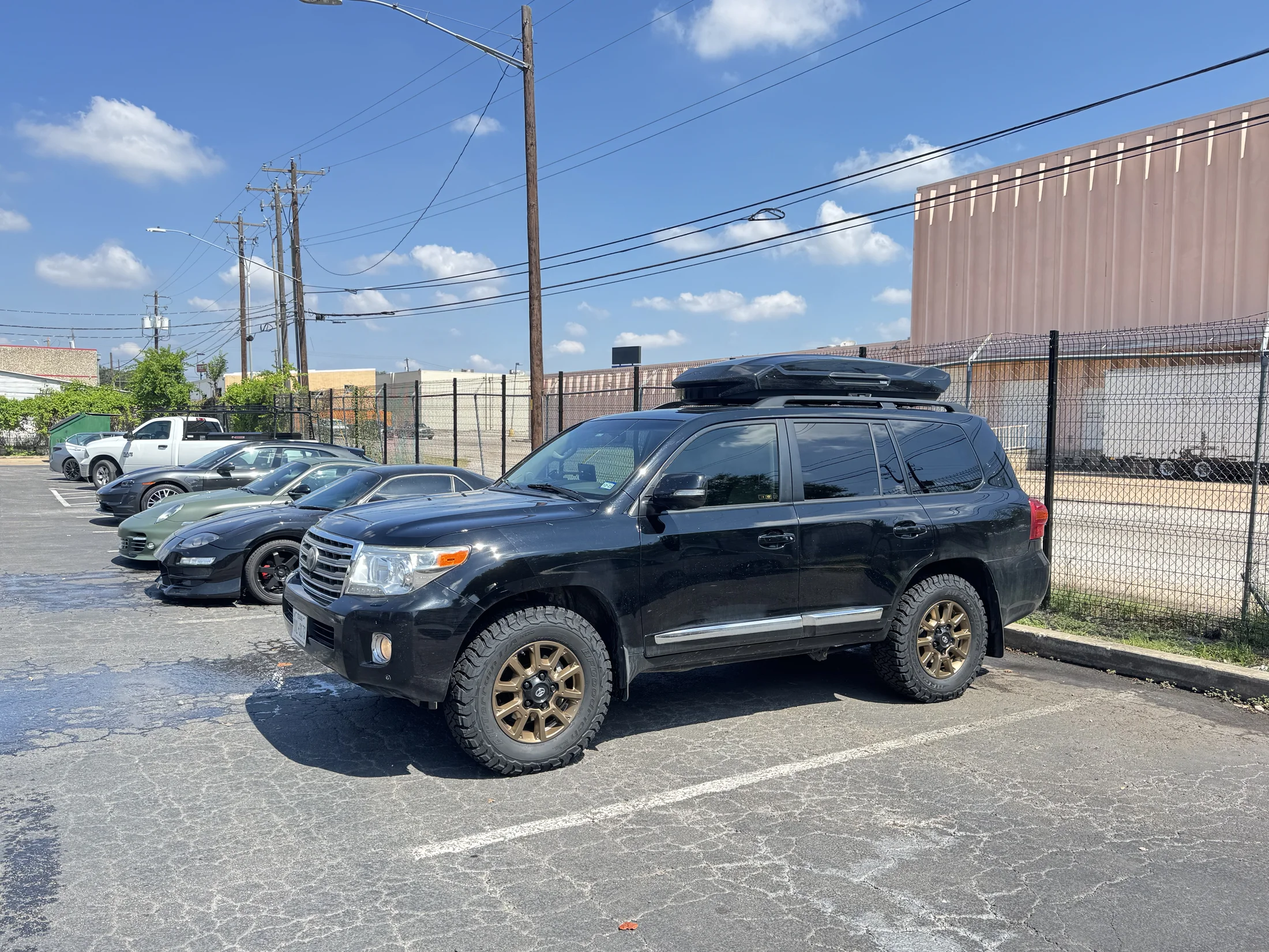

I went with:
BFGoodrich
KO3
275/70R18
Very happy with them but very few miles on theM at the moment. I like the look compared to my old tires and happy with the wheels. I was worried for a little thinking I made the wrong choice - but love them now. I have plans to hopefully cover up the chrome strip in the future.

Another combo to add: Evo Corse 18” et45 with 275/65 R18 Falken AT4W’s SL. I wanted a softer and more rugged looking setup than the stock 21’s. Also needed better snow traction for commuting. No rubbing or need for plastic adjustments. The rake looks a bit aggressive but she’s parked on a bit of a downhill angle.
This combo looks great.

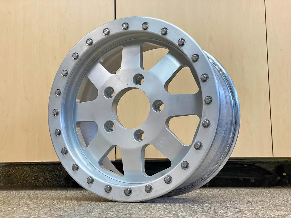

Need some advice on wheel offset. I am toying with putting these on my 200 series. They are one off's from a SEMA build. Seller states 17x9 with a 7.5" backspace, which puts the offset at 63.50. They will be on a 285/75R17. I have looked at the database and seems that stock wheel is around +60 with minor rubbing on larger tires. I have 3" lift in the front and don't mind messing with the wheel wells, nor do I mind running a spacer if need be. I just gotta ask before I take the dive into this, I only wanna buy wheels once lol!
Given those specs, you might want a 1" or 1.25" spacer, but they might fit as is.
