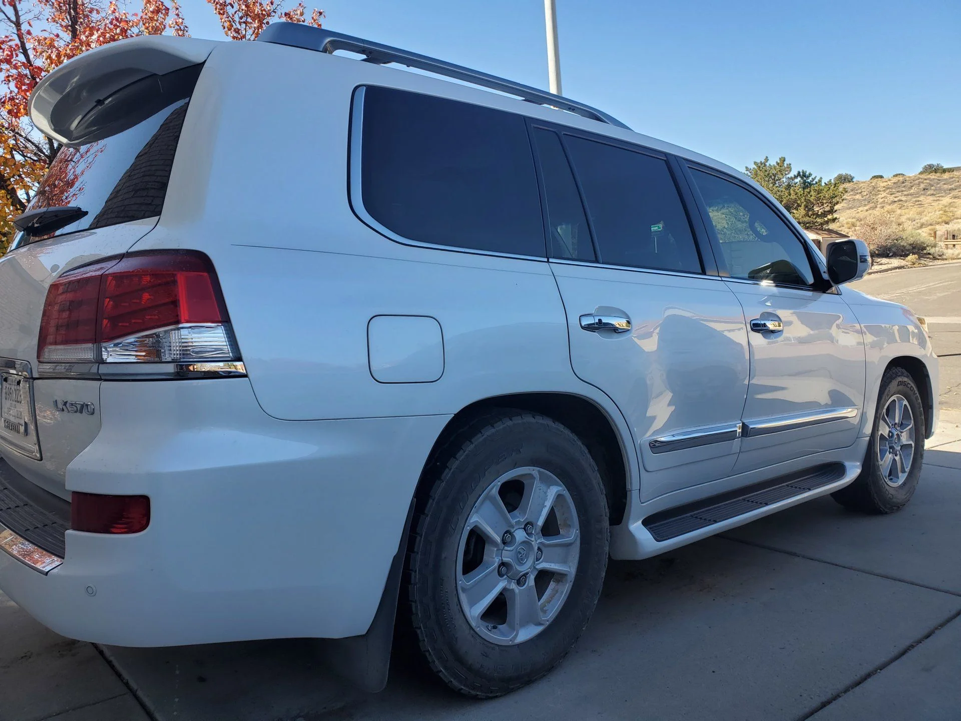

New guy here requesting for a 2013 LX570 the followng:
DISCOVERER AT3 4S - SIZE: 275/65R18 116T
33PSI?
Thanks!
Got any pics of those tires on your LC? How do you like them so far? Been eyeballing them myself.
I'll upload some pics later today.
Frankly I think it's a perfect tire for the LX. Did a hundred mile loop yesterday with 85mph interstate, 10mi of Rocky, steep jeep trail, and a 10mi bomb (45-65mph) graded gravel road. Tire performed great on all surfaces giving lots of grip and confidence on all surfaces. Tire is very quiet at interstate speeds. Prior to Gaijin's recommendation I had them at 32psi.
I had 20's with Latitude HT on the rig before and if there is a mpg difference it is very slight. More to come with more driving.
Will weigh the respective wheel/tire combos later today but I suspect the setup (on Tundra 5 spoke) actually weigh less than the 20" Lexus combo.
W
Edit to add: weighed the respective combos (new 3AT 4s on Tundra 5spoke compared to Latitude with 10k wear on Lexus 20")
Latitude combo 75.6# (285/50/20 actual measured tread width 233.3mm)
Cooper combo 74.8# (275/65/18 actual measured tread width 228.7mm)
