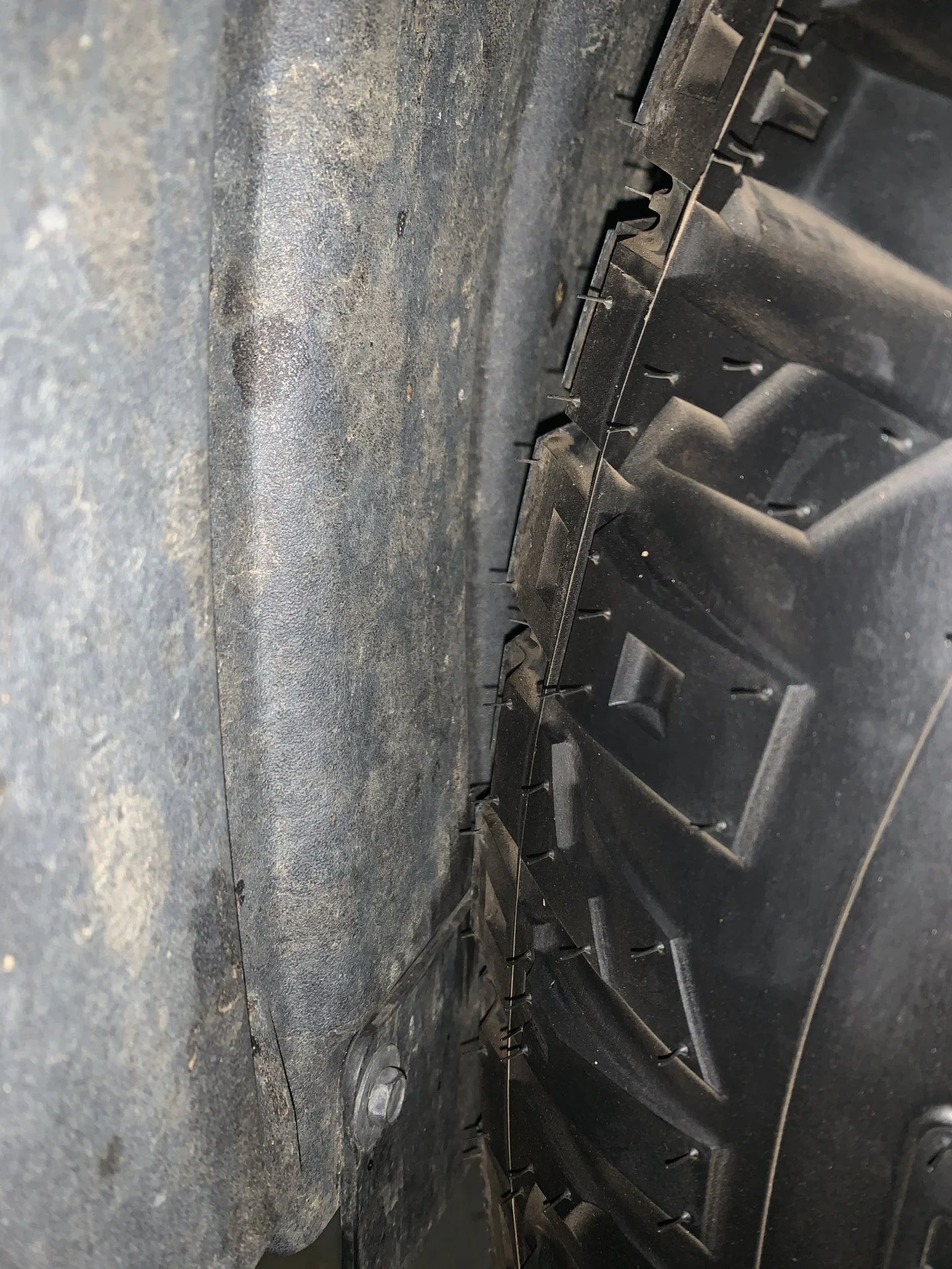

It's been an adventure with tires/wheels so far. Purchased an '18 in August and swapped out the stock tires with Goodyear UltraTerrain ATs 275/65/18s to achieve a more aggressive tread and, hopefully, fill some space in the wheel well. After a week or so, I felt a "pulsing" sensation on the right side and Discount Tire confirmed there were heavy spots on those two tires that couldn't be balanced out. By that point I had regretted not just pulling the trigger on different wheels that would better fill the hole, so I bought the 17" Icon Vector 5s from Discount Tire. They were originally supposed to arrive in September so I kept the Goodyears on until they were to arrive.
Fast forward to this past weekend when the Icons finally arrived and I went to 285/70/17s in the Nittos. Much better appearance (both tread and the offset) than the Goodyears, but there is some rubbing at full lock on the front. I removed the mud flaps but they still rub on the front of the tire and I'm not sure what to do in that spot. Heat gun? Cut it? It's not the "tab" but the actual fender liner and I'd really like to avoid cutting that if possible. I seem to recall a thread where someone used a bolt/washer/nut assembly to pull the fender liner forward and open up the space. Any other ideas?
Look up any of the fitting 35s thread and they’ll have the walkthrough to pin the wheel liner 1” forward. It’s on my build thread too.
