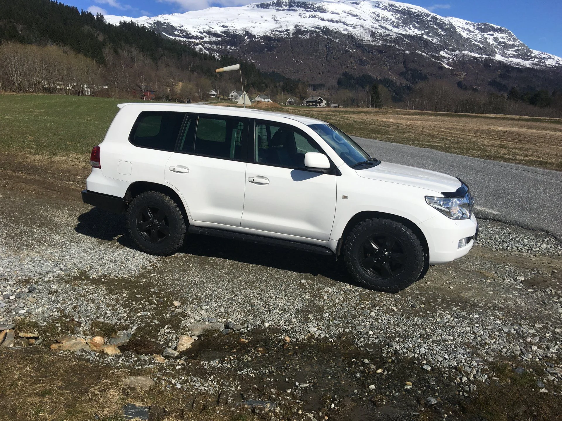

Hi,
I have fitted the 275/70r18 on stock rims with 60 offset. No lift. It is really good, no rub what so ever..
Your rig looks awesome!!!
I take it since your in Norway your LC probably has the front leveling spacer installed stock from the factory. The front spacer another small project for those USA owner's trying to get the global, worldly look for our LC's... Thanks for the pictures.

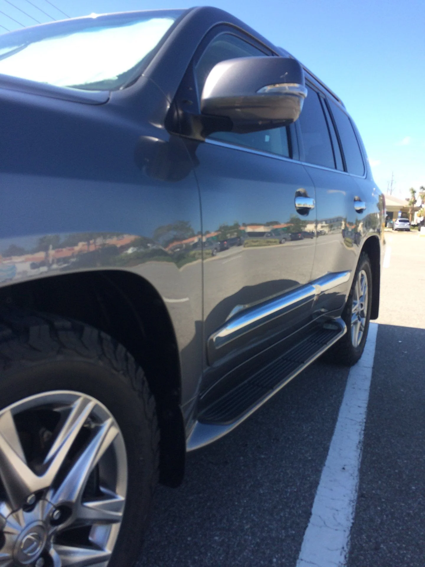

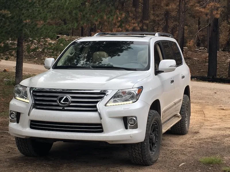

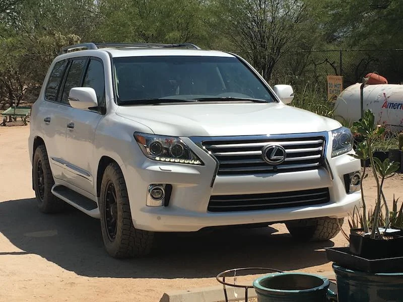

I thought I would take the opportunity to share some info for the LX crowd. When choosing a tire I believe LX owners should refer to the database's LC stock suspension (zero lift). There is only one LX listed and It is different than my set-up. I thought it would be nice to see a different LX idea and help somebody "be sure" about the tires they are considering. Again, I think any of the stock suspension LC sizes listed in the database will fit. I know I was worried about what size tire would fit with the AHC at all heights.
I wanted the biggest tire possible to fill the wheel well and I wanted a provocative (wider) stance. The tire had to be functional off pavement as well as on it. This truck is also my daily driver.
I chose Nitto Terra Grappler G2 285/60 R18. Rims: XDSeries - Addict with +18 offset.
I am EXTREMELY happy. I do not have a road noise issue. Handling is great on and off road. These wheels are flush with the fender and do not stick out beyond it. No rubbing encountered in any of the AHC positions. The first 2 pictures show the wheels with the truck in the highest AHC position. The last 2 pictures show the wheels while the truck is in the lowest position.

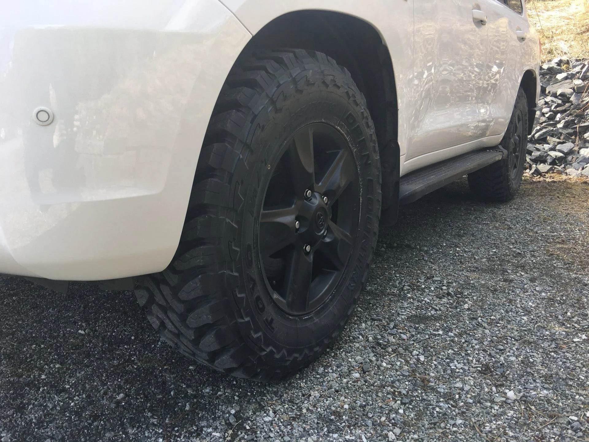

So here is my 2008 supercharged 200. 3" lift, coilovers, etc....
So i had to go with 20" fuel wheels due to the huge 8 piston brakes i put on...not quite happy having to go to a 20" wheel. That said i bought the fuel 35x12.50 MT tires. These were the WORST tires i have ever owned in my life. There is zero traction in the snow, minimal in mud and the wear is horrendous. I got rid of them after about 4k miles and went to Toyo Open Country MTs 295/65/20 and they are night and day different. i did have to trim a bit of the mudflaps but overall they seem to fit....barely. i might need to bring the front end up a tad. Might actually go back to stock brakes and go with 18" wheels

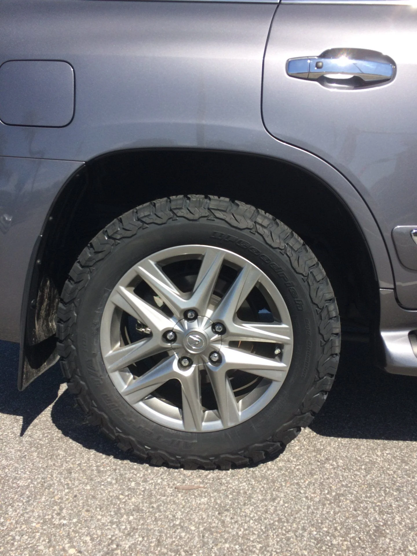

Gee those BFGs look good! Are those rims +45 or +60? Would you see any issues with going +25 rims?
OEM rim's. These BFG AT/KO2's in the 285/55/20 size have a wide thread width 10.1 inches, where the 275/55/20's have a 9.6" wide tread width and the 305/55/20's have a 10.2 but will not fit with out mod's. I wanted wider with heavy tread 15/32" for AT performance and still have good on road performance compared to the Dunlops with no tread.

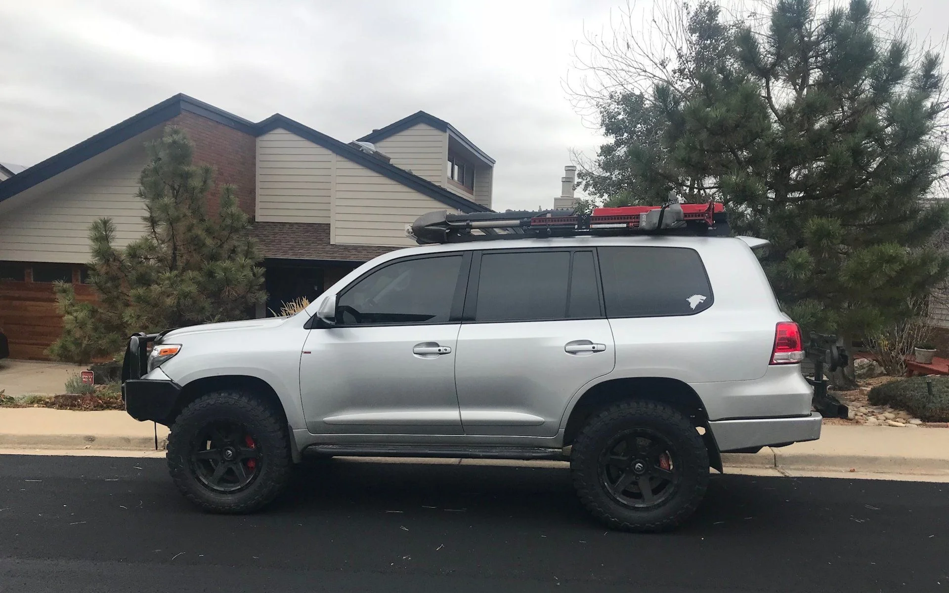

Thanks for doing this, @MScruiser! It reminded me that I never provided my specs so here you go.
First, you can copy pretty much any row that has 285/65R18 KO2s on stock wheels. No rubbing, etc. 42/42 PSI. The only real difference from stock is the 2" lift. (ARB OME 2700 and 2721 w/ OME UCAs). Love the ride. Noise not an issue - meaning I don't notice anything.
