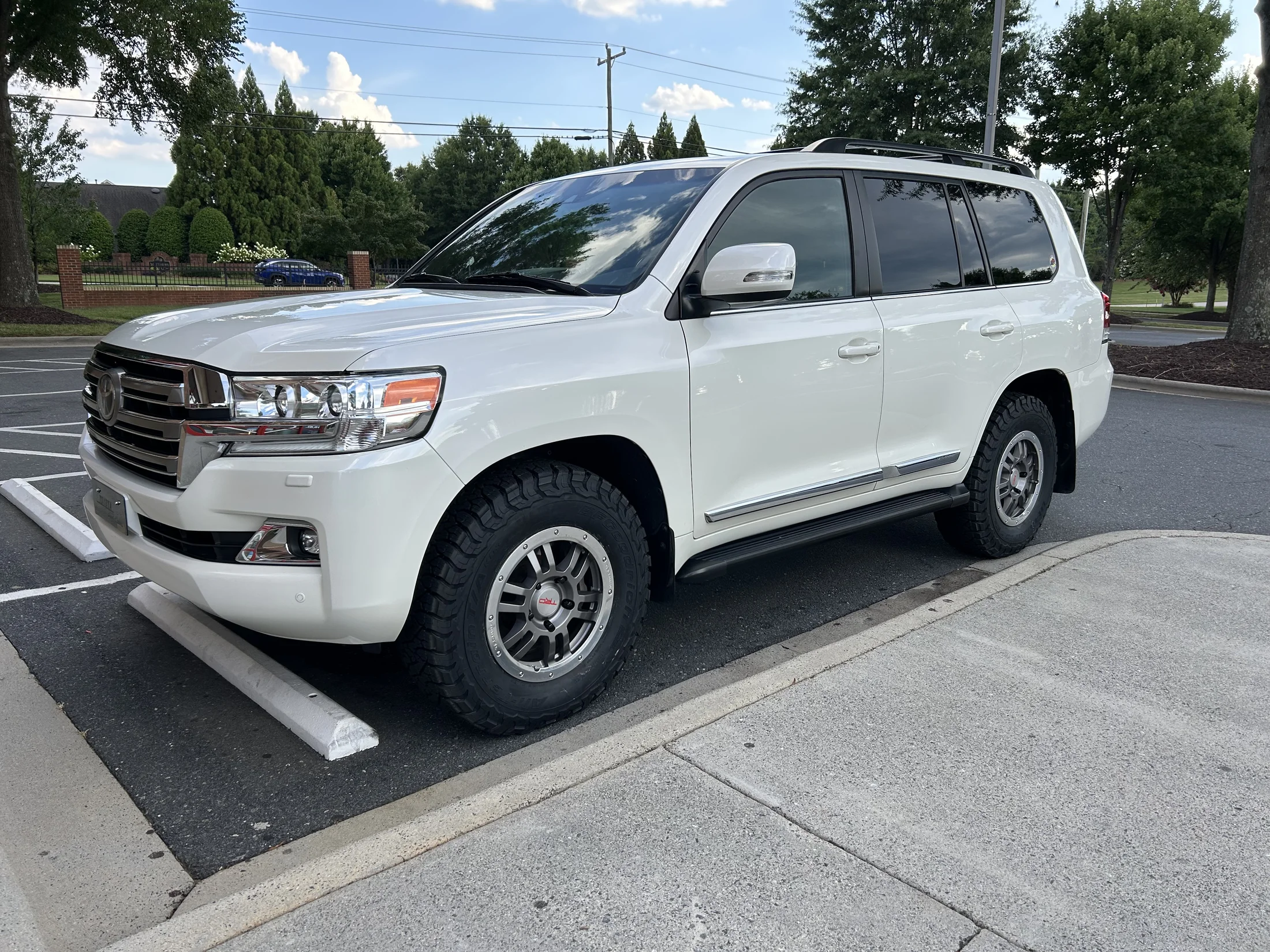

Our recently acquired 200 was on methods 703
17x8.5 +25 on 35s

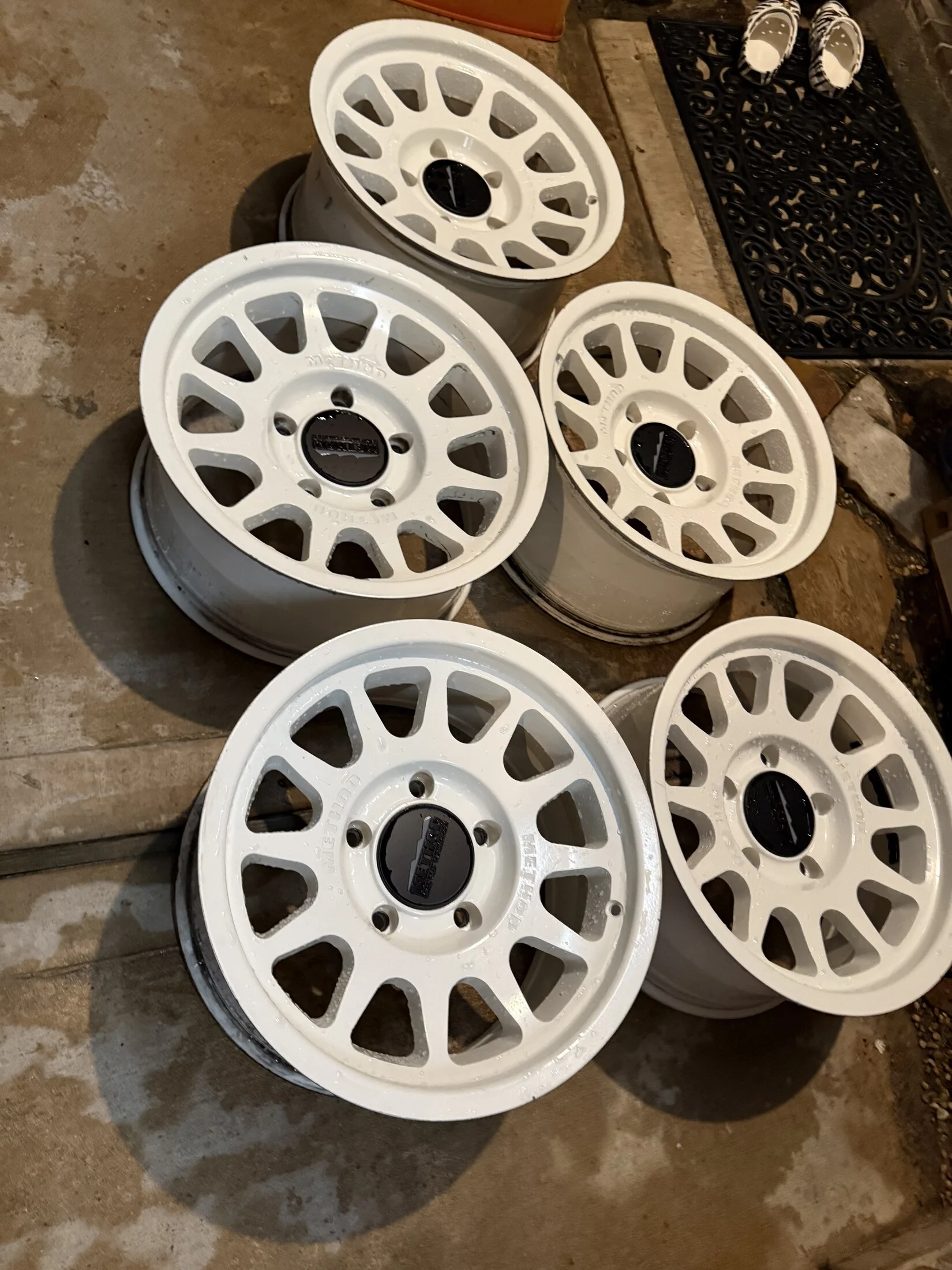

We just switched to some rockwarriors with 1.25 spacers for the oem + look
The wheels are for sale by the way

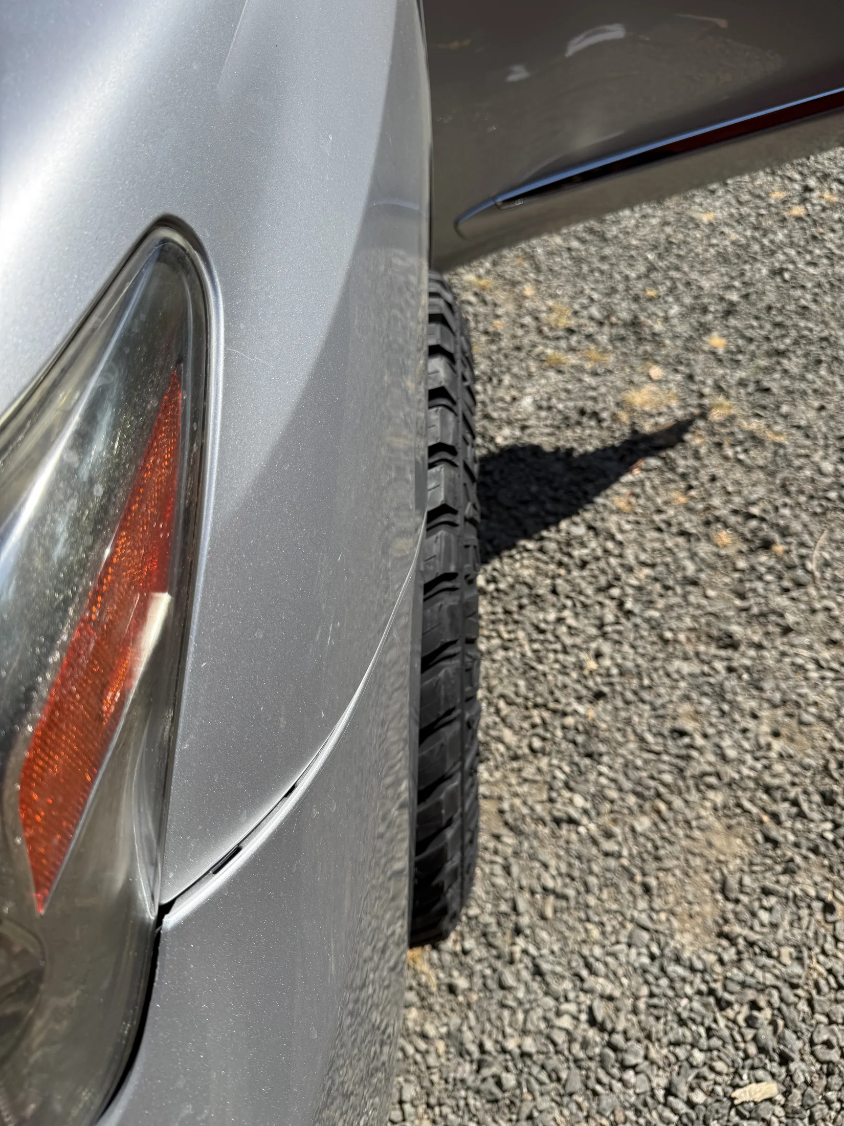

Back at ih8mud! Almost 20 years on this forum, I missed it! I’ve had 80 series, 100, and now after 8 years with no LC I just got a 2011 LX!
First thing to do was to get rid of the 20’s! I might have kept them but the rig I bought had a fairly banged up wheel that I was surprised held air. So went with some 18’s and got an amazing deal on some on closeout on Tire Rack.

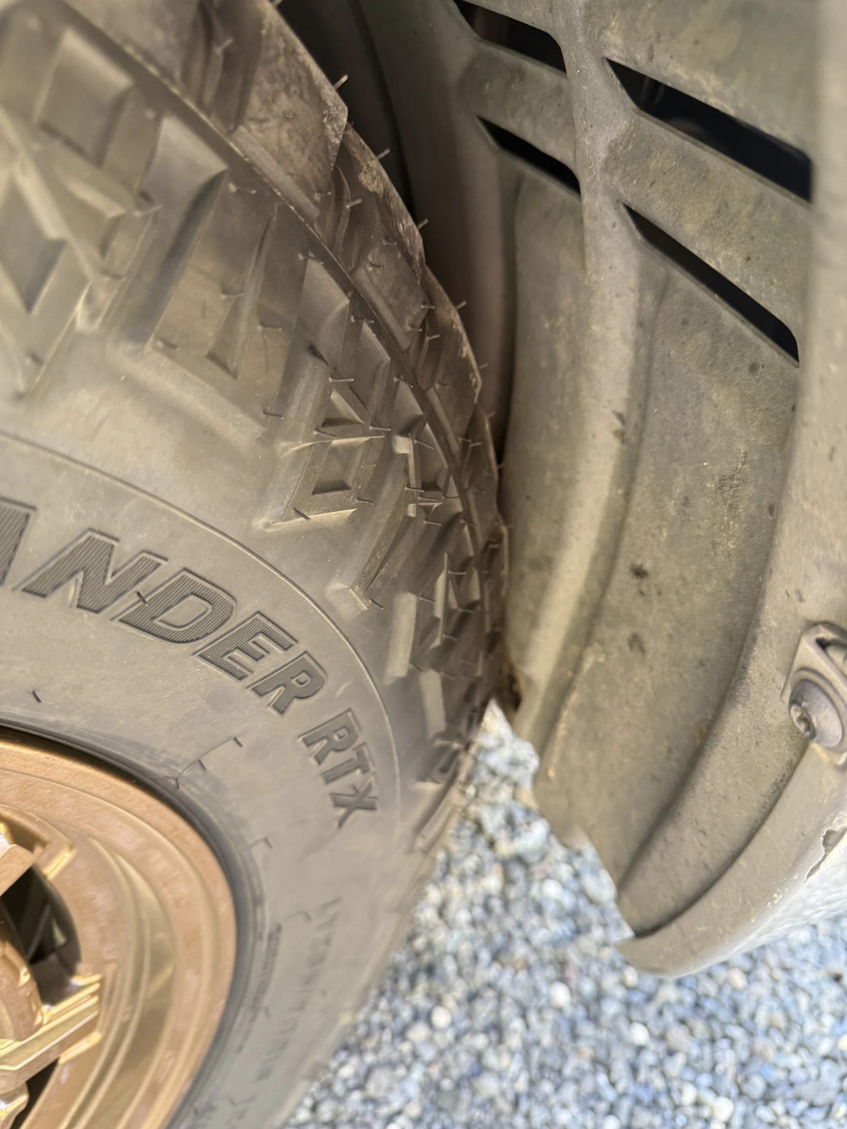

Went with 285/70/18 Kanati Terra Commander RTX. They were cheap and thought I would try them out (I’ll only put 5-7k miles on this a year). The wheels are 18x9 with a 30+ offset.

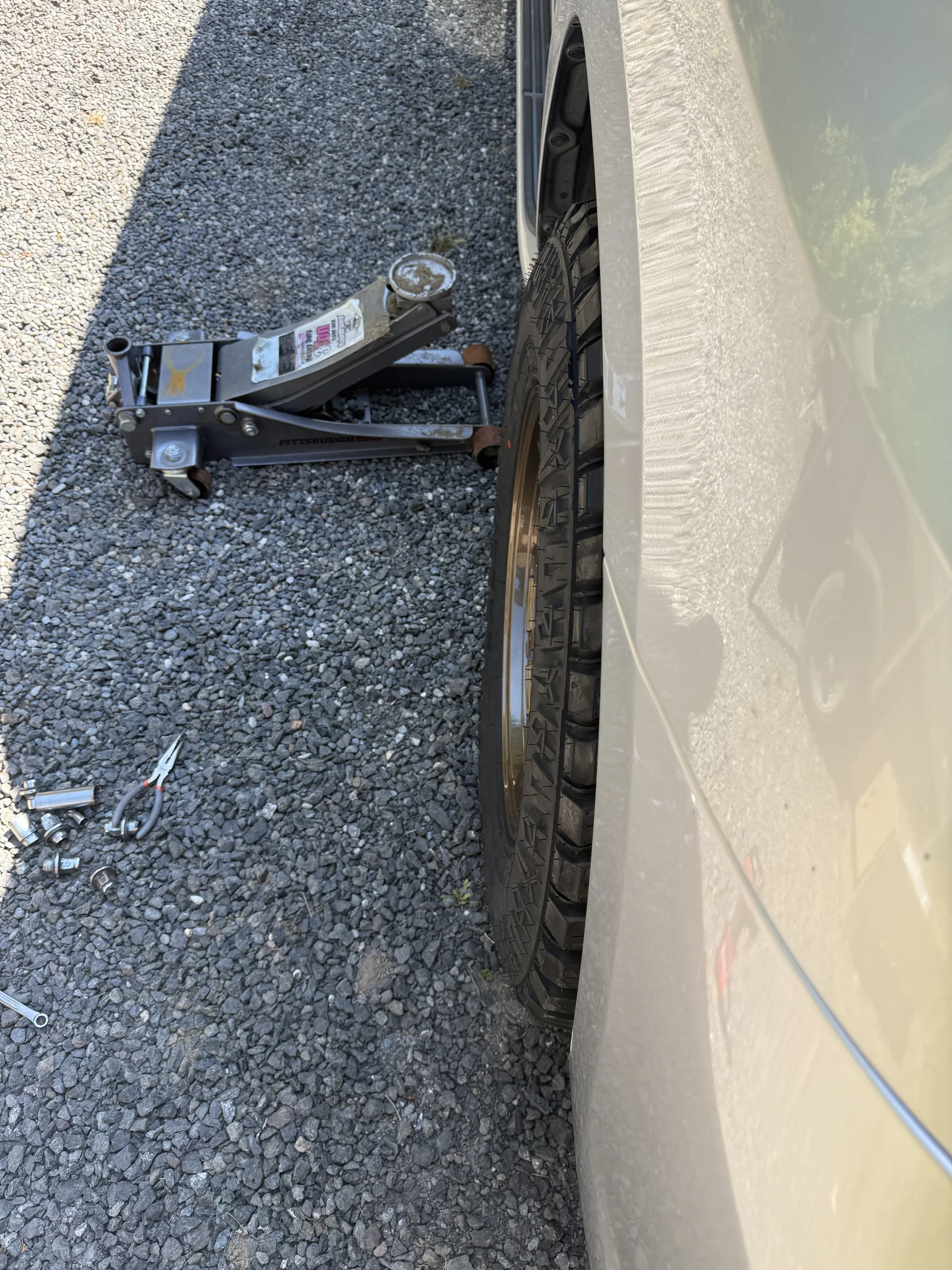

At first I went with a 1 1/2” spacer but the rubbing was worse than without the spacer! Without a spacer I get rubbing primarily only up front, so I’ll move the liner forward. No UCA rubbing, and with no spacer the tires stay within the wheel wells.
Here is with and without.
I might try a 1/2” spacer? What do you guys think?

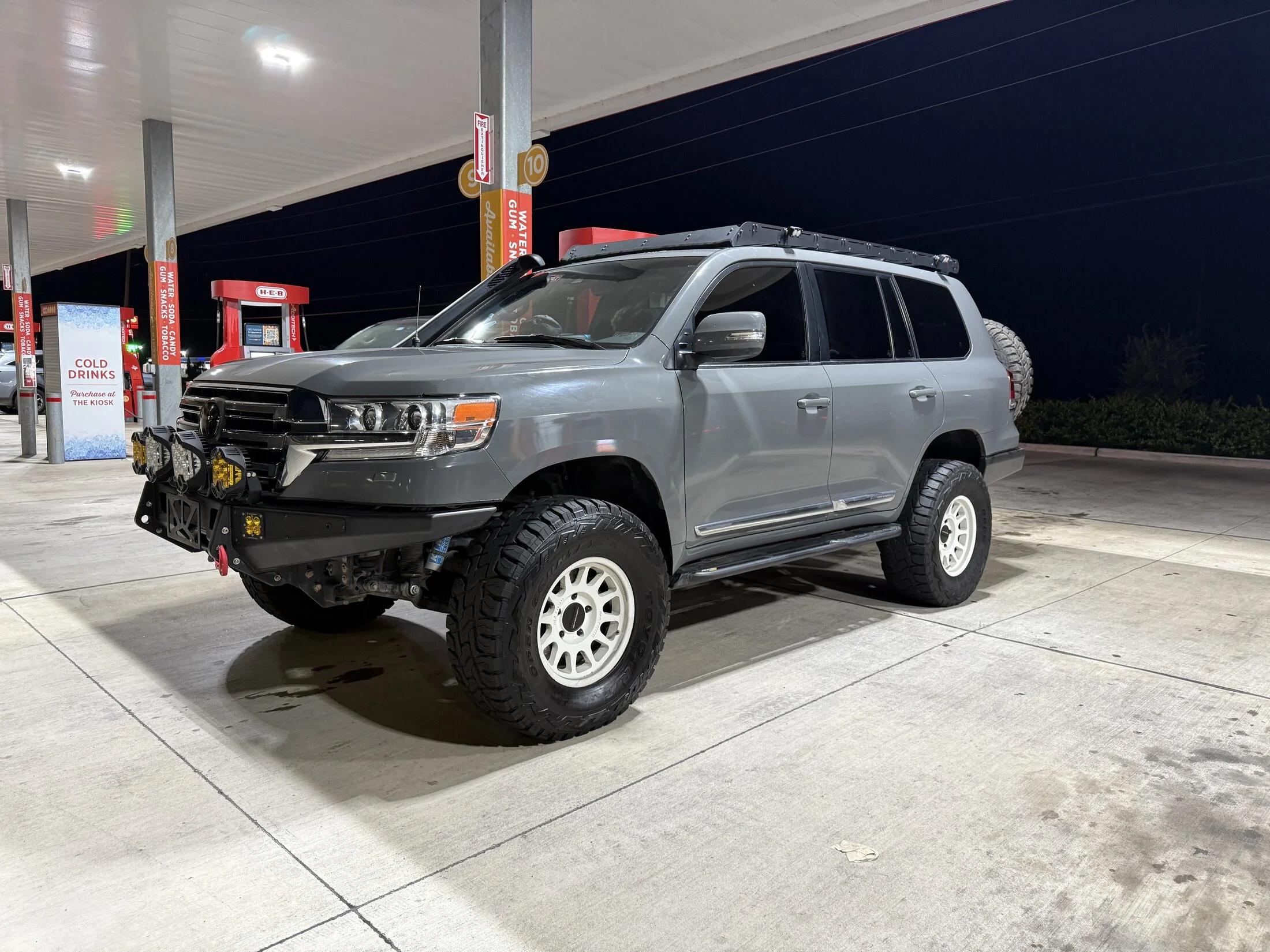

Tried and true, stock suspension, RW’s, 285/70/17
