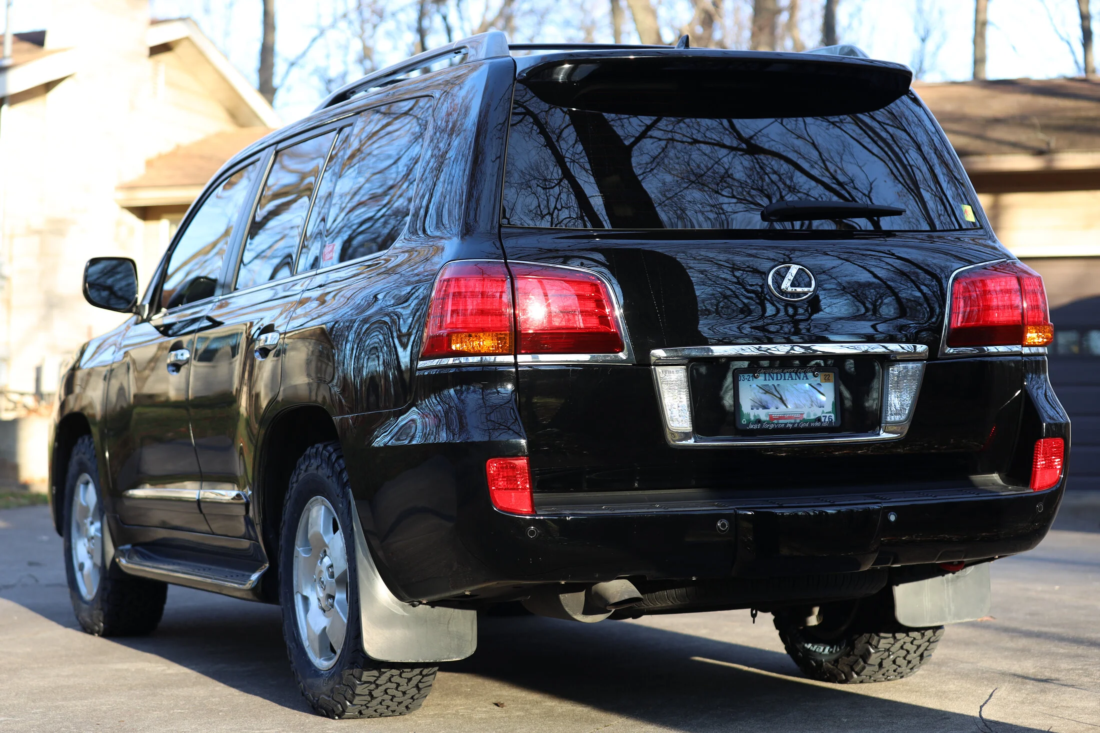

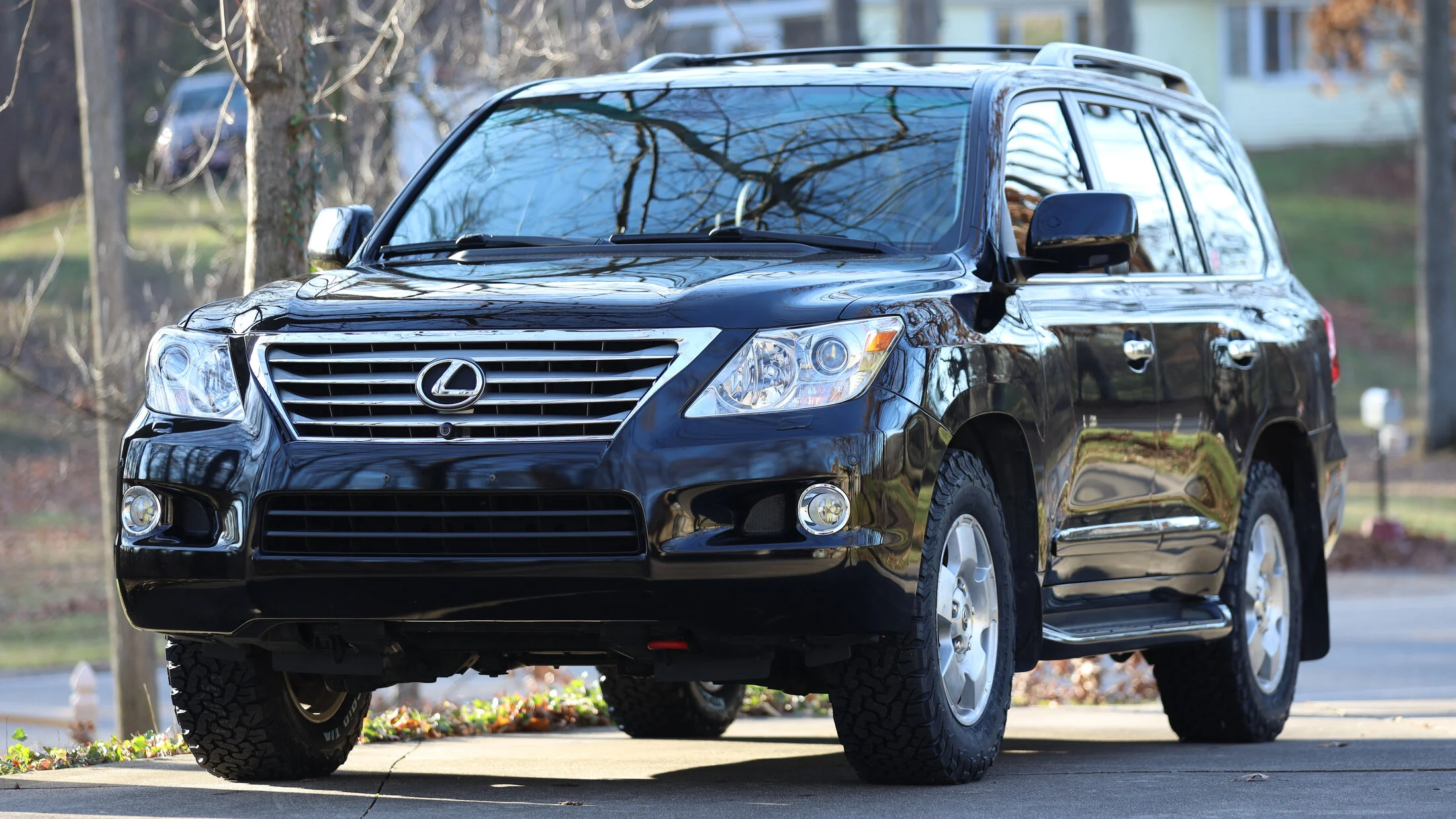

I've bought new tires 15 times in my life and it's always been the next size up, until now. Went from 37" ko2's to 36" toyo at3's.
Specifically 285/70r20 on 20x8.5 +10 (added center caps after photo)
I loved how the 37's on 17's fit and performed on my LX, but wanted to change it up. My goal was to keep the total weight no higher than the existing 26lb wheel and 65lb tire. Wheels weigh in at 30lbs and tires at 60-61lbs. We will see how I like it long term.
That looks great. How much fender work was needed?

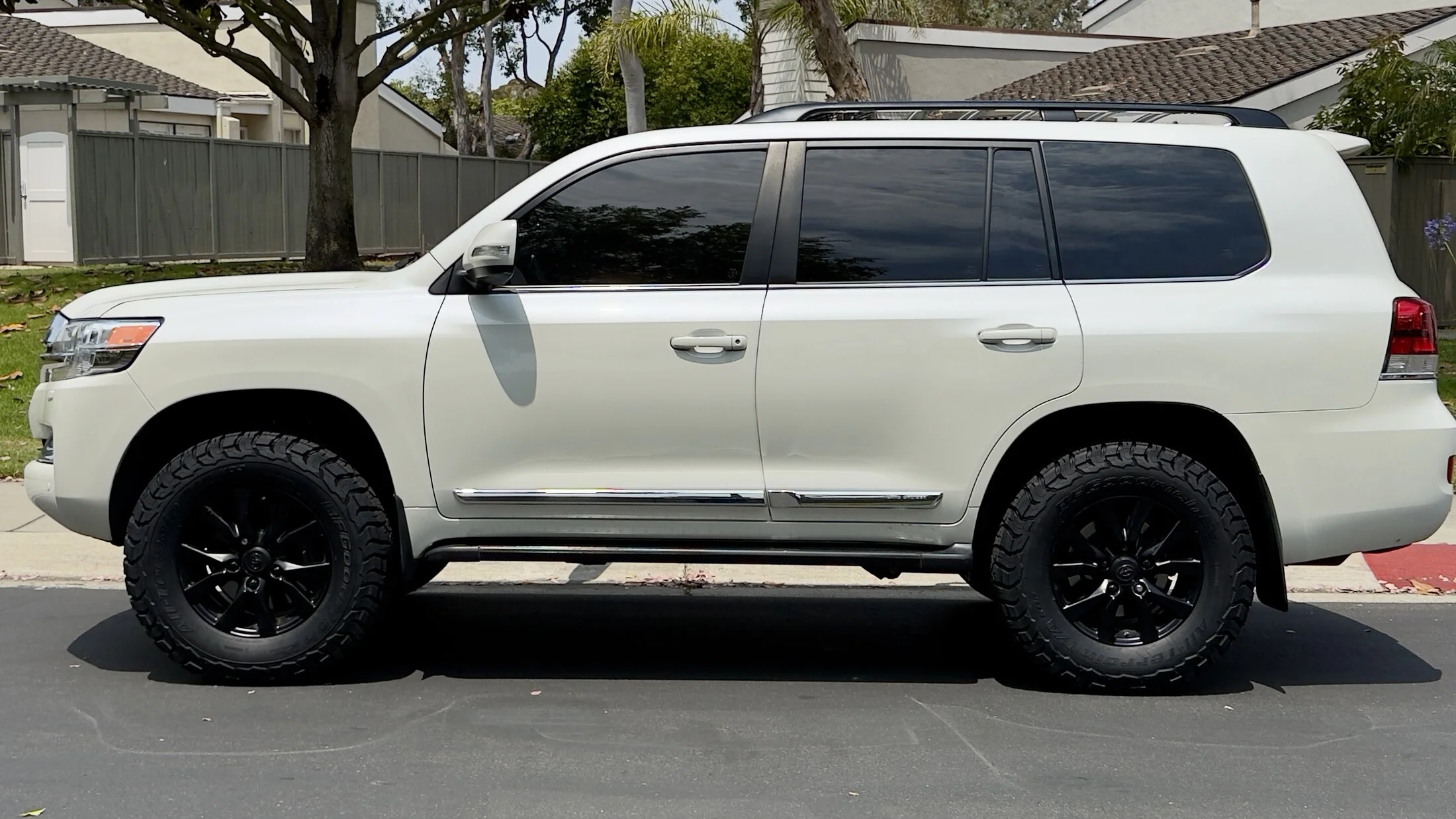

Curious if anyone have used this Tundra wheel. I would like to see pictures mounted. Im shopping around for Tundra take offs. I found a set of TRD Tundra black/grey for $600. This other set is only $200.
Installed some new tires on my brother's Tundra. BFG KO2 275/65R18. Tried them on my truck. I didn't care for them because of the offset that inset them too far for my liking, but that's personal preference.
Thanks. No fender mods. I have both sets of front and rear bumps modified/upgraded. Front wheel well liner pushed forward and a body mount chop.

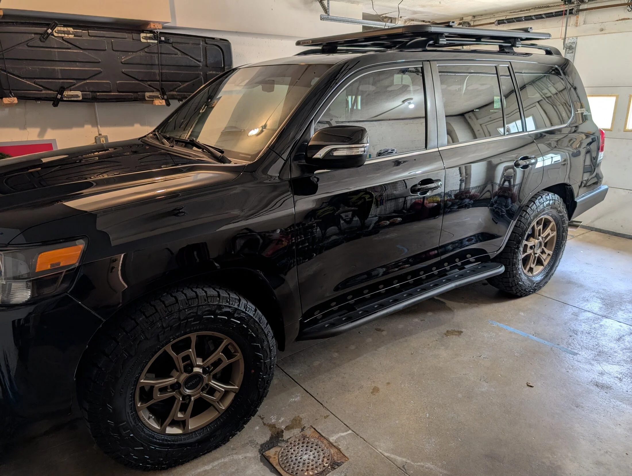

I scored a set of the 18" TRD Pros (I think that is what the wheel is called) this morning! Been looking for several different wheel styles for a couple of months and finally found something locally. They will need to be reconditioned a little and then considering what color to powder coat them. I have seen a couple of threads about powder coating impacting fitment. I'll make sure that a shop that knows what they are doing takes care of them.
These will be going on a black 2015 LC200 - I am ok with black on black, and bronze is really popular at the moment but I love the look.
