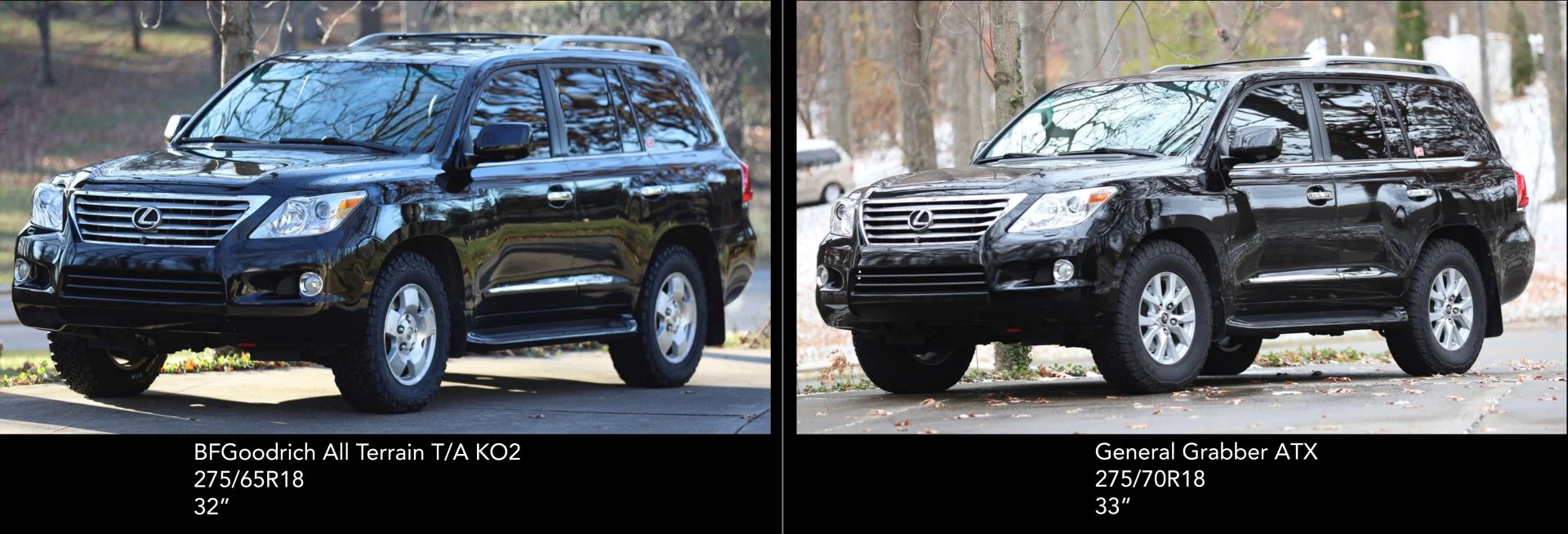

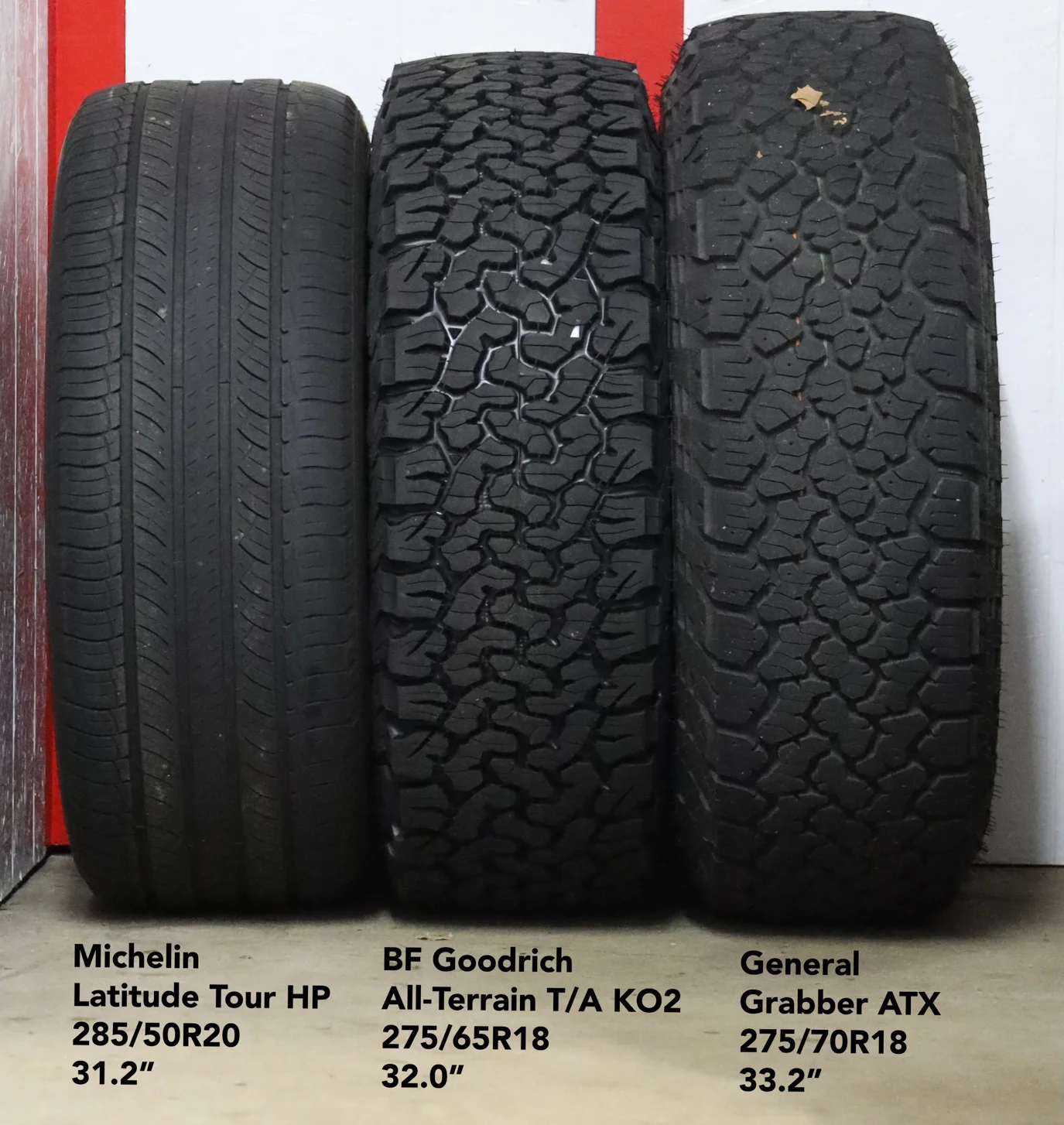

As much as I wanted Rock Warrior wheels because 17" meant more sidewall squish, finding a set in decent condition without spending an arm and a leg was fruitless after nearly a year of shopping. I found a few sets, but other buyers snapped them up before I could. The bronze BBS forged TRD wheels are also quite appealing to me, but again, the incredibly high cost turned me away. As much a like traditional 5-spoke wheels, the Toyota offerings weren't really doing it for me. I like the wide spoke Tundra wheels in the test fitment shown below, but the offset sucked them in a bit too far for my liking and I didn't want spacers. Meanwhile, the 10-spoke Land Cruiser wheels caught my eye, so there you have it.

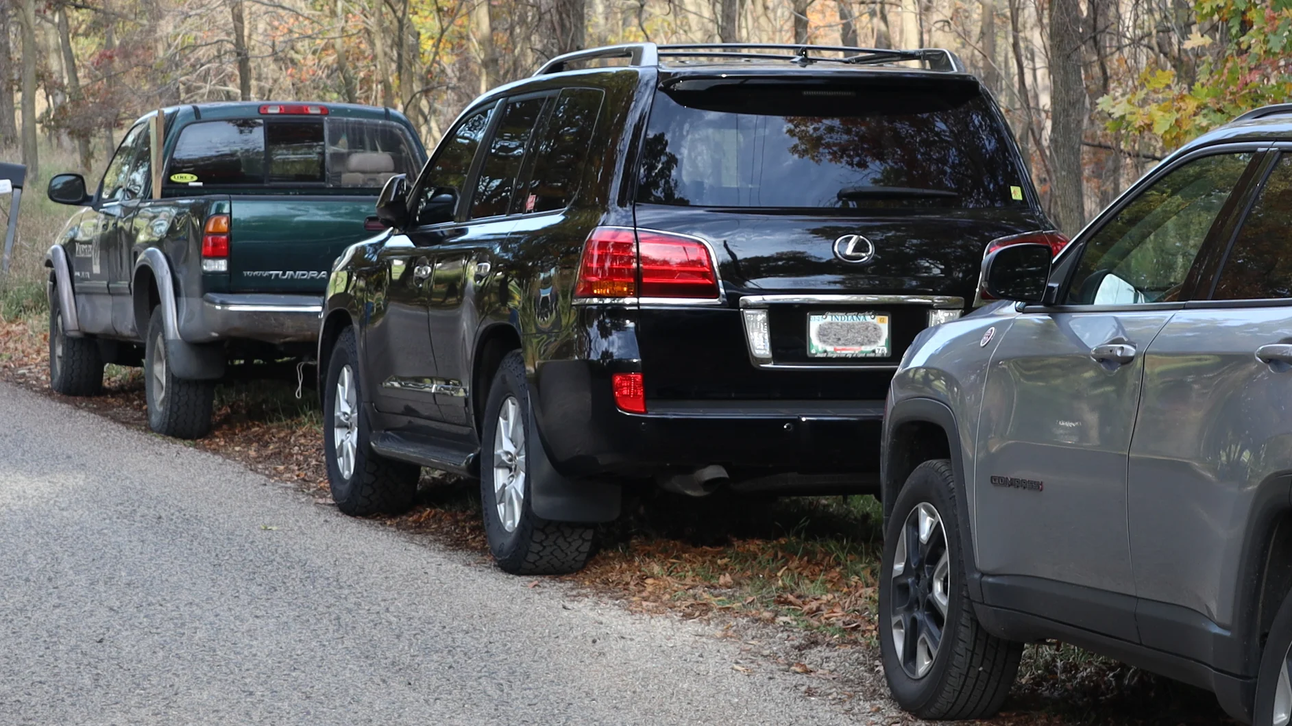

275/65R18 (32") BFGoodrich All-Terrain KO2, Tundra wheels. 91lbs each tire + wheel. Test fitment and test drive before installing on my brother's Tundra (not the green one shown below). Turn in slightly more responsive than Grabber ATX, which I attribute to the stiffer sidewalls of LT rating.

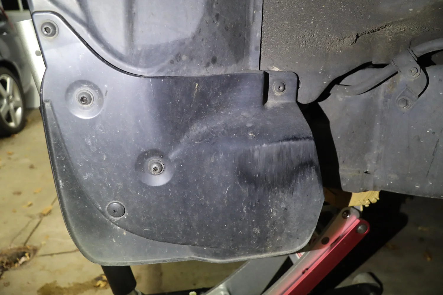

275/70R18 (33") General Grabber ATX, 2018 Land Cruiser wheels. 78 lbs each tire + wheel. Installed Nov 2021, so not many miles to give long term feedback. I'm still experimenting with on-road tire pressure in the 31-38 psi range. Initial feedback on-road is noise levels on par with the KO2. Noticeably more, but certainly not objectionable, noise than the OE Michelin Latitude Tour HP, but those are very street biased, crossover tires . So far, my wife and kids have not mentioned one iota about tire noise. (very) slightly softer ride than KO2, but I attribute it to the load rating SL (General) vs. LT (KO2) and slight bit of additional sidewall. My first choice was KO2 because of the rugged appearance and legendary performance, toughness, and durability, however the feedback about sketchy wet weather traction turned me off. This is my wife's daily driver and family trickster, so I didn't want to be concerned about wet traction. Furthermore, 90% driving will be on road, but I wanted the capability, confidence, and assurance of a capable all-terrain tire when the chances and opportunities present themselves. The only rubbing was the outboard shoulder against the front splash guard inboard couple inches at nearly full lock. That was remedied with a heat gun and 2x4 reshaping the plastic a bit. These are the summer tires; Bridgestone Blizzak DMV2 (255/70R18 = tall and skinny) serve winter duty. Therefore, winter traction wasn't very high on priority list for all-terrain tires.
Now that I've had the 33s on, there's no going back to smaller tires. I like how they fill the wheel wells. All these view with suspension set in N mode.

My truck just rolled 190k miles on the odometer with approx. 45k miles on this set of tires with 5k mile rotations. 6.7 mm (8.5/32") tread depth remains after 90%+ on pavement miles. Was 11.1 mm (14/32") when new. I have been quite pleased with their performance and longevity, and really have no reason to try something else, particularly in the SL rating. I run Blizzak DMV-2 winter tires on separate wheel, so the winter traction on all-terrain tire isn't so important to me.

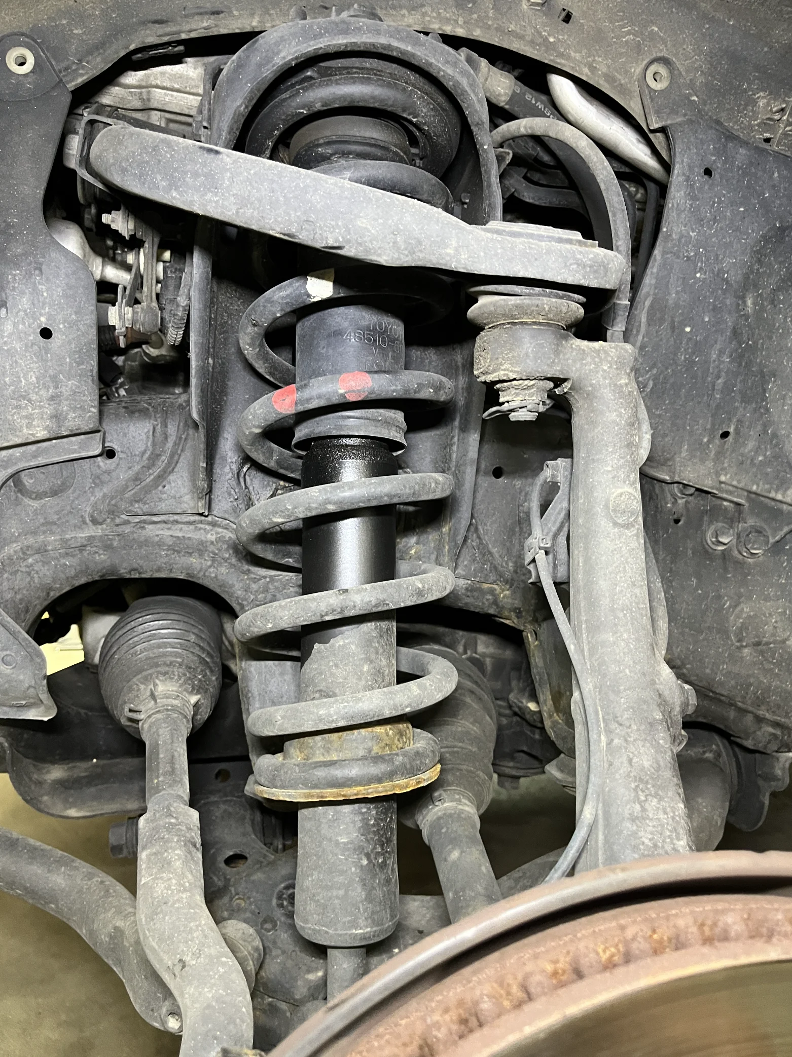

The front shocks are starting to weep, so replacing them is in the not too distant future. It should time nicely with a AHC fluid change along with supporting suspension hardware. I guess I could consider it the truck's 200k mile birthday gift.

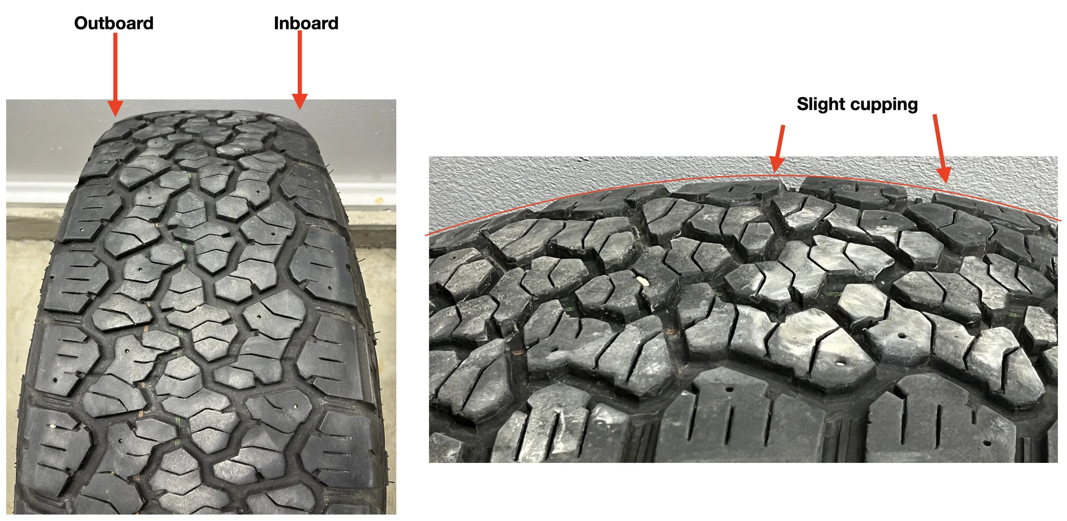

The inboard tread blocks are starting to cup, leading to some road noise.

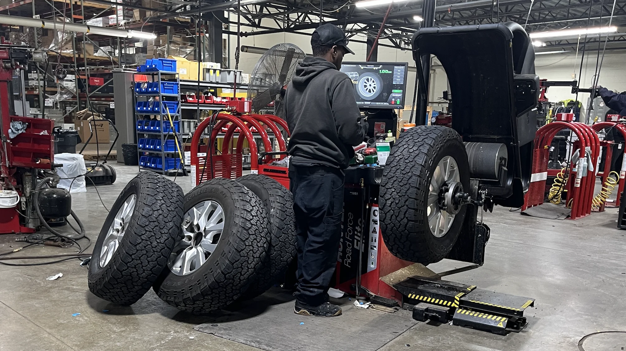

To prolong the life of the tires, The Tire Rack headquarters in South Bend rotated the tires on the wheels - as in dismount tires from wheels, flip them inside out, remount, and balance them. I exclusively use Tire Rack because their equipment is plastic, rubber, or vinyl coated so as to not mar the finish on the wheels. It absolutely blows my mind the number of tire shops that use metal grippers/tools and destroy finish on (expensive) wheels or leave paw prints embedded in the aluminum. The Tire Rack technician was taking great care not to damage my wheels and I commended him for it. And, until 2025, they only charged $15 per tire for mounting and balancing, but that has increased to $22.50 each.

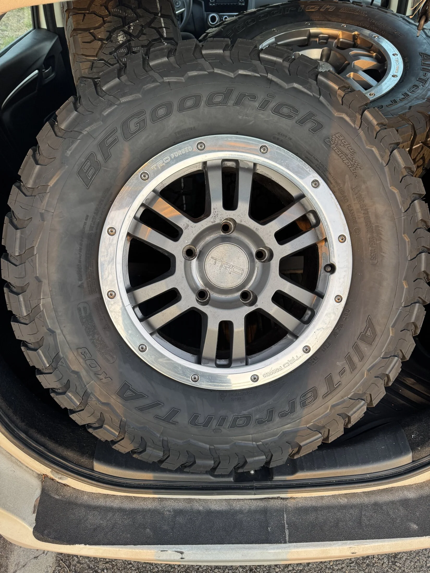

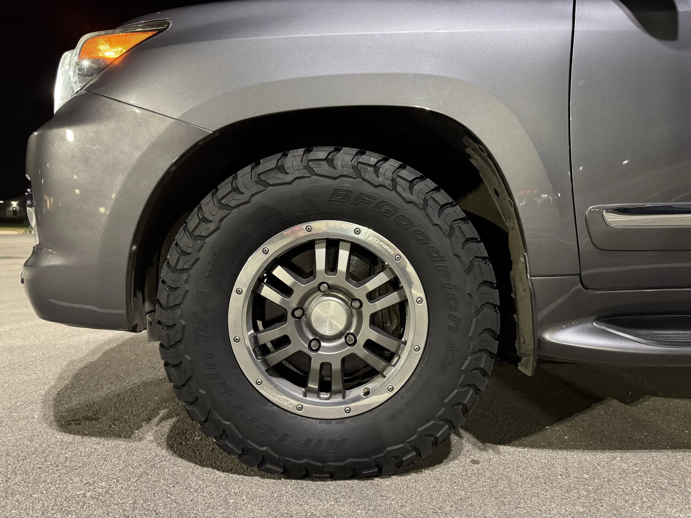

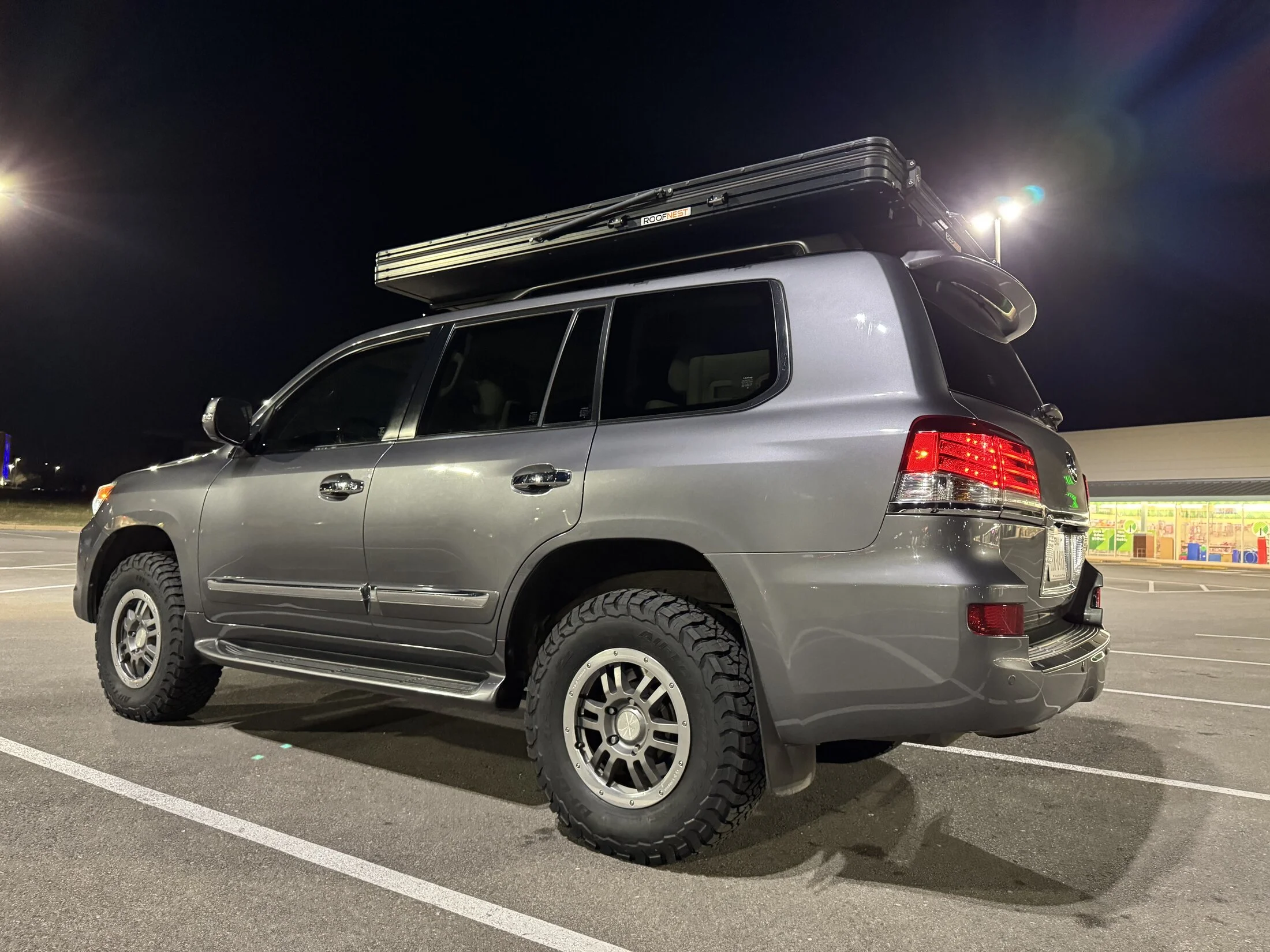

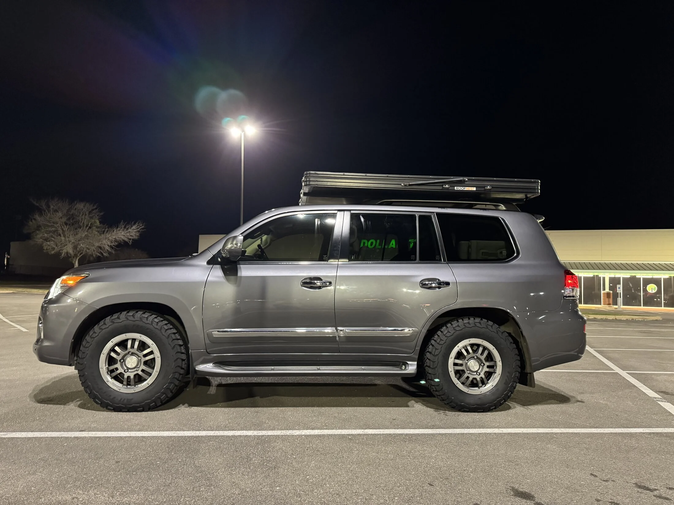

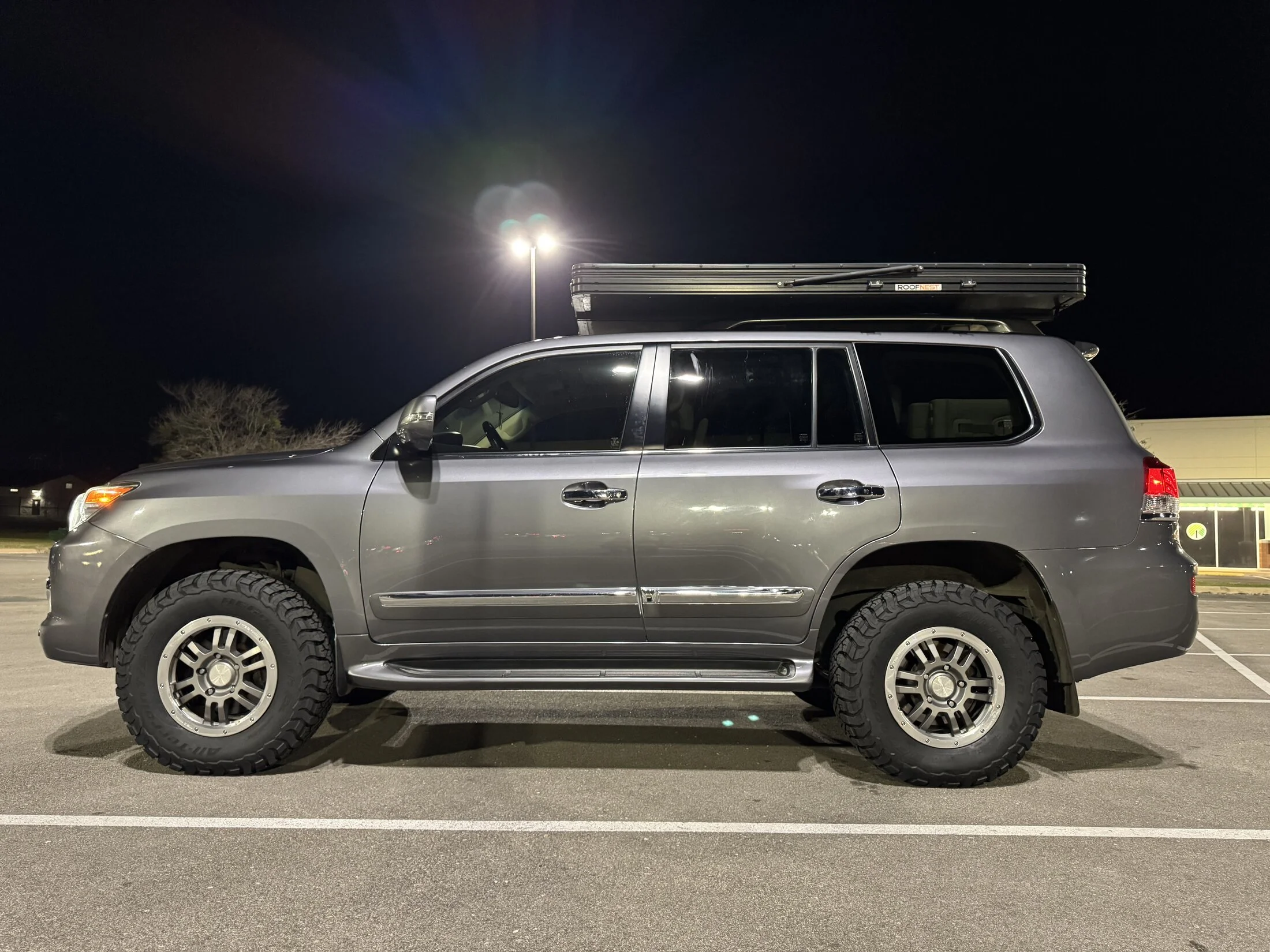

nice, thanks for pics and info. looks like your is 17" and probably @urinalcake is "18 wheels. I have 20" oem on LX 2011. I dont mind finding a 17-18" wheels if a fellow LXer using AHC can put these bad ass tires without spacer or other modifications. love the look. LX folks, please chime in. I looked at the list and the only open I see for LX in the list are Michelin defenders. Others seem to need 2" lift based on my quick read.
View attachment 3832083View attachment 3832084View attachment 3832085View attachment 3832090
Quite happy with results. Immediate impressions very comfy. No noticeable noise increase.
Tire shop put them at 35psi but I believe they call for 40.
Is gaijin around for Rcitp? Don’t know how to tag anyone.
"The Book" says 35psi for those tires on an LX570, but Toyota (and "The Book") dictate 40psi for those wheels and tires on an LC200.
So.. take your pick.
